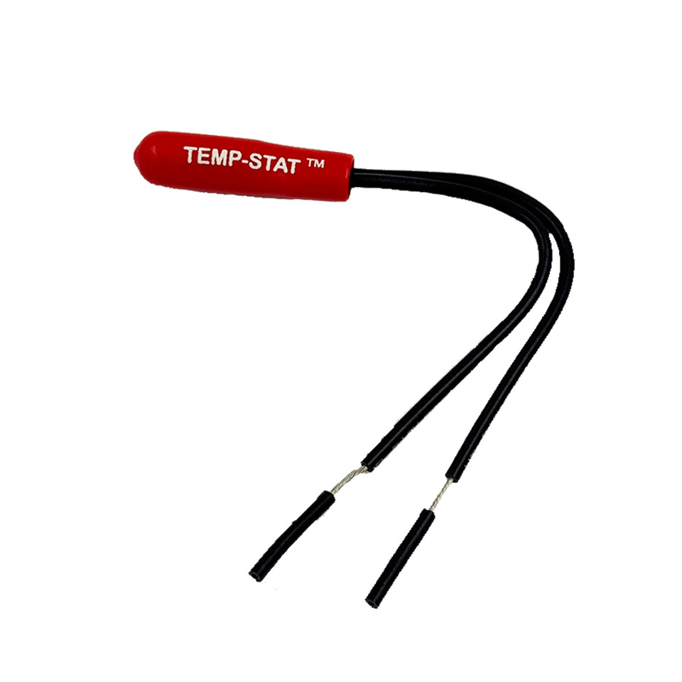

These are already wired with two wires so no common. So I have put in a couple of 2 wire heat only mechanical thermostats. They asked about other options.
Has anyone tried this. I picked up two construction "bulb type" thermostats set at 50 degrees. They are small enough to fit inside the room thermostat. I tied in parallel with the room thermostat. If the batteries die, the bulb thermoses will maintain 50 degrees.
Has anyone tried this??

Agreed to wire them in at the boiler.
I've also installed actual "cheap" thermostats at the boiler as a back up for the same function set at a low temperature
why would you need to "try" this.? this obviously will work and what i suggest to friends and coworkers that really want a nest or other overly complicated thermostat programmed by people who are not embedded systems programmers.

the backup mechanical thermostat also takes care of software problems with the themrostat
