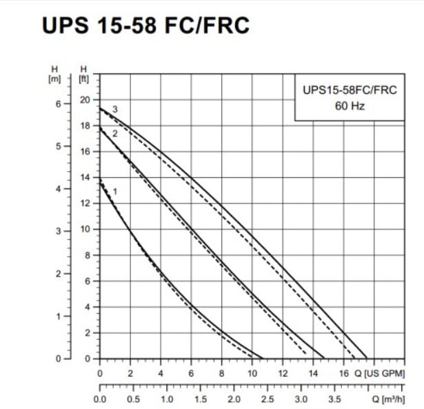

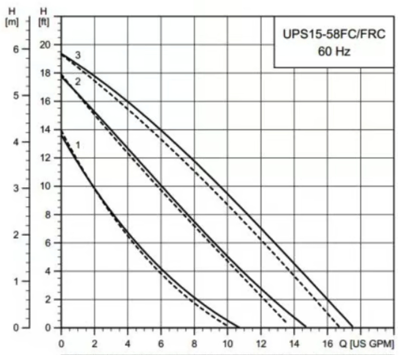

Hi all I'm looking at two Grundfos pumps both 15-58FRC & 15-58UPS.
Trying to figure out do both have the same curves or are the different. I dont understand the curves from the two.
15-58UPS below

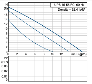

    Yes and no. The top graph shows the actual inherent performance curves for the pump operating at three different power levels. That graph shows what the pump — without other controls — will accomplish. The bottom diagram shows the effect of three different electronic control strategies which the "e" version oof the pump can be programmed to do:
    hot_rod Posts: 28,704
    The first set of curves shows the 15-58 with and without the internal check valve, so a small difference.
    The "c" in the model number is for internal check valve versions. FR is for flange rotated versions.

    Can the second curve/pump depending on how its programmed/set mirror the first pumps curve or are the completely different….just trying to undertstand is it worth buying the 15-58 UPS
    The pump itself is exactly the same. The difference is in the controls.

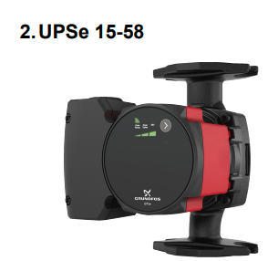

    There seems to be some confusion. The UPS15-58FC and UPS15-58FRC are the exact same thing but with different flange orientations. The UPSe that you are referring to as a UPS is an ECM motor with pressure sensing controls and a completely different design. The curve is very similar and one will swap for the other unless it's at the very edge of its curve. If the system is zoned and has a magnetic separator and/or minimal ferrous components, the UPSe is a great choice and will likely save a few bucks per month in operating cost. If there is any iron in the system without a mag sep, stuck with the standard UPS
    Different design for the motor, that is. The pump (impellor and volute) are the same (that's the UPS15-58 part of the designation.

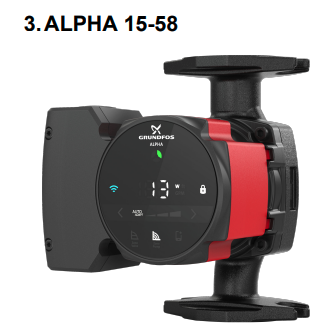

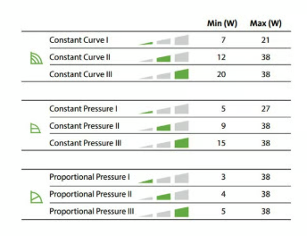

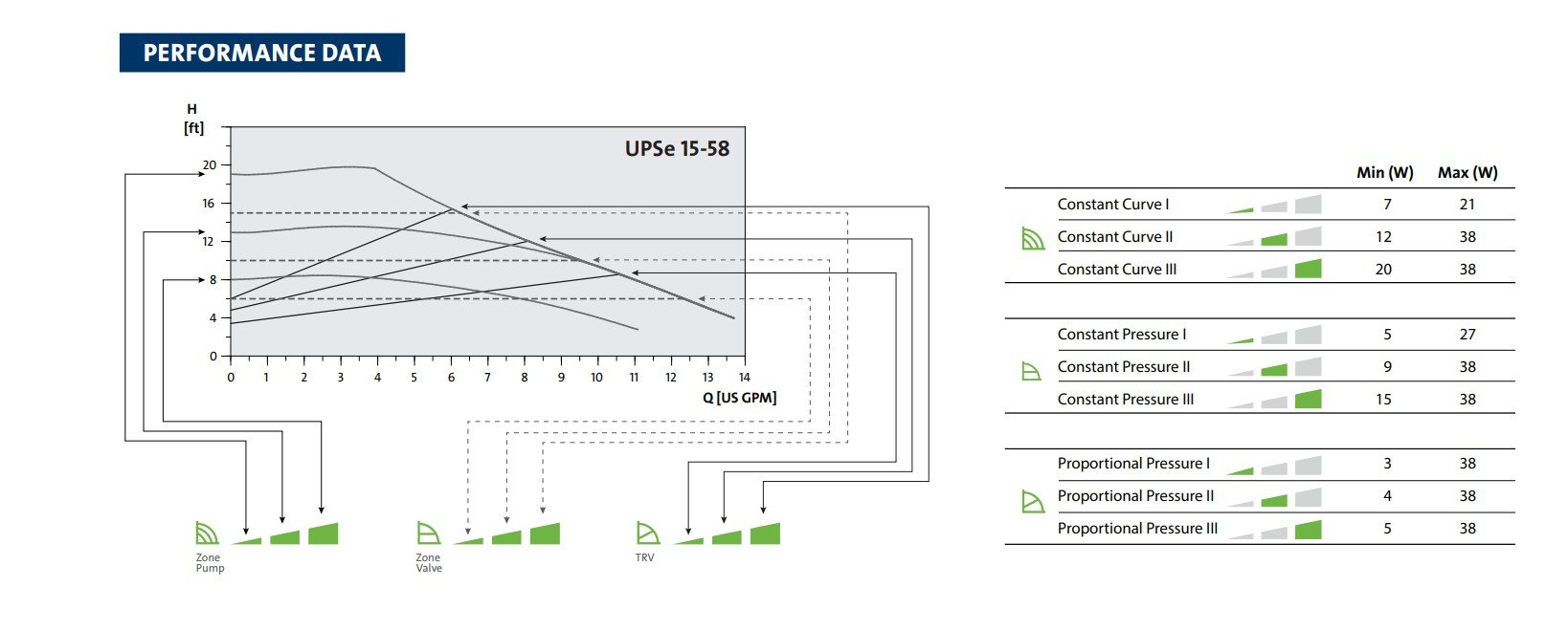

    There are two versions of the high efficiency 15-58 Grundfos pump, recently introduces.
    In addition to the Alpha 2 15-55 model still around.
    The UPSe 15-58 is the basic model, around $220 online
    The Alpha 15-58 has more features, $285
    In the basic operating mode they consume about 1/2 the power of the standard 15-58, while moving the same gpm flow rate.

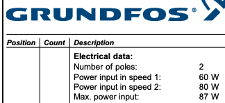

    Shown below, under blue Grundfos, the standard 15-58 non electronic (ECM) model shows 60, 80 or 87W depending on speed.
    The Alpha, green chart can run down as low as 7W, max. 38W
    Using the variable speed function on zoned system they can reduce power consumption by 80%
    There are energy efficiency rebates available for upgrading to these SCH, electronic, high efficiency circulators in many areas, if you do plan on upgrading.
    Most important is selecting the correct pump for the application.
    Screenshot 2026-02-11 at 8.18.45 PM.png Screenshot 2026-02-11 at 8.18.30 PM.png Screenshot 2026-02-11 at 8.03.49 PM.png Screenshot 2026-02-11 at 8.29.43 PM.png

    when you say 15-58 ups are you referring to the UPSe 15-58? that letter e is very important to include. both pump models will start with UPS

    If the system is zoned, either with zone valves or TRV on the radiators, then an ECM pump with the variable flow adjustment makes more sense, Alpha 15-58 for example.
    It will save some operating cost, 50% or more, allow the system flow to be modulated, for better control of the system.

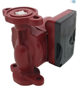

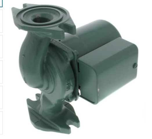

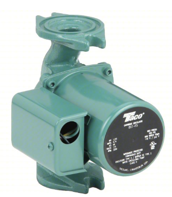

    If you are replacing a Taco 007 with a Grundfos the flange are in different positions, notice the difference here. So if space is tight the Grundfos may not fit.
    Screenshot 2026-02-12 at 8.29.47 AM.png Screenshot 2026-02-12 at 8.30.16 AM.png
    So Grundfos offers the RFC versions (rotated flange check) this matches the flange orientation of the Grundfos, see below.
    If you go with the standard Grundfos 15-58 it would be a 15-58 FRC shown here.
    If you go with the 15-58e or Alpha 15-58 you need the FRC model also, see below

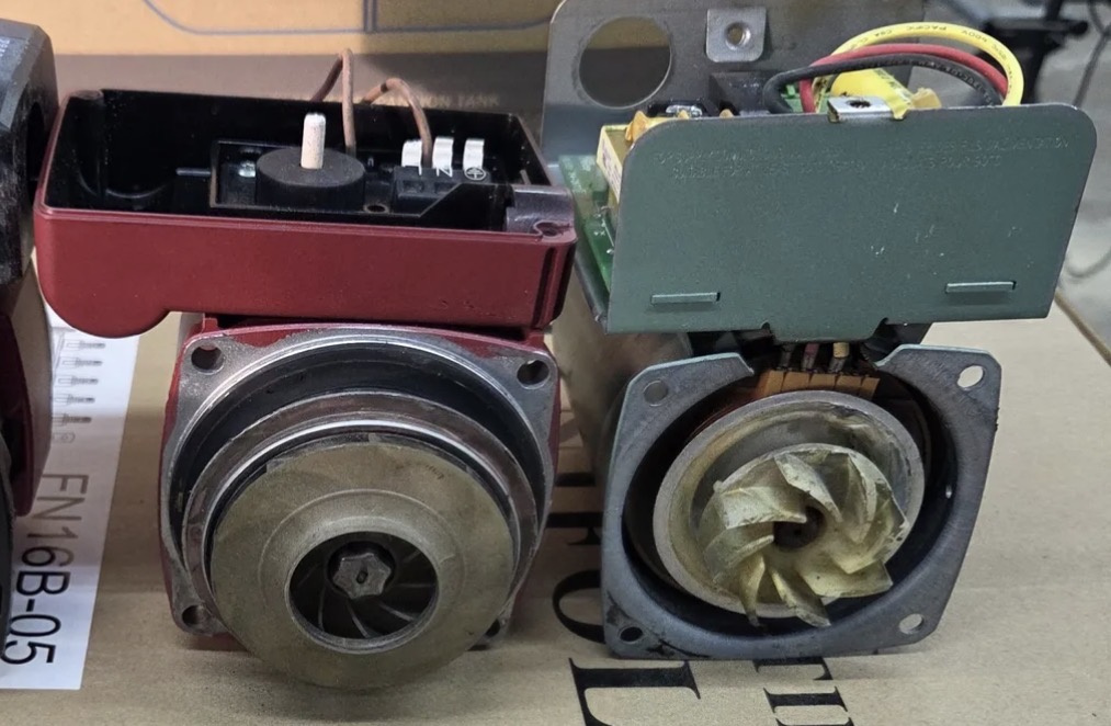

    For your viewing pleasure (disregard the Taco 007). As with all Grundfos circs, the 15 designation means a 15mm bore and the 58 means 5.8M of head like @GGross mentioned. The curve really isn't a lot different but everything else is. Even the bolt pattern is different.
    To the OP, you seem to be ignoring the repeated questions about zoning but generally, power savings is your only potential benefit of going with the UPSe.

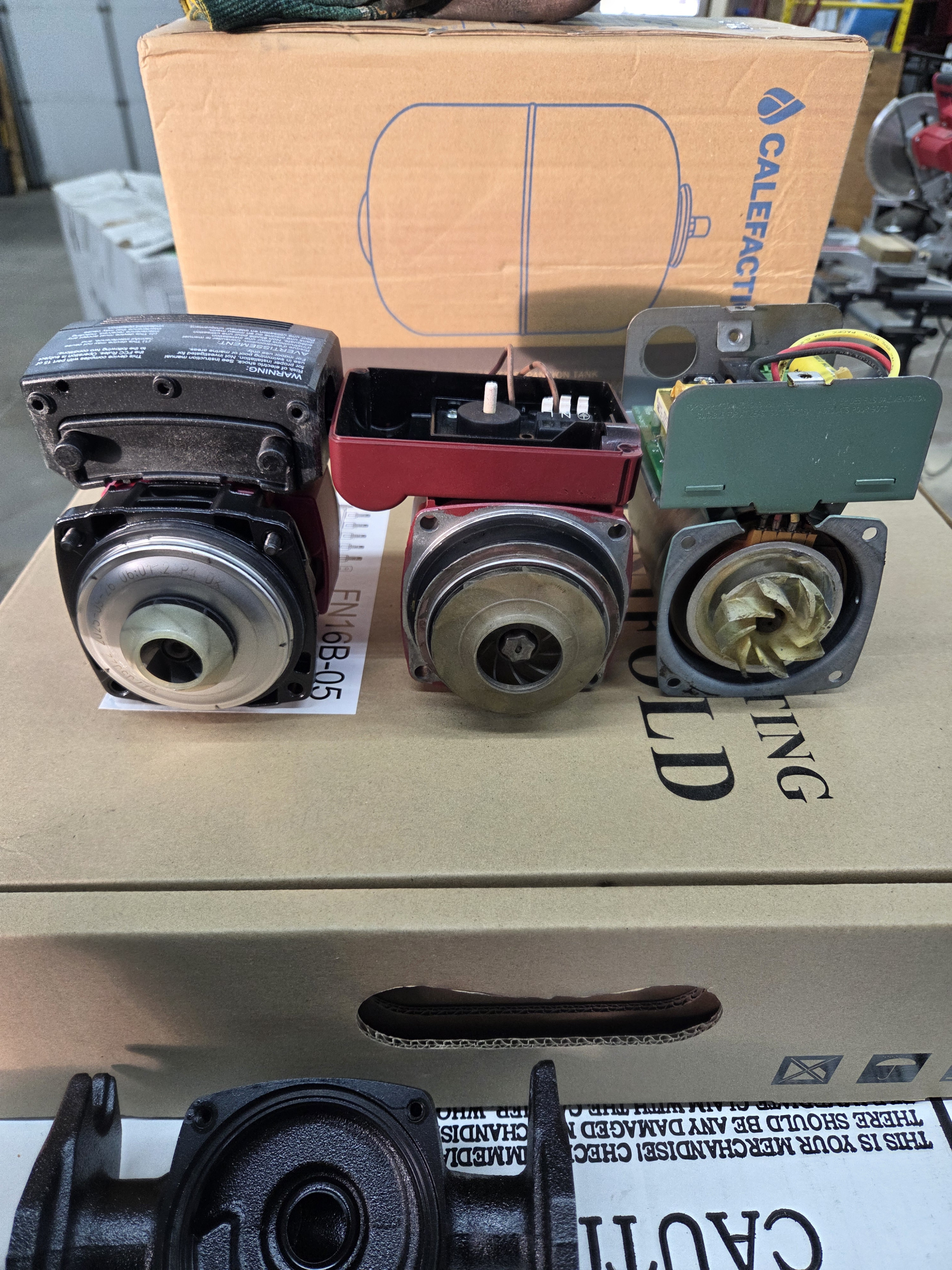

    you can tell a lot about a circulator by looking at the impeller.
    Generally a small diameter wide impeller will be a low head high gpm circ
    The green Taco if it is an 007 is at 23 gpm, max. head 10’
    The Grundfos with a large diameter, thin impeller is 17 gpm, max. 19’ head
    They are not really an exact swap circulator.

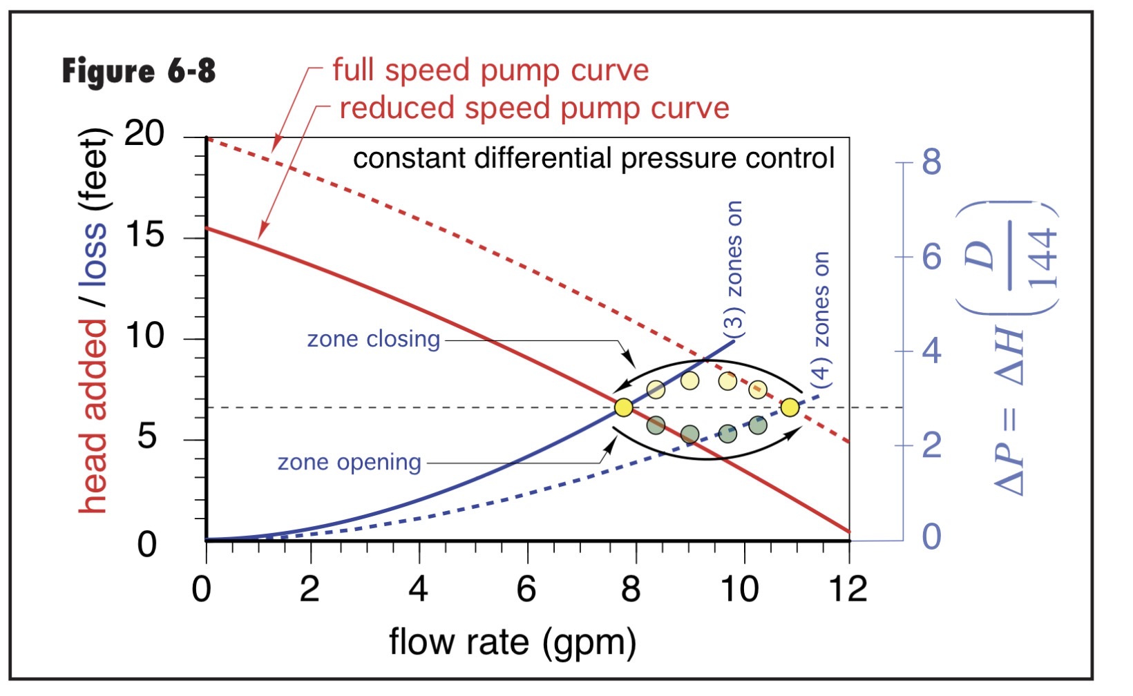

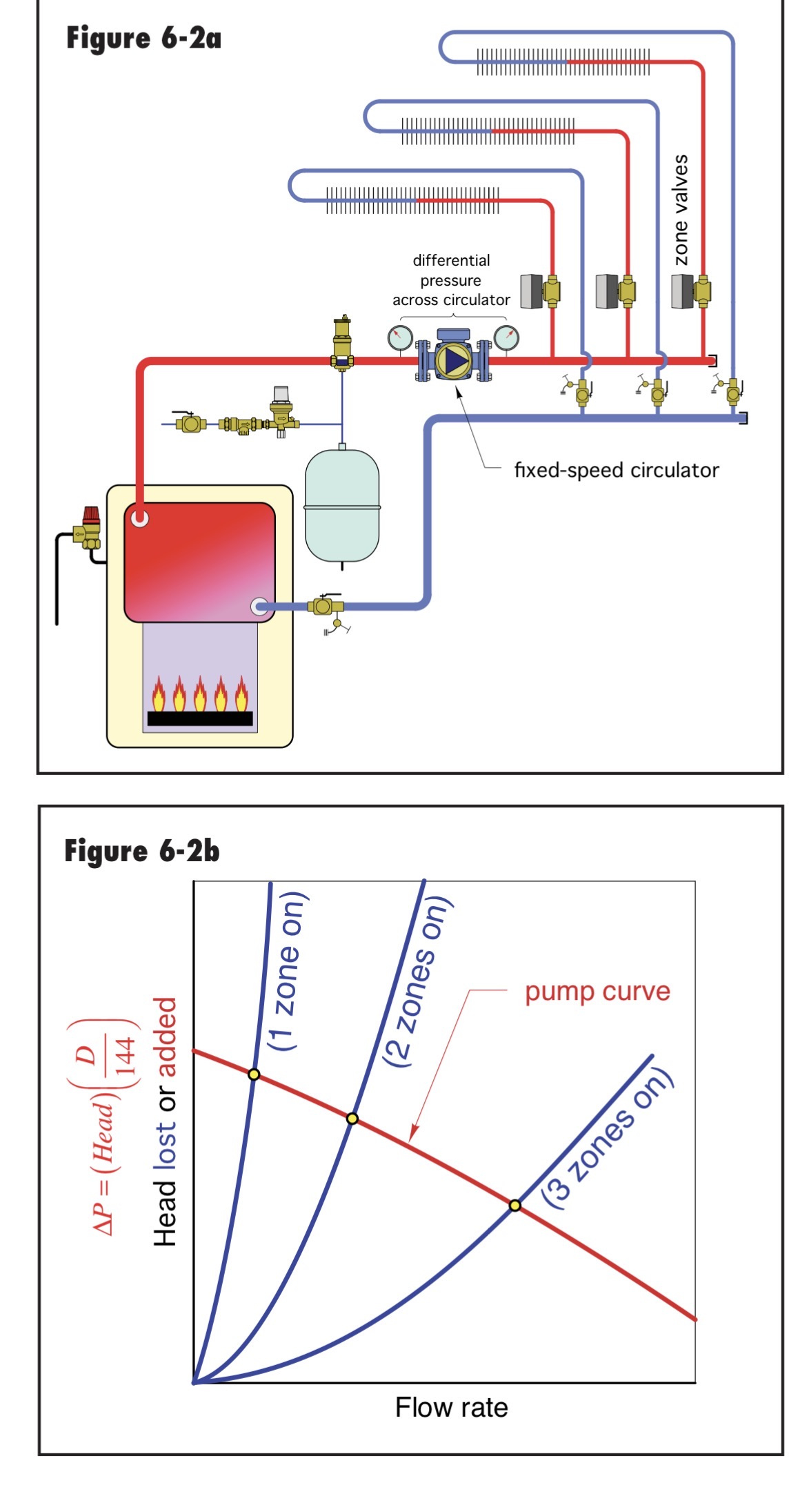

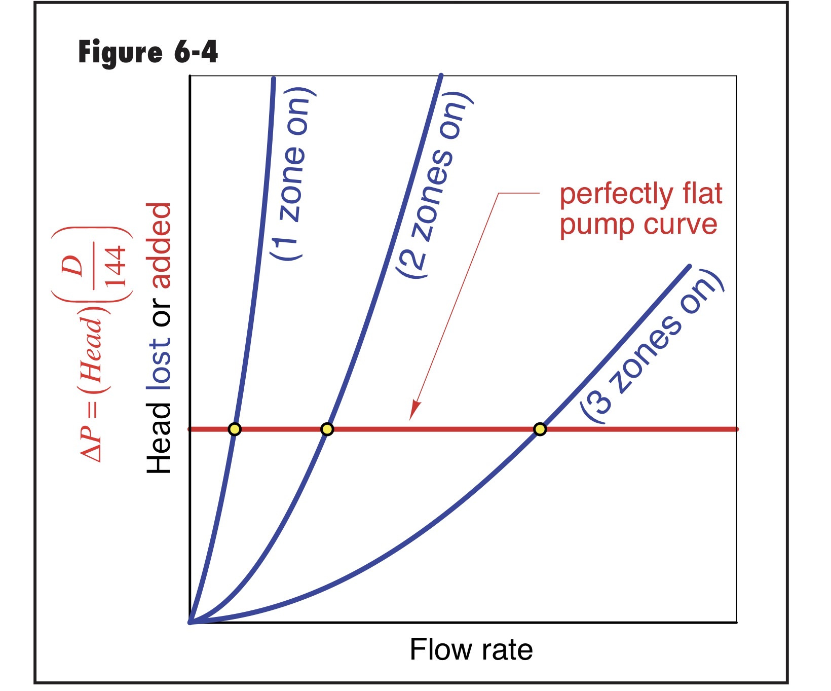

    if you do have a zoned system the ECM does have several distinct advantages. Think of it as a cruise control on your vehicle. The engine output, rpm constantly changes with road conditions.
    With any fixed speed pump, it is sized for max load all zones calling. As zones close off you start over pumping the remaining zones. The Taco handles that better than the 15-58 due to the low head flat curve.
    But better yet is a pump like the Alpha that adjusts speed (cruise control) as zones close. So power could drop as low a 7W with one small zone calling. Possibly an 80% reduction in energy consumption over the standard pumps.
    Adjusting speed down also reduces flow velocity, noise, piping wear, prevents grossly over pumping the zones
    Some graphs to demonstrate the pumps performance, starting with a fixed speed. Notice with only one zone open you at at the top of the curve, the worse spot on the curve to be running.
    a flat curve would be the ideal operating condition.
    , head remains constant as gpm changes.
    today’s ECM variable speed circs get very close to the ideal operating (flat) curve. Withing seconds of a zone opening or closing the pump reacts and adjusts it flow rate.

    @hot_rod I would generally have agreed, until I opened up the UPSe 15-58 on the left side of that photo. Very similar performance to the UPS, but with an impeller 1/4 the circumference (visually same thickness). I also recently opened up a UPSe 20-78 which is a very high head circ, and the impeller looks identical to the UPSe 15-58. They'll even swap from one volute to the other. I may be missing something obvious, but a visual on the impeller doesn't mean what it used to when referring to these UPSe circulators.
    the rpm also comes into play. The B&G series 100 a classic low head high flow circ was a 1750 rpm. wet rotors tend to be higher rpm, 2450 on a 15-58, so impeller design, involves shape, size, and rpm
    Although I have swapped various 15 series among different volutes, 42s, 55s, 58 and not noticed a big difference. Probably not an option with higher efficiency circs nowadays
    Back in the day pump dealers would shave the impellers to dial in larger circ, now the variable speed does the adjusting, and the electronics make the decisions.

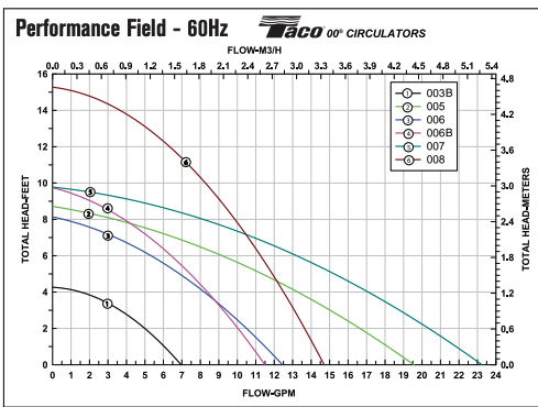

    I think @EdTheHeaterMan made a pump curve sheet showing the 007 and 15-58 on the same sheet to easier see the performance difference. The 15-58 is a higher head circ which would have been more than the series 100 or 007 would have provided.
    At mid curve of 8 gpm the 007 is 8', the 15-58 is 11', for example.
