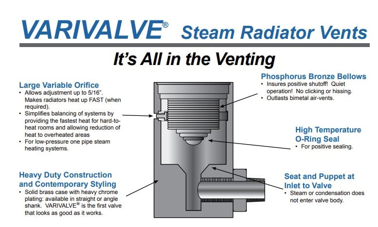

I wanted to share a "post-mortem" I did on a pile of Heat-Timer Varivalves I’ve pulled from my house recently. While these valves are popular for their sleek look and adjustable sliders, I’ve found them to be fundamentally flawed, with several units failing in my home after only a year or two.
If you have these on your radiators, take one off and shake it. If you hear a rattle, the valve has failed internally.
I cut a few of these open to see exactly why they die so quickly. The issue is the connection between the bellows and the sealing ball. It appears to be held together by a chemical adhesive or glue. Between the constant expansion/contraction cycles and the exposure to high-heat steam, that glue eventually gives way. Once the ball detaches, the bellows can no longer force the valve shut, making it useless for controlling your steam.
It’s disappointing that a design this old hasn't been updated with a permanent mechanical connection. I've personally stopped using them and have switched to more reliable alternatives like Vent-Rite or Maid-O'-Mist.

    @patrykrebisz did you find out how they assemble them? Are they press fit from the top? Or what? Their construction is rather mysterious on first look but I haven't removed the sticker off the top yet
    CLamb
  • The bellows are made from thin cooper with some sort of check valve at the tope. The whole assembly (bellows and the ball) seems to be pressed into the the housing from the top.
    The ball has a rubber-like ring around it.

    Not to be nitpicky…..great video and taking the thing apart with the cross section cut was very informative, but the bellows is actually phosphor bronze, which is a spring tempered copper alloy. It's a darn shame what they have done. They see fit to do a press fit for the cap so we can't take the things apart and actually repair them, but they can't solder or press fit the ball pintle into the bellows. I'm also wondering if the QC is lapsing on these or the earlier ones I got were just luck. I wonder what the check valve does, which they make no mention of. Also lol at "puppet" instead of poppet and "steam or condensation does not enter valve body" 🤣

  • I'm tempted to chuck one up in my lathe and cut the cylinder just enough to remove the top. They might be repairable some way and then resealed with high heat epoxy.

  • There are enough people with an engineering background on this board that we should all agree that glue between the bellows and the sealing ball is NOT an adequate way to attach the two.
