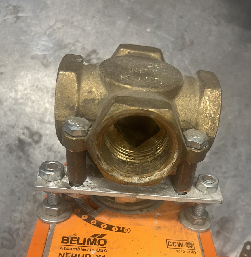

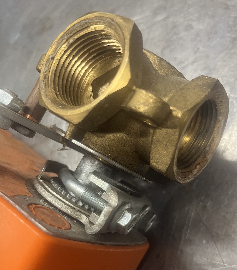

    Belimo offers a variety of mounting kits for their actuators. Basically a bracket and coupling for the shaft.
    I've built a couple mounts, like this one, for reversers on 1000' radiant loops.
    A piece of flat metal, some spacers and modify a 1/4 pipe coupling to go over the valve shaft. Th U bolt comes with the actuator. It pinches the split coupling against the flat on the valve shaft.

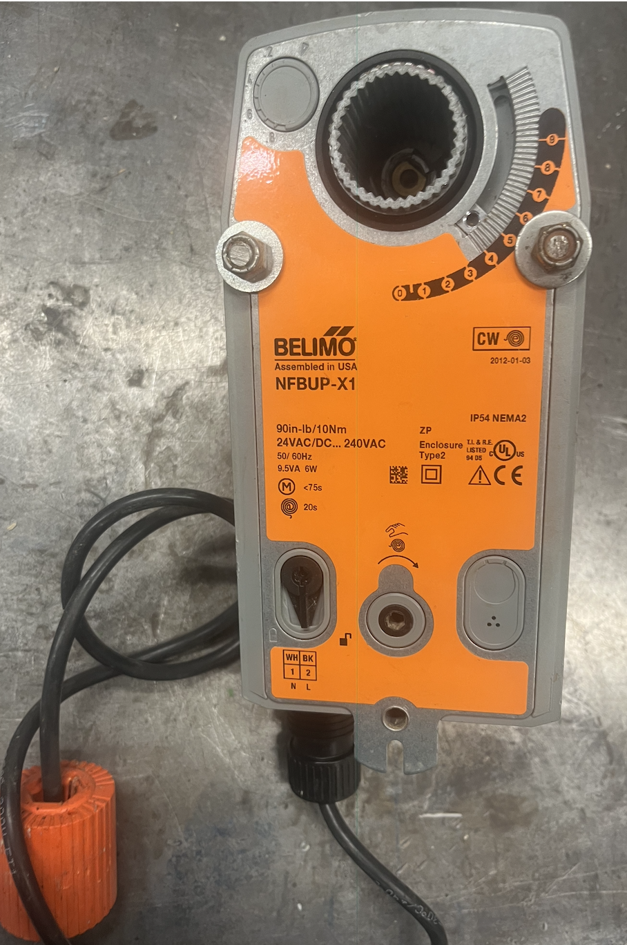

    I used a simple lamp timer to flip the valve every 15 minutes. This 90 in/lb model Belimo can accept AC or DC from 24- 240V

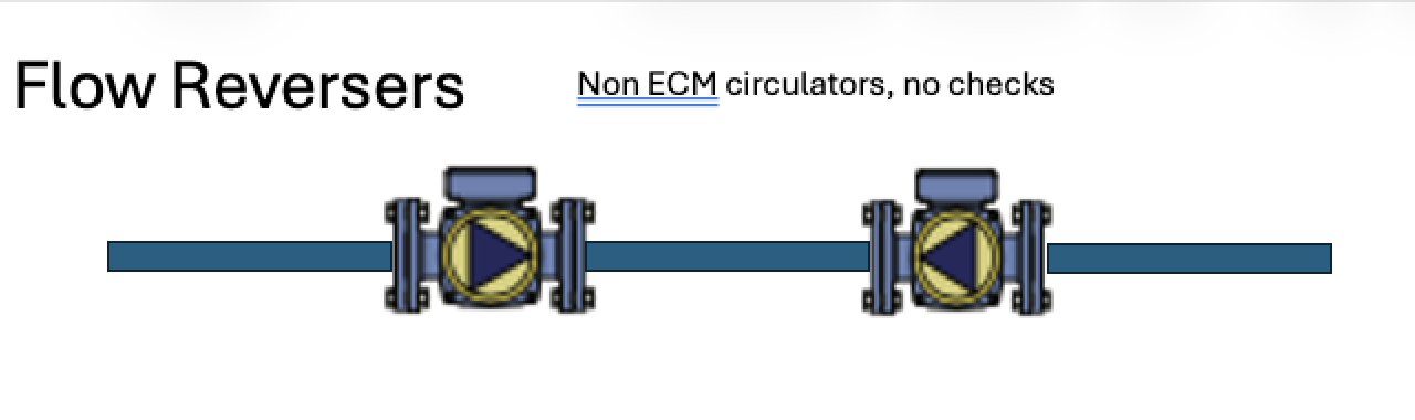

    Flow reversal with two circulators. I tried this with two ECM inline, but the one that was powered off would flash weird displays when un-powered and rotated backwards :)

    There was a general contractor in my area putting 1000' coils in basements of his spec homes and billing them as "radiant ready" As people bought these homes I got called to connect the radiant. So I built a few of these and they worked well.
    There is no problem with the valve moving positions while the pump continues to run. There is never a position in the valve where the pump deadheads.
