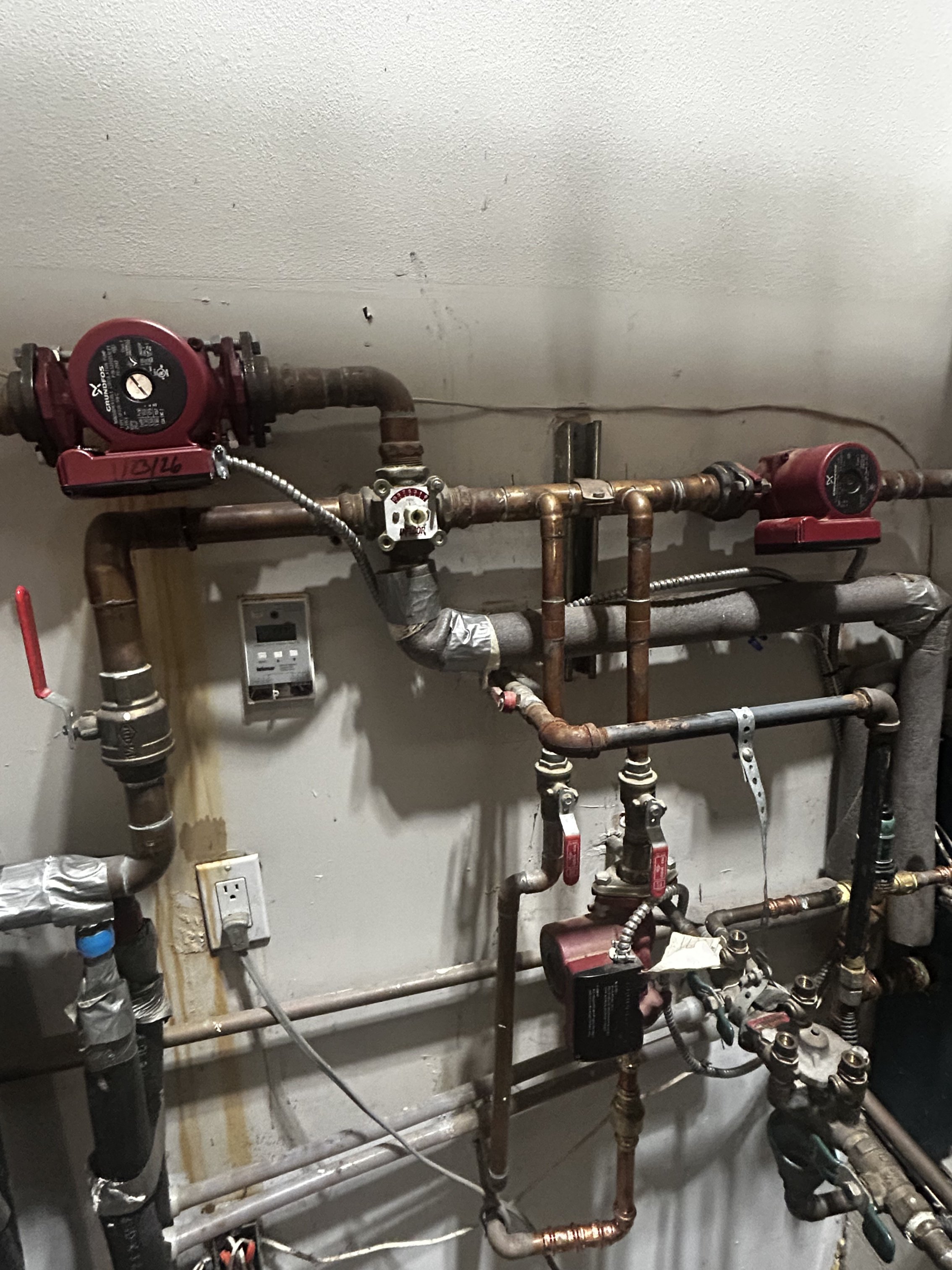

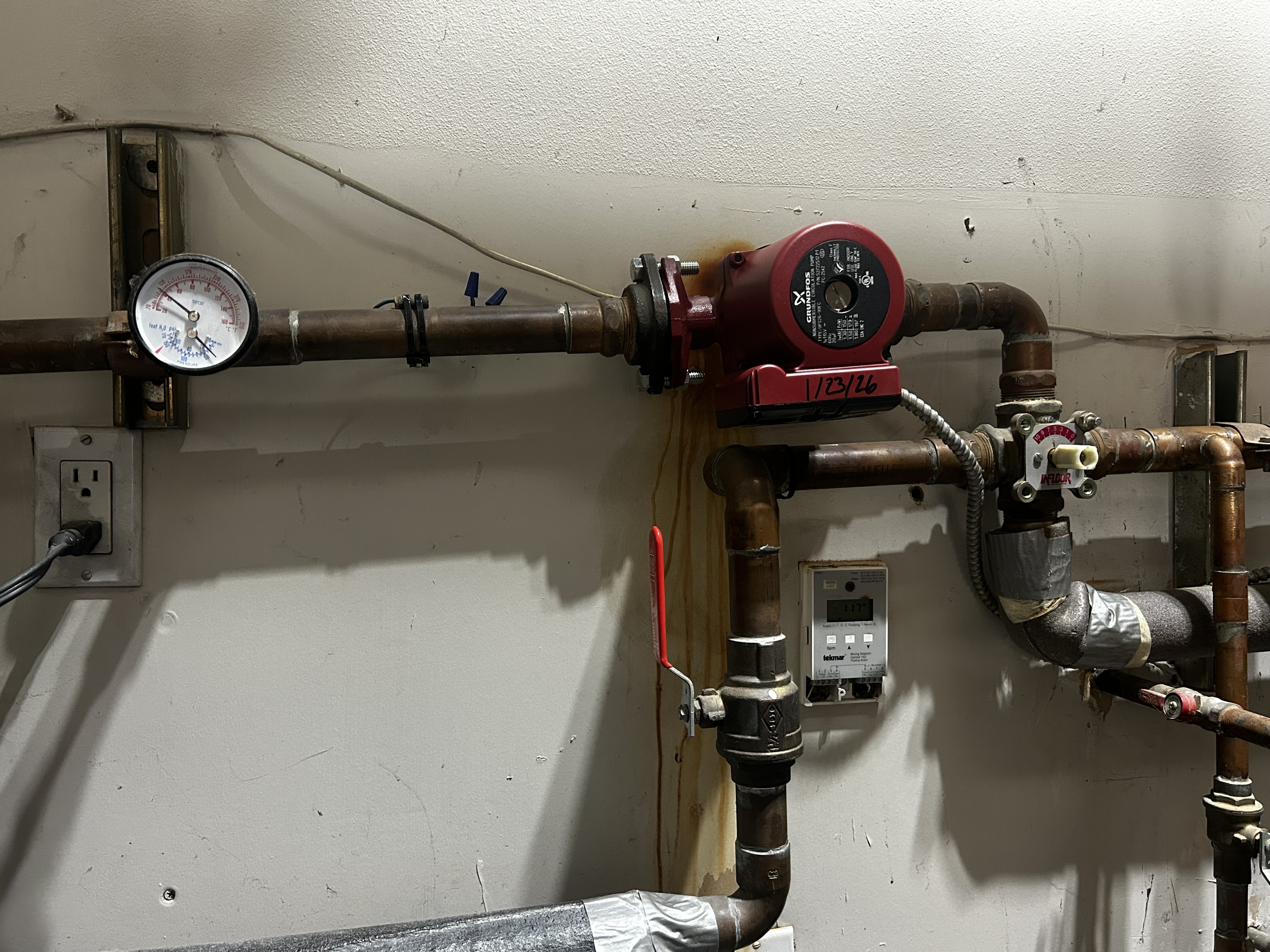

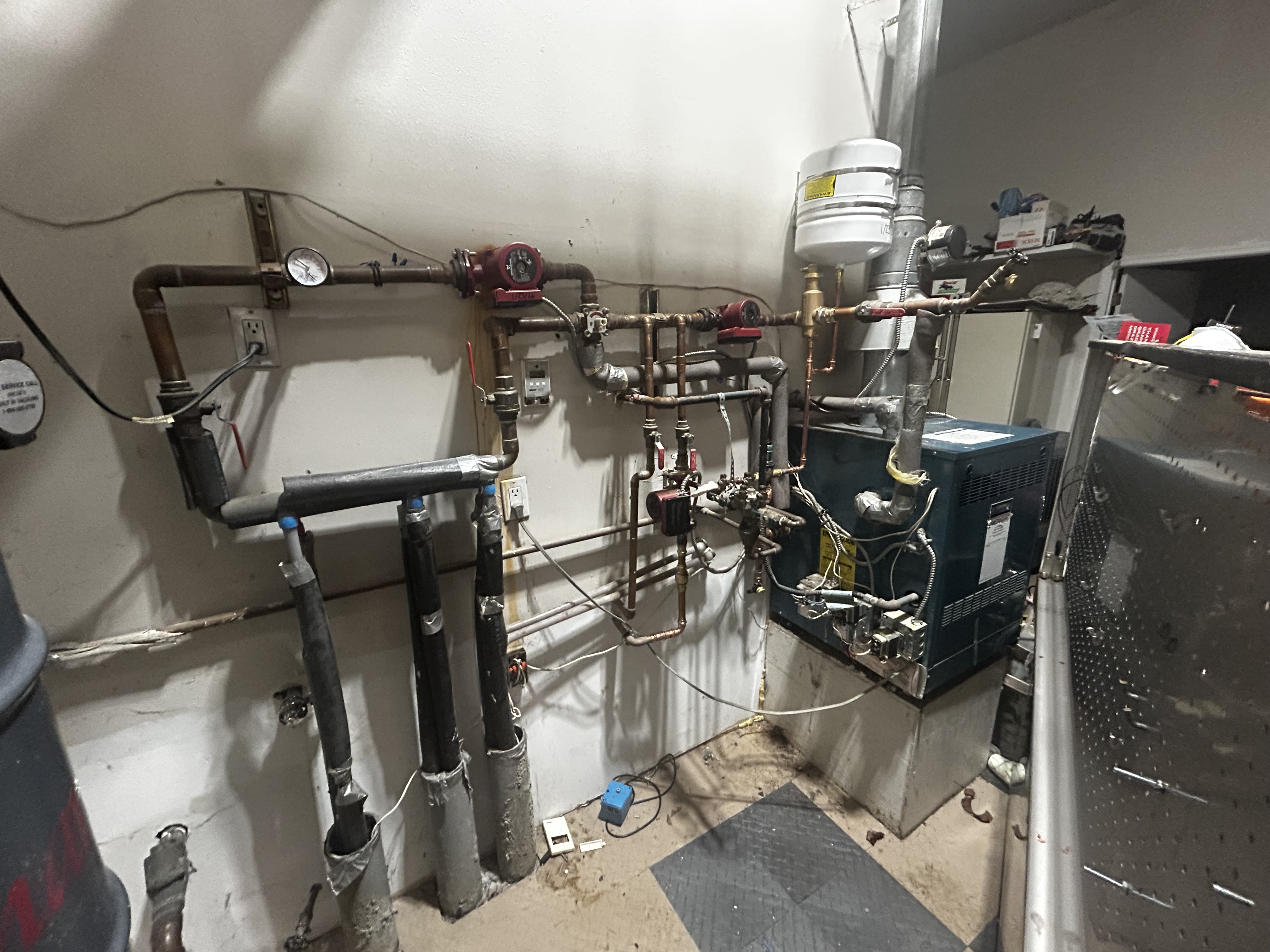

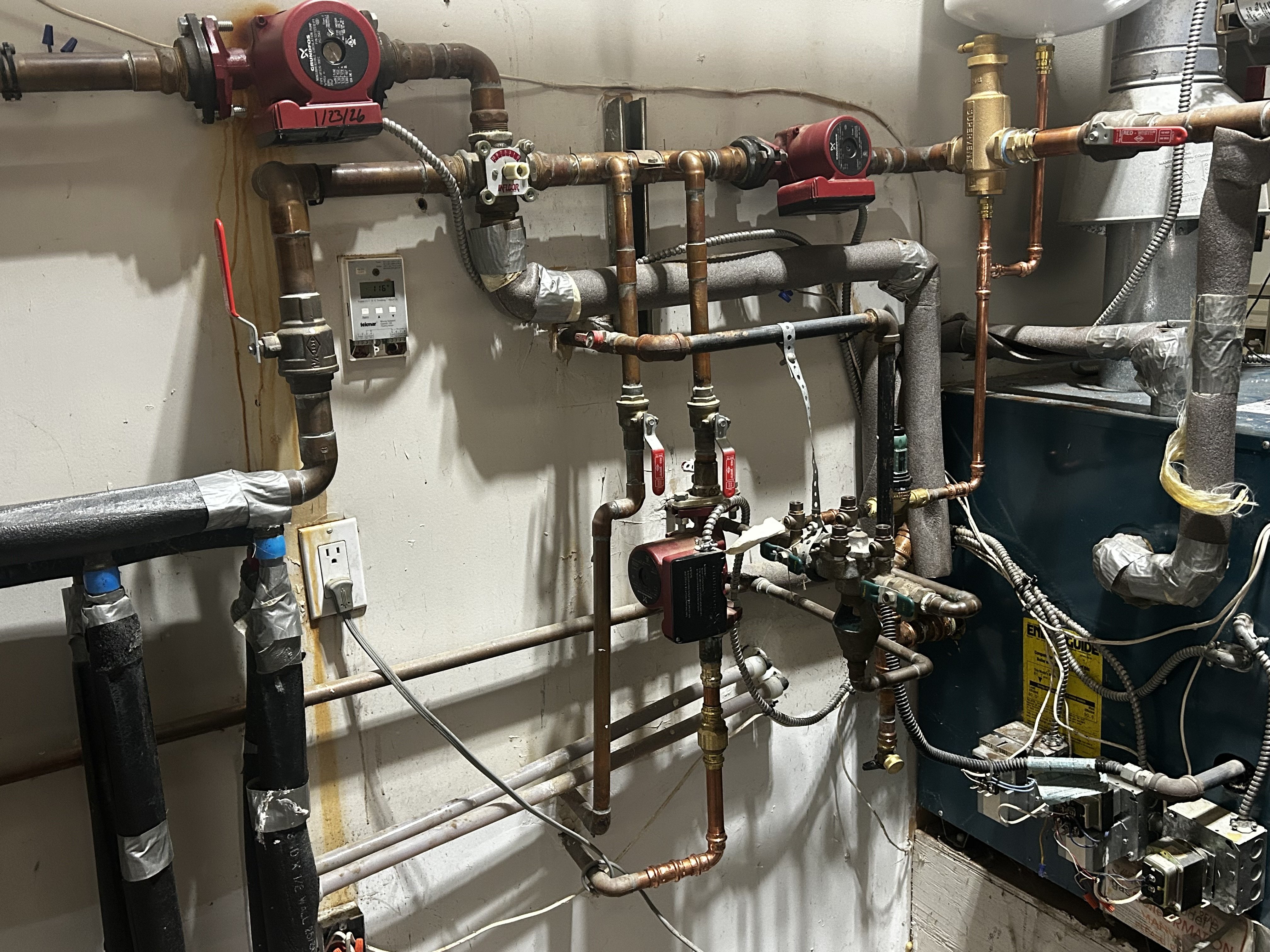

Hello. My actuator that controls the mixing valve stopped working last year, and now my mixing valve seems to get stuck when turned all the way clockwise. Instead of replacing the valve and actuator we tried to find a point where the radiant temp was 120 and leave the valve there. I was told I needed a new pump. We had a new pump installed which is now causing noise in my other pump. My temp going to the floors is now at 170. This leads me to the following questions:
  1. In this setup, should I replace the mixing valve and actuator?
  2. If I don’t replace, what should my mixing valve be set to?
  3. If the valve is all the way clockwise, will that stop sending water to my radiant pump?
  4. If the valve is all the way counter clockwise, will that be too hot for my radiant?
Thanks all. Pics attached

    Yes, the valve should rotate fairly easy. If it jams, it could ruin the actuator.
    You can operate it manually, get the boiler up to temperature, run the zone pump and adjust. This is refered to as a "dumb" mixing valve. It will not respond to the control and be able to adjust the water supply temperature.

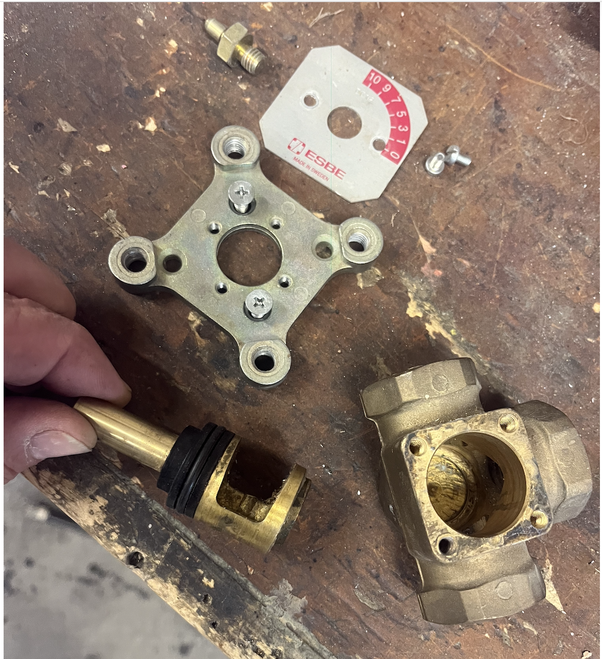

    It is a fairly simple valve under the hood, easy to disassemble. However if the rubber o-ring seal is worn or hardened, it may not last through a disassemble and reassemble. Example of a 3 port version below.
    I believe it is an ESBE valve and a repair kit, and new actuator may be available.

    @hot_rodThank you Bob. So is it the job of the actuator to adjust the mixing valve to accommodate the temperature of the water to both the floors and the domestic tank?
    Sort of. The mixing valve is to set or adjust the temperature of the circuit following it. The way it works is you have nice hot water — hot enough for the highest temperature demand in your system. But some other part (notably your floors — 170 is much too high) — needs cooler water, so you mix some of the hot source with some of the cooler returning water to get it "just right" and then send it on its way with the pump.
    hot_rod Posts: 28,705

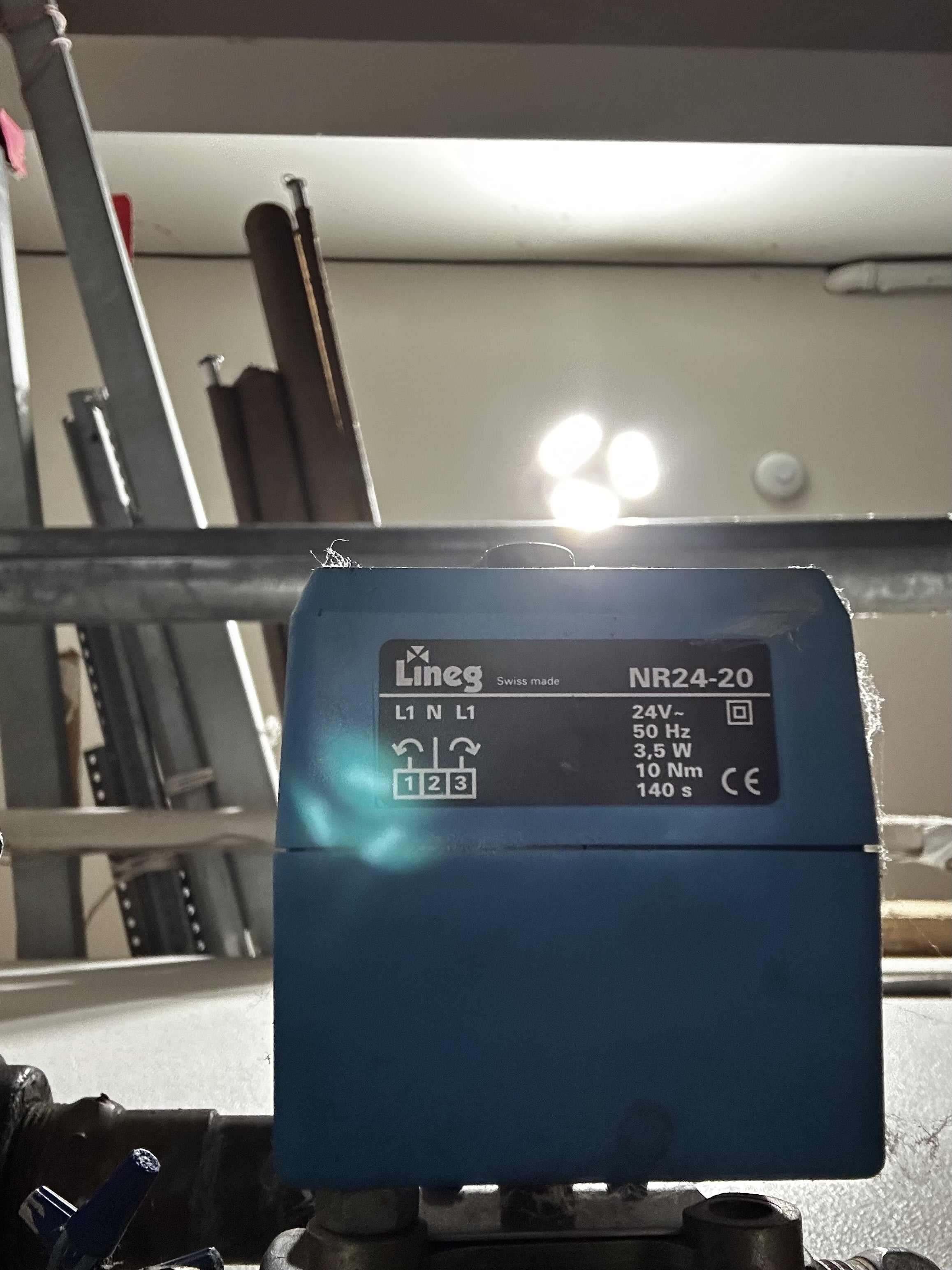

    there are 3 components to that valve. The valve, an actuator and a control. I suspect that white tekmar control was wired to the actuator?
    The valve blends down the high temperature from the boiler to a lower temperature for the radiant.
    In some cases, depending on the control it could also be protecting the boiler from too cold of return water. So it can be a dual purpose valve.
    Definitely worth getting rebuilt or replaced to get the best use of the system

    @Jamie Hall thank you. We ran out of hot water today so I thought I’d play with the valve manually while I look for somebody to replace it and the actual. When I turn the valve all the way clockwise, the pipe to the floors immediately cools down. Same thing when I turn all the way counter clockwise. @hot_rod yes the Tekmar control was connected to a blue actuator picture attached

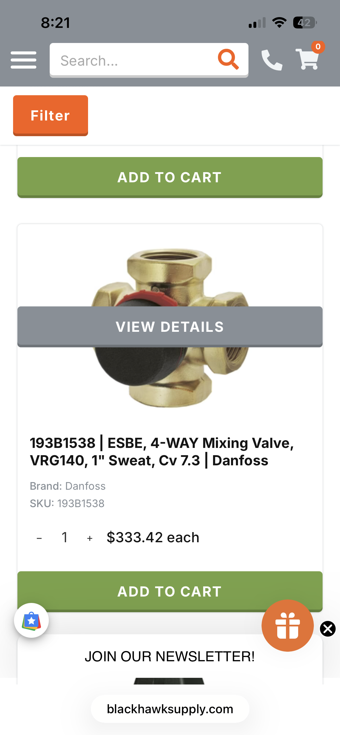

    all right folks I’m gonna attempt replacing the valve and get a new actuator and wire it up to the existing controller. Can anyone recommend where I can find the parts? It would be helpful to also get the model numbers if you are so inclined to share. Thank you so much.

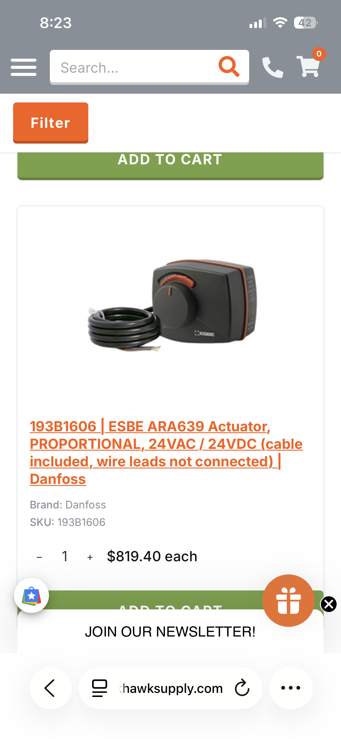

    I think it is an ESBE VRG140 if you want the identical valve, although it is probably rebuildable.
    with this actuator
    There are less expensive options, www.blackhawksupply.com has choices
    Are the actuator and controls workable ?

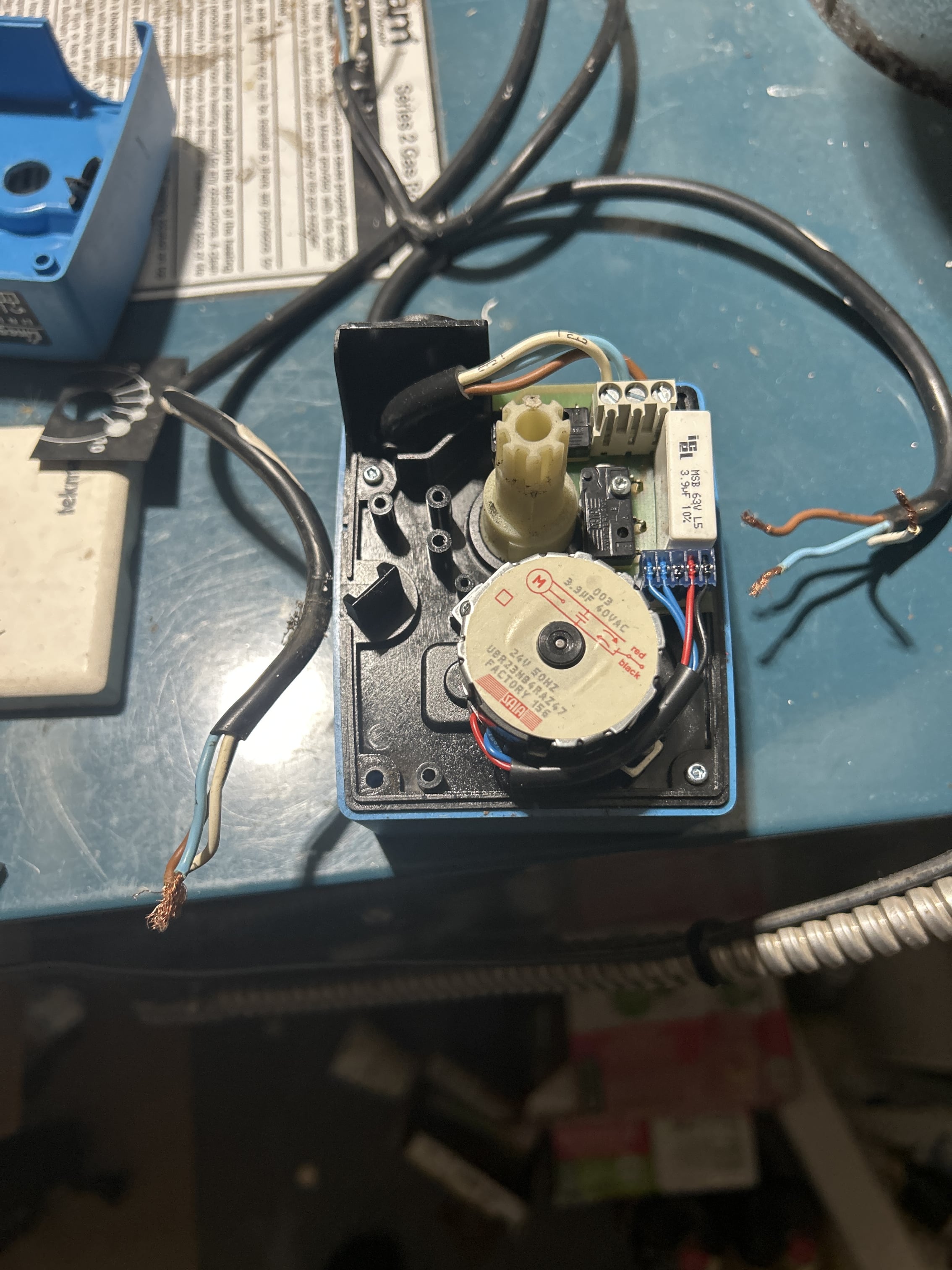

    the control board looks to be working, but how do I tell if the actuator works? I’m assuming I need to figure out how to send power to it. Here’s the inside of it.
    you could connect the actuator to the control, then warm and cool the outdoor sensor . A piece of ice on the sensor to mimic a cold weather condition
    Is it the tekmar control the runs the valve actuator? It may have a test button the runs the actuator through its control range.
