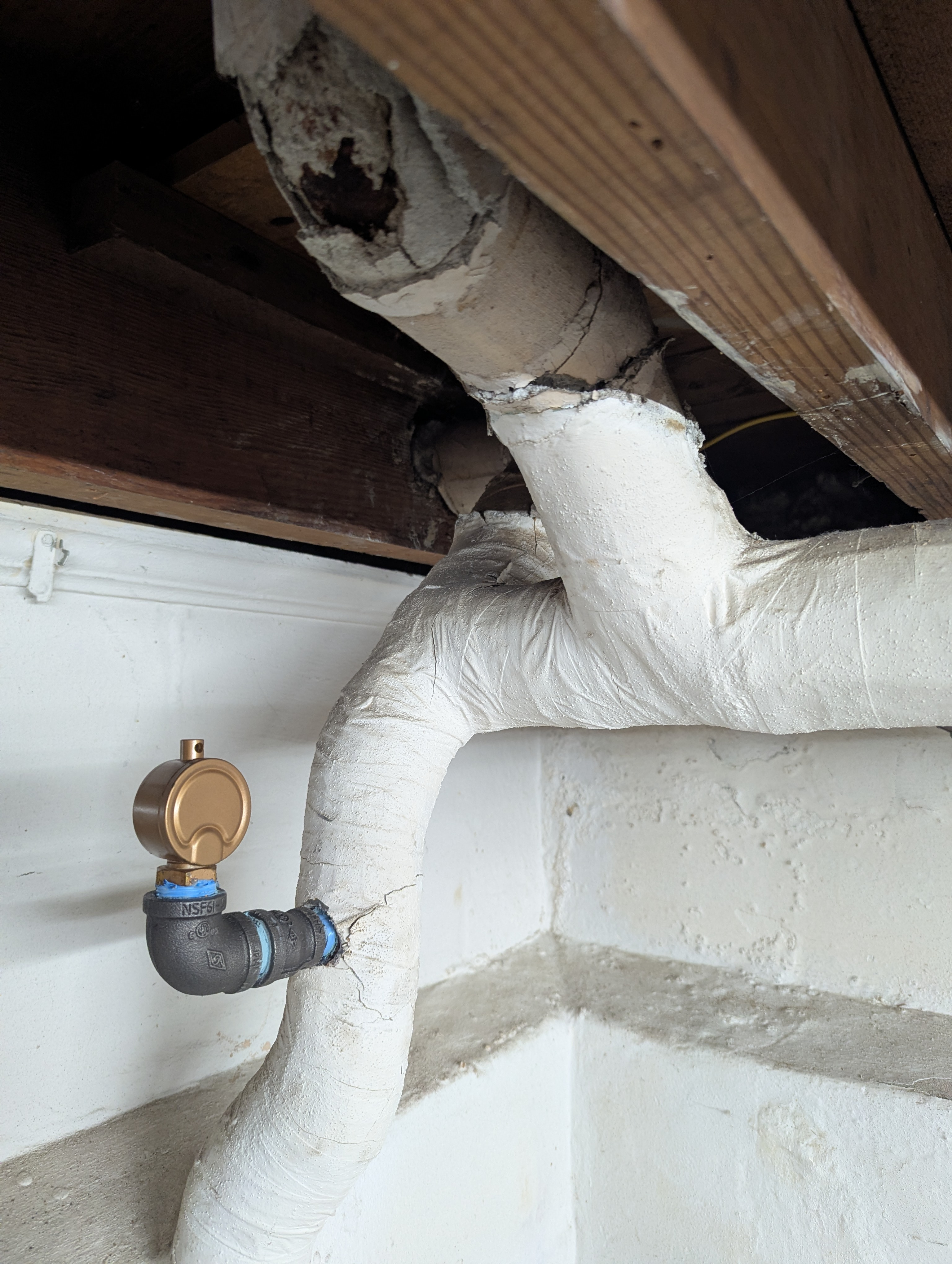

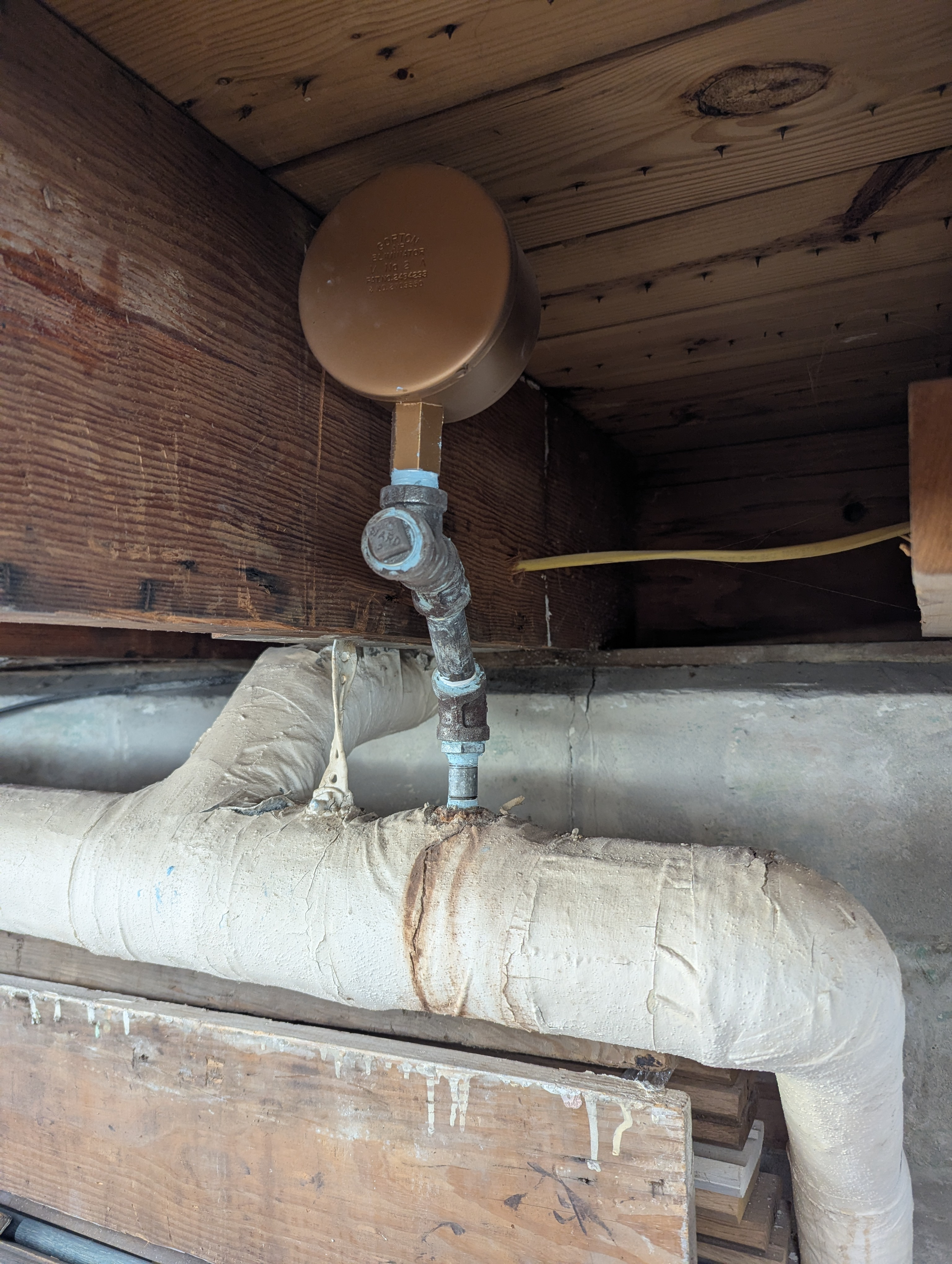

  • @dabrakeman the slope on Main 1B seems to be fine, with 1/8" per foot. Could the position of the new vents at V2 and V3 affect anything? The original tappings are on the vertical of the return just past the end of the main, whereas V1 is at the end of the main just before the return.
    V2
    V1
  • dabrakeman
    dabrakeman Posts: 1,038
    I would certainly prefer to see that Gorton #1 (V3) vent raised higher up. Where it is I could see potential for condensate getting into it. Looks like there is plenty of head room. Regarding B&K the steam is obviously preferring that path and we can speculate on the reasons but with all you can and should do is slow those radiators down.
  • Fair enough! I'd be a little nervous about it too but I wonder if breaking those 3"-to-2" reducing Tee's (guessing on size) and re-piping it properly might actually have been cheaper. You might have used less elbows, Tee's, nipples etc just going straight from the new header to the two individual mains.
    They did the right thing and used unions top and bottom of the new header(s) assembly so this still could be done relatively easily at some point. You could re-use the new fittings too.
    Food for thought down the road…..maybe during an off season. In the end would it make your system work any better? Probably not but who knows? I'm a tinkerer so this would bug me. 😁

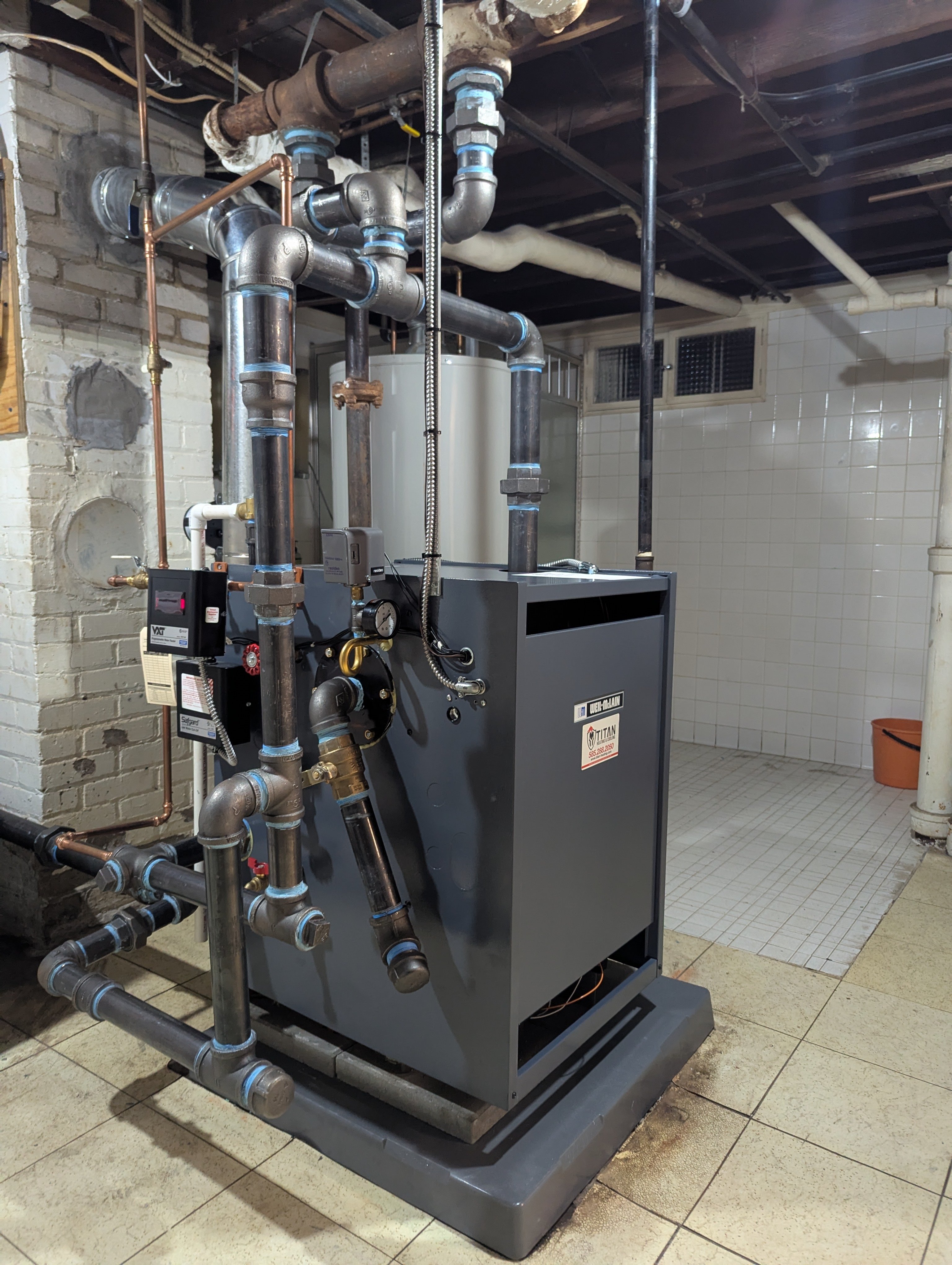

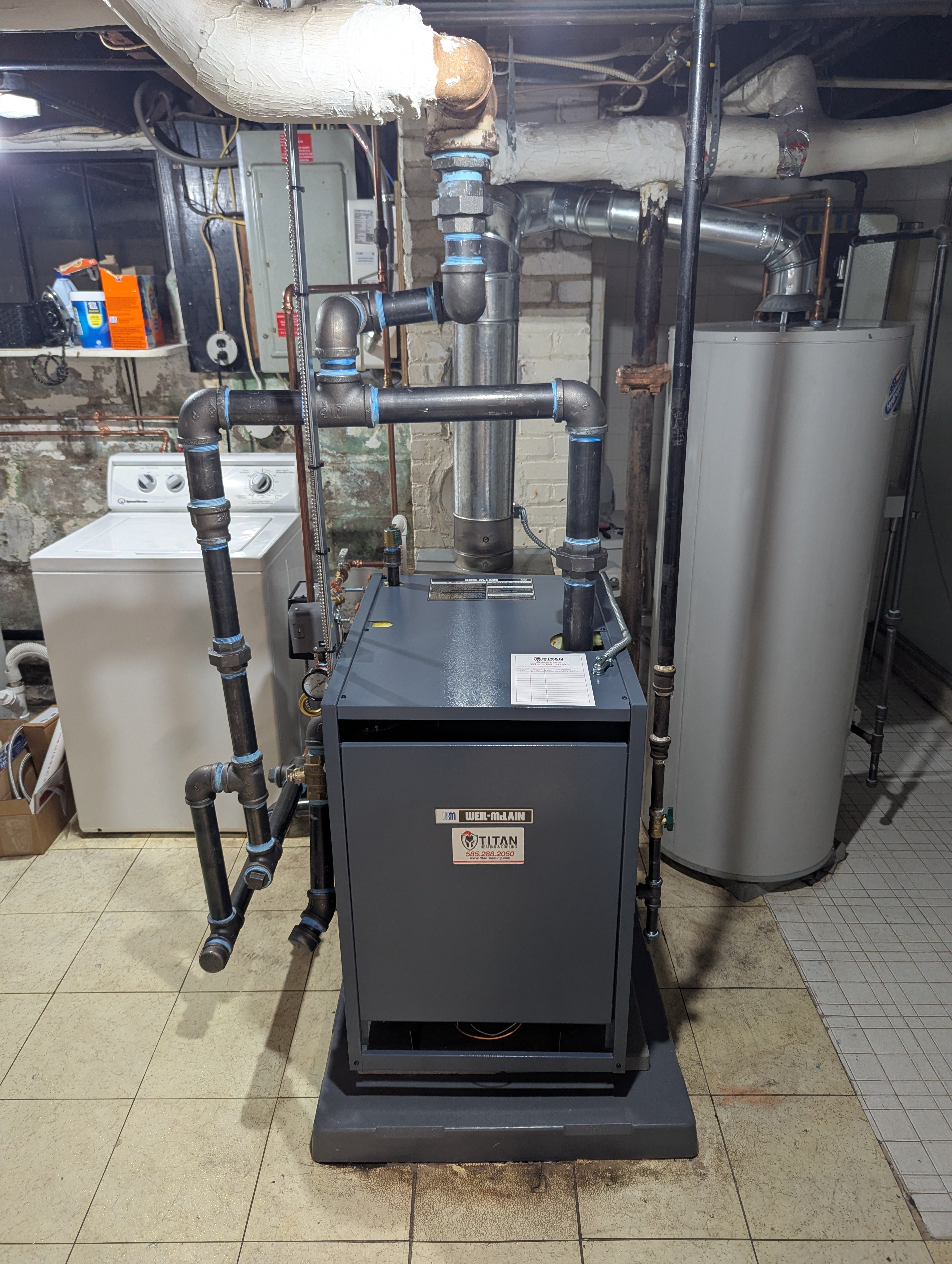

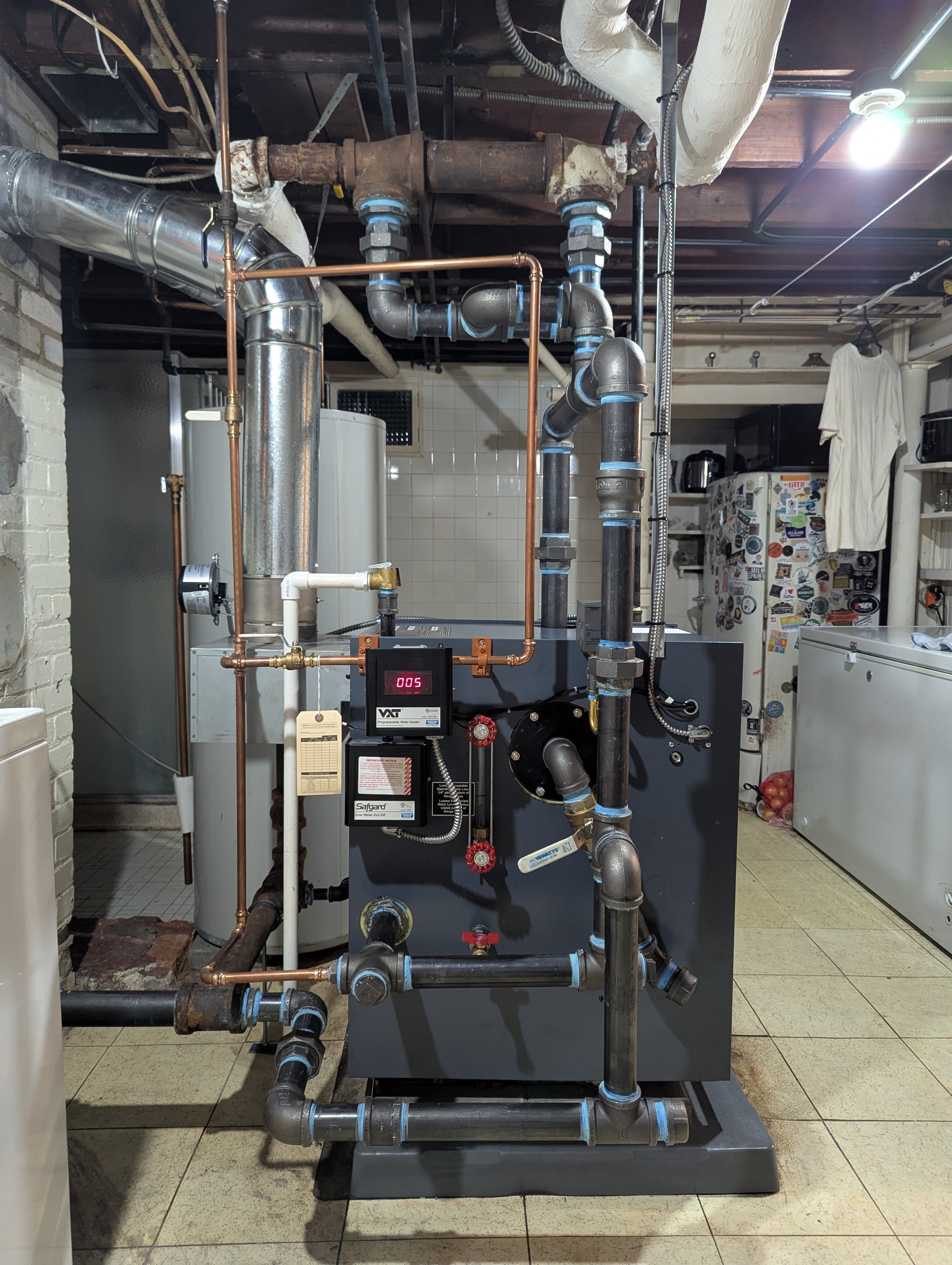

    This may help slow down the main w the most rads on it . In my experiences mains w more rads on them similar to yours and main w 1 or 2 always lag due to have a slightly more restriction due to less radiator and vents . Since you have them switch out the no 1 and no 2 location and see if there's any improvement i would also raise the one vents height as suggested . The installer could have done a better job and removed that way original header and re pped new drops i'm sure i would have but it would have costed a premium . Hard to tell from the pic but should have done a 2 /12 riser to a 3 header but thats me and it would have cost more also . Strangely enough is that a plastic pad it sitting on or some thing i have not seen and i know weils are rated for installation on combustional flooring .

  • @clammy good eyes. Yeah the equipment base is rated for relatively high het, but they still topped it with concrete pavers, refactory mortar, and a fireproof blanket. It was a field decision to accommodate the surprise the installers of the previous boiler left for them (a large hole in our floor slab with a cavity beneath. They filled the whole void with compacted stone.
