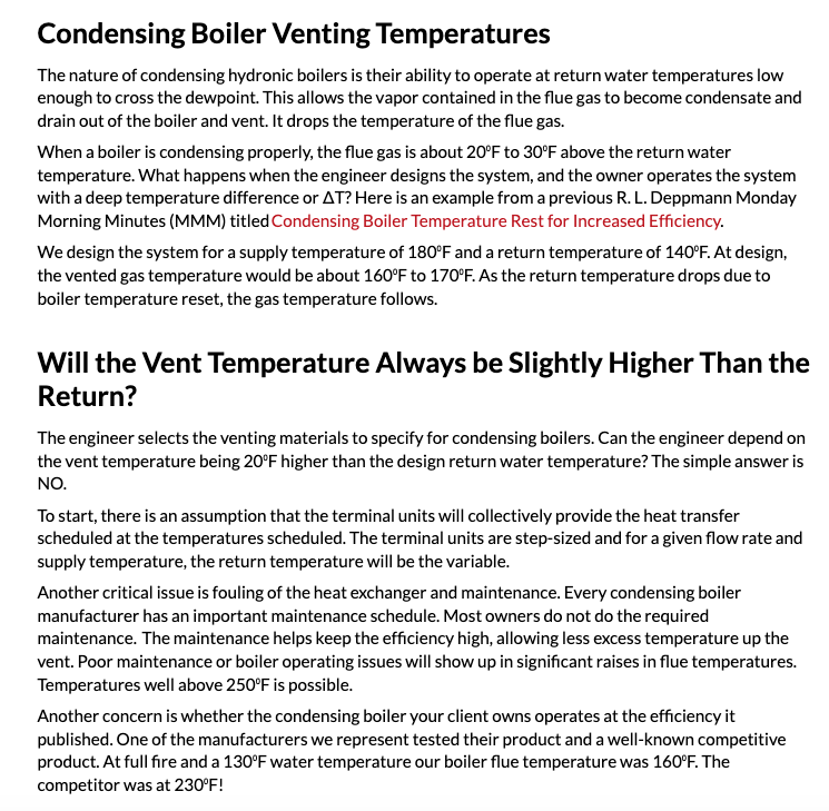

    Good info from From manufacturers rep RL Deppmann blog.
    Dirty, plugged mod con HXers are when you may start seeing yellowed, over-heated PVC vent pipe.

    I wonder if anyone reads those directions? It would certainly affect the vent material used.
