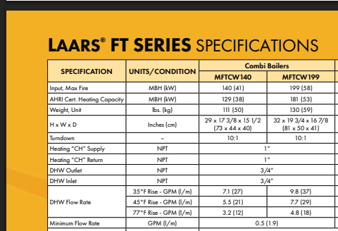

    No, you do not need to turn the taps wide open to trigger the DHW. They fire up as soon as a flow switch inside see water movement.
    The spec sheet for the particular models you are considering should give you that info. Here is a Laars example. . 5 gpm seems to be a standard flow rate across the brands.
    .5 or 1/2 gpm is a very low flow put a gallon container under your faucet if you want an idea of what a 1/2 gpm flow looks like

    depends on the unit, I've seen some that start around 0.4GPM and up to 0.7GPM
