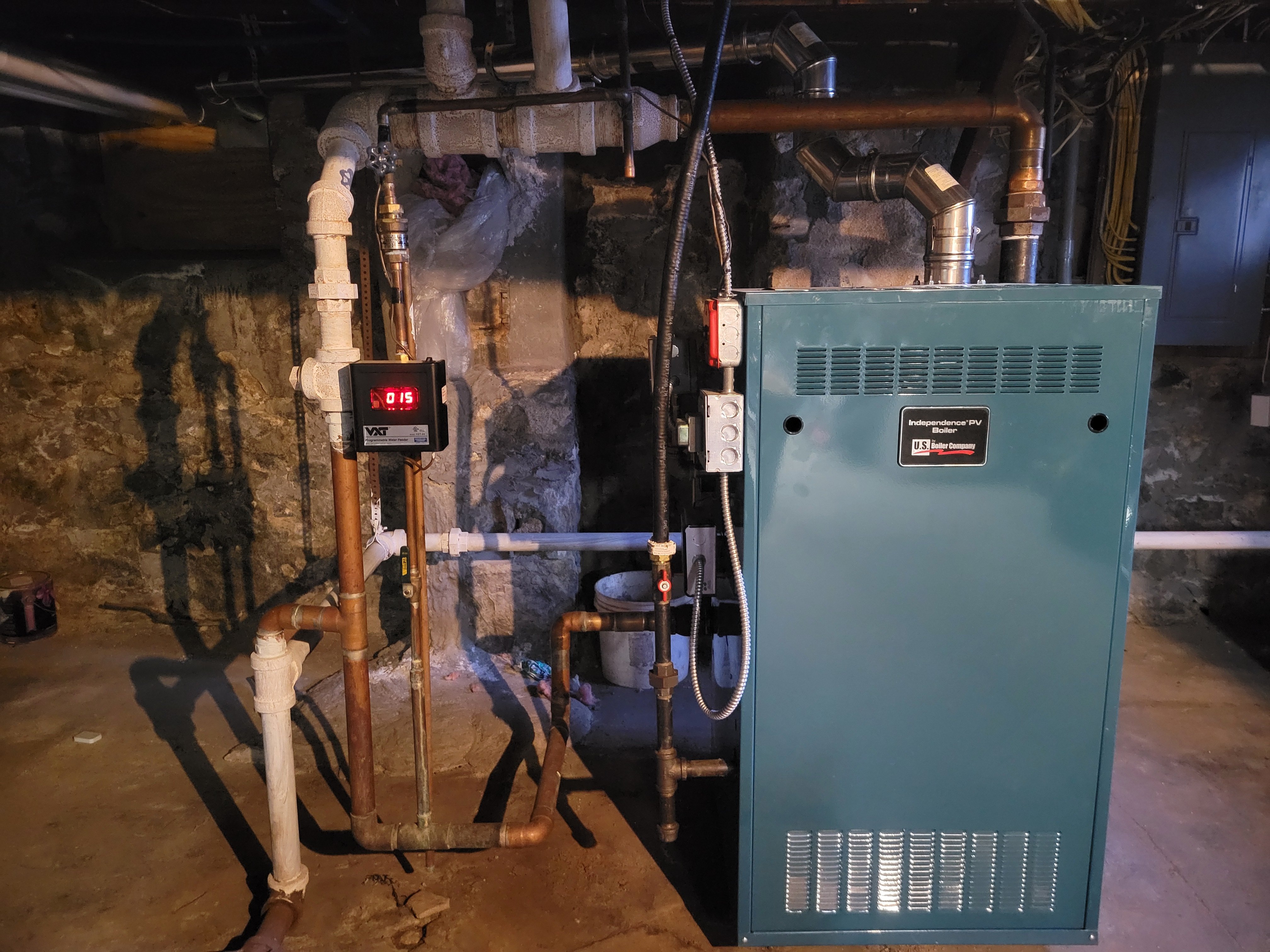

Hi folks, I'm hoping for some help getting a handle on very inconsistent heating. I have a Burnham Independence boiler, installed about a year ago. The guy was not a true steam guy and reused an existing copper header (I know, I know), but it seems to still conform to the mfg minimum height-above-waterline requirements and not an inch more (again, I know that's not great to go off waterline). It utilizes a single 2" riser off the 2" tapping with an elbow to a 2" copper header section, which subsequently expands to a 3" black pipe header section just before it hits two 2" risers to the mains, then drops to a 1.5" equalizer. Water level is quite stable in the sight glass (though occasionally i see a drop of water drop from the top of the glass within the glass itself). I have a pressuretrol set to 1.5 with a 1 diff. Pressure generally seems to be somewhere between .5 - 1psi for the most part, though it's a 0-30 so imprecise. It doesn't seem to cut out except for when it's checking water level periodically. I have two roughly equal length mains at about 60 ft ea - one running primarily through the open basement and another that is largely running through a much shorter (in height) crawlspace that gets quite warm. The mains are not insulated (again, I know). The main that runs through the crawlspace has a Gorton #2 at the end and the one that runs through the open basement has a vent antler I built, consisting of a #2 along with two #1s. Pitches seem correct on the mains (more than 1" per 20ft). The crawlspace main has a mostly dry return, and the open basement main has a wet one.
Here's where things get strange - the crawlspace main heats about 2 mins faster than the open basement main, despite the extra venting on the open basement main. Not coincidentally, I assume, those radiators generally get hot quicker than the ones on the other main. Unimpeded, they get much quicker, even at the very end of the main. I have several of them throttled back to just over a #3 setting on adjustable Vent Rites, and then the rest with Gorton #5. The primary basement main uses Gorton #4s on its respective radiators (where thermostat is) with #5s the rest of the way. At the end of that run is a room with two equal sized radiators. the one furthest presently does not get warm. the one nearest gets hot as anything. Pitch on the far radiator seems fine, as does the pitch on the riser that runs to it from the main. That riser gets extremely hot quite early and then just hits a wall and stops to a near crawl. I remove that radiator vent entirely and occasionally a puff of air comes through.
The above is just how things are going now. It seems that when I make the slightest adjustments to vent rite settings on the hot side everything starts to change. That far radiator I mentioned actually was heating up fine a few days ago - pretty much in step with the other one in the room, but I suspect it was because I had been throttling the vent rite at the other end of the house to hardly anything. Once i touched that setting (opened it only enough to start venting) the radiator at the other end of the house stopped heating. Even now, I adjusted a couple of radiators on the "hot" side of the house simultaneously - one is still heating and the other has totally stopped, despite them also being in the same room and the same vent rite setting.
All of this to say - I do something barely noticeable in one place and suddenly something in an entirely different area goes lights off. Could all of this be due to the near boiler piping being done just to minimums? Could it be uninsulated piping? Neither seems the observable culprit (e.g. boiler doesn't seem to be surging and both mains seemingly fill ok). My boiler is slightly undersized (e.g. edr sits pretty much right between the two burnham sizes (IN6 and IN7) - but only after i had shut off one of the larger radiators I didn't seem to need based on heat loss for that room (turned the vent upside down to kill it).
I realize this post is as all over the place as my heating seems to be, but i just can't seem to get a handle on what's going on and it's driving me crazy.
Happy to provide any pictures or other details that might be helpful.

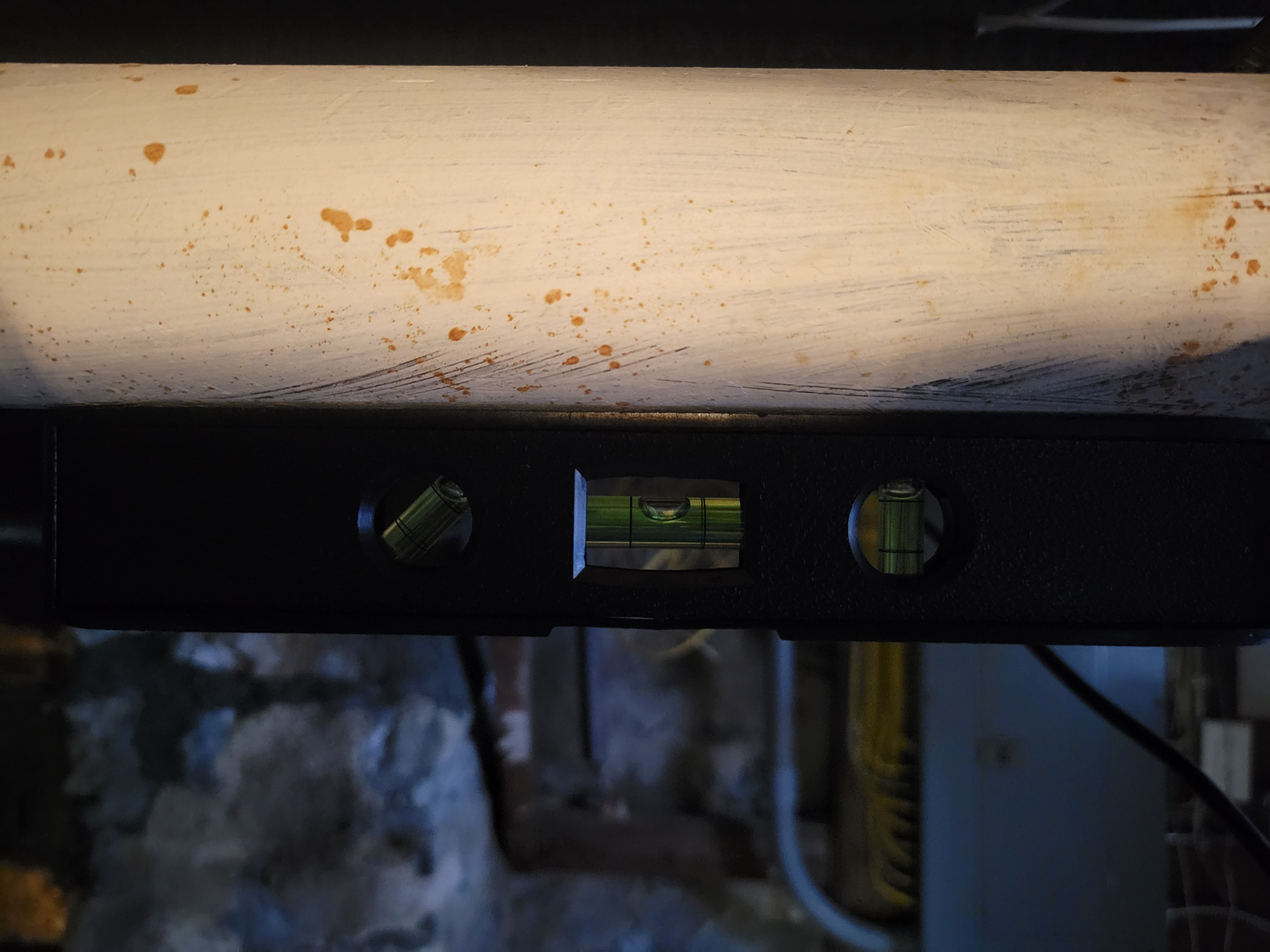

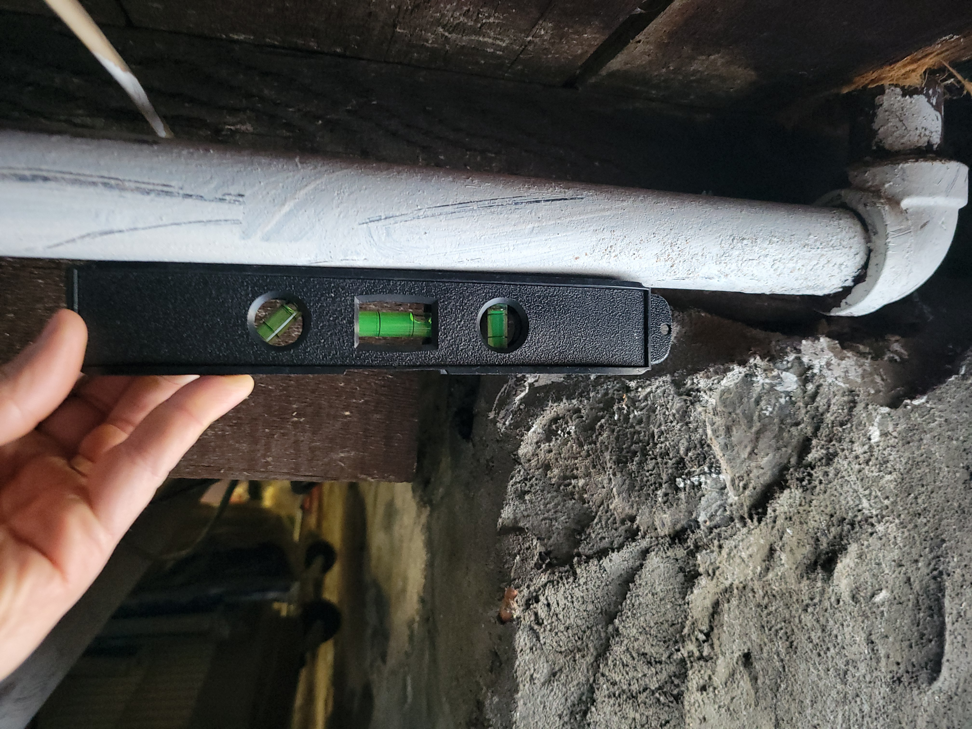

    Before doing that though I think I would be extra careful in checking the main every foot or so for pitch, with a shorter magnetic level. You have it easy since you have no insulation. If there is a puddle that could be killing the steam.

    @Captain Who at the very start of that main it is just the right side of level (image attached), but that's about as bad as it gets. This is not a particularly long level - what's the max length you'd go with? Also to note:
    1. I don't have any water hammer
    2. all the other radiators on that line heat up fine (for now, at least). and that radiator actually did heat up pretty well until i made a small adjustment elsewhere.
    3. one of the radiators on the other main, a radiator that historically has been blazing, stopped heating almost entirely when i slightly adjusted the vent rite a bit earlier today to try to balance things better with this other problematic radiator on the other main.
    I think it's the extreme volatility that's throwing me off here. I didn't think such minute changes would have such dramatic impacts - especially within the same room - but maybe i just need to sit with things for a few days and see if they find their balance?

    Let's see a picture of the near boiler piping. There's no bullhead tee arrangement or anything like that?
    I use a very short level, maybe 3 in. long and magnetized so I don't miss any puddling sections.
  • No, nothing like that. It ain't pretty but it's pretty much mfg. spec, with the exception of some missing valves on the return side.

    Why is that return so much higher than the other one? Does the waterline ever go below that?
    What is the spec for the diameter of the riser out of the boiler? Even my small Peerless 63-04L is 2-1/2 in. minimum.
    60 ft. mains are extremely long. Twice what my longest one is, and mine are fully insulated. Pretty long main to have no insulation.
    Aside, that flue vent looks very small to me, and all those bends are not proper.

    I'm confused on how your boiler pressure is averaging 0.5 to 1 psi with one radiator not even getting steam, let alone it's vent ever closing? You should be getting no pressure. Oh, you are going by that internal syphon code compliant piece of garbage 0-30 psi one? They always clog unless they are on a pigtail. It is probably giving a false reading and reacting to the temperature, not pressure.
  • @Captain Who assuming that's the case and i should be getting no pressure, that wouldn't necessarily point to any one issue, correct?
  • Captain Who
    Captain Who Posts: 883
    edited February 7
    No I wouldn't expect it to fix this particular problem but you really need a 0-3psi gauge alongside your pressuretrol teed on the same pigtail.
    If somehow it were reading correctly then that would mean there is some clog in the piping leading to your troublesome radiator, like the valve maybe, even though you believe it to be fully functional due to being new. We have to start thinking a bit outside the box maybe.

    Two 45 ft. 2 in. steam mains would have an EDR of 87 sq. ft. So if you add that you have 591 sq. ft. EDR and the boiler is good for 454. That doesn't take into account the near boiler piping either. Your header alone could add another 12 sq. ft. easily, so make that 600 sq. ft.. This doesn't factor in the uninsulated supplies to the radiators. If you had 3 ft. exposed in the basement per radiator could be another 18 sq. ft. there, so say 625 sq. ft. total EDR.
