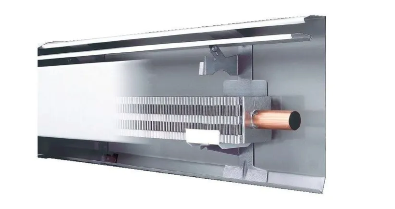

It is more likely that you have a hot water system. Can you tell us what kind of radiators you have on the third floor? Baseboard made of copper tubing with aluminum fins?

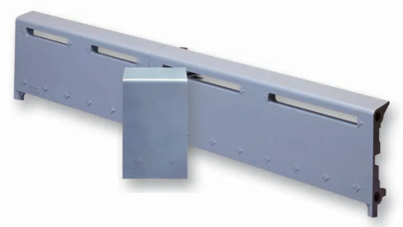

Baseboard made of cast iron?

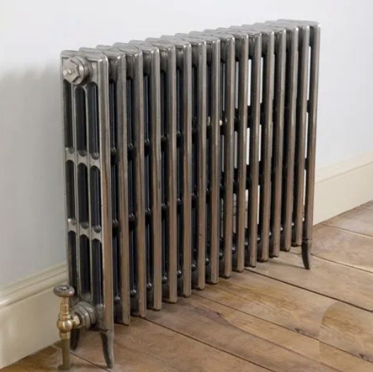

Old cast iron standing radiator(s)
If the pressure is too low and you can't vent the air out of the radiator or purge the baseboard then you will not get heat in that radiator. For cast iron like this one, remove the air by opening up the air vent until water comes out and you will solve the problem. You need enough pressure on the boiler in order to get the water up that high. We called that filling and venting the system when I was an apprentice. If you have the copper tube with aluminum fin like the top picture, that is done with a purge valve in the basement.

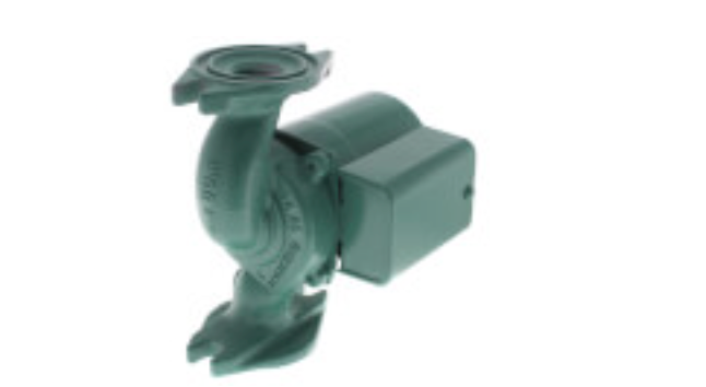

- Does your heating boiler have a pump connected to the pipes, that moves the water into and out of the boiler?
