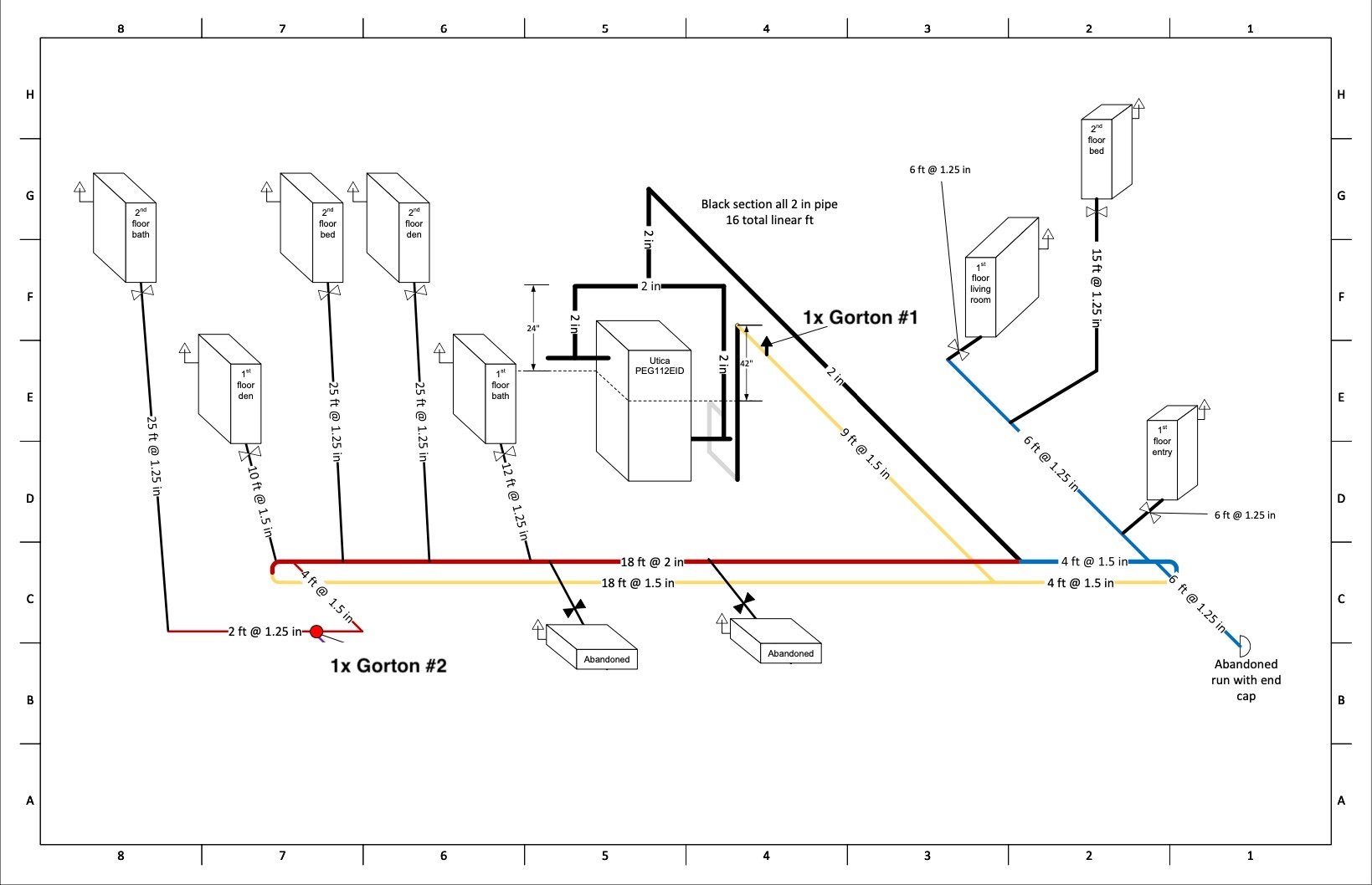

Overview
1930s home in the Detroit area with a single pipe steam system with all new Gorton main and radiator vents sized correctly from my calculations. My main issue is I want to stop the leaks in my system so I don't have to use so much make up water (~once per week). I have checked my boiler for leaks by overfilling and did not notice any water dripping, so I would like to rule that out. I am also aware that vents fail etc and that the problems most likely relate to pipe pitch. I just want to express/define my issues and get actionable feed back on what I can do now to resolve them and determine if any vents need replacing.
Issues
  1. Leaking mains: My video below (@~19m mark) shows my #1 leaking. I have since replaced this with another #1 and it looks ok for now. My #2 (@21m:30s mark) still hisses during operation. I don't know if this vent has failed open because it hisses a bit but it does not drip water at all like my #1 did.
  2. Cold panting/wheezing 2nd floor bath rad: (7m:30s mark I discuss this). The piping in my laundry room where my #2 is has a bunch of stupid turns (my diagram below is simplified) and is likely sagging at a union before the rise takes up to the 2nd floor. I believe the hissing #2 and the sagging/pooling related to issues #1 above.
  3. Hissing rad vents: My 1st floor living room and 1st floor entry way have slight to moderate hissing during operation.
Given the information here please recommend a few steps I can take short term to alleviate the above issues, and help me identify what (if any) vents are in need of replacement.

    Thank you @Captain Who I attempted to put my phone screen near the vent and I believe it did fog up somewhat. I just don't know what constitutes what is an 'acceptable' amount. The radiator does fully heat up, like screaming hot and will hold heat, if that means anything. For the sake of argument, lets say the vent has a leak. Let's walk backwards and address why it has this issue before I decided to replace it.
    Concerning the main venting, yes my #1 has the correct piping. The #2 however does not have enough spacing above the pipes to lift it up more than the current 90deg elbow before it hits the 1st floor subfloor. The #2 sits at the end of the long 'red' main with 2 x 90 deg turns before the main vent so it's ok at best, but not as bad as the above example.

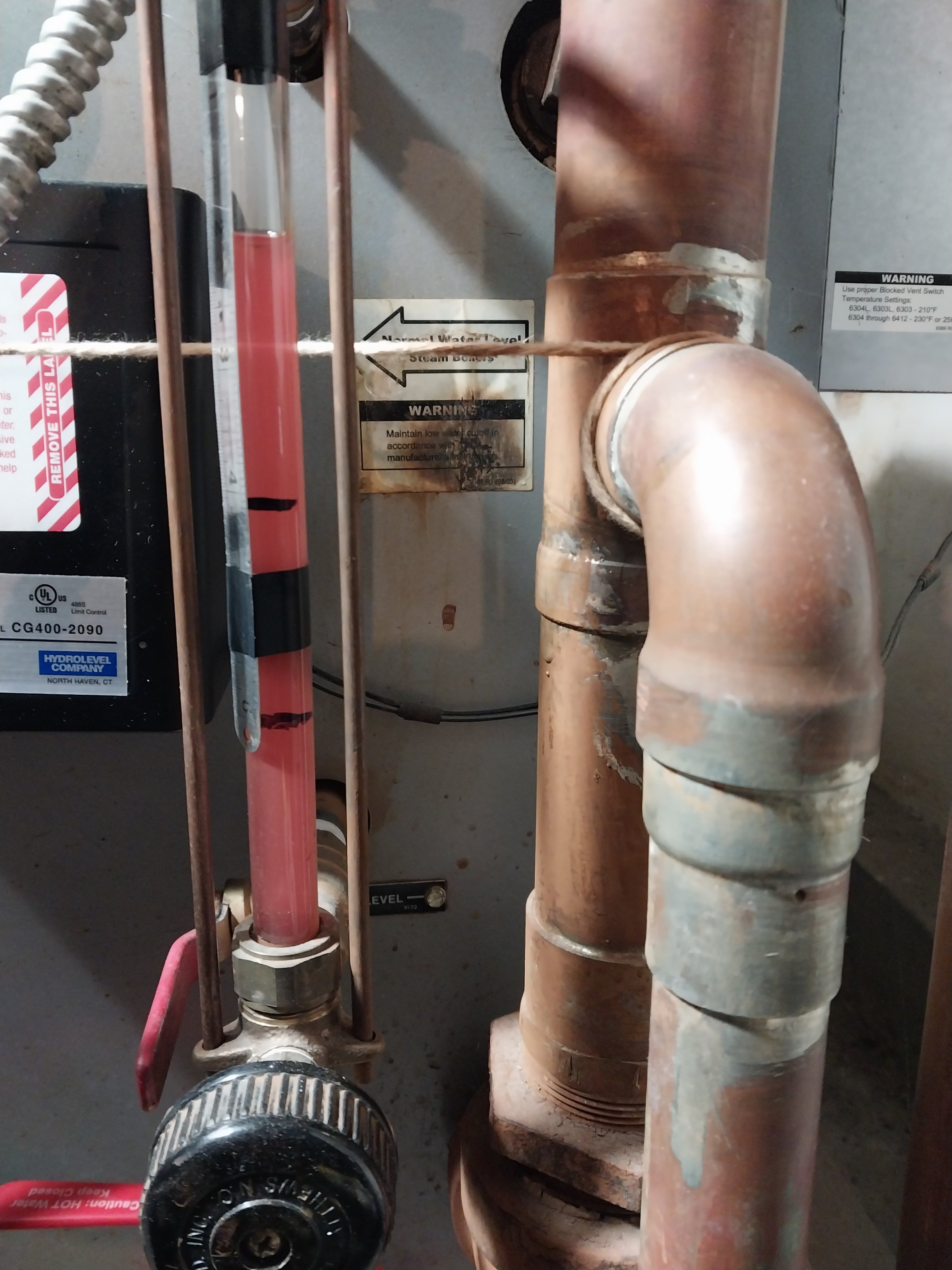

    You can simply tape a 6 in. engineering scale to your sight glass like this and keep a small notebook next to the boiler. Do daily checks and jot down the reading. Also jot down when you add and how much. Of course you have to have a place to add to do that. I have some stainless steel nipples and a tee between the boiler and the Pressure Relief Valve that I can open a ball valve, stick a funnel in and add.

    @ Captain Who - I aspire one day to have as clean a boiler water as that. Also another post season planned task. May I ask……what do the 2 magic marker lines above and below the tape represent. Does that have to do with the return being slightly higher than ideal ( I believe you have indicated that before).
  • Captain Who
    Captain Who Member Posts: 741
    I actually had to think for a bit about the identity of those two lines. The one above the tape is as far as you can drain the boiler by the return drain valve through the High Hartford Loop. The lower one is how far the boiler water has to be drained to trip the LWCO to shut off the boiler.

    your no 1 (near the boiler) is junk.
    your no 2 should shut off the hissing at some point. it could indicate it's failed open OR that it's still releasing air from the system. (in which case you should add another vent next to it)
    double check that your pressuretrol indeed shots down the boiler at 1.75psi (as it seems now in the video). this "precision" is OK for such a crude device.
    your mains are so well insulated (keeping basement cold) that a small amount of condensation from vents might be inevitable.
    panting in your 2nd floor bathroom is from the pipe not being insulated running through your cold basement.
    Day_Tripper

    Maybe I mentioned it before, don't remember, but I personally would not vent back at the boiler in your situation. You could move the #1 (a working one) out to either the junction or the end of the abandoned 6ft section. No need to wait for steam to fill the long return. Your radiators off the short main would then have total takeoffs of ~ 6, 27ft and 18ft which isn't much different than the takeoffs off the long main after the Gorton #2 would close of 27, 10, 25, 25 and 12ft. The Gorton#1 currently may be having issues dealing with both the steam and all that condensate.
    Doesn't sound to me like your makeup water is exceptionally high but if a main is not closing completely then that will contribute a lot and as mentioned each and every radiator vent needs to be inspected with mirror after steam has reached the vent to verify complete closure within seconds.

    To reiterate for everyone that skimmed my post or didn't want to watch a 40 min video.
    My #1 has been replaced and no longer leaks.
    I'm not going to move the placement of my main vent any time soon, and I won't use the abandoned run area because it's not accessible.
    I took some time in the last few days to repitch my radiators and strap a sagging pipe.
    The hissing has all but stopped. The cold radiator in my 2nd story bathroom is working better now but still not getting as hot as I'd like, likely due to @patrykrebisz observation that the pipe is at the end of a long run and not insulated. I'll deal with this later.
    I don't have a meter or a way to accurately quantify my water usage so let's all end that side bar. Whatever it was, the situation is now way better.
