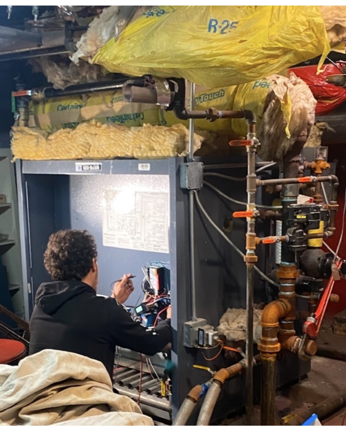

I have a Weil McLain Lbg about 900,000 btu. At Weil mc lains recommendation last year I used Sentinel x 100, the amount the tech told me to use , 3/4 gallon totally messed up the system. The return glass would jump way up and down then overfill the boiler to the top! And heat was uneven. Maybe the tech was just wrong and told me too much to use . I flushed the boiler many many times to remove the x100. What do I use for an anti corrosion treatment? It’s Chicago city water. What about 8way? Or just less X100? Thank you.

    "Return glass"? Is this a steam boiler? A quick search on Sentinel X100 revealed to me that it isn't for steam boilers, so you definitely don't want to use that product again if that is what you are using it in. I use 8-way very successfully in my one pipe steam system.

    wow , the tech at Weil McLain knew I have steam. I talked with him 10 x. Yes the boiler would go low as the product backed up the pipes with I guess foam , water would not return . Water fill would go on . After 5 hours boiler was full to top!! Quite a nightmare . About what do I need for a Weil mc lain Lbg steam , 975,000 btu? A cup ? A gallon ?

    LGB-8?, LGB-9? LGB-10? What is the water capacity of the boiler? Rectorseal 8-way instructions tell you how much to put in based upon, IIRC, both radiation capacity of the boiler and gallons. IIRC it will be about 1.2 oz. per gallon but don't quote me on that. I'm using more like 2 oz. per gallon but I seem to have some unusual situation with lots of carbonic acid because that is producing pH 10.0 for me after a few days of operation. You will probably be best off using a smaller amount according to Rectorseal instructions.

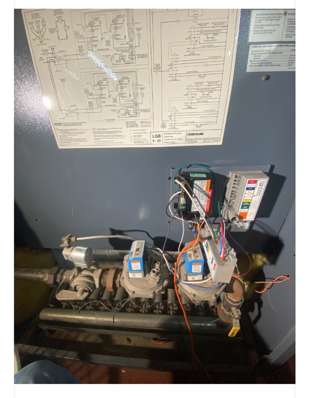

    it’s a Lbg 6/23, I do not know how much water it takes ,

    Yes, but there is no LGB 6-23. They probably had a range of boilers they were referring to at the time: LGB 6 through LGB 23. You need to find the proper placard and take a well focused photo of that for us.

    I’m not at the building today , I don’t have better photos . It’s about 975,000 Btu and maybe 30 gallon if I remember. Yes I will find out first . I ordered the 8 way from Amazon just now . Thank you
