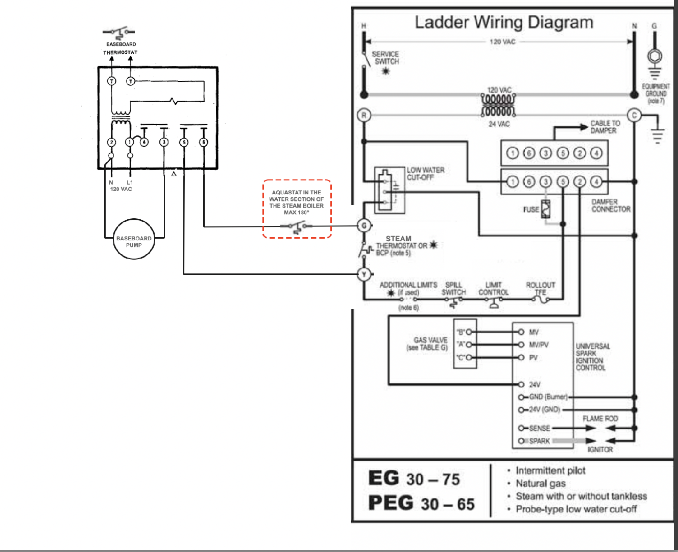

    You want to see if you have wiring like this:
    I am not sure what steam boiler you have but the thermostat wires are all that you need to look at. in this boiler the thermostat gets connected to Y and G on the boiler wiring diagram. the thermostat for the steam heated area should be connected to Y and G as indicated in the instructions.
    The thermostat for the hot water setion should be connected to something that will operate the circulator pump and have an extra set of contacts that can turn on the boiler. The important part is the Red Box. That is a water temperature control commonly called an aquastat. Set that temperature at 180° or lower and the baseboard thermostat can not make steam. The aquastat will stop the burner at 180° and will never make steam. Only the main thermostat can make steam.

    @DRG100 said "When it's below 20 degrees (outside) both day and night in spite of the thermostat programing the steam zone is at 4 to 6 degrees above programing and the baseboard is at 68."
    This is a concern. Perhaps the aquastat is not set properly or is not connected properly. It does sound like the steam boiler is operating off of the hot water thermostat and making steam if the steam heated areas are above the thermostat set point. Check to see if you have a circulator relay and if that relay turns on the burner and if the aquastat will shut off the burner by turning the temperature down on the aquastat. Do this test with the steam thermostat turned off or all the way down to the lowest setting.

    Boiler is Burnham Independence. There is an auto fill. Shortly after it was replaced I replaced the thermostats with WI-FI ones. The one for the hot water zone required a new wire run. The "new" addition was added in 1969 and the electrician used Romex. I replaced with thermostat wire (I was an electronic engineer for 27 years). I kept the same connections except the addition of the +24V. The thermostat connects to a terminal strip in a Taco Box. There is another pair of wires leaving the "Taco Box" going to an electrical box outside of the boiler with a transformer (+24V step down?). I do not intend to poke around in the high voltage areas!
    There is no loop around the boiler. Looks like all of the hot water plumping is connected below the boiler water line. I can provide photos on request.
    I always believed that the hot water thermostat should operate the circulator pump only and let the aquastat control the boiler water temp with the steam thermostat overriding when needed.
