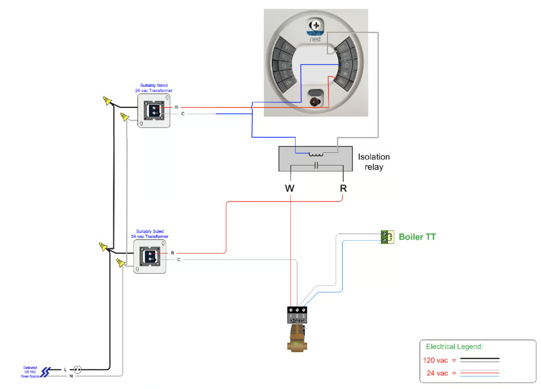

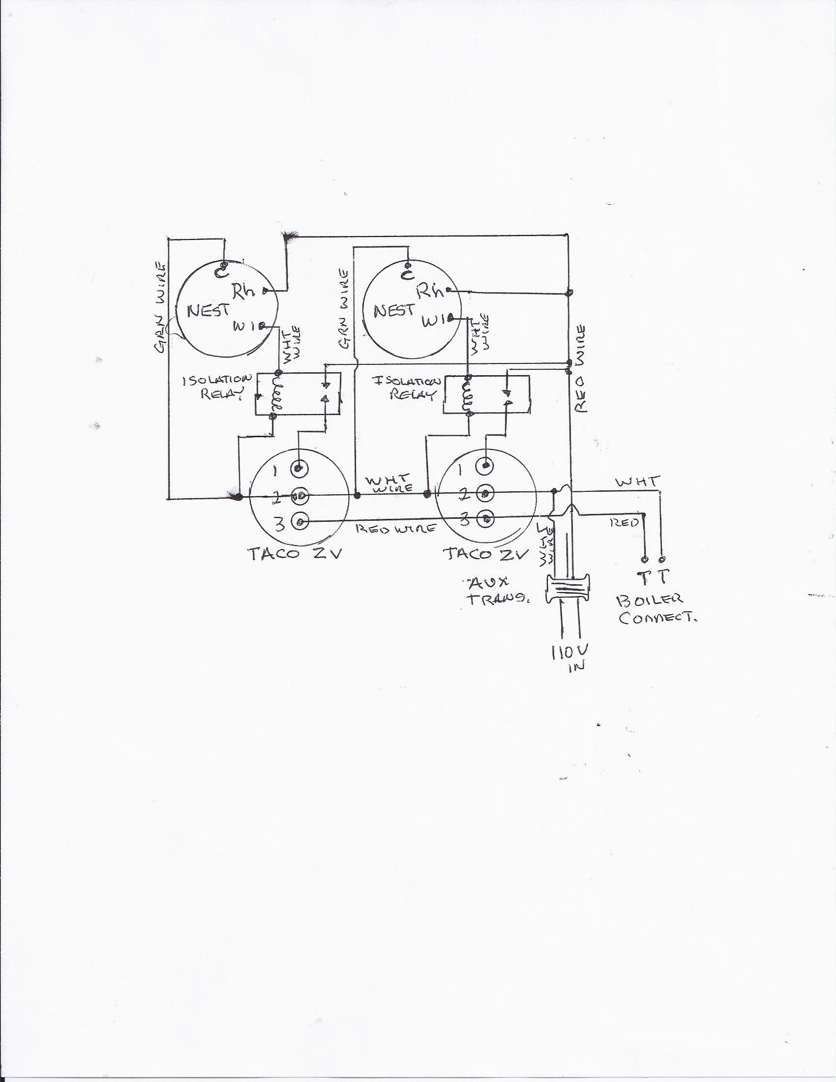

    @sre92 , This may help. Forget the Nest designation. This is a 3 wire setup to the Ecobee.
    sre92
  • HomerJSmith
    HomerJSmith Posts: 2,837
    edited February 2
    @sre92 -If you are going to use more than one ecobee, with @EdTheHeaterMan recommendation for a isolation relay, using a SP/DT fan center will not work. You will need two isolation relays for two ecobees & one transformer. If you only have two thermostat conductors to you current thermostat, you will need a special wiring diagram unless you can pull a new three conductor thermostat wire.

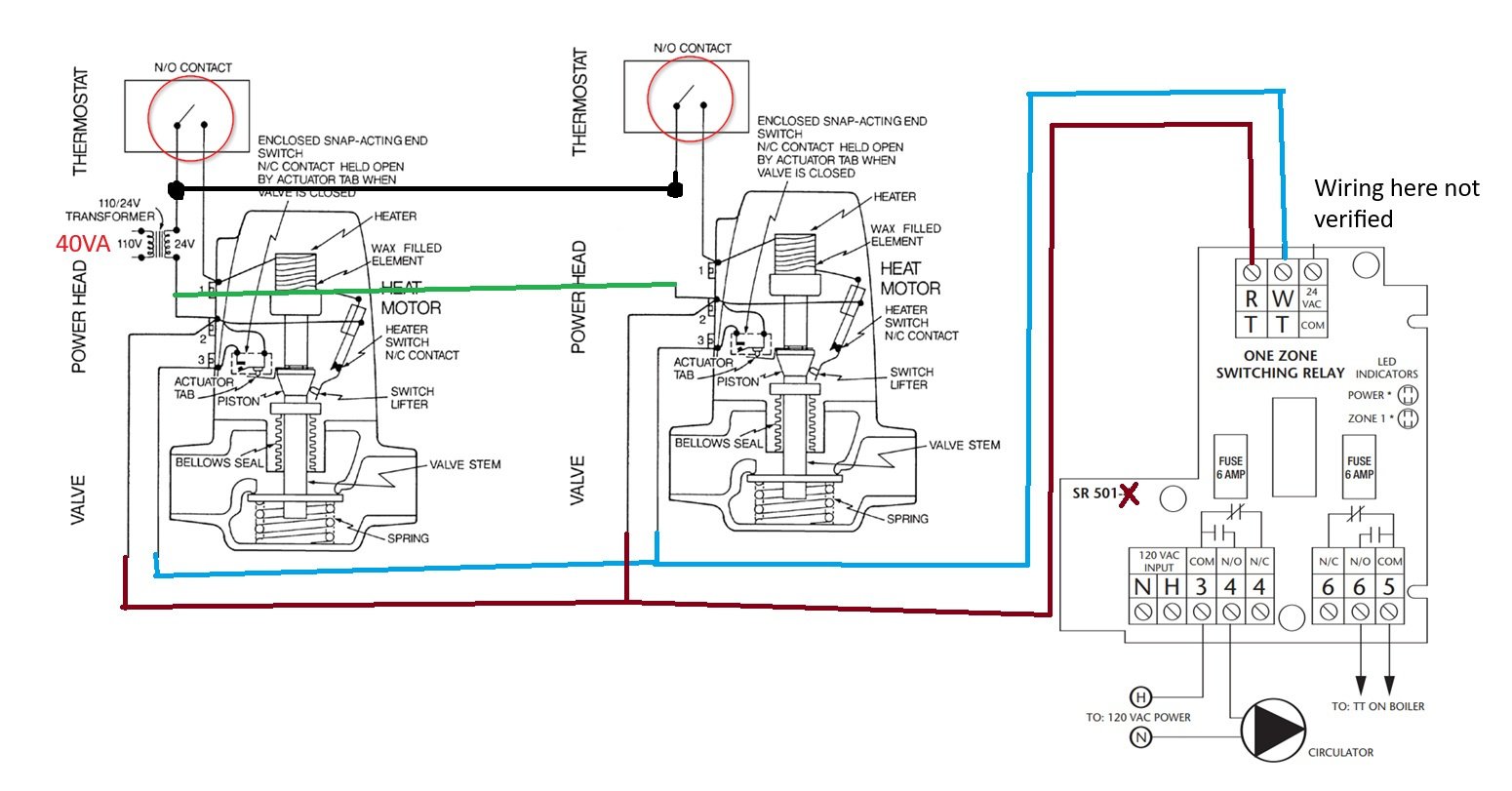

    Here's a better diagram of what is going on as it exists. Definitely some spaghetti… I didn't open the lid on the SR501 so I'm doing some assumption, but the end switches on the two 570s are tied together so that either can turn on the single zone switching relay.
    I can picture wiring with a transformer/relay as you and HomerJSmith describe. It would add to the spaghetti, but only cost ~$35 vs ~$180 for the 5-zone 80VA Taco ZVC405-5.
    EdTheHeaterMan Posts: 13,027
    This will work with 2 Taco 570 Zone valves. You might be pushing it with three Taco 570 valves on a 40 VA transformer.
