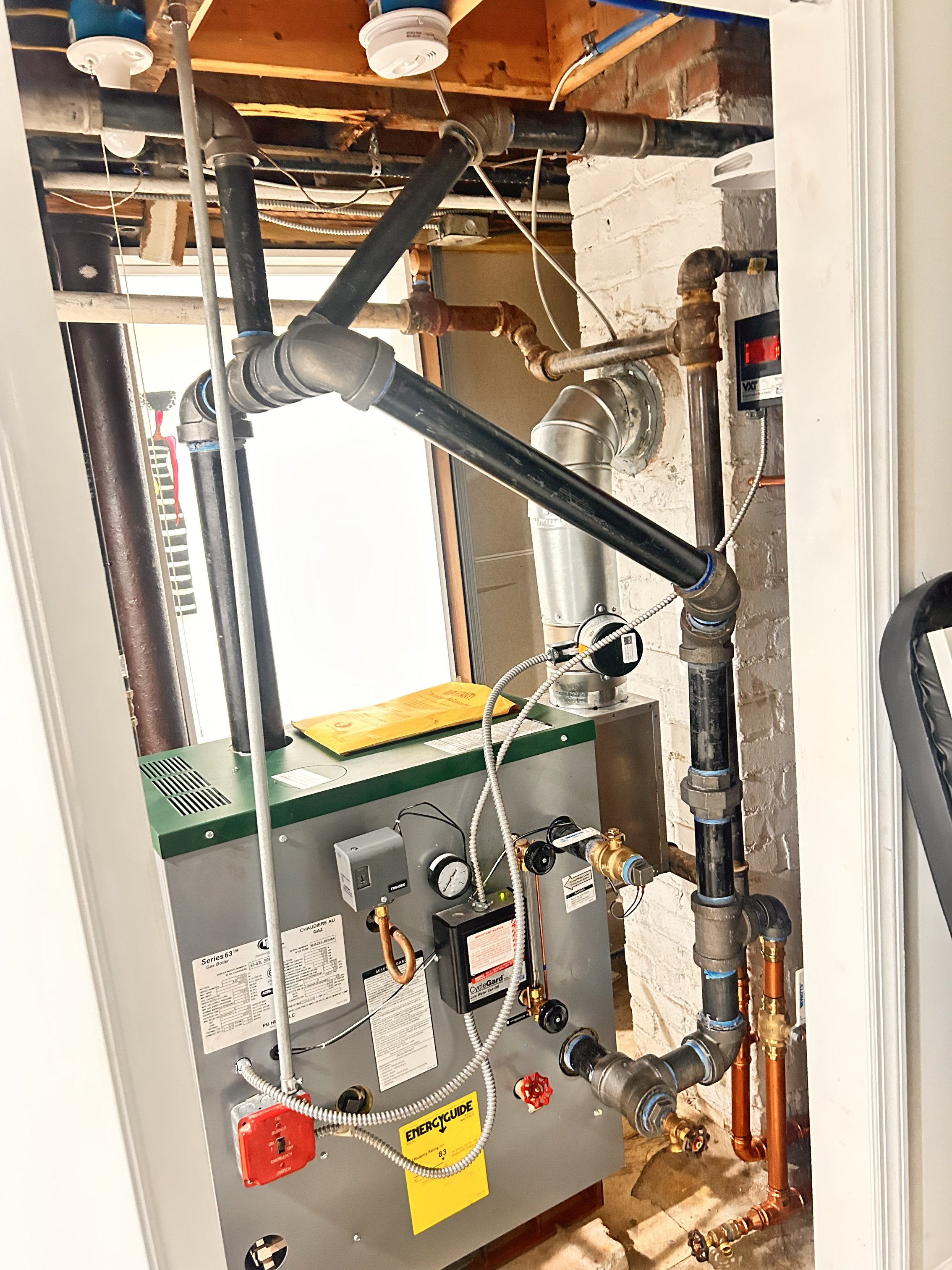

My main concern is the near-boiler piping layout:
In many steam boiler diagrams/photos (and what I expected from the manual), I don’t usually see this kind of diagonal piping arrangement coming off the header area.
Is diagonal near-boiler piping normal/standard, or could it cause issues (wet steam, water carryover, uneven heat, noisy system, or just for resale, etc.)?

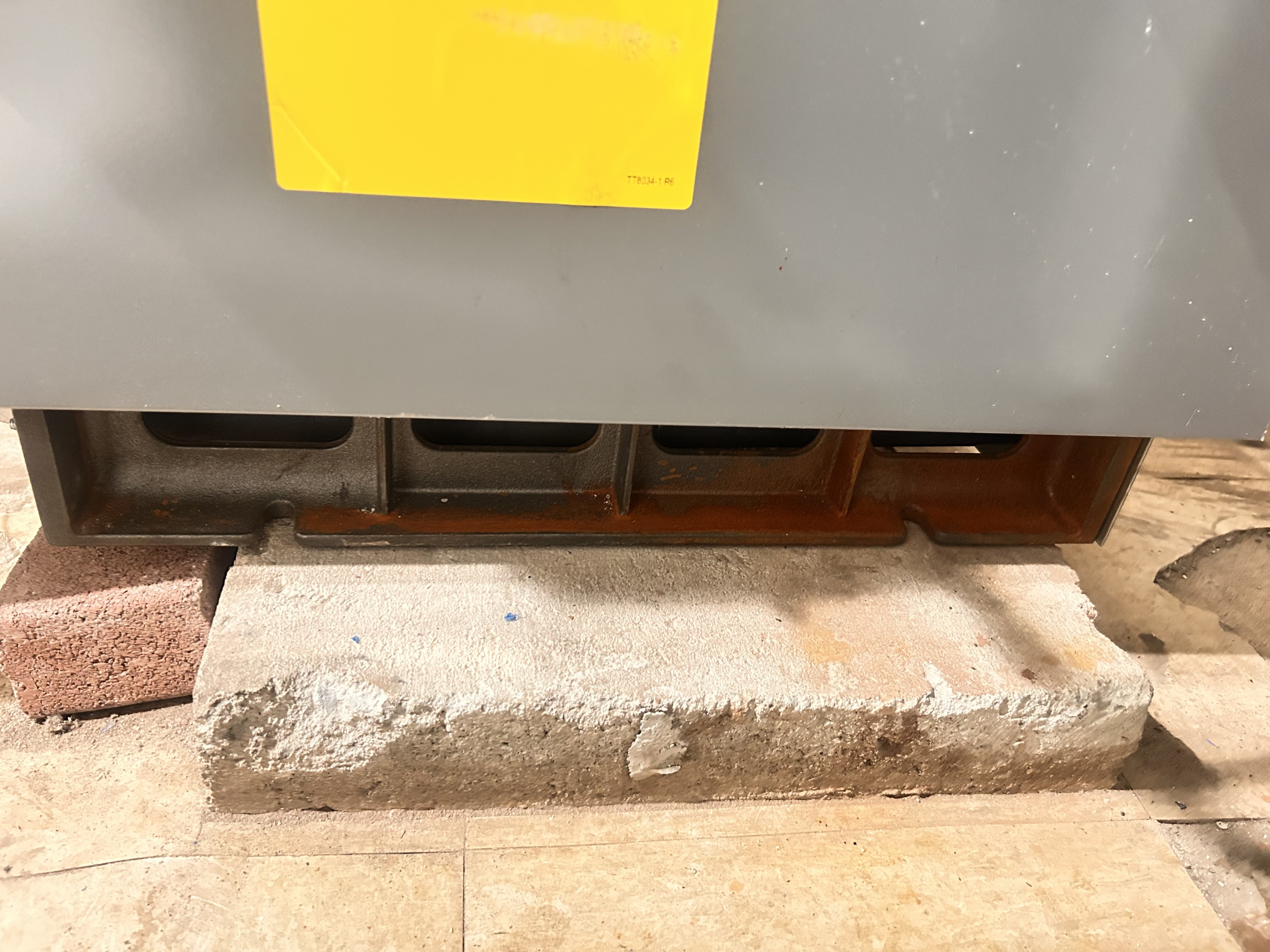

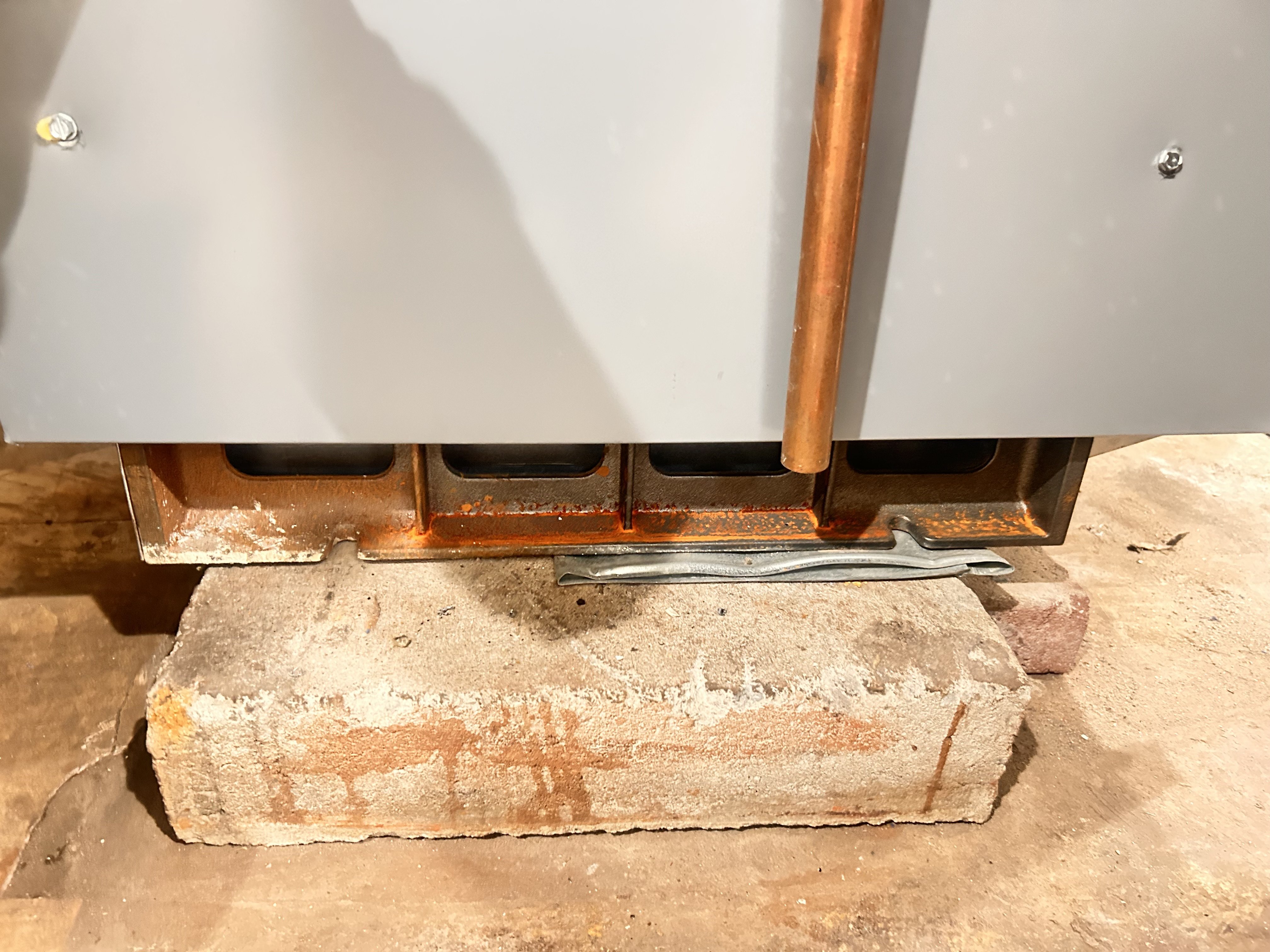

Also: I noticed rusting near the bottom/base area, and it looks like there may be a thin metal shim/plate under the boiler for leveling. It almost looks folded (not like a solid shim). Is that acceptable practice or something to be concerned about?

    That is fine. Not the most solid, perfect block foundation for under the boiler perhaps, but it's not going anywhere.
    They left a nice skim tapping setup on there, did they run washing soda through it and skim it in their mad rush to finish?
    I like this install very much although it appears that the two mains hook together above the water line which is Not Good™ if that is indeed the case

    looks like hartford loop is too high, do you have your manual ?

    most manuals read 2 inch below normal water line, and I've see 6 below water line,
    if it's not misbehaving, don't fix it,

    HL could be the camera angle. Otherwise the conduit is crooked and needs to be supported within 3' of the switch box but I am nit picking.
    I don't care for the looks of the diagonal equalizer but it will work ok. Why use a 90 and 2 45s when 2 90s would have done it if they had the right nipples.

    So when that single main vent closes are both your mains steam hot past the last radiator (one of course would be)? If so, I guess no worries but they. The two mains should be vented separately and then drop down below water line and connect.

    Top of Hartford Loop Close Nipple is supposed to be 2 to 4 in. below the Normal Water Level. Also, the equalizer is supposed to be 1-1/4 in.

    The pipes at a 45 instead of horizontal and vertical is preferable, you won't get water collecting in the pipe on a 45. The returns connecting above the water line is a problem and looks like it was that way with the old boiler, unless we are missing something about where those pipes go.
    the equalizer being bigger than the minimum in the manual isn't a problem.
    Is this a 1 pipe system?
    The collection of leftover masonry products under the boiler could cause too much secondary air if this boiler is designed to be installed only on a solid surface and is relying on the floor to close off the bottom of the boiler.
    ethicalpaul Posts: 9,076
    I would love to see a combustion test of this scenario to see if this actually matters. It's not exactly a controlled combustion air intake under these boilers, and the manufacturers surely know that everybody puts their boilers up on blocks. This one looks roughly like every other one I've seen on this site and in person.

    blocks are fine. blocks of different sized with huge gaps or open cores that haven't been filled are not. most likely the effect of too much secondary air is going to be more heat going up then vent than should be.
