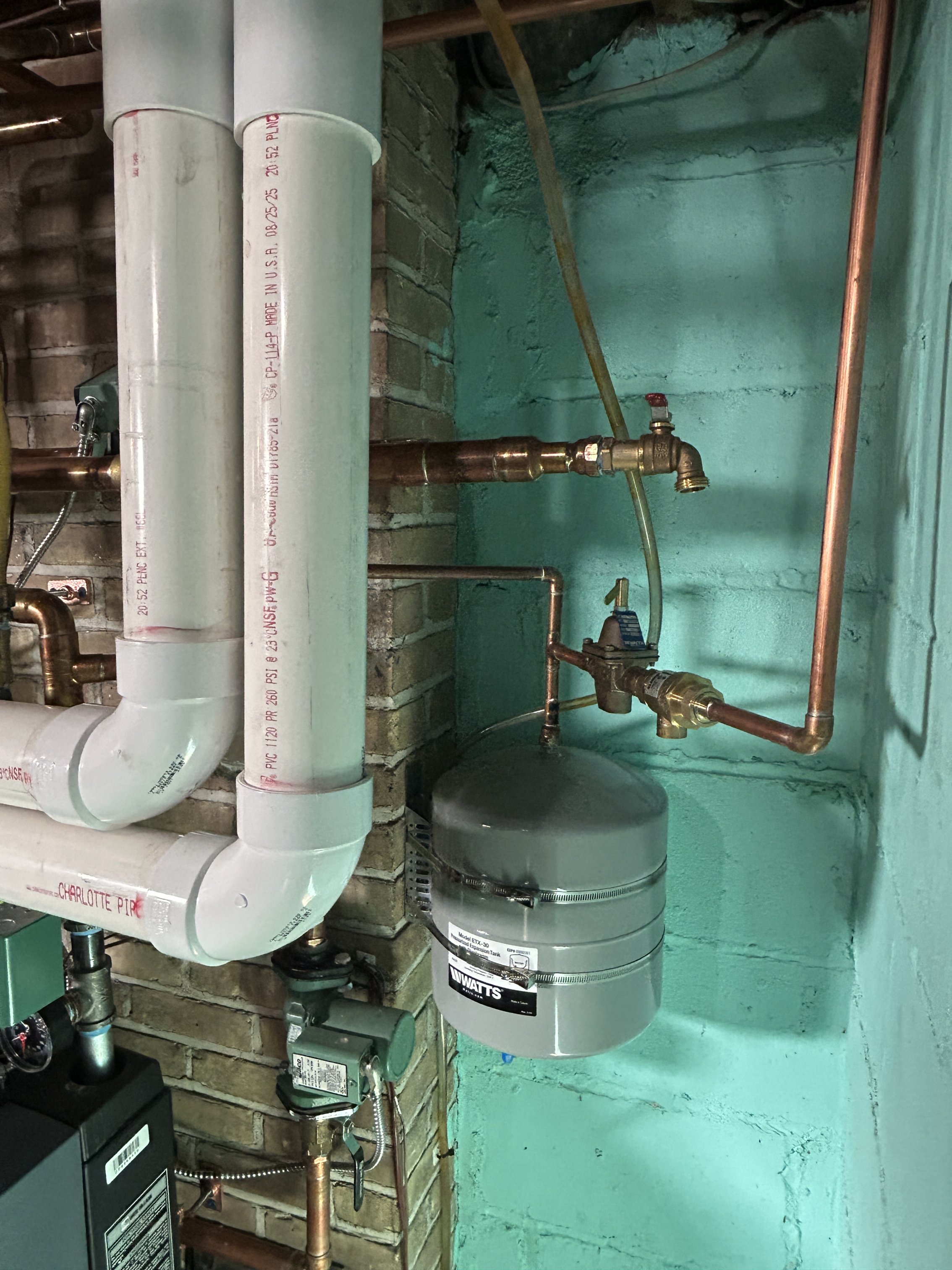

Hey guys. Plumber here, but I replaced my boiler about 6 weeks ago after doing a lot of research and asking several questions on this site.
Problem I seem to be having is I can't bleed the air out and on further thought I think I might be pulling air into the system through the seperator.
I followed installation instructions to the best of my understanding and was careful on my layout, but I might have a negative air issue near the seperator and system pump. I'm attaching some photos here so you guys can see my set up and would appreciate any direction as to tests I can do to be sure or how I might adjust things so it operates properly.
Also since you won't be able to tell from the picture there is 17" between the seperator and the system pump.
Also, system pump is a 0015e3. I had it set to medium most of the last month but had since changed to low to see if that didn't pull as hard. Seem to have same issue.
Also, if I did anything else stupid please point it out! Thanks in advance!

    Well now, you can't pull air in if your expansion tank is reasonably close to the INLET of the main circlation pump, and if the system pressure — and tank precharge — is adequate (probably around 15 psig cold).
    So… where is the expansion tank in relation to the system pump — I can't make it out in the pictures — and what is the system cold pressure?

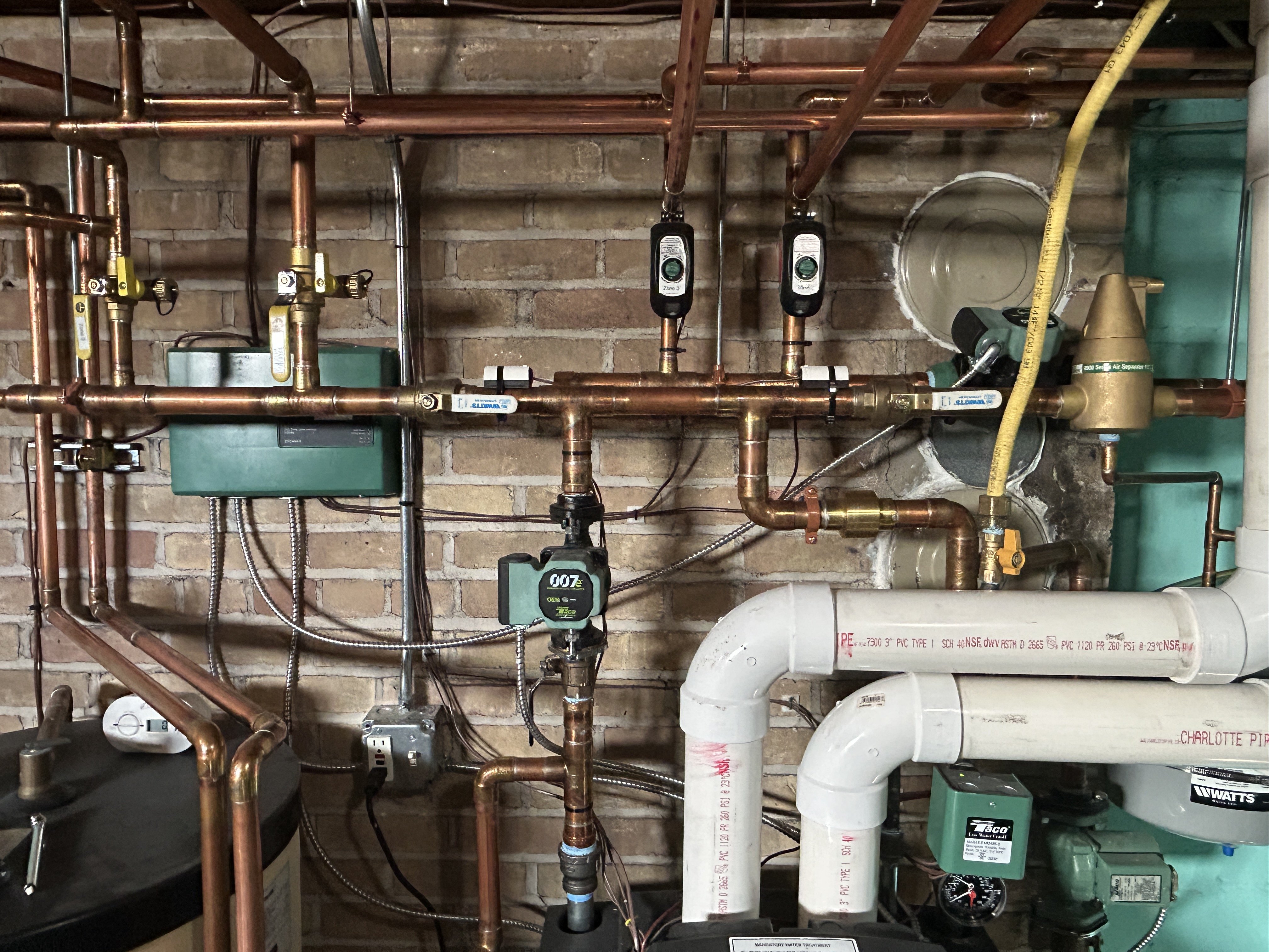

    The circulator is mounted wrong, but the piping appears to be correct. If you are keeping the correct pressure in the system, it's impossible for it to be pulling air in. Sounds like a proper purge is in order, but I don't see a purge station or even a way to do that aside from the auto-fill which isn't always adequate. Hopefully there are some high point vents?

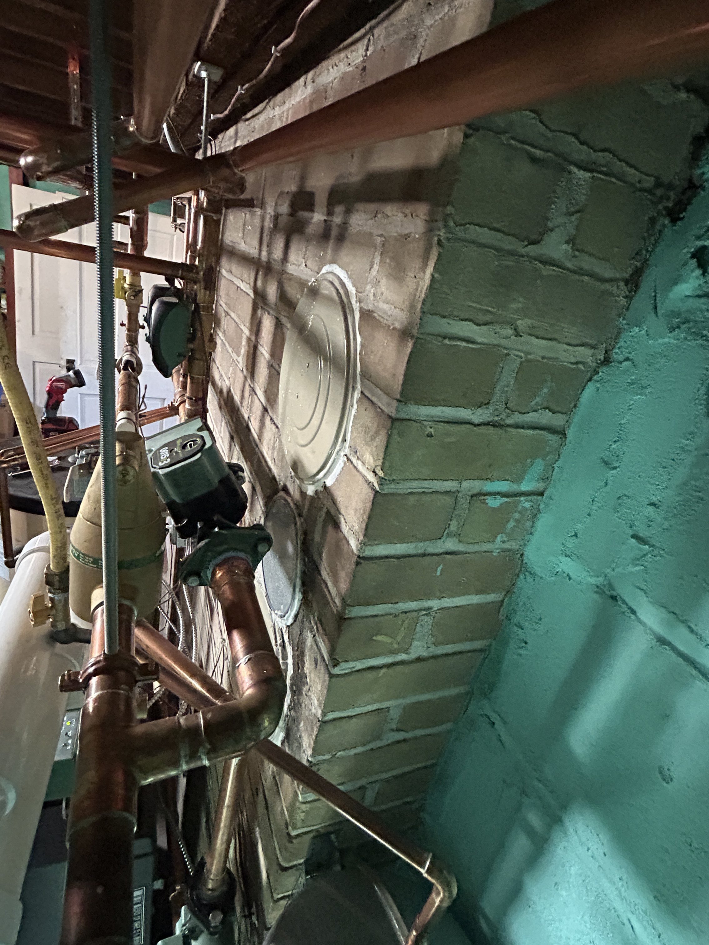

    @Jamie Hall Hadn't checked in a bit but I have a watco 911 combo fill valve regular which I thought was set to 15 psi but my boiler hasn't run all day currently and while it's not cold cold it's sitting at 11 PSI. The expansion tank might be overcharged as a result.
    Sorry about pic angles but between pics 2, 3 and 4 you can see the expansion tank in relation to the automatic air filter. It has almost exactly 27" of piping between the bottom of the seperator and the top of the expansion tank. That plus the 17" between the air seperator and the system pump is 34" of piping.
    Only guidelines I saw were a required minimum distance between those components not maximums of how close they should be. Insight appreciated.

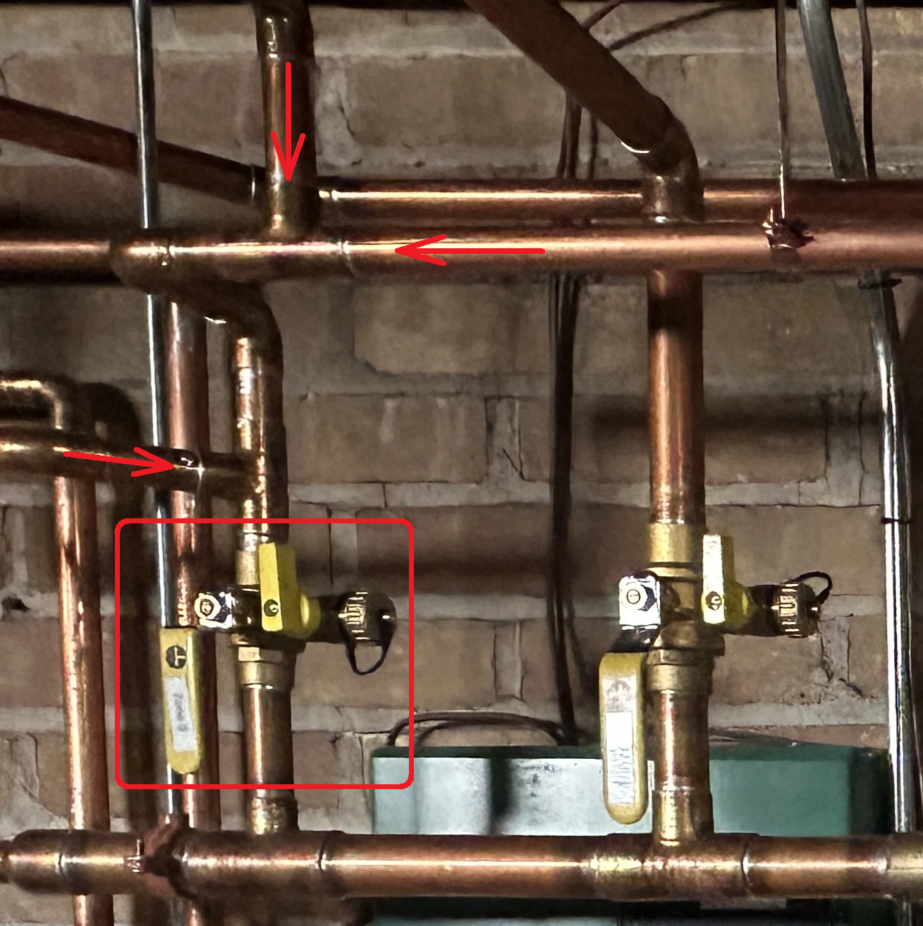

    @109A_5 Yes there is a purge valve on the zone but it runs in different directions to feed different radiators. I mean I guess I could add purge valves to each loop but how would that be different that purging the zone?

    Not individual purge stations for each loop but just a full port ball valve on each loop so each loop can be purged out individually. Only one valve open at a time to purge that loop. Once all loops in that zone are purged, all the loop valves are opened for normal operation.
    The way I see it, what guarantee is there that the purge water will flow through all the loops in that zone to purge out all the air ? Doing one loop at a time forces each loop to purge.

    I don't like using the fast fill for purging as it generally doesn't have enough velocity, so I generally use something like a Webstone purge and fill valve in the main and then purge each zone individually. Not saying your fast fill method doesn't work, it would just need to be verified. How many vertical feet above the boiler is the highest point in the radiation? 11 psi may not be enough to lift that high, which would pull air in the high point vents if applicable

    I acutally hadn't checked that an had assumed system was at 15psi from the preset on the watts fill/regulator. I adjust that and then took the pressure off and set the expansion tank to match at exactly 15. Seems to be running well and getting between 18 and 22 psi when running.

    Why is my circulator mounted wrong? Will that impact performance or just the orientation you mean? Being an amateur at this my layout didn't quite work like i envisioned so i had to orient it that way but I understood it can be mounted in any direction.

    GroundUp Member Posts: 2,513
