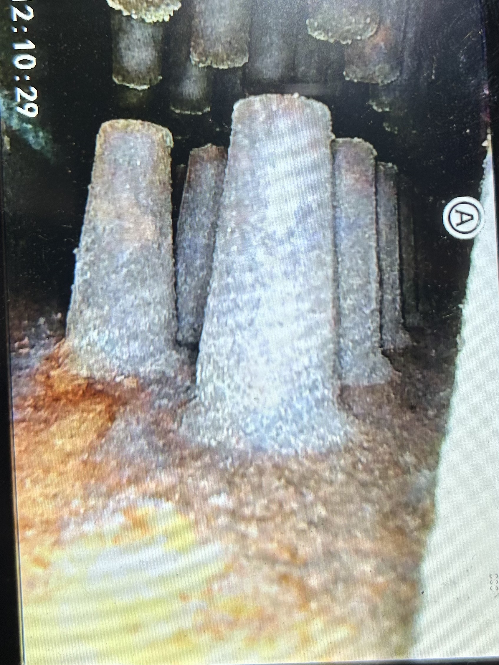

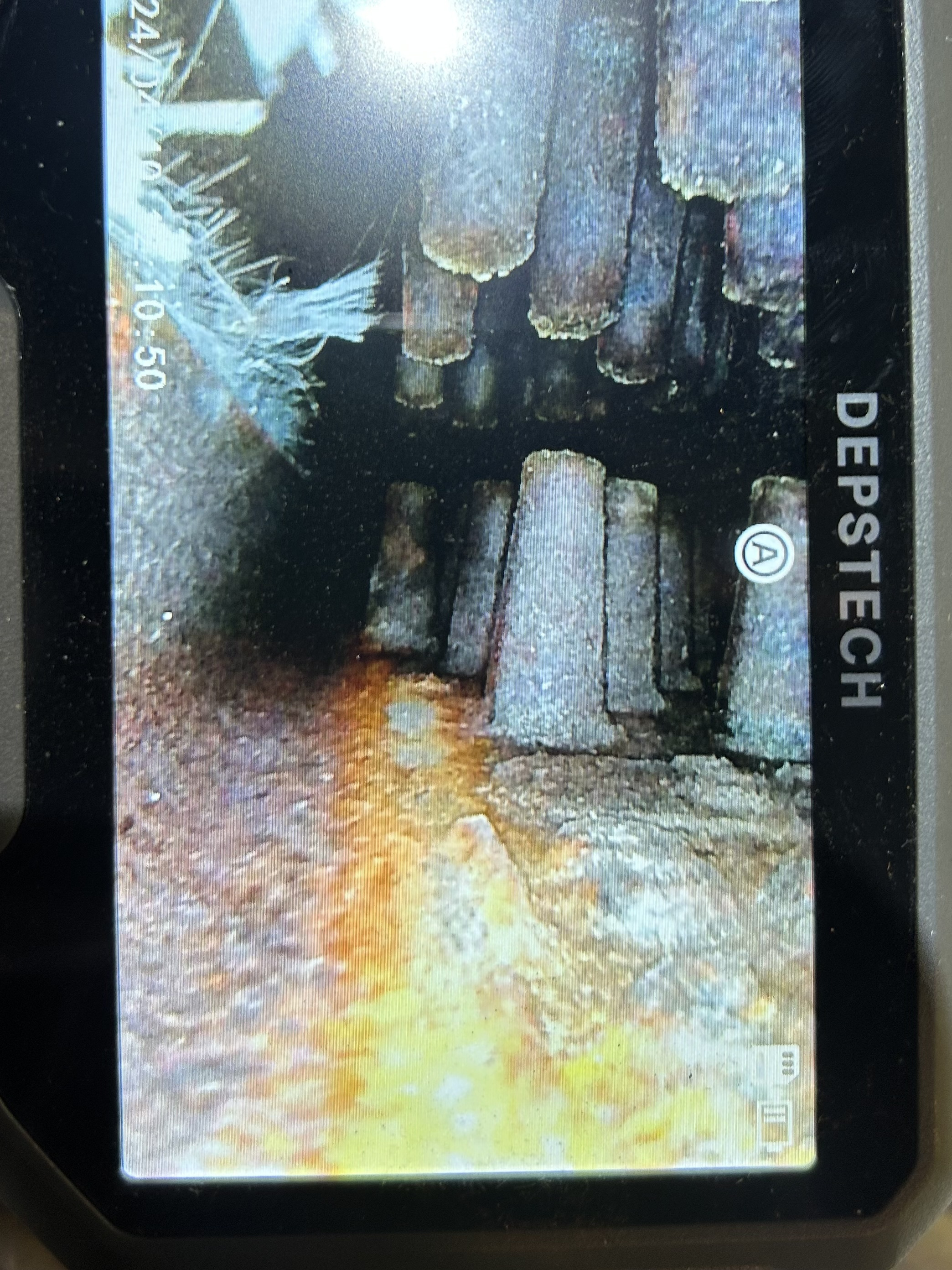

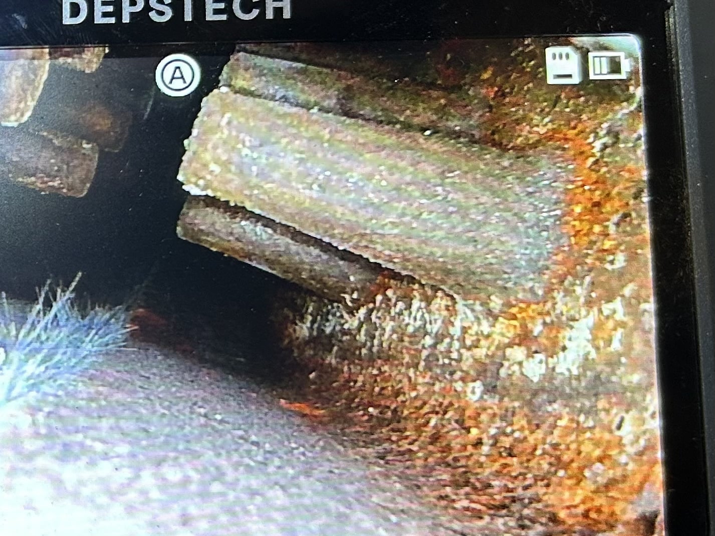

    Completed my boiler inspection yesterday, I believe I have a leaker. I have included close up shots of the near heat exchanger, boiler has three sections. It's a Peerless 64-03. I don't have an auto feeder. The issue of having to add water only started in the past month. For the past 15 years the boiler has given me zero problems. I will admit i have been a little lazy on up keep of my vents, but I do replace when they fail to close . I use all Hoffman adjustable. Like everything else they have gotten way more expensive.

    I flooded the boiler and let it sit for a couple of hours and i did not see any leaking, and it was filled almost to the first floor. I know this because water came out my main vents. should I have left the boiler flooded for longer? I took some pictures of the heat exchanger and i saw surface rust.

    its not the boiler if you didn't see water running out somewhere after a couple hours. it could have a very small leak but it isn't a have to add water every few days kind of leak.
