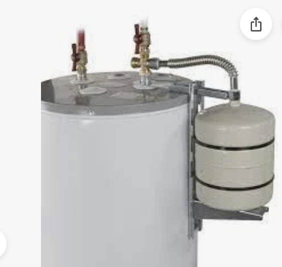

My water heater currently doesn't have an expansion tank. I don't have any check/backflow prevention from the city supply right now, so there's no huge concern there, but I'd like to be able to safely shut off the main water valve for extended periods, so I want to add an expansion tank. My water heater is under a fireplace hearth, so if I support an added expansion tank from above, I'd either have to locate the exp tank farther from the water heater than I'd like (long dead leg) or drill into cement (I'd rather not).
Three above fitting/valve supports the tank from below, but not by the body of the tank. Would you consider using that in my situation?

    If you are closing off the water feed to the whole house, you should also shut off the burner or element to the water heater. Then you will still not need an expansion tank. I don't see any reason to have the water to the entire home/building shut off and continue to heat the water in the water heater. Can you?
    But to answer your question, that tank holder will carry the weight of the tank under normal use since it should never actually be full of water. You want to be sure that the pipe connecting to the water is properly supported as soon as you get past the masonry ceiling.

    I'd limit the, length of the line to the tank as it could be a bacteria breeding ground.

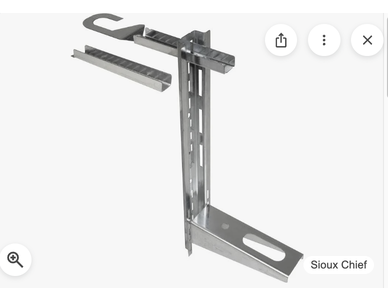

    What about a bracket like this?

    They are pretty darn good. @sre92 the one you posted and the one above that @hot_rod has shown. They support a tank A LOT more than any pipe can. They support the tanks real well. Especially when the tank fails and is water logged.
