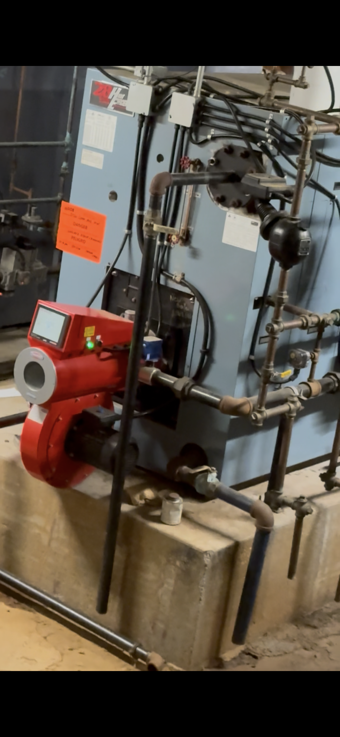

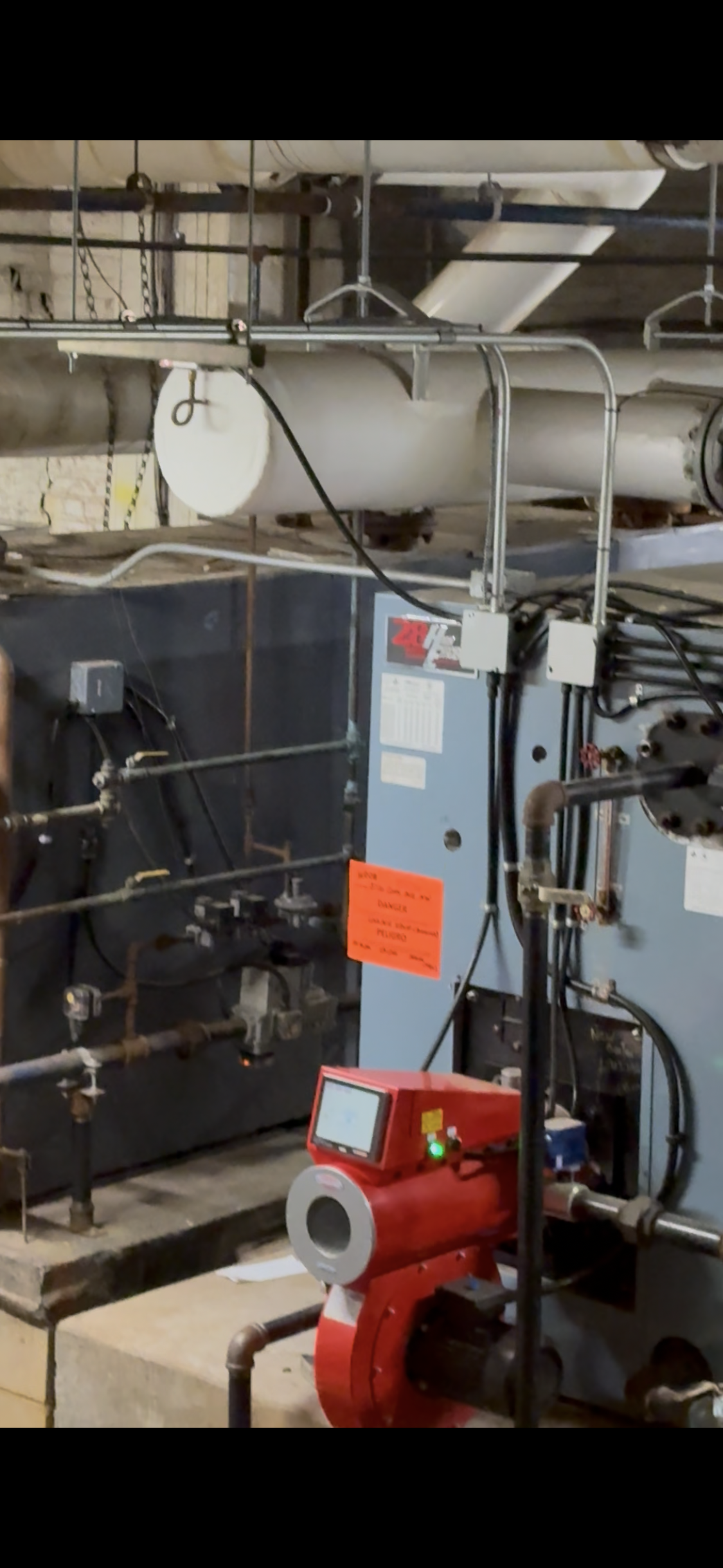

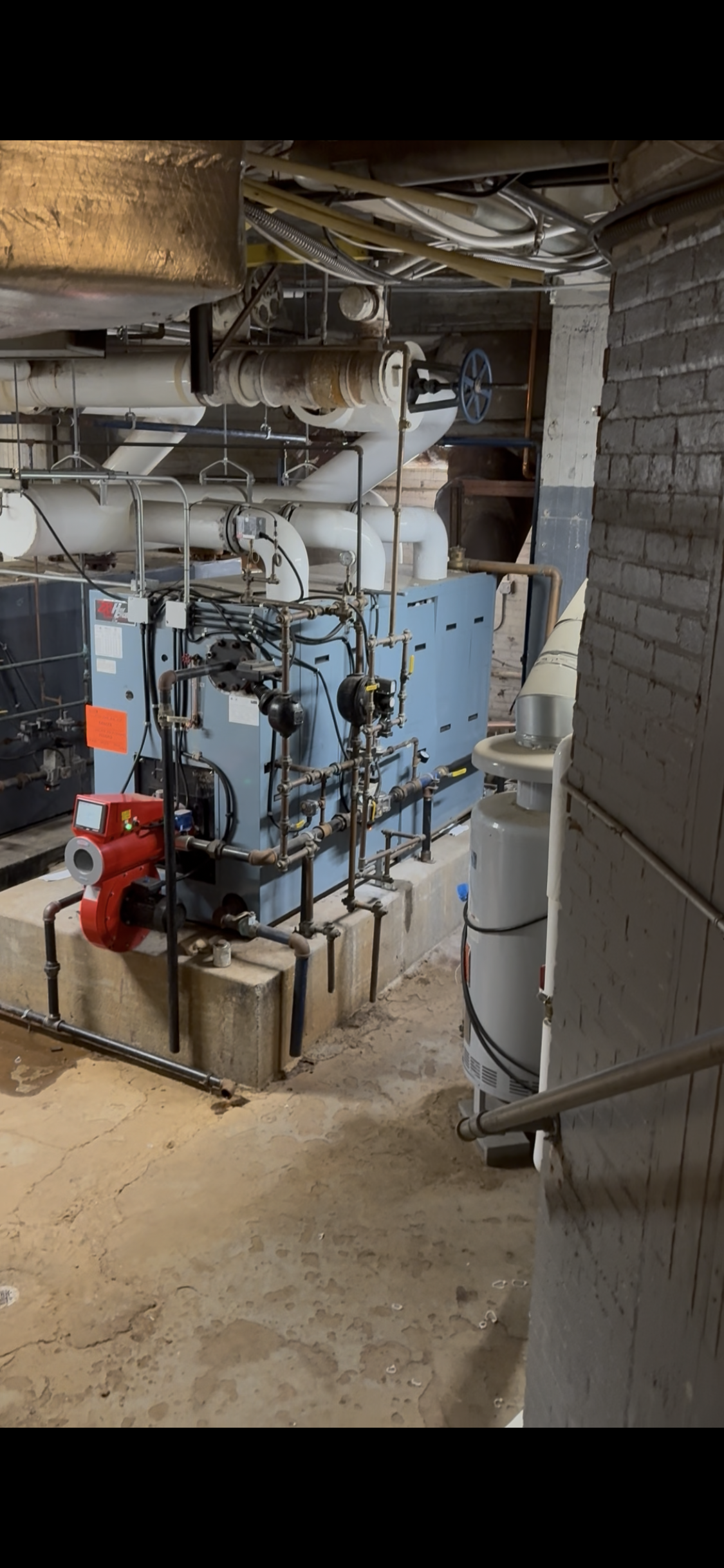

    Here I took screen shots of my video of the boiler. I will try to load here.

    you didn't mention that there were 2 boilers. there are a million things that have to be done right about that or all of the condensate will end up in one of the boilers and cause all sorts of problems.
    can you show us a picture of a radiator? I don't know what they mean by it was a vacuum return system. Vacuum systems are 2 pipe. There were some vacuum vent systems usually called a Paul system that used vacuum vents. Is there signs of a capped off small pipe near the vents? I thought those systems were much earlier than 1930's.
    why is there water on the floor?
    I don't see how a cycle control could cause a carbon monoxide issue. That being said you probably want to get a low level carbon monoxide monitor like a Defender or the low level monitor version of the Nighthawk/Kidde. The low level monitors are unlisted and will be called monitors rather than alarms. The listed alarms will only alarm for large amounts of CO because the listing standard requires that they not alarm or indicate for low levels of CO.
    what does that big orange sticker on the boiler say? i bet something is wrong with how the boilers are twinned and the water is not getting distributed evenly between them causing one of the boilers to call for more water and overfilling the system over a couple hours to days

    Yes we have carbon monoxide detector contained within our smoke detectors, which is how the tenant and her children knew they had a CO problem recently. Good-source rumor had it that Runwise controlling the controls caused the CO problem. I think the firemen in hazmat gear came to that conclusion when they checked the boiler room near the apartment.

    I am remembering somewhat about CO. As I recall of bits and pieces of a conversation, the CO occurred maybe after Runwise was shut off the first time, then on again and something about the second boiler. Since it had not been in use for a while (?) there was a CO build-up? We were all guessing, believe me.
    that is a different type of 2 pipe system. that is talking about a 2 pipe hot water heating system that is also used as a cooling system. in winter heated water is run through the pipes and used for heating, in summer chilled water is run through the pipes and is used for cooling. in this context this is a 2 pipe system in contrast to a 3 or 4 pipe system that has 2 separate water pipes dedicated to supplying heated water and chilled water and 1 or 2 separate pipes for the return of that water.
    you have a steam system rather than a hot water system. I would be surprised if it isn't a 2 pipe steam system where there is a pipe to supply steam to the radiator and a pipe to return condensate from the radiator. if it is a 2 pipe system then the radiator valve can be used to modulate the heat.
    the tank is probably a condensate tank. if the controls are correct it should not become overfilled and require draining of water from the condensate tank. I strongly suspect that most of your problems are in the boiler room.

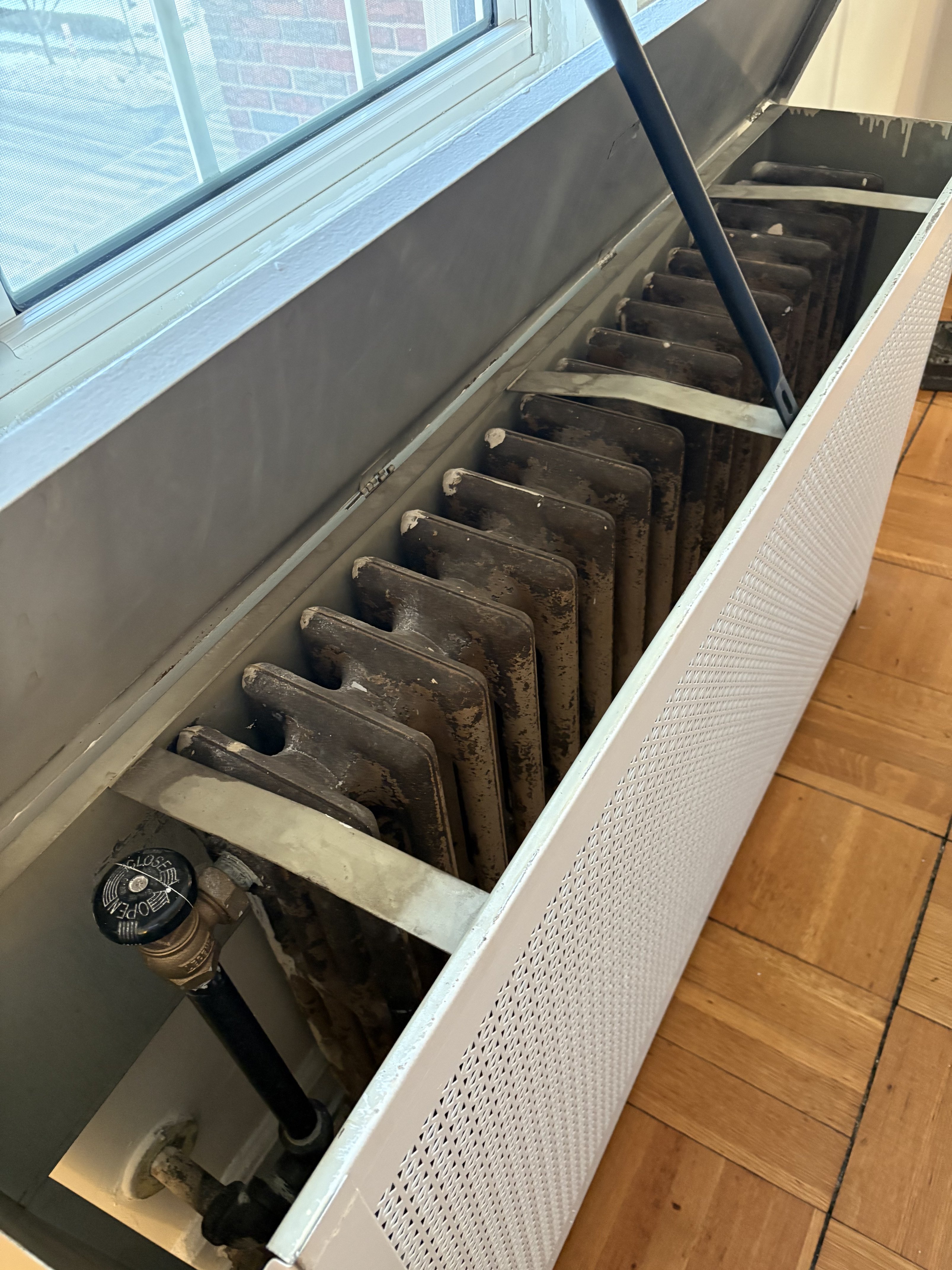

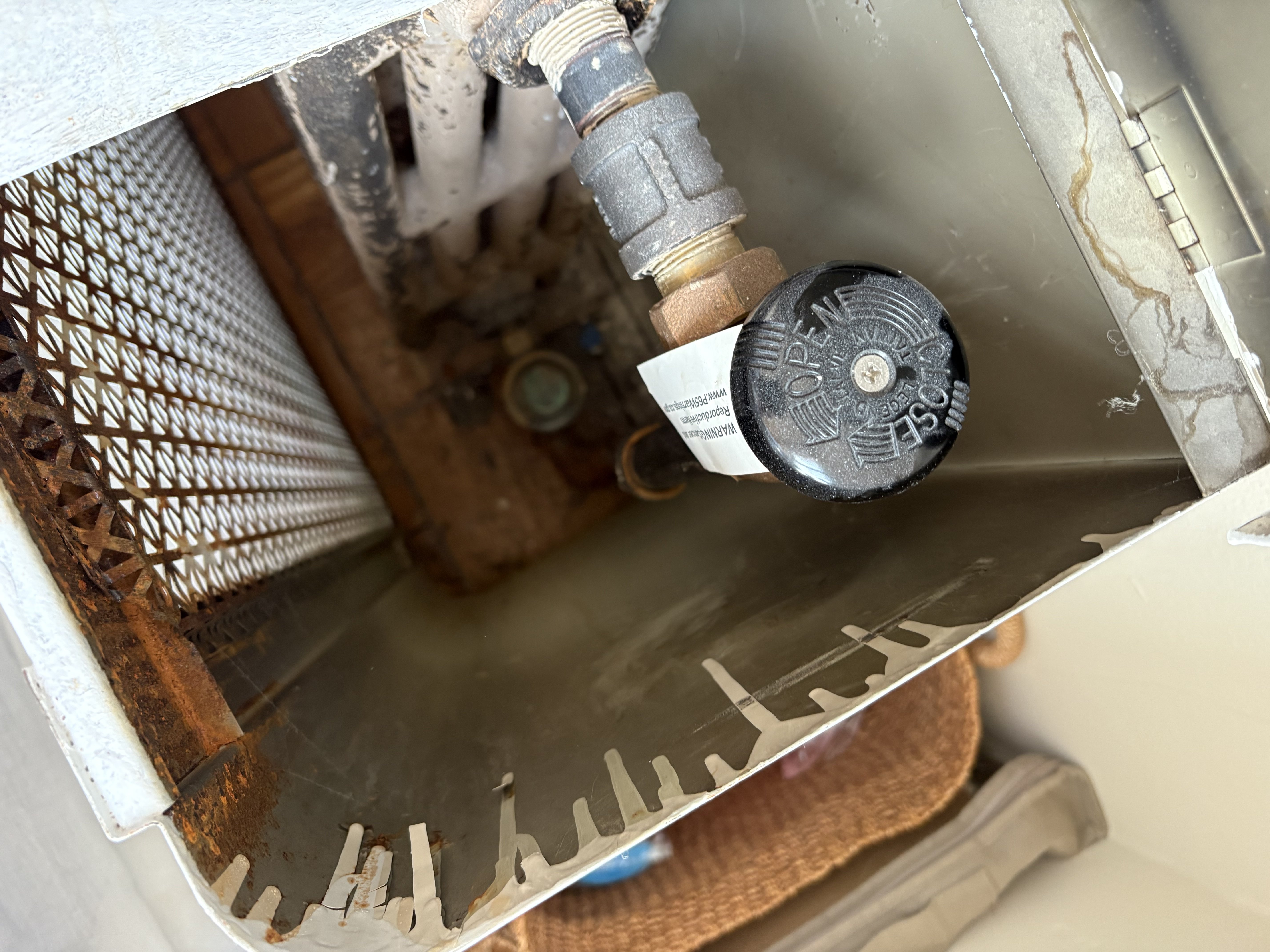

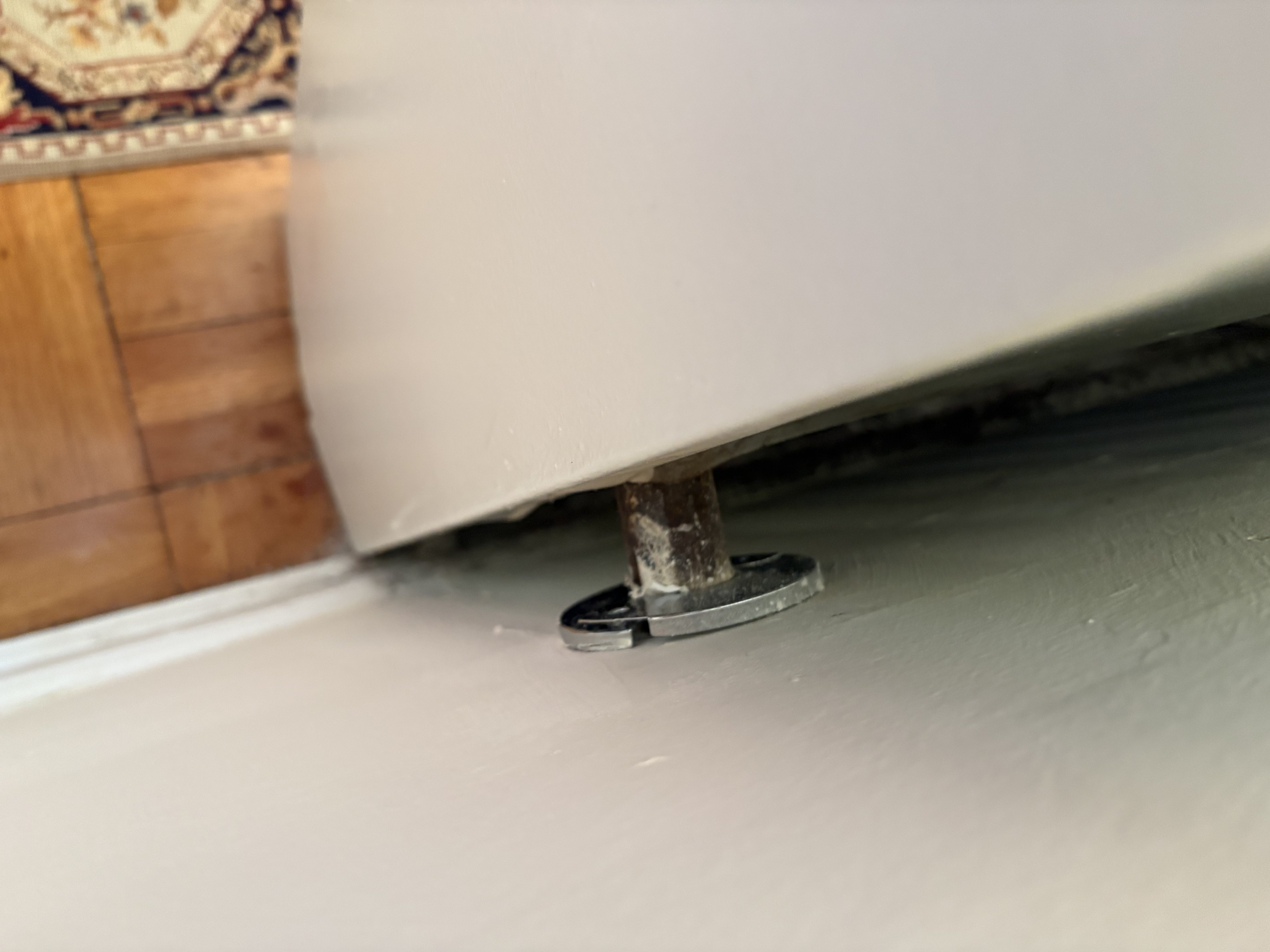

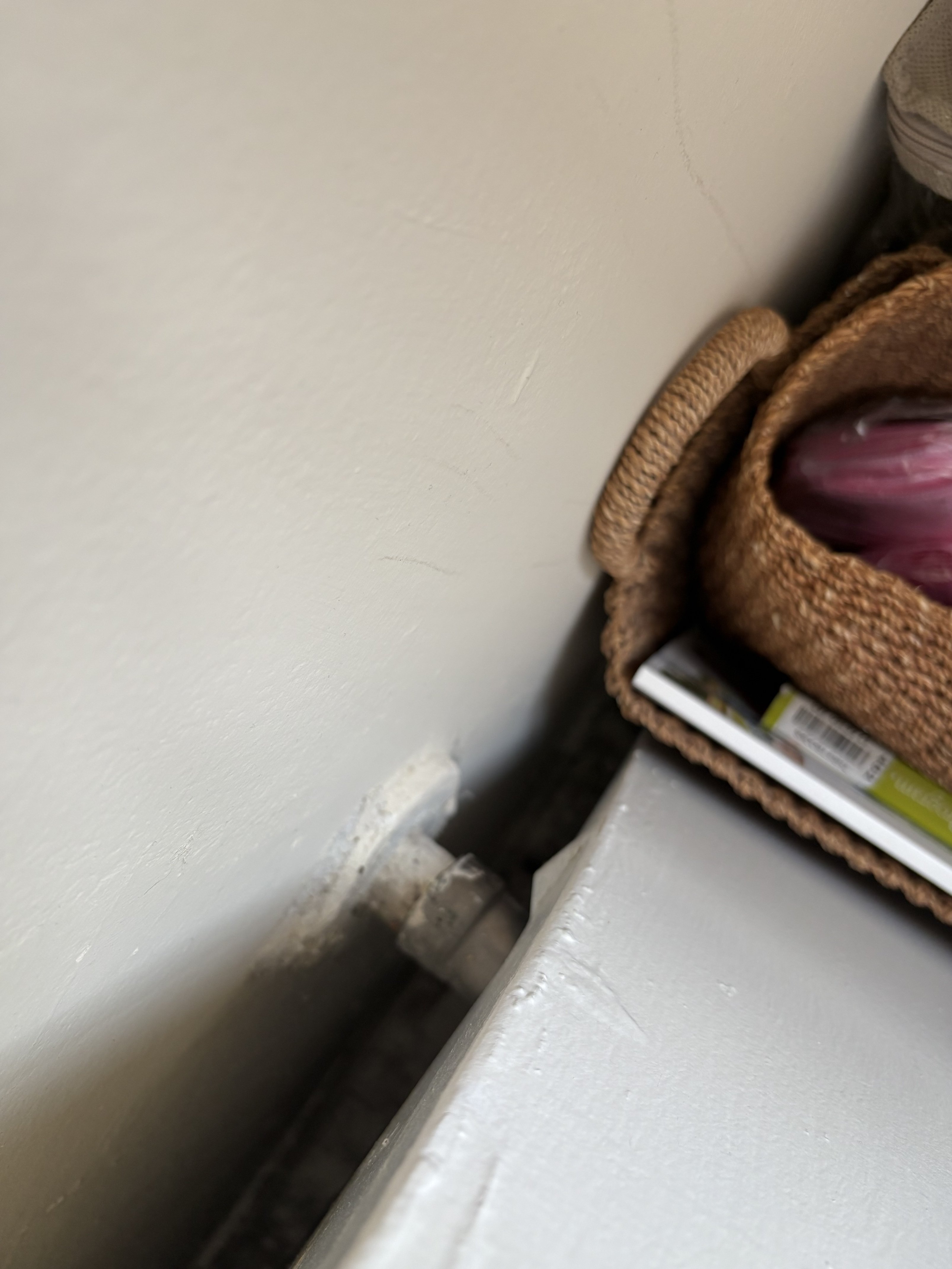

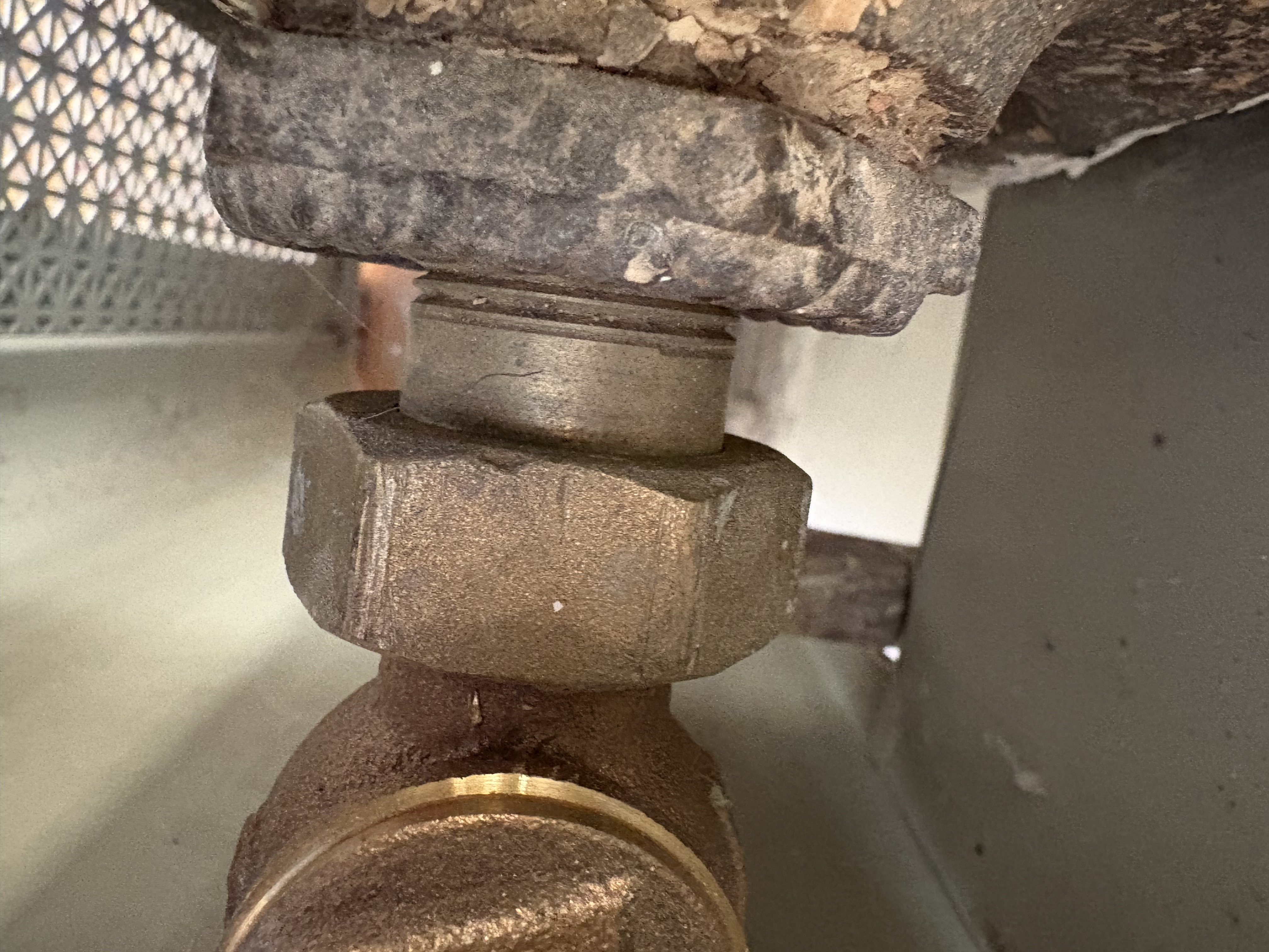

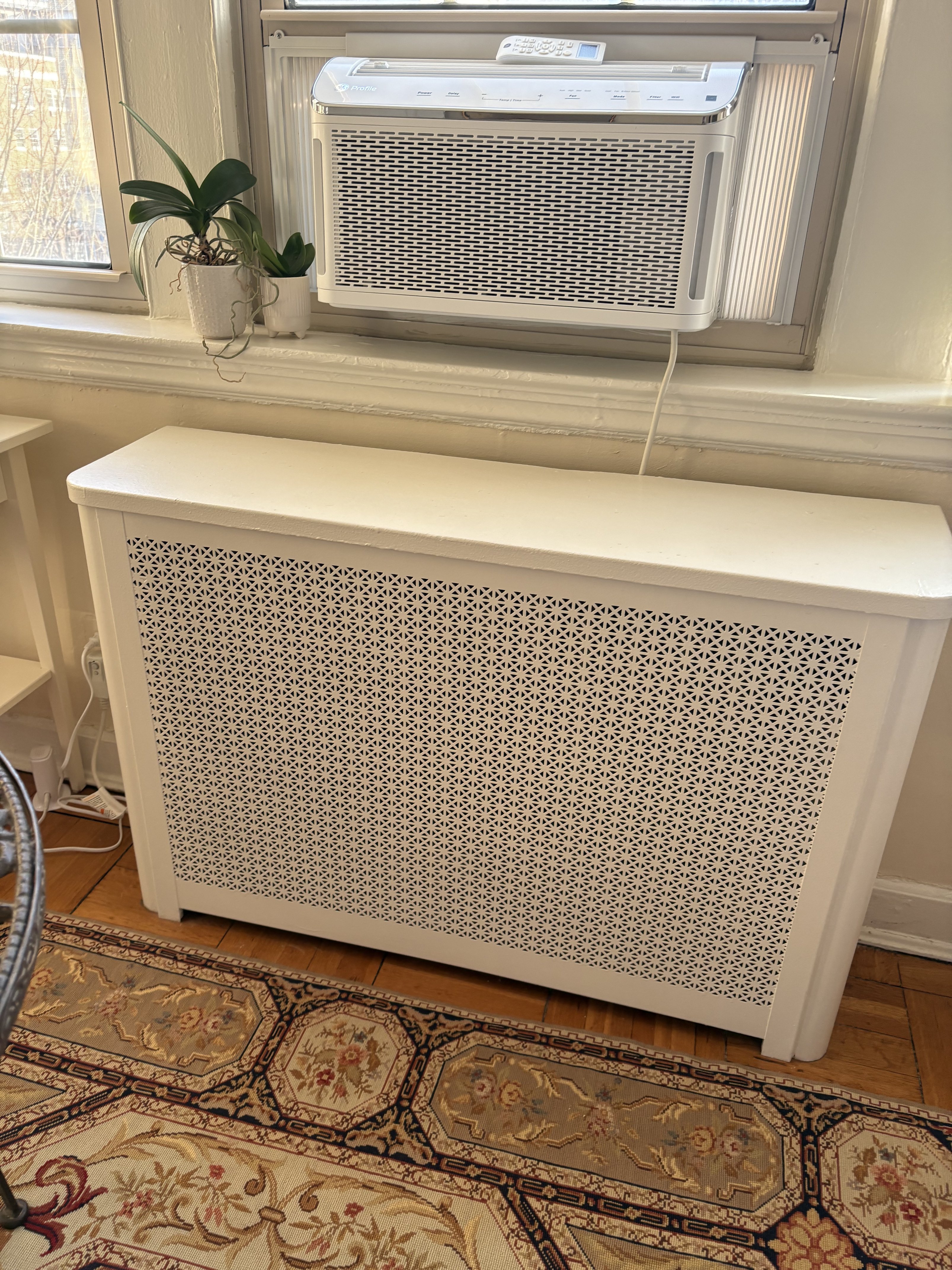

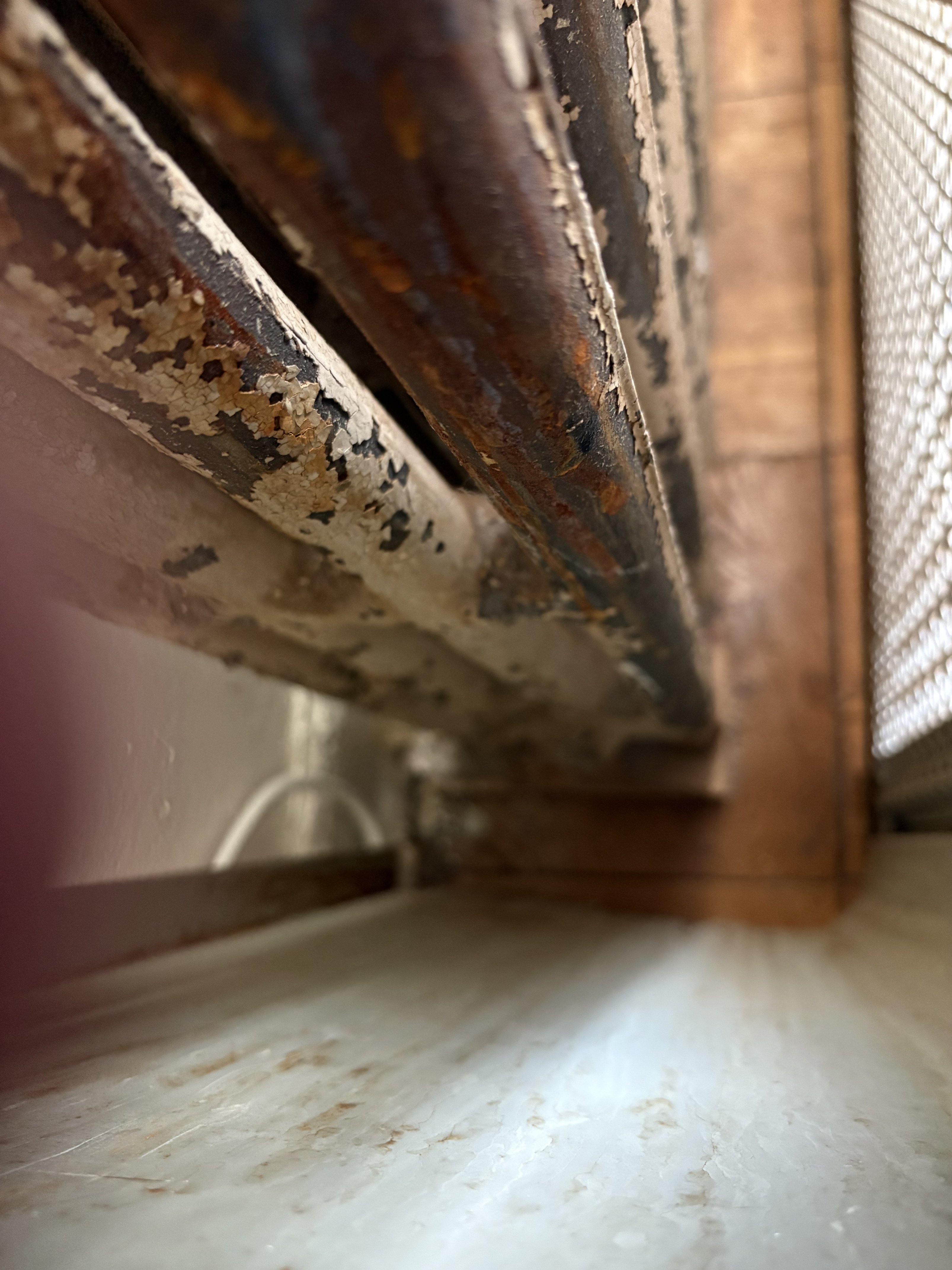

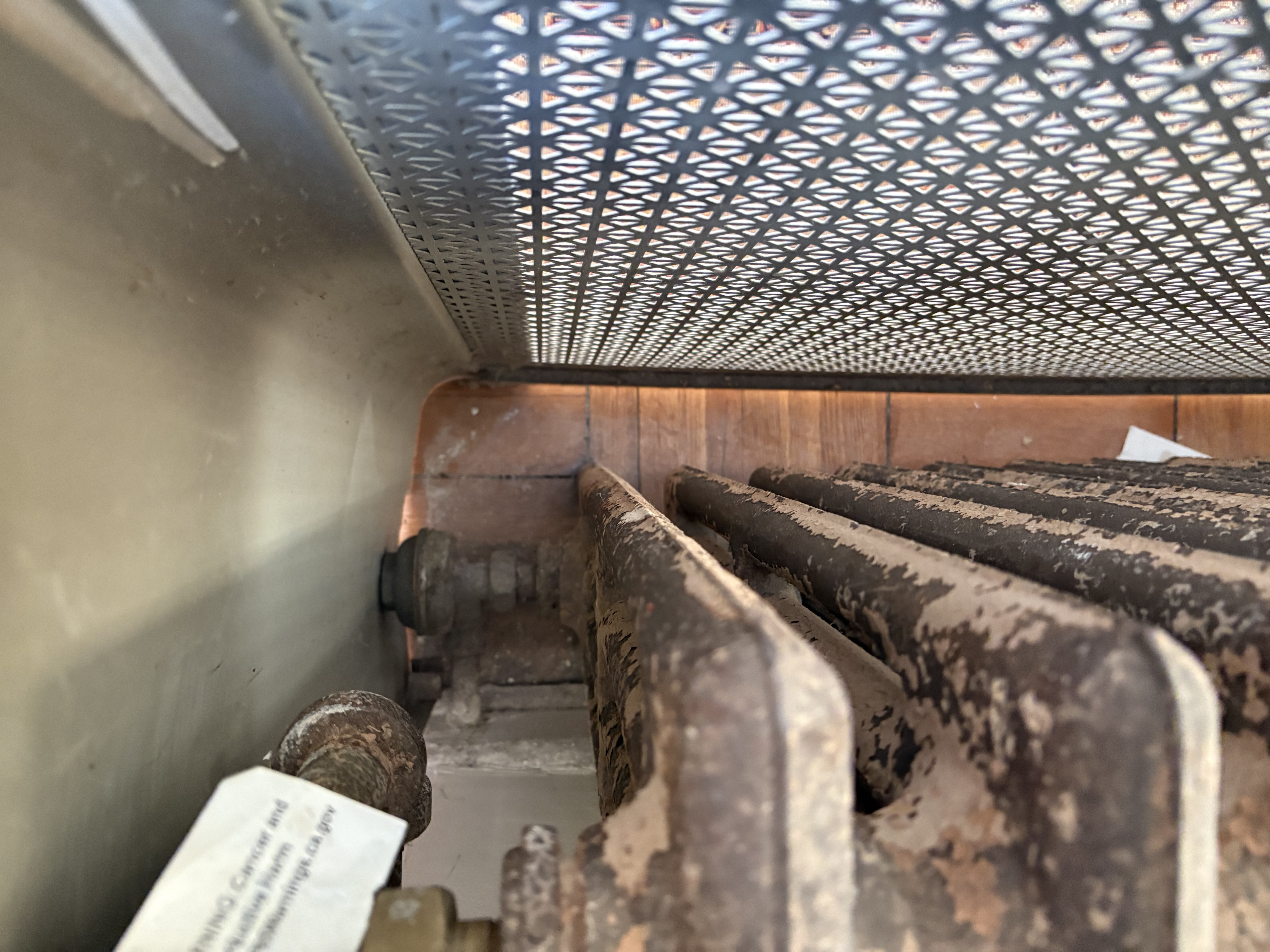

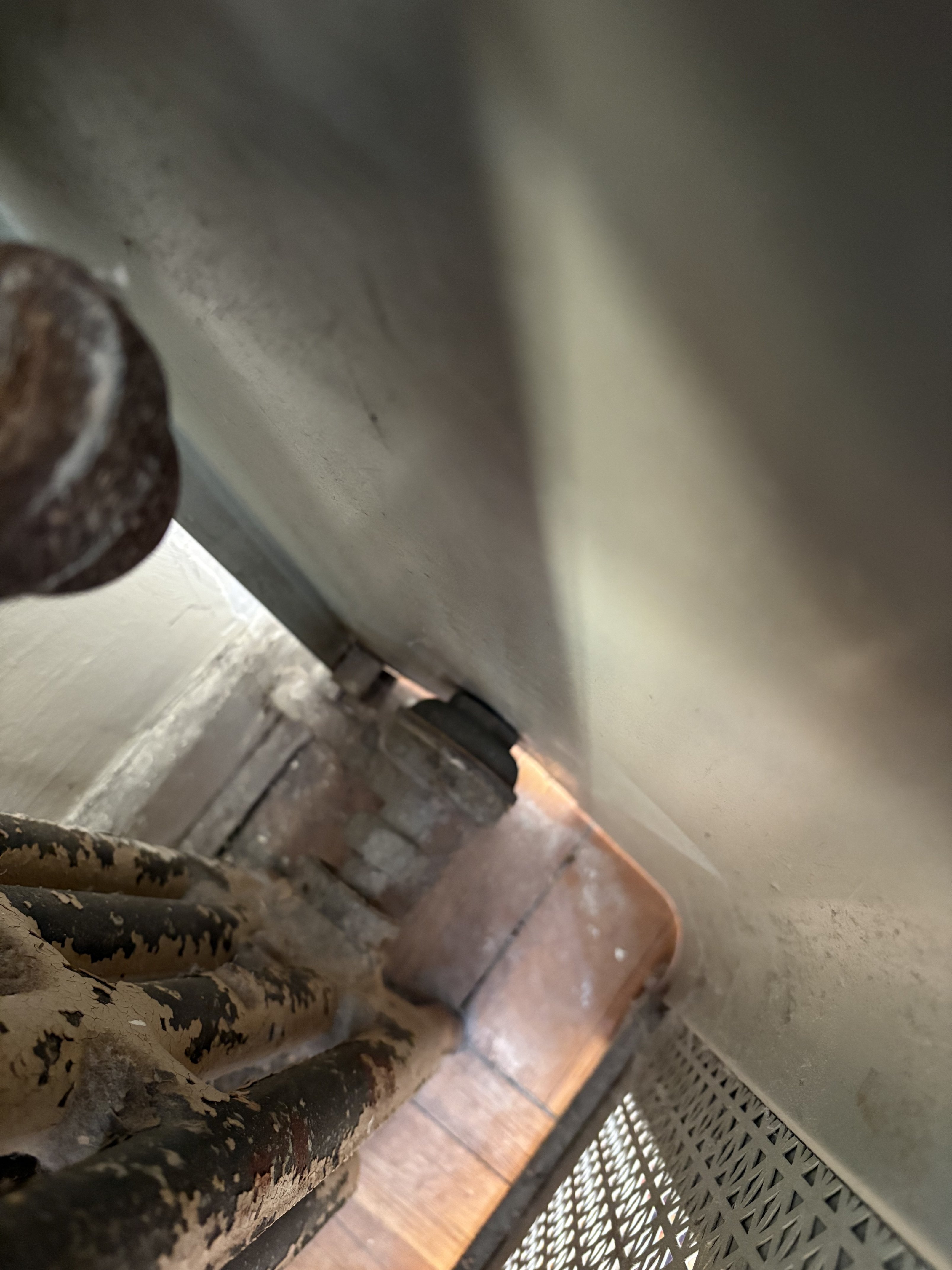

    Here are some of radiator photos I took:
    1. Living Room: I was told this was completely detached from the wall and shut off, but according to photos, maybe not. No heat; no ability to turn valve(?) on or off or to adjust. Sets on two wooden blocks, each side.
    Bedroom one to come, next comment.

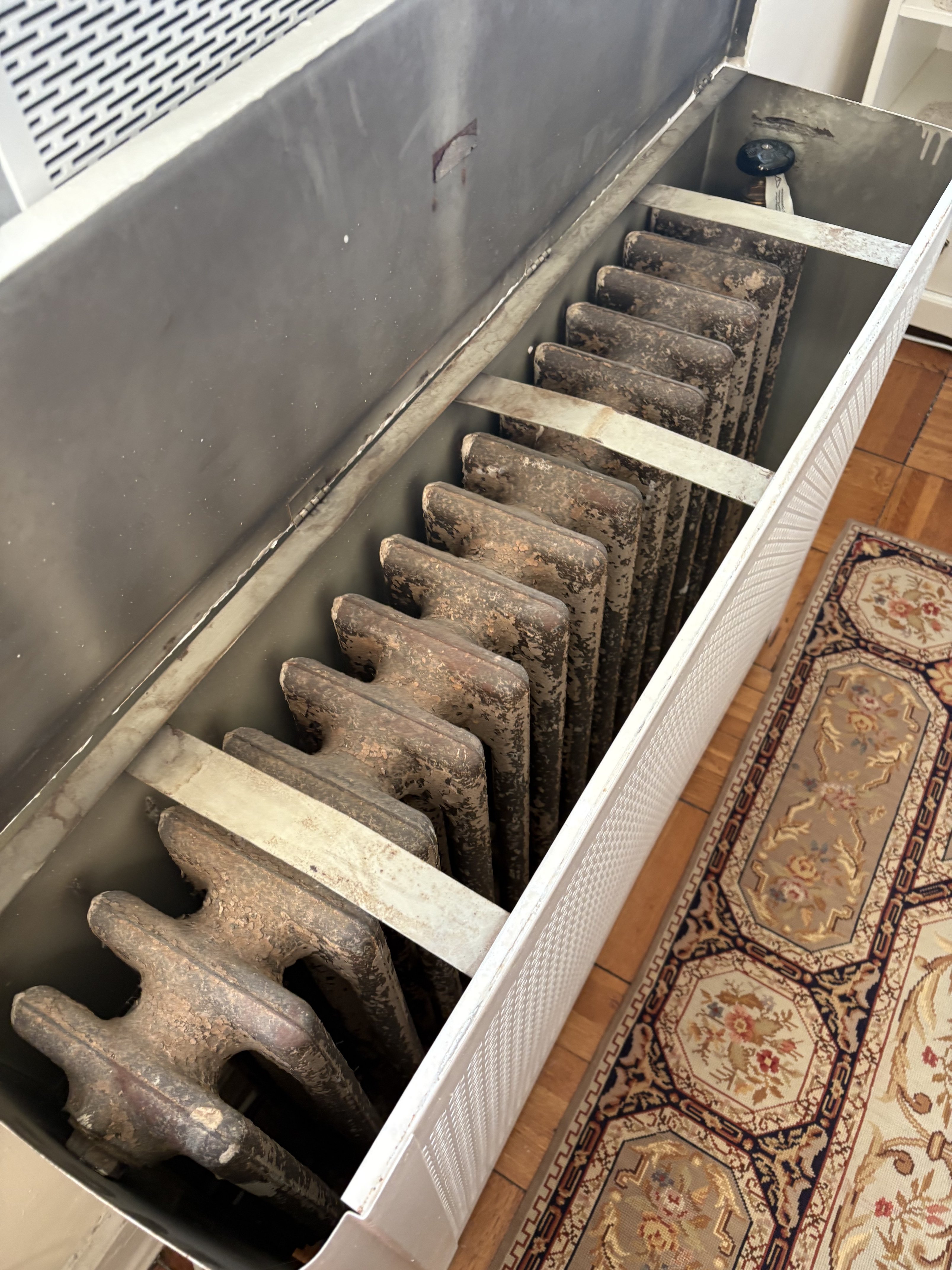

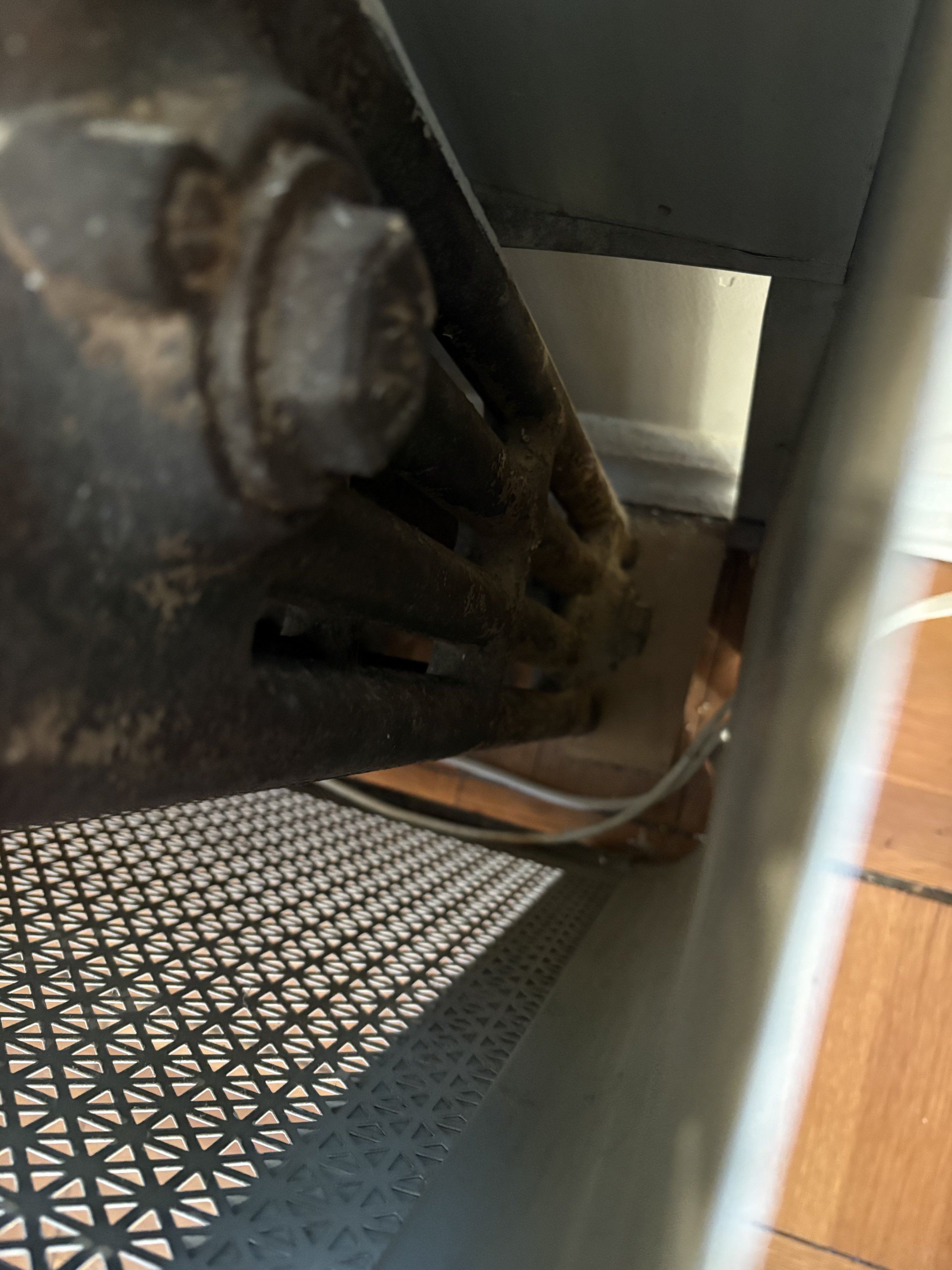

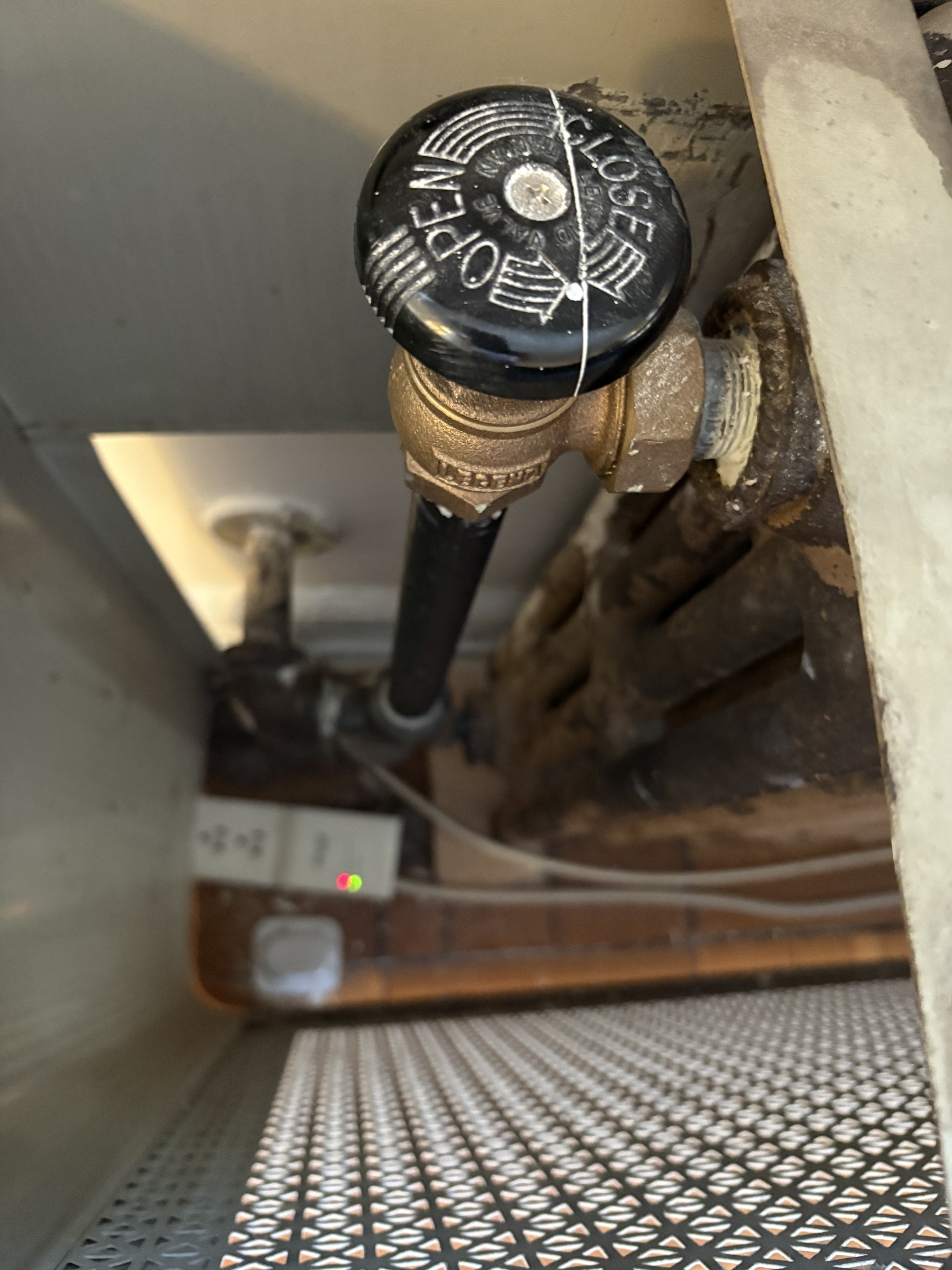

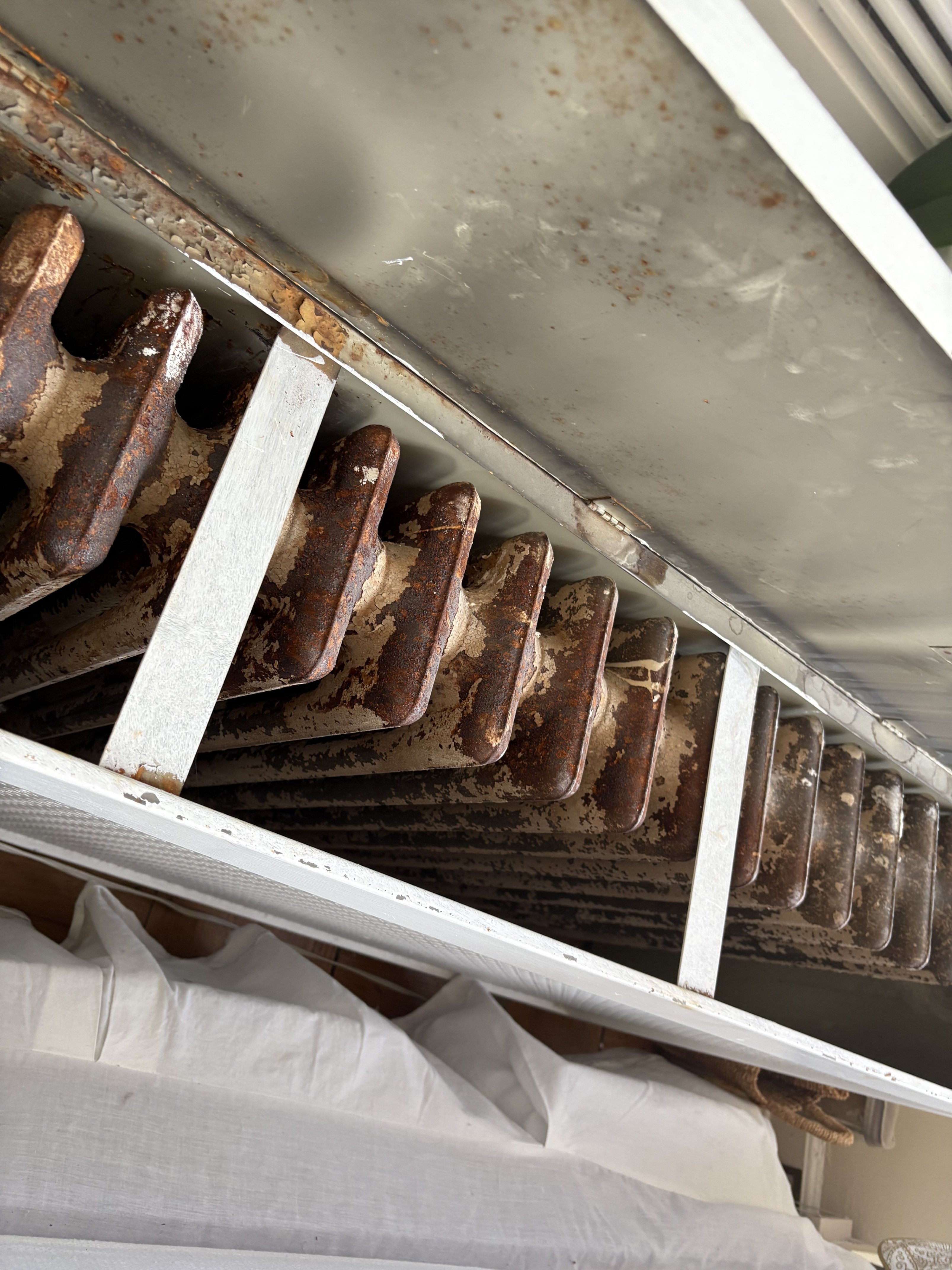

  • melanie
    melanie Posts: 23

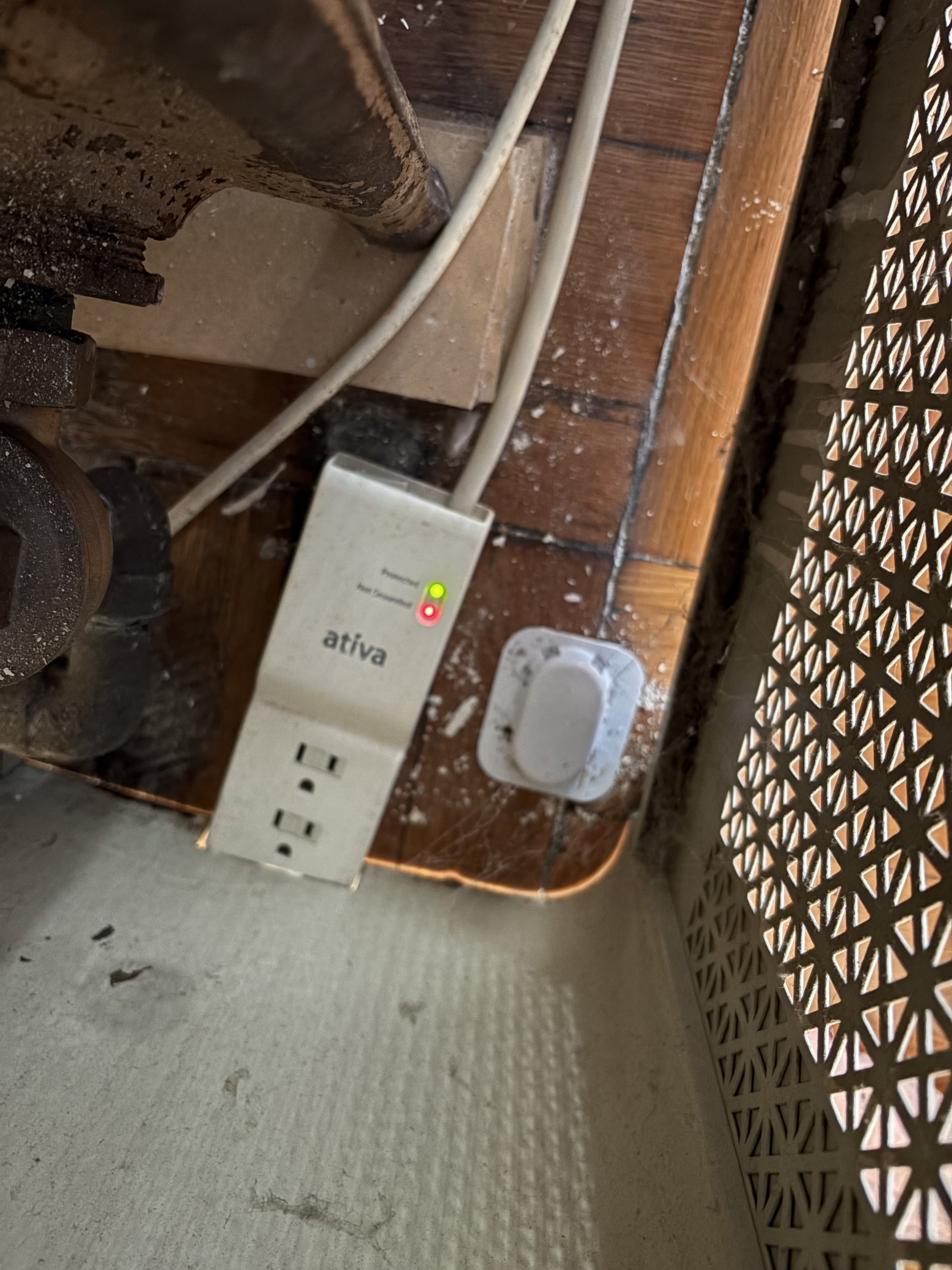

    Please see bedroom photos in prior posting. These are of the bedroom:
    No blocks.

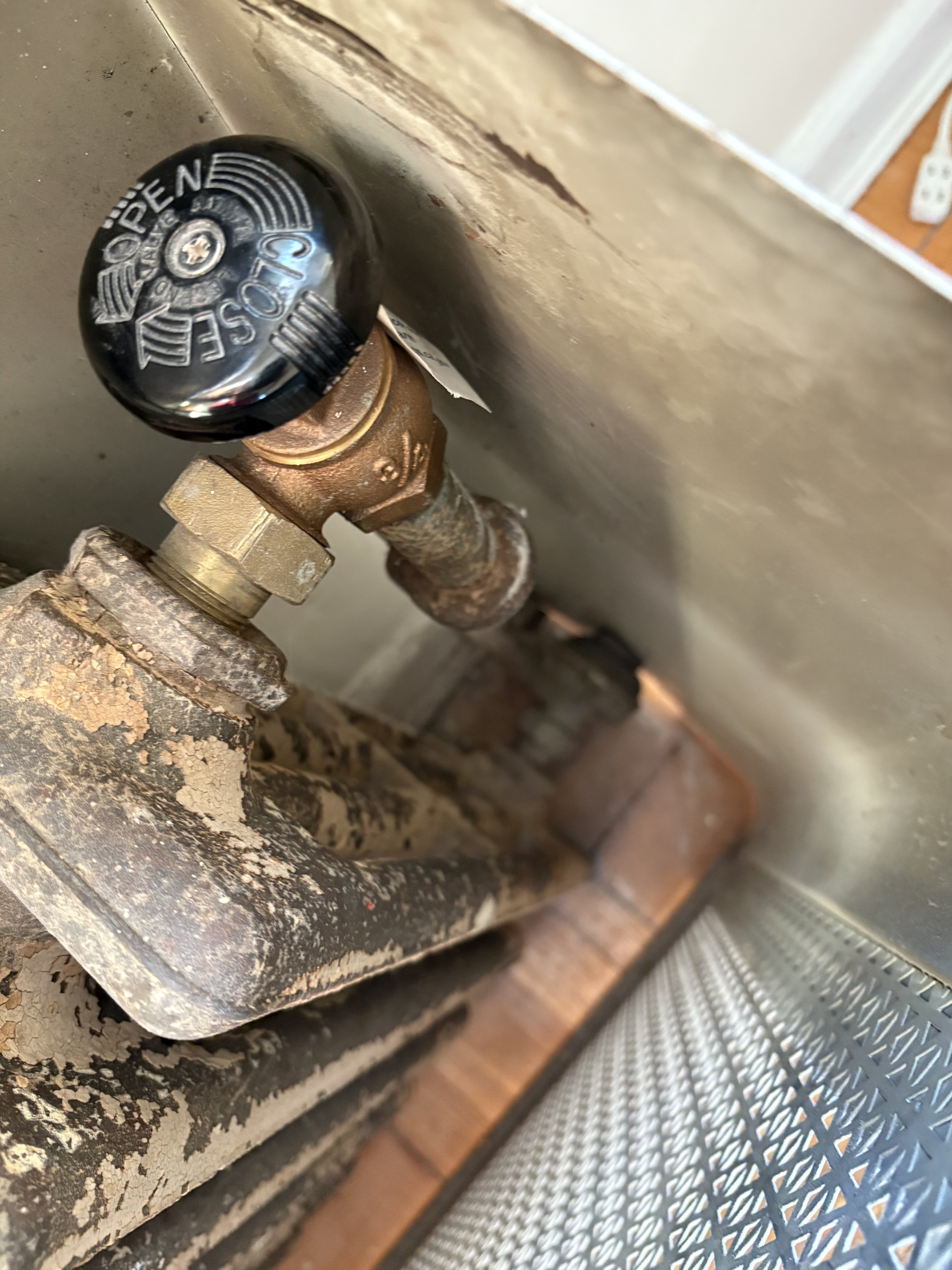

    This has an adjustable valve. If I turn it on, I turn it about a half inch at most—any more, the room becomes a sauna. Wall banging now comes often beneath the radiator on either side. Neighbor on same floor complains and I think it must be horrible for neighbor beneath since that seems to be where it must really be loud. That resident is hardly home at night so hard to confirm.
    Photos of den to come in next posting.
    that is 2 pipe steam. you can close the valve partially to regulate the heat. if there are steam traps that are bad that can cause many problems, most frequently other radiators that don't heat other than the one with the bad trap but the steam in the returns can cause all kinds of other problems too including water hammer.
    the way the supply comes out of the wall and elbows up gives all sorts of potential places for the pitch to be wrong and hold water and cause water hammer and keep things from heating.

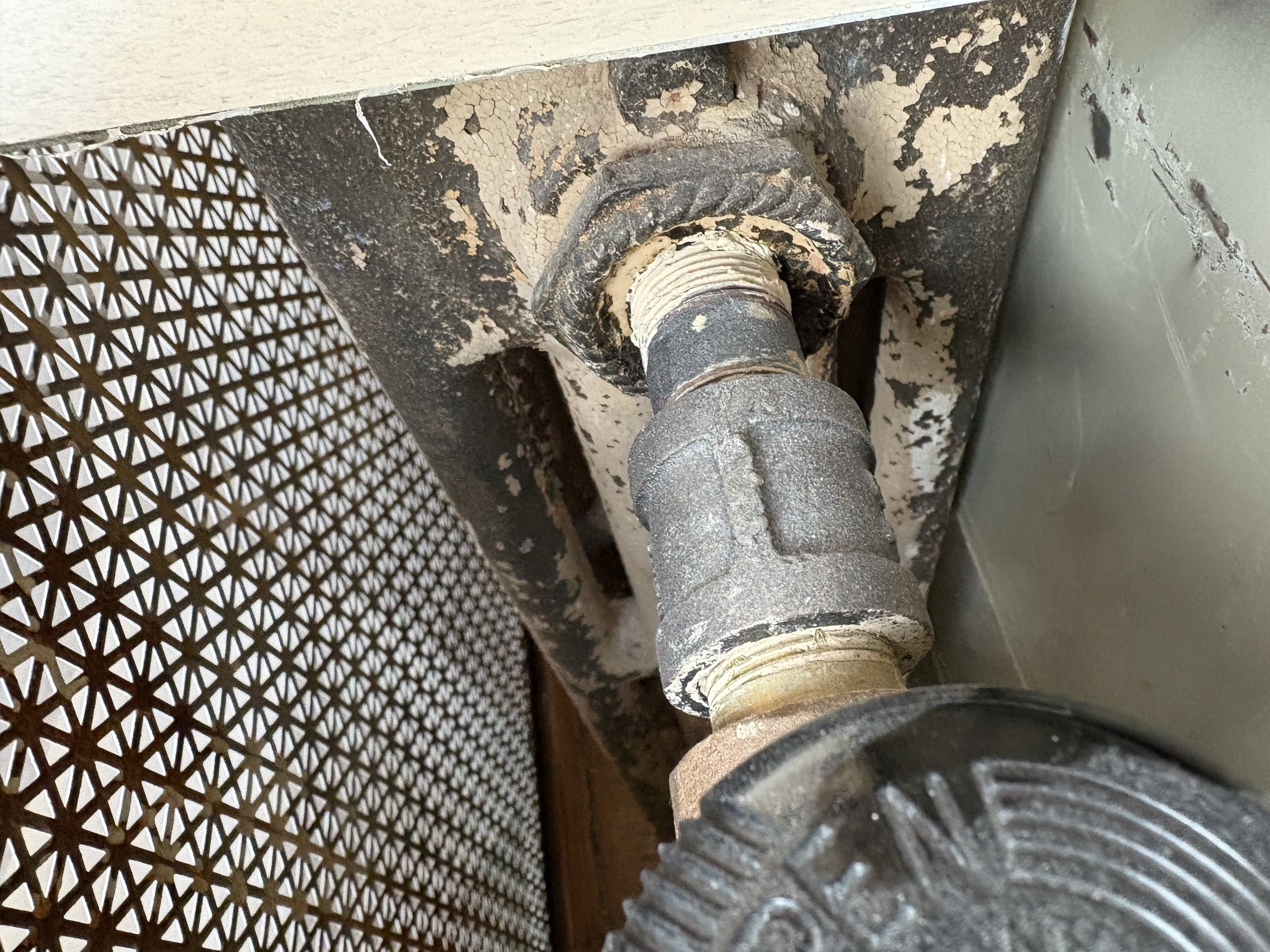

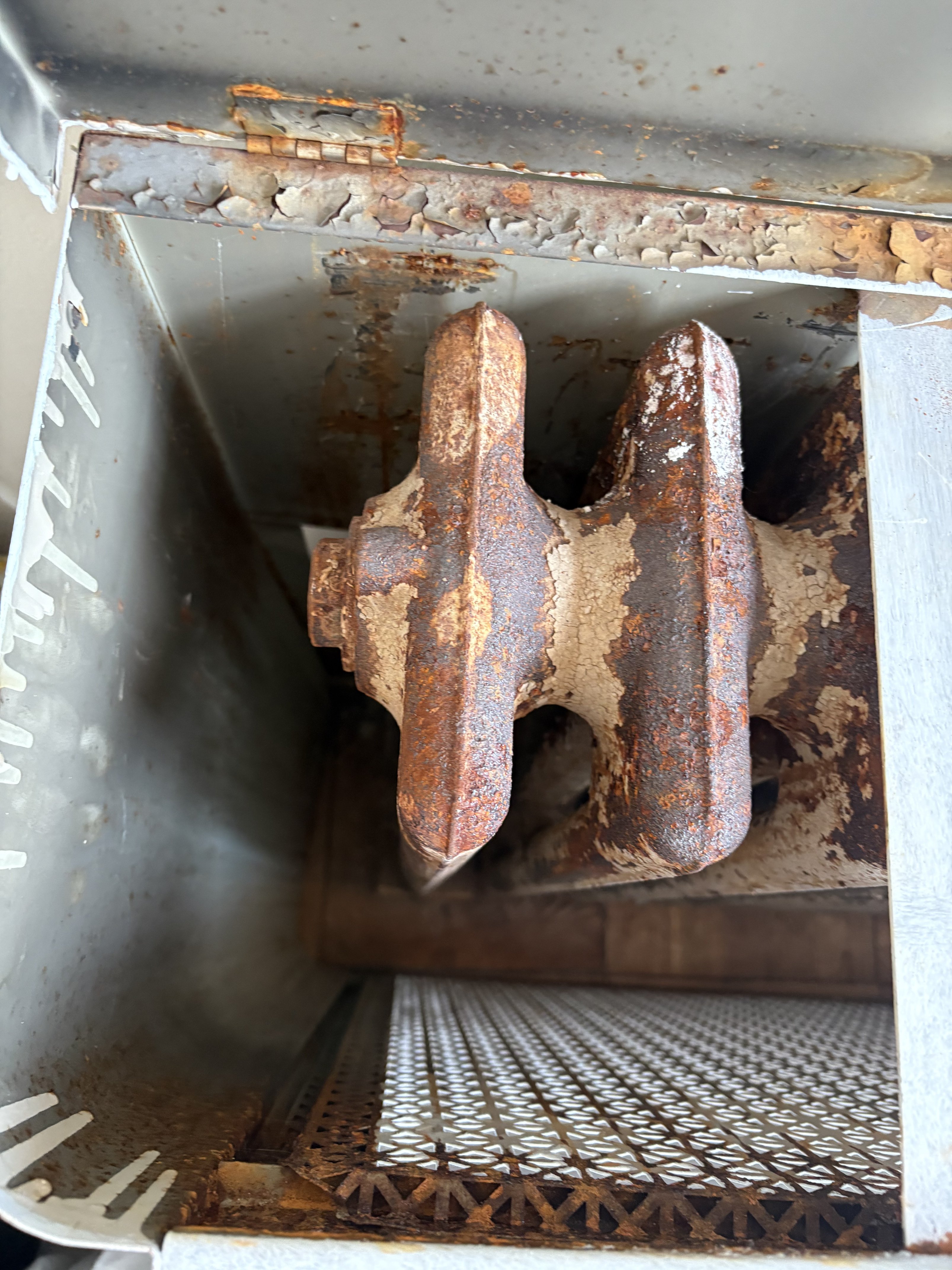

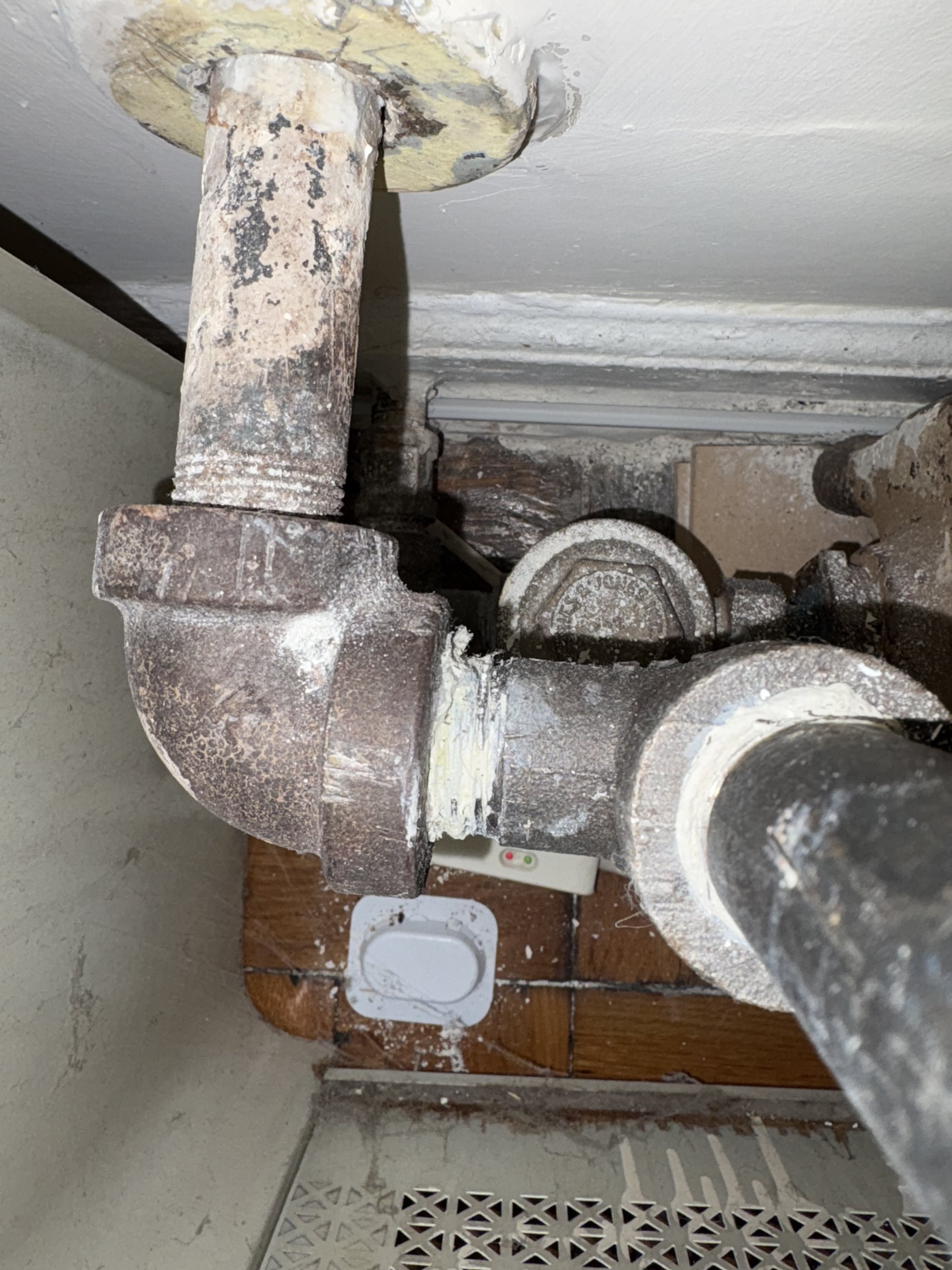

    Here is the den (second bedroom) where I sleep.
    Two blocks on each side. In August, in anticipation of Runwise, Contractors arrived and made an adjustment to this radiator. They told me that they were changing the valve, but it didn’t look like it to me. In retrospect, they could have been placing a sensor related to Runwise. Valve was suppose to be turned off. I did not touch it after they left. Initially, in October, pipes were banging badly this year (I have about 75 videos of banging through the night) but only in living room last year.
    This year, early on, banging started in my dinette, then traveled along living room ceiling, then into bathroom, then settled mostly and loudly along the ceiling above left side of radiator in den.
    After about 3-10 minutes (as I recall) would move into bedroom; be quiet for a while; then come again anywhere from 10 minutes to two hours later. All this every night since October 20 until last night (at least), except more recently it is in lower wall and along baseboard.
    Now, this den radiator: This is the valve (on/off knob) that exploded 2 years ago while I was sleeping and sprayed steam burning me and that destroyed my linens. I believe they had a plastic valve on this at the time—or something plastic. (I will look for a photo.) They made an adjustment. Before renovations, we had an 83 year old, great boiler man with the company for years. . He loved this boiler and was furious at what the contractor was doing. Occasionally, before he left the company, he changed out my valves and did some other work that improved the banging.
    Although the contractor’s den valve recently was suppose to be off, it seems slightly (1/4 inch) on. Radiator is not warm anywhere but pipe traveling to floor attached to valve is red hot to the touch.

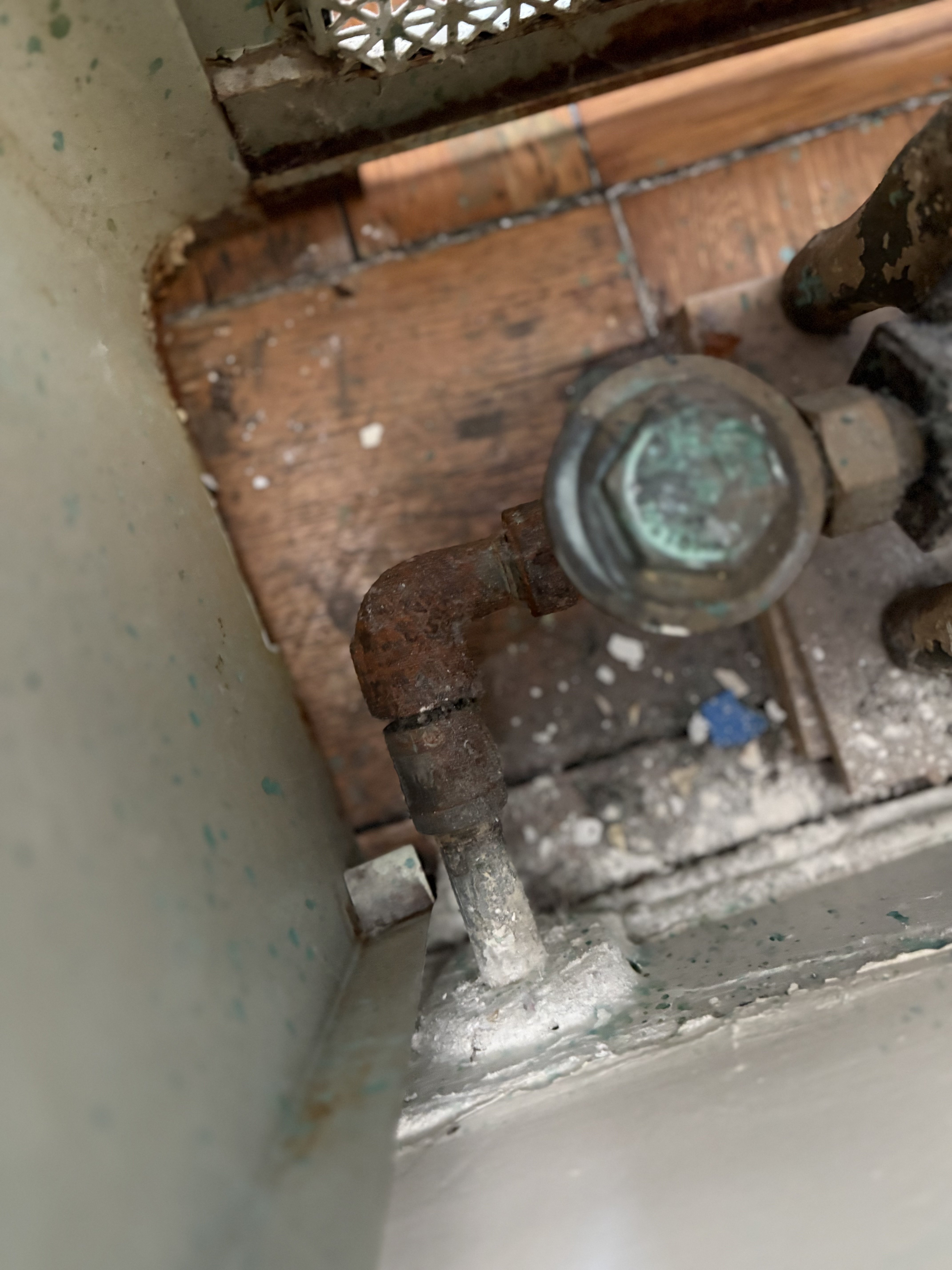

    in the post on feb 4th from author, jpg 2791, you see the valve on radiator, if you zoom in on photo on same side of radiator. The trap is mounted on its side below valve. I don’t think that would allow trap to operate properly.
    Grallert
  • Grallert
    Grallert Posts: 1,237
    I noticed the same thing and was going to ask about it. Seems like a likely place to trap a lot of water and slug it through the trap.
    It wouldn't surprise me if mounting the trap that way was causing a problem but wouldn't be my first guess about where the problem was. It will keep somewhat more water in the bottom of the radiator and may open and close more often with the bellows on the opposite side from the steam supply but I don't think it would outright fail to keep steam out of the returns or prevent the condensate from returning.

    Matt, yeah don’t think it would be main problem but wouldn’t help. The comment about not replacing traps due to cost is troubling. What if a gob of traps have failed over the years. Steam blowing through, condensate backing up. A recipe for 4th of July noise.
