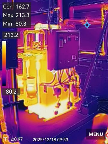

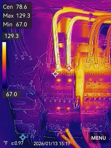

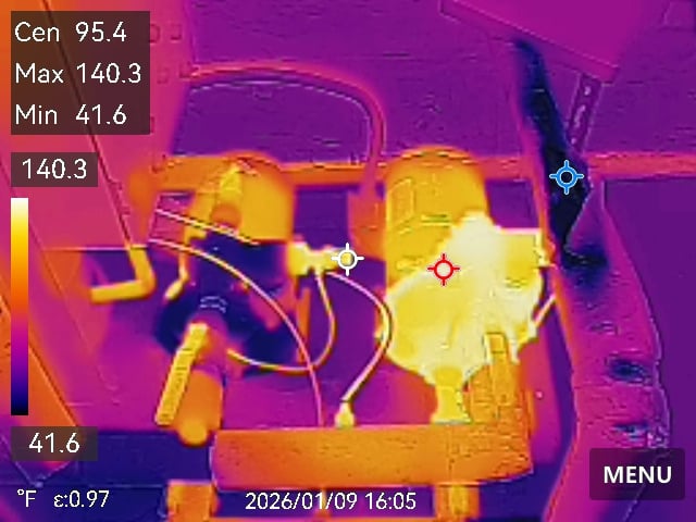

    I've carried around a Hikmicro pocket 2 with me for a couple years now, great little independent point and shoot that combines thermal and visual cameras. . I didn't want to have to rely on my phone battery, so I specifically wanted an independent unit. Was $600 at the time of purchase, which was about 2 years ago and I've been more than happy except for when I forgot to charge it for a while and the battery was dead on it when I wanted to use it. Photos aren't super high res, but fine for the what I need
  • pumpcontrolguy
    pumpcontrolguy Member Posts: 69
    edited January 28
    Here's a couple photos for reference
