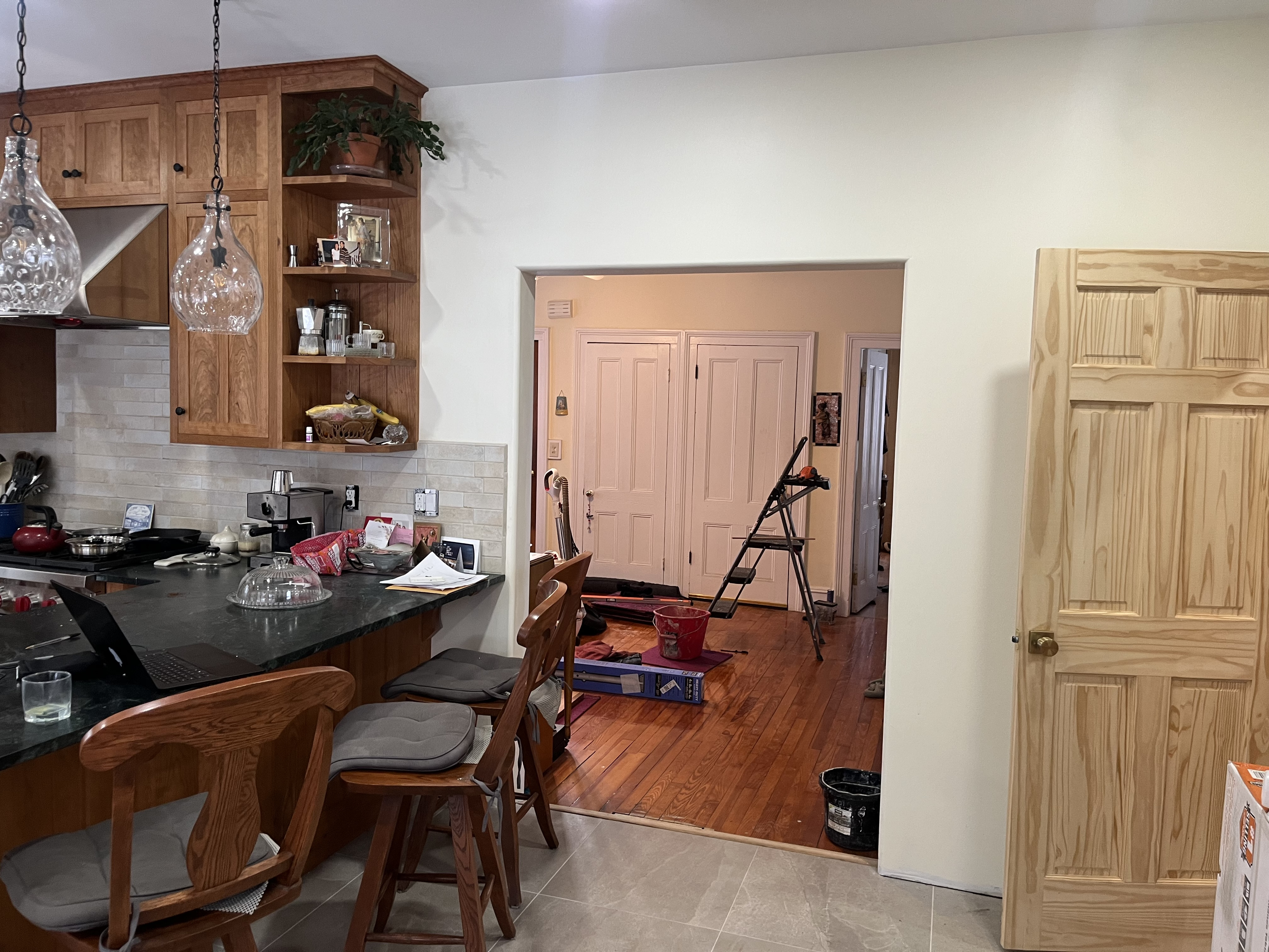

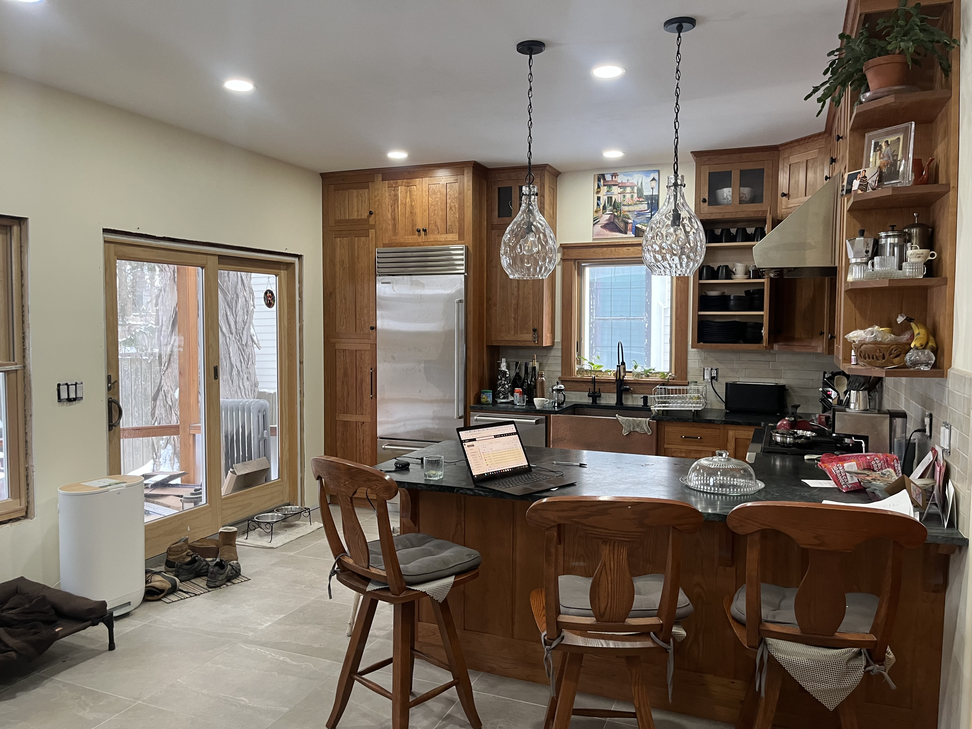

Finishing up a kitchen remodel where we made two rooms into one. The room size is 21' by 13', with 9' ceilings. There is a nook in the back left corner, 8' wide, that we are getting a bench and table made. I installed electric floor heat under tile.
I would like to add a steam radiator under bench in the nook area, leaving the front open under the seat. The only one i can find low profile is with castrads, which is 14" high. When I do calculations for room size I am getting 7000 BTUs needed. However we have not had a radiator in kitchen this winter and last and the kitchen is comfortable with both the floor heat and the heat coming from the nearby room. There is a 5 foot opening to the adjacent room.
When I got my electric bill last month, it got me thinking maybe reinstalling the steam heater will help lower this cost.
So my question is what would be recommended for BTUs. I am thinking 7000BTUS may be a bit much in the nook area even though the room is about 250 sq ft. I was thinking maybe 4500-5000 BTUs?
I attached pictures of our messy kitchen. The one with the day bed is where the banquet with bench and table will go. The other is of our kitchen area which the nook opens to show size and the third is the opening to the adjacent room.
