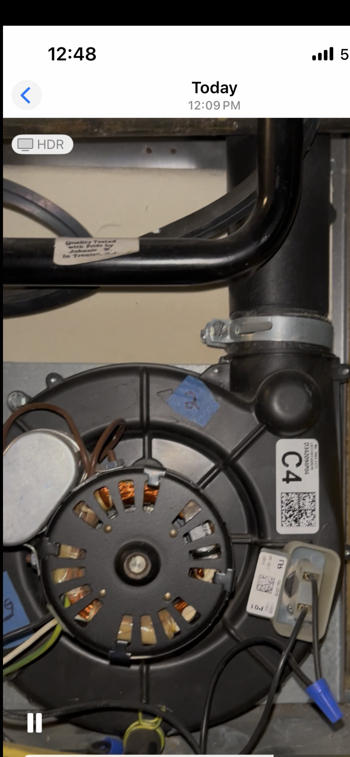

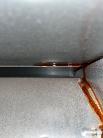

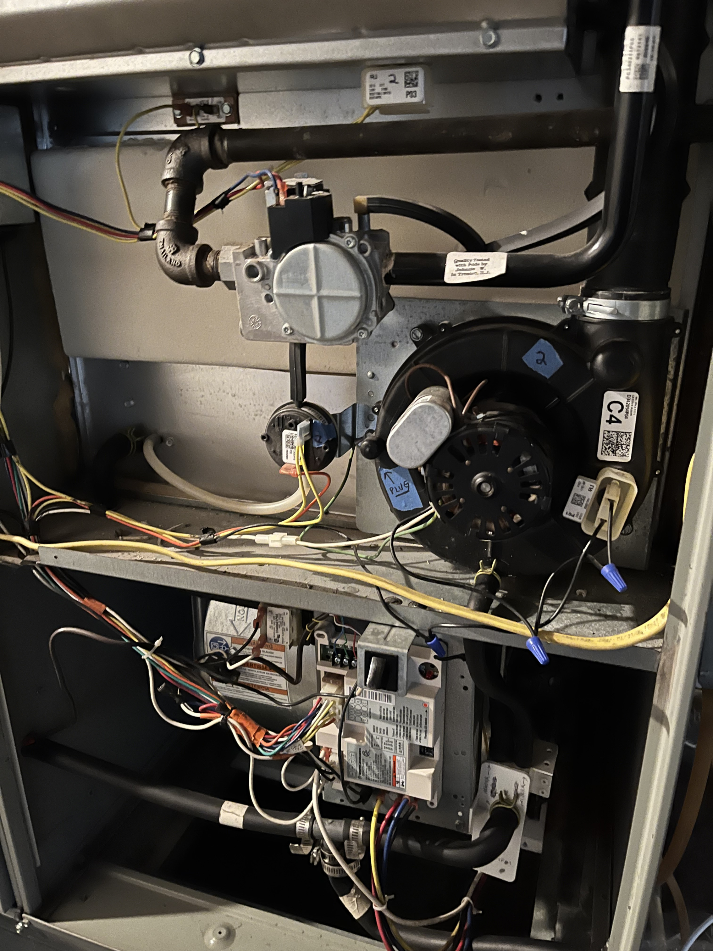

I noticed a puddle under my furnace today. The furnace is two twinned American Standard Trane 120K BTU gas forced air units that operate together (model AUC1D120A9601AD).
I removed the panels and could see the leak right away. There’s a steady drip from the aluminum tray that separates the section where the inducer is and the control board is. The leak is a little more than halfway towards the back of the unit (well past the inducer). It’s dripping on the blower motor.
I removed the inducer and all associated tubing, and flushed the small white collection box. No signs of a blockage or water collecting anywhere.
Yesterday while shoveling the snow I checked the 3” flue gas pipe that exits the house It wasn’t blocked at all, but I made sure to remove all of the snow underneath.
Any ideas on where the water is coming from and what I can do to address the leak? The furnace seems to be operating as normal

    mattmia2 Member Posts: 17,416
    either a tube or the passage a tube connects to is clogged or something is cracked or a gasket is leaking. of the secondary hx is cracked. does the flame change at all when the blower starts? can you see where it is leaking from, i see it is crusty under the inducer fan. also if you don't fix it, it will rust out the cabinet really quickly because in addition to being wet the condensate is acidic
    if you use a funnel and a big cup otr small bucket of water does it pour through the tube and out to the drain feely? if there is a condensate neutralizer those can get clogged. did you take apart the trap in the furnace and clean it?

    I pulled the inducer and all of the associated tubing, including the condensate trap. Everything was clear and free flowing. I flushed the condensate trap anyway and reassembled.
    I cannot see where the leak is coming from. As you know theres a shelf that separates the top of the cabinet from the bottom. Water is dripping from the underside of the shelf into the lower section of the cabinet.
    I told the tech I was concerned it was a cracked HEx, but he felt confident it was not. He said the flame was too steady, and that the furnace would shut down if that was the case. Theres a drain tube that exits the HEx; he pulled the tube off the port and looked in with his flashlight and said he could see some "gunk" and that it needed a cleaning. He also felt that the furnace was slightly leaning to the right, and the drain hose I just mentioned is on the left hand side, so he felt the condensate may not be flowing into the tube as it should.

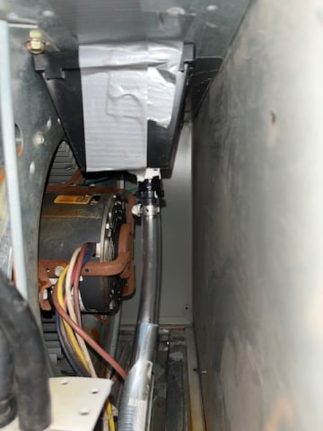

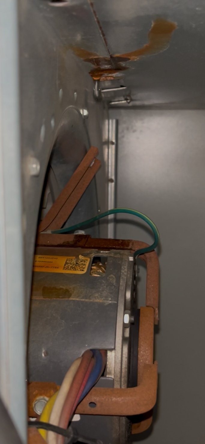

    I dug in a little deeper. Unfortunately no smoking gun. I pulled the inducer and the blower. Here's what I found:
    1. The leak with the blower in place. This is the right hand side of the top of the blower:
    2. I removed the blower. Felt around to what I can reach up inside the opening where the blower is. Mostly everything felt dry, except for MAYBE some dampness on the right hand side. When I reached up on the right hand side I found a small black piece of plastic lying on top. It's probably nothing, but here it is:
    3. I climbed inside and stuck my head up into the opening. I'm in my 60's - definitely too old to be doing stuff like this. Did not see any water dripping, nor did I see any puddled water. In fact, almost everything looked dry as a bone and I could feel dusty grit everywhere. When I looked back towards the front of the furnace (where my legs were) I could see evidence of water because of the rust. But no pooled water.
    I attempted to take some photos by sticking the camera up into the opening at different angles. Most photos came out blurry or simply showed SS coils. The most interesting photo is below, which was facing the camera back towards the front again (interesting because the aluminum isn't straight). The "floor" looks shiny but it is dry:
    That's it for the blower removal.

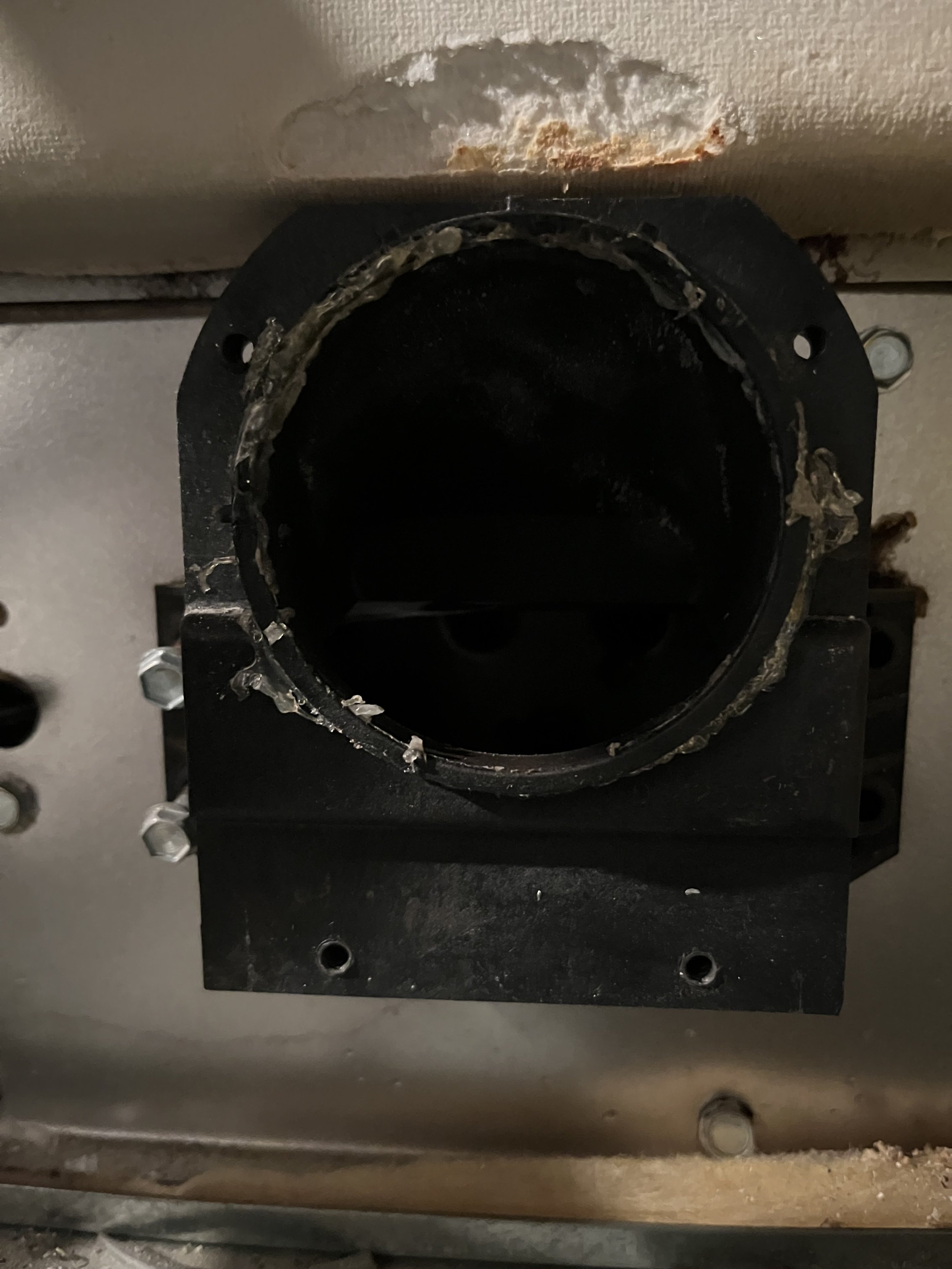

    4. I also pulled the inducer to take a look at the transition piece. I thought more of it would be visible. I did not remove the alum plate in front of it. It looked like this:
    FIrst question: can I easily remove the (5) screws (four at the transition piece, one in the recess to the right) to remove the aluiminum plate? WIll the black transition piece remain in place when I pull the plate, or will it come away with the plate? Anything I need to know for the reinstall? Will it simply slide back into place? Do I need a new gasket or just put everything back together?
    5. Lastly, photo inside the transition piece:
    6. If I pull the aluminum plate, is it much more work to access the collection box and replace the gasket? The new gasket should arrive tomorrow.
    What do you think based on these findings (or lack thereof)? And thanks for providing the confidence to pull the blower. It was pretty easy and straight forward.

    It's most likely that black plastic piece which is called a "RECEPTACLE"..
    When you remove the galvanized metal plate, which I think is just 5 screws (that are typically rusted), then you will easily see the black plastic piece. I can't remember exactly, but I THINK there are 2 more screws that hold the black plastic piece in place, along with silicon adhesive. But this piece should come right off and then the cracks in in will be obvious.
    Again, the cracks in the plastic typically occur where the screws from the galvanized metal plate on the bottom go into the plastic.

    yes, two on each side. All 4 were out. The receptacle still did not want to come out, likely due to silicon on the bottom holding it in.
    I started the reassembly by placing the two screws on the left hand side and then snapped the picture. Before taking the picture, ALL of the screws were out.
  • Slowhand63
    Slowhand63 Member Posts: 150
    Okay, so I went back and removed the inducer AGAIN, pulled the galvanized plate, and cut the silicon caulking around the receptacle and was able to wiggle it free.
    It is not cracked.
    There was nothing I could see with the receptacle removed that indicated where the leak is originating.
    It's gotta be EITHER a cracked collection box OR an issue with the gasket. If I'm lucky it's the gasket. Unfortunately I'm not feeling very lucky.

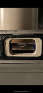

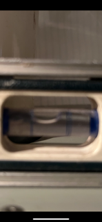

  • Slowhand63
    I put a small torpedo level on top of each of the two side-by-side furnaces. Maybe not the best location to check level, but it was the easiest.
    Although the leaking furnace may be leaning A LITTLE, it's certainly not leaning any more than it's twin:
    Furnace 1
    Furnace 2
    In case you couldn't tell, Furnace 1 is the one that's leaking.

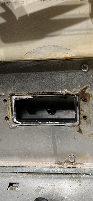

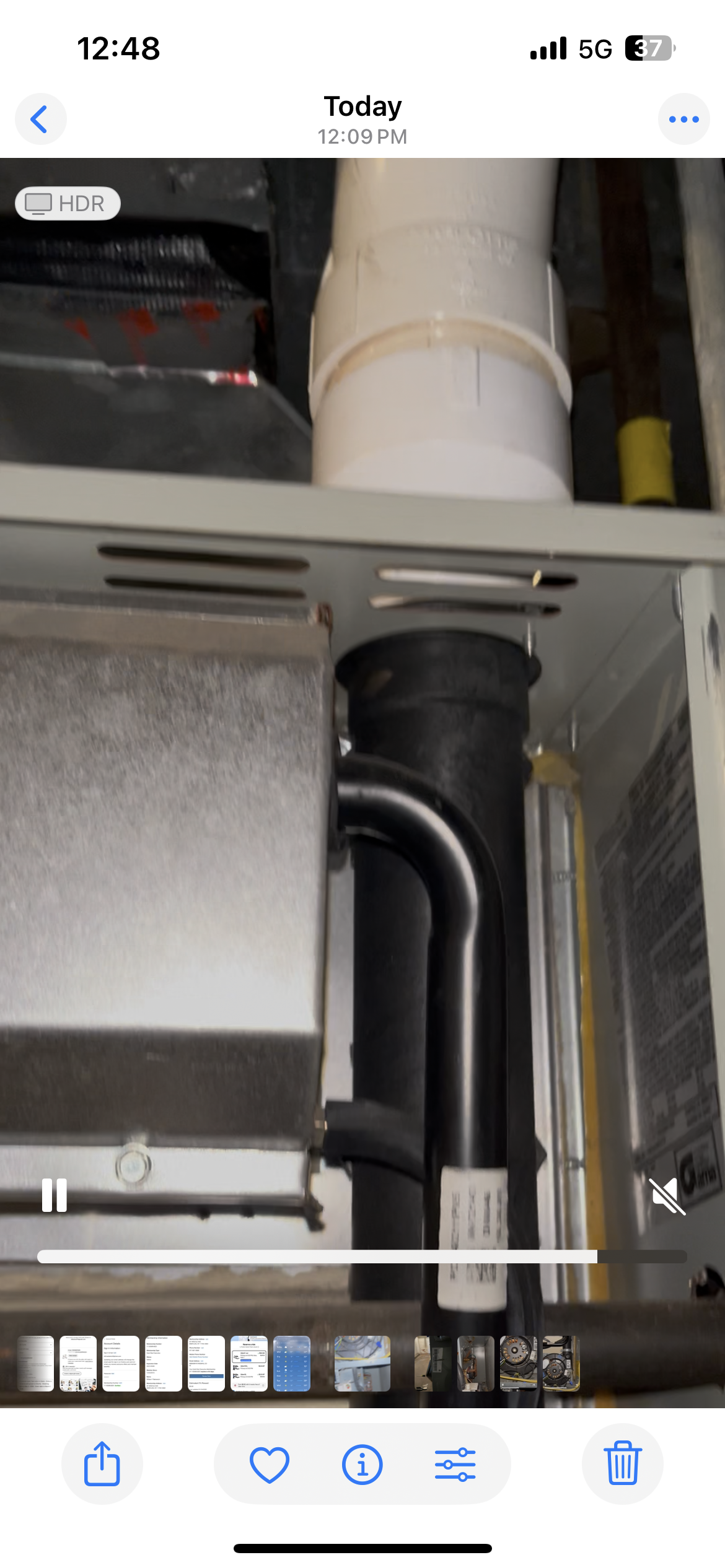

    All - the gasket arrived around 130, and the service tech was here by 2. That's where the good news ends.
    The inducer, receptacle and plates covering the area were removed, though not enough to tell us exactly what is happening.
    For orientation, the inducer and receptacle are mounted on the right, the drain hose on the left.
    What we can see is that the condensate is running to the right, not the left. In a very short time the condensate is gone (having leaked out), but not a drop has come out of the drain hose. Please reference the photo below. Even though the furnace pitch (slightly elevated on the left) is resulting in the condensate running the wrong way, the fact that it quickly "leaks out" tells me that the part isn't water tight.
    This photo shows the location that the inducer receptacle connects to. The drain hose is 12-18" to the left. I am unsure of what to call this black plastic piece… is this the "collection box"? If yes, 1 of 2 things are happening:
    1. The black plastic "collection box" is cracked (although no cracks can be seen, but there's limited visibility); or
    2. The seal/gasket is not properly sealing the unit.
    It doesn't show in the photo, but the black plastic piece is at least two separate pieces, a back part and a front part that have a white gasket/seal between the two.
    The tech said he would investigate further, but if I could identify the black plastic part and/or the gasket material he would further disassemble the furnace to access and replace the part.
    Can someone help me understand what I'm looking at, and if what's described makes sense and how I might source the part(s) I need?
    37 on that drawing is the secondary heat exchanger.
    what is the warranty on the hx?
  • gpjazz
    gpjazz Member Posts: 78
    Yes, I believe it's the entire secondary heat exchanger. I do not think that plastic piece you are seeing is replaceable by itself. The whole secondary heat exchanger would need to be replaced… Which is what I previously said happens 1 outta 10 times.
  • Slowhand63
    I agree that it’s the secondary heat exchanger. Everywhere I look it says “discontinued”. I’ll ask the service provider to call Trane (and also ask about warranty), but if you needed one where would you look? I am located in NY if it matters.
    Oh, also, and ide if there’s a chance it can be repaired? JB weld or some type of high temp epoxy?
    Of course I have no idea at this point if it leaking from the black plastic or if it’s one of the coils. I do know when I pulled the blower and looked up at the coils I didn’t see anything. Car radiators can be repaired… maybe a HEx can also?
