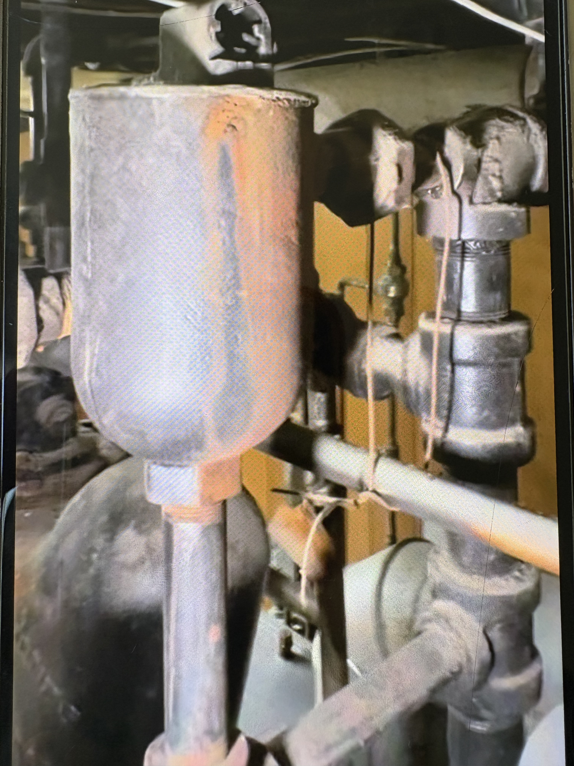

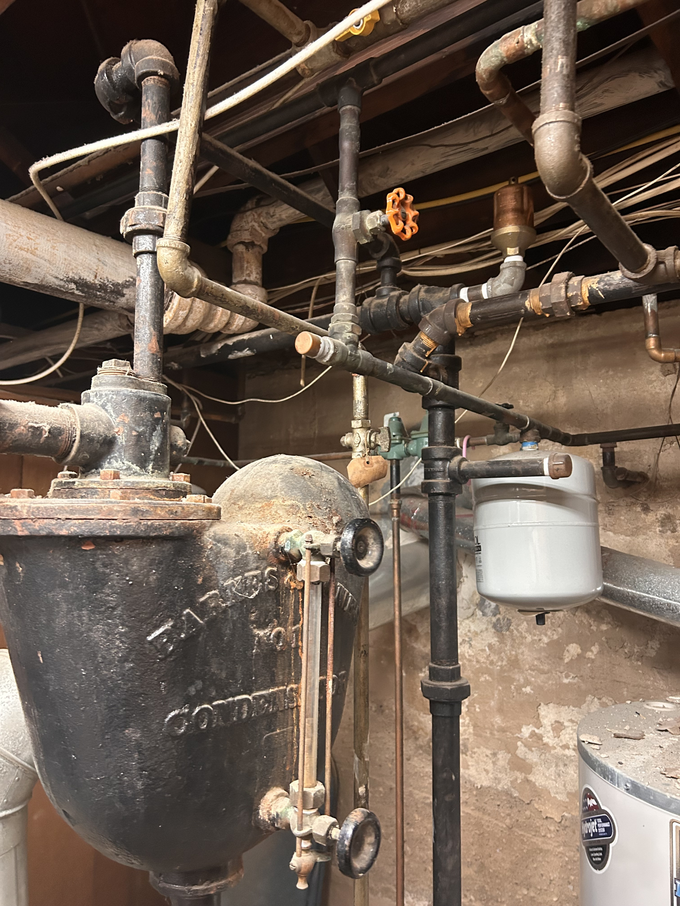

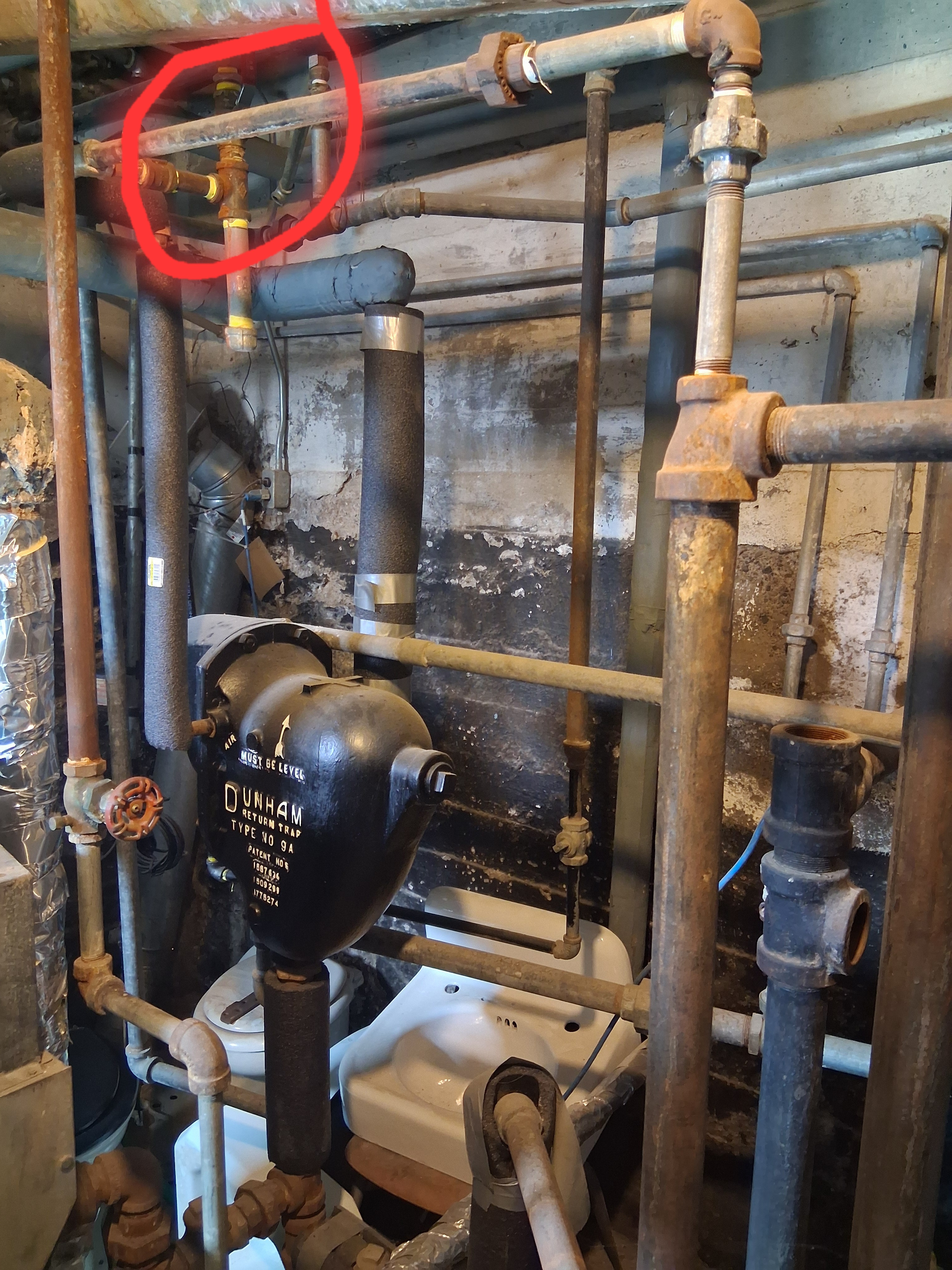

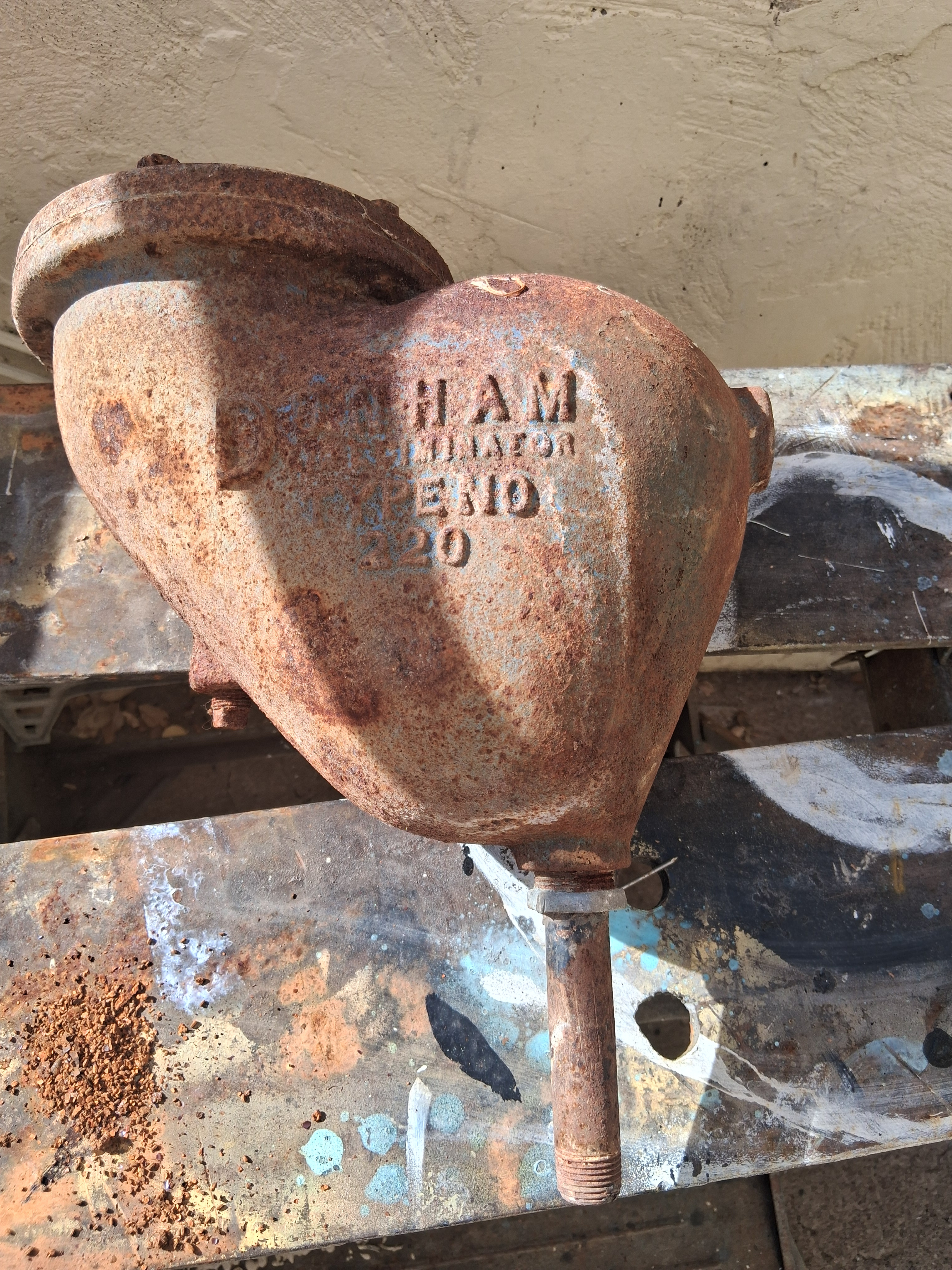

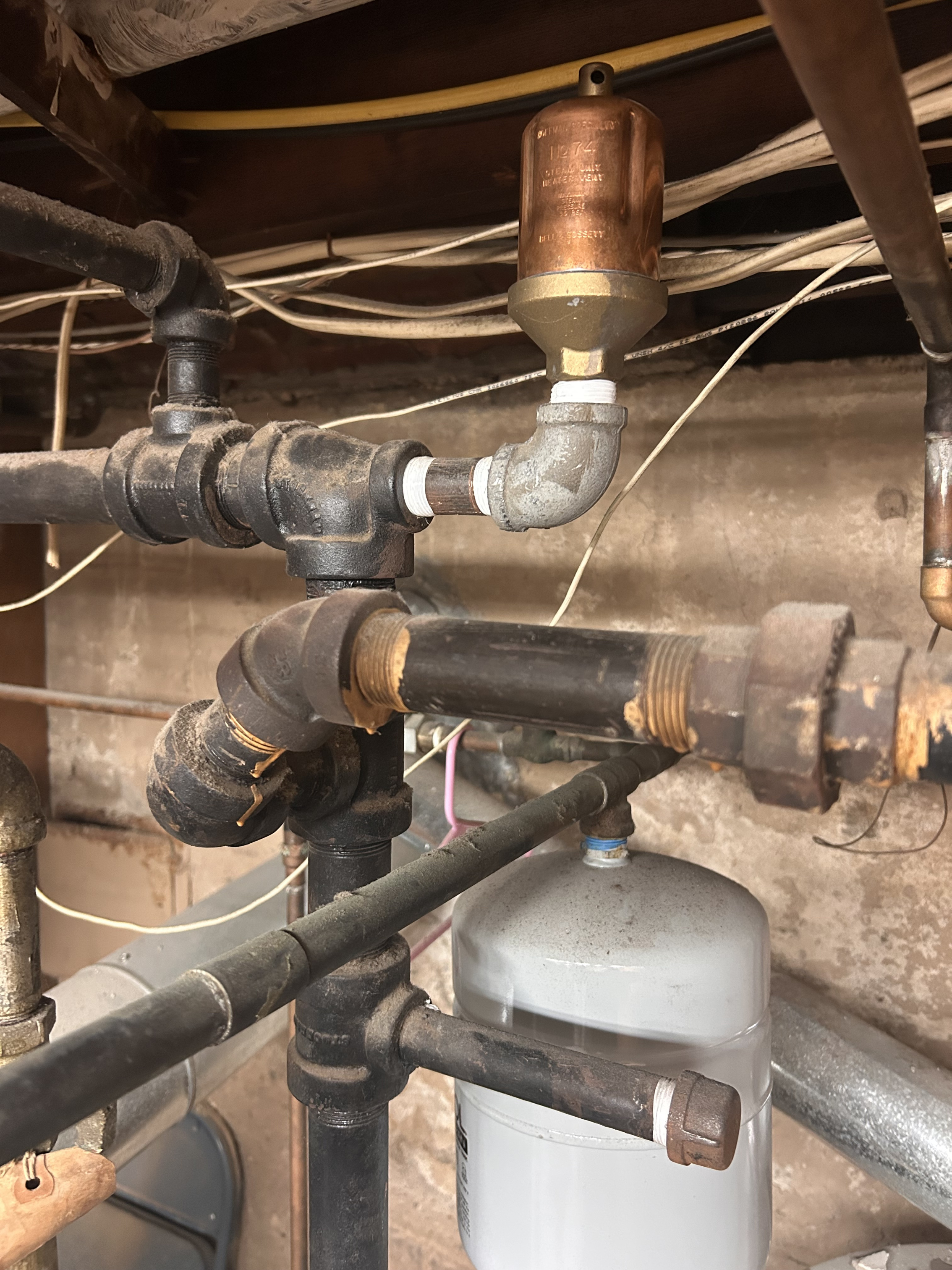

Hi! I have a 2 pipe steam system (see first pic) and 2 return pipes coming back (see second pic ZOOM UP). On the ZOOM UP pic, you can see that the plumber removed an F&T trap (you see tape marking on two pipes) and replaced it with a copper air vent - this was done 3 years ago. I'm recently noticing two problems w the heating - the return pipe on the right is getting hot and the boiler is constantly cycling to hit thermostat temp (it does turn off but turns on again within 1 minute, til we hit thermostat temp). Could the removal of the F&T (replaced by air vent) be contributing to the problems i am having? I've also added a pic of the F&T from when it was removed. THANKS ALL!

    Exact same thing was done to my 2 pipe system but with a MoM vent. I replaced it (was leaky) with a gorton #4, fixed the crossovers traps and increased the venting on the mains. Runs at less then 5inch pounds now. Not really a vapor system anymore but seems happy since the vaportrol never needs to cycle it down.
    Found the original 220, in the crawlspace, I've thought about restoring

    @ACS , that wasn't an F&T trap. It was a "vent trap" or "float trap/air eliminator" designed to keep water from escaping from the system, to vent the air and possibly to hold vacuum.
    The vent they used is a Hoffman #74, which has a very small vent port. I'd replace it with a Gorton #2, which vents much, much faster.

    @Steamhead, thanks… but could the old f&t trap have been serving a purpose other than removing air? should i revert back to f&t? also, if i still go with gorton #2, does the location matter? note: old f&t had inlet at top of returns, and outlet at bottom of returns (you can see tapemarks for old f&t placement in the first pic)… tx
    it wasn't an f&t trap, it was a special vent trap for a vapor system.

    Replace the Hoffman vent with the Gorton #2 and everything should heat faster.

    @Steamhead , i picked up the gorton no 2 but am seeing that it is 1/2". i have a 3/4" pipe where the current hoffman no 74 is. will an elbow reducer (from 3/4 to 1/2) cause any issues or reduce effectiveness of the gorton? THANKS!
    Steamhead Posts: 19,007
    No, but a 3/4x1/2" bushing screwed into the existing 90 will do the job as well.
