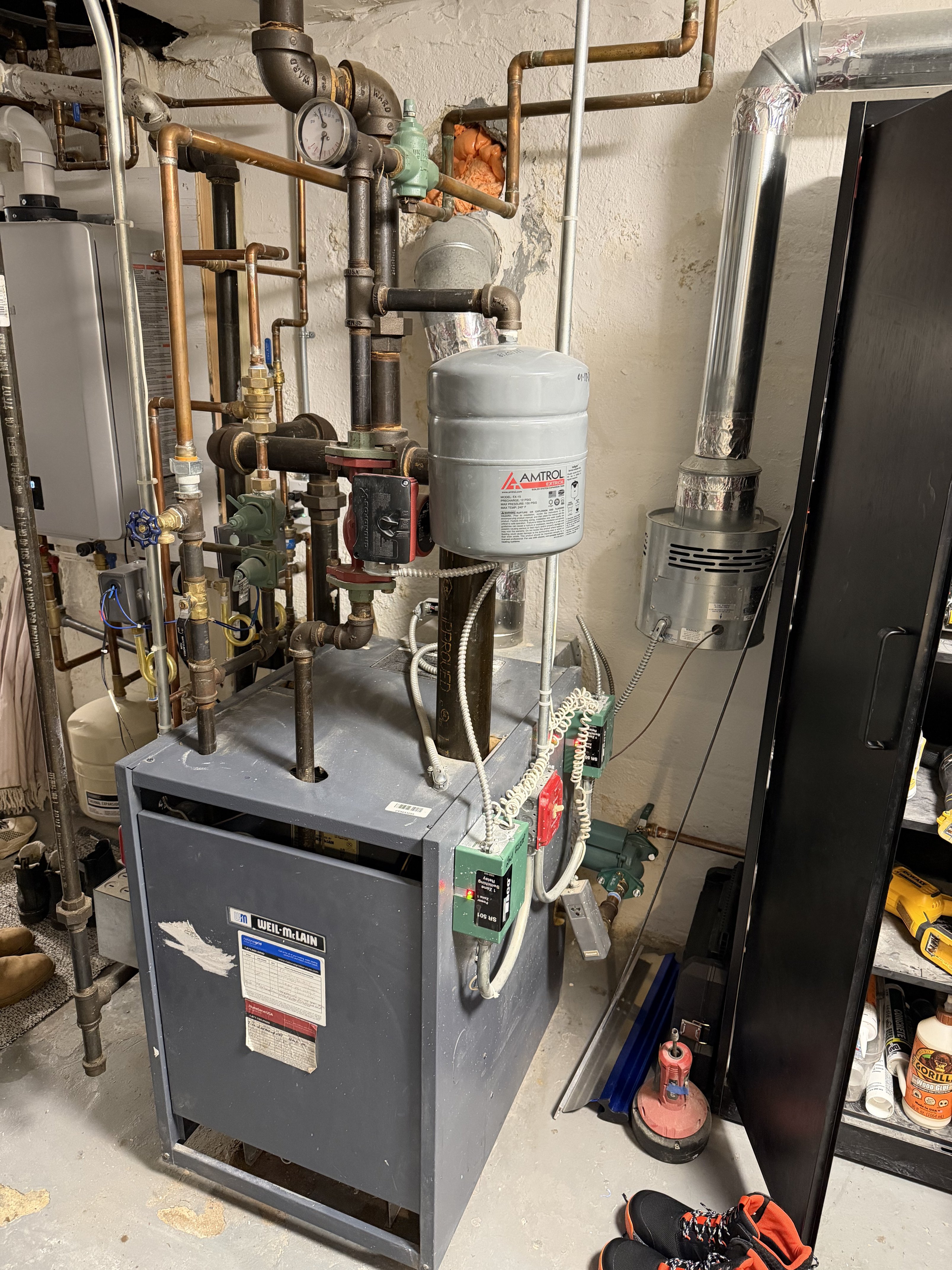

hi everyone, I have been making some improvements to my boiler since buying my first house- I have read that the extrol tank should be located before the circulator pump. Is this true? Also, should I replace the Flo Check and get a new circulator pump with an Integrated Flo Check?

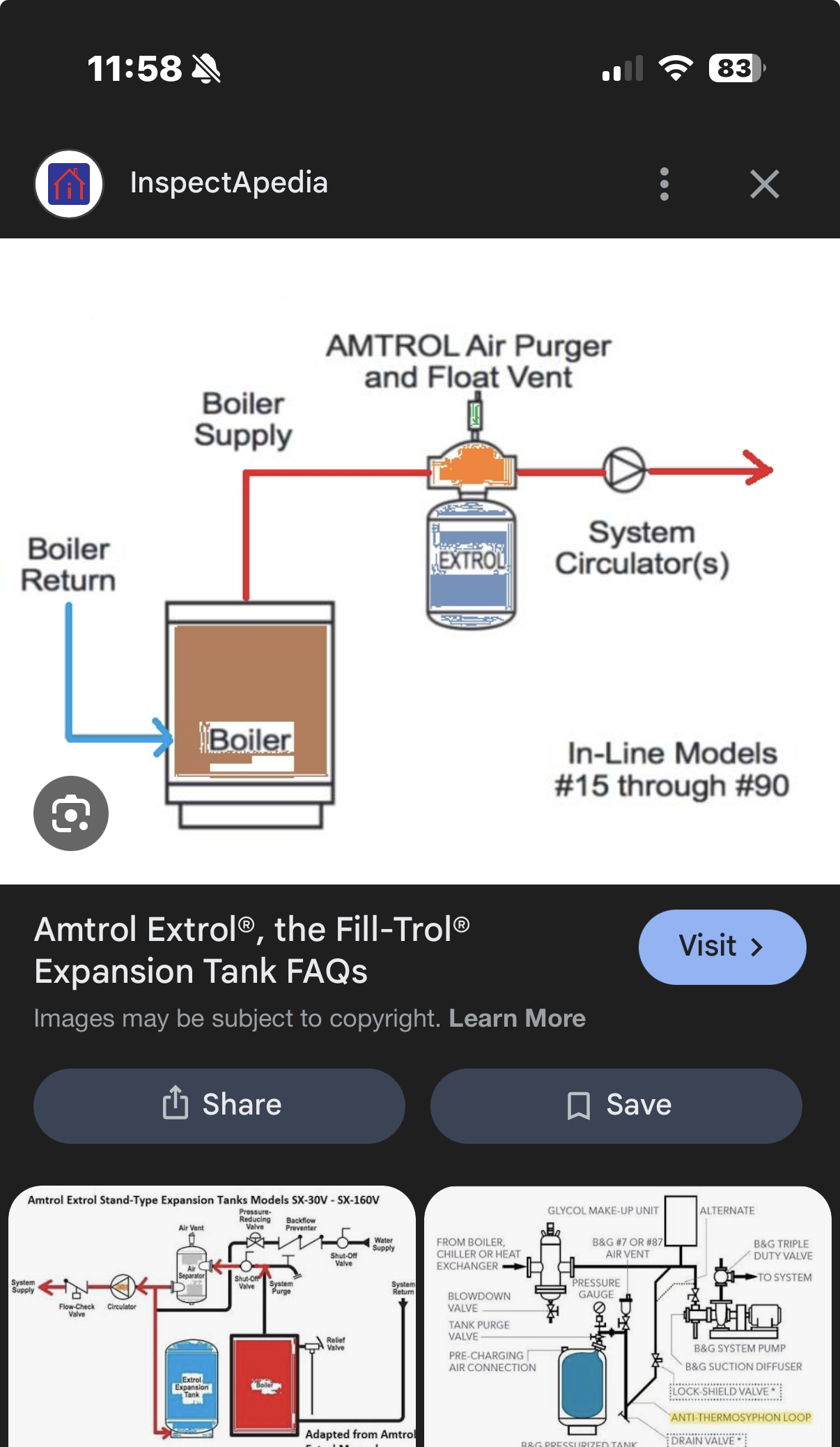

The circulator should be on the boiler supply for best results. If it is on the return its probably ok in a low resistance residential job. Either way you should "pump away from the expansion tank" so the expansion tank should be on the pump suction.

And you should have an air separator before the tank.

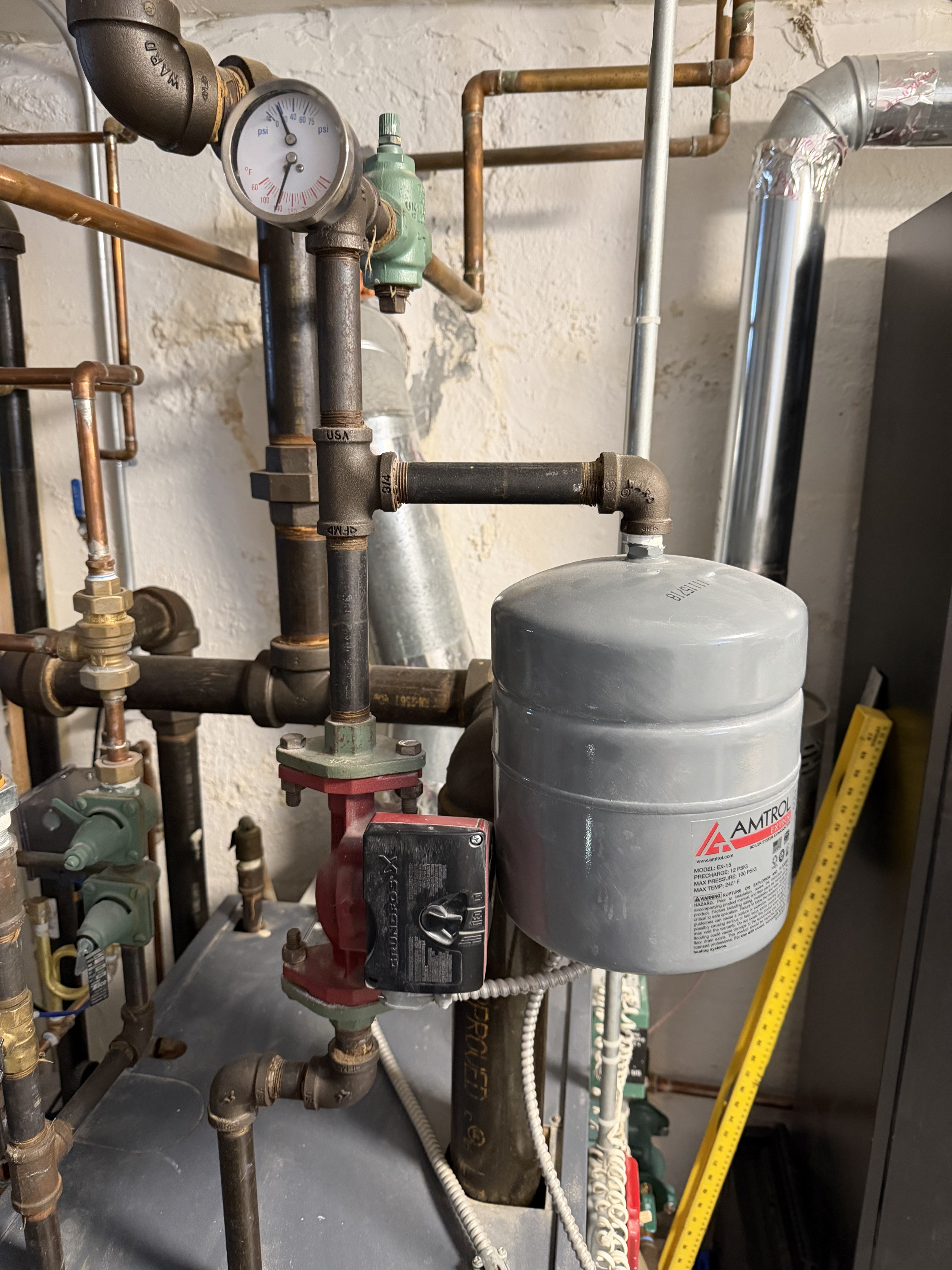

I don't see an air purger in that pic?

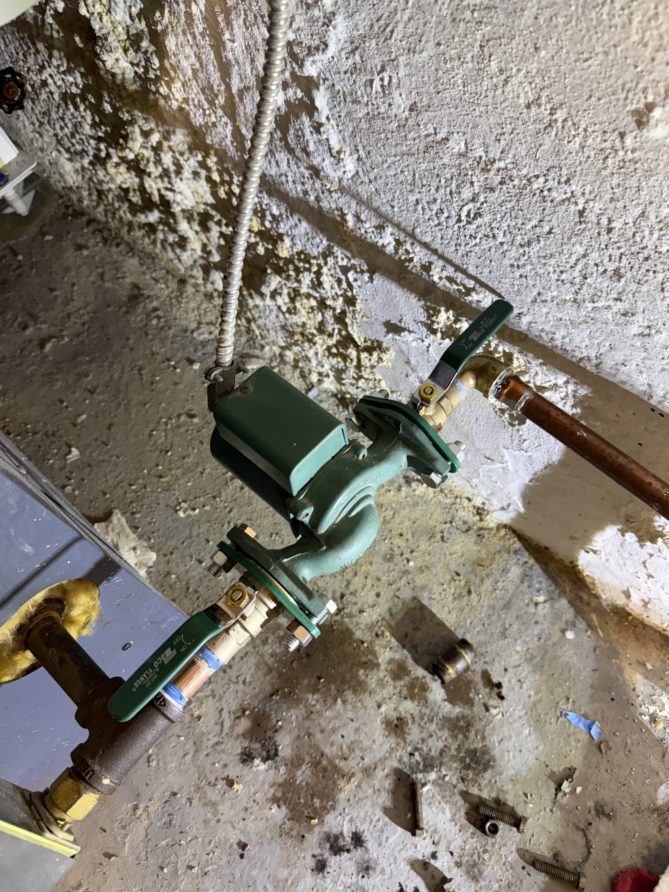

Is there another pump somewhere, maybe lower right side just out of view.

thanks all- the system is a hydronic and steam system. There is another pump for the basement hydronic zone. Pic attached
there is not currently an air purger. I am getting air in my top steam zone
thanks for the correction. I meant that is has steam heating and a hydronic zone. So you are saying, air purger/ tank, then circulator pump?

Looks like steam boiler, with a tankless coil. Seems like there are two water zones. One coming off the bottom of the boiler, which does not need any of the typical hot water apparatuses. The other zone, is a traditional hot water zone, which needs the pressure reducing valve and the expansion tank... If things are working properly, it's probably not worth the efforts to make any major changes. Always good to come away, but on smaller systems, not as critical

thanks so much. You are correct. Everything is working, except that there is some excess air in the system in the upper zones which I’m trying to eliminate
