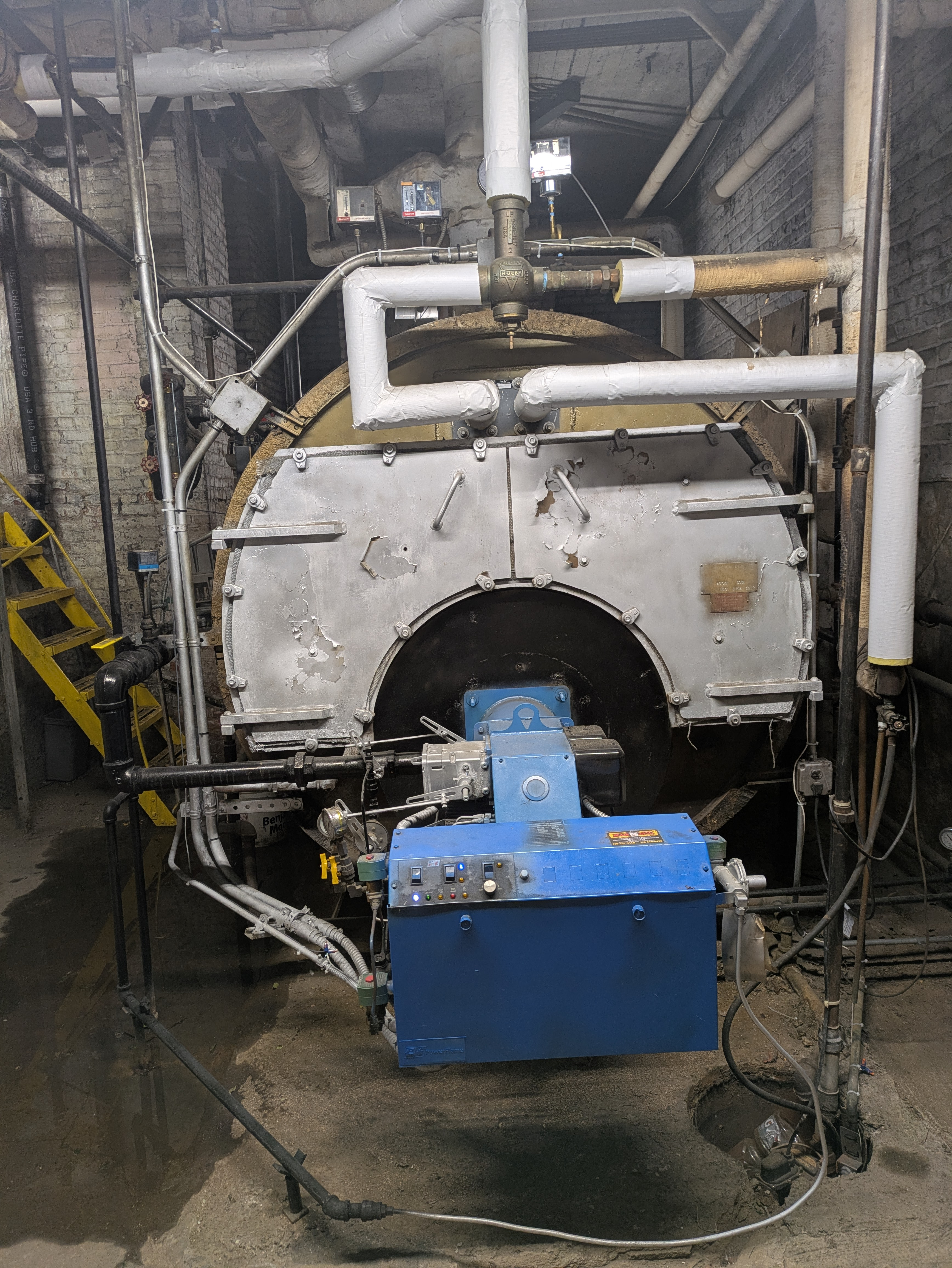

Hi I have a 100 HP boiler in a NYC co-op building (see pic). I noticed when the boiler stops calling for heat the pressure drops from 2 PSI to zero in less than 2 minutes. Is this unusual?
That is expected. When new steam is no longer produced, the steam in the system quickly collapses (condenses) to a small amount of water which greatly reduces any positive pressure to or below zero psig
That Power Flame burner has full modulation. If set up correctly the burner should start on a drop in pressure (from the operating control) and go to high fire. As the pressure builds the modulation control should cut the burner back to lo fire or mid fire based on the rising steam pressure. If the burner produces less steam than the load requires the burner will drive to high fire. if THE BURNER PRODUCES MORE STEAM than the system needs it will modulate to low fire. If the building load requires less steam than the boiler produces on low fire the pressure will rise and the boiler will shut down. This lengthens the burner run time and the purpose of the modulation is to balance the burner firing rate to match the load and reduce cycling.

Ed, the modulation on the burner only kicks in at 2.5 psi. I set both the pressuretrol and modulation at their minimum so that is what I have. The pressure rarely gets close to the 2.5 PSI. This system was run at 5+ PSI before I arrived. Originally I wanted to use a vaporstat but was told that the power flame doesn't have a modulator at those low levels.

I'm not worried about the quick drop in pressure just curious. In the rare instance when the pressure cutoff is reached while still calling for heat it will restart again for a short period. That's why I would like the modulation to take place earlier to prevent this. But again doesn't happen often. Yes it has a weighted damper and I do run the water at nowl
