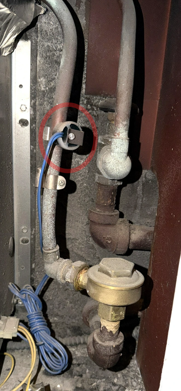

    @KateRomanelli , can you try tapping the aquastat to see if it stops the fan? They get hung up sometimes.
    Can you see what temperature the aquastat is set to, and is there a differential? You might need to take the cover off.

  • Thank you all! If i take the cover off it looks like this: Included in the four pictures is also the wiring diagram. I am not sure how to find the aquastat, does it look like a thermostat? Thank you!!
    edited January 26
    This is the um…"aquastat". It is just a fixed snap disc thermostat that presumably turns on the blower when the outlet of the steam coil is hot. It might work better on the inlet.

    Take the disk limit off the pipe and see if it stops.
    All the switch settings are correct?
    seems like the outlet would only work if the steam makes it to the trap. if as soon as the blower comes on it starts condensing all the steam that is entering the return will cool an depending on the setpoint of the snap disc thermostat it may turn off then the return fills with steam again, turns the thermostat on and the cycle repeats.
