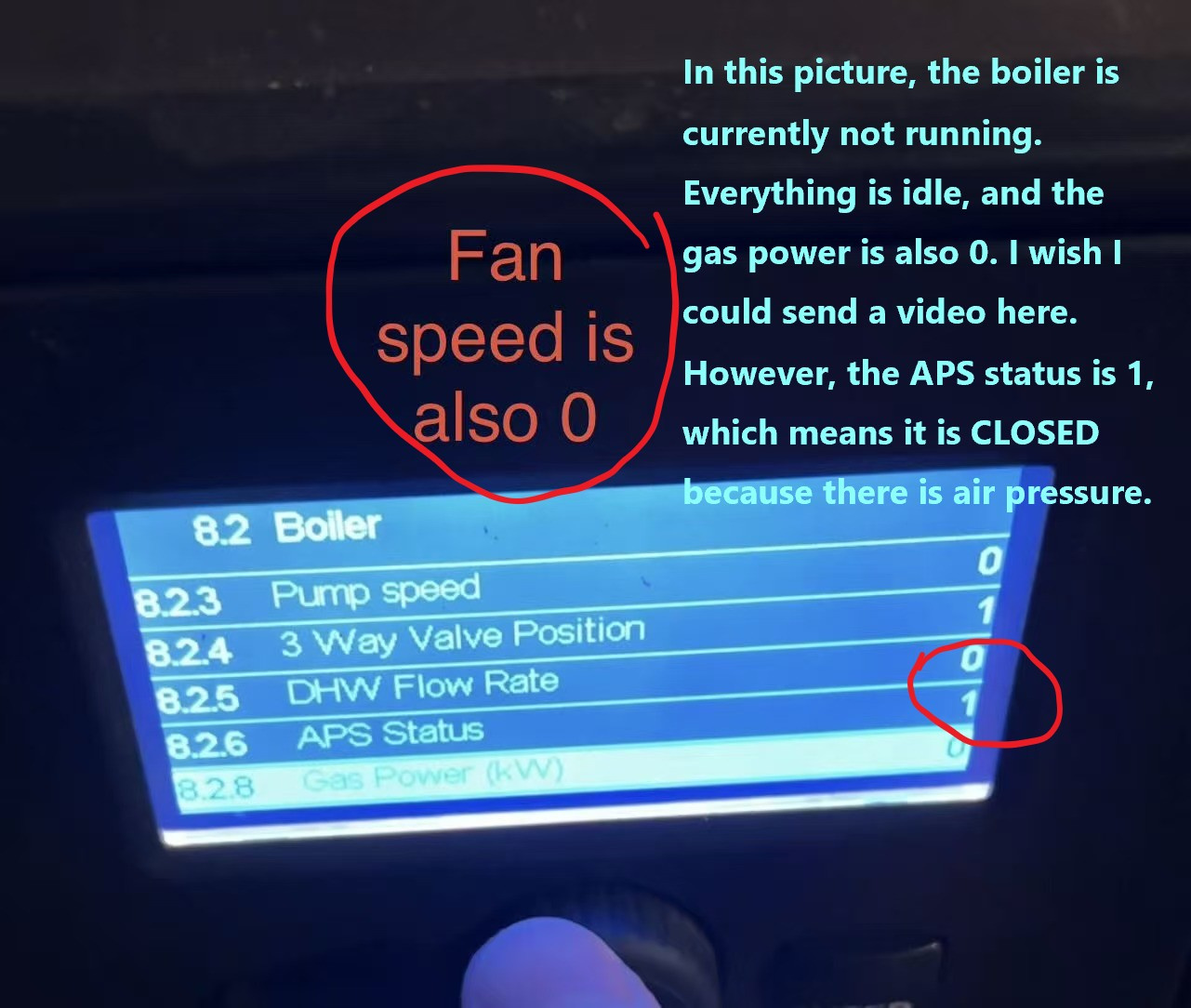

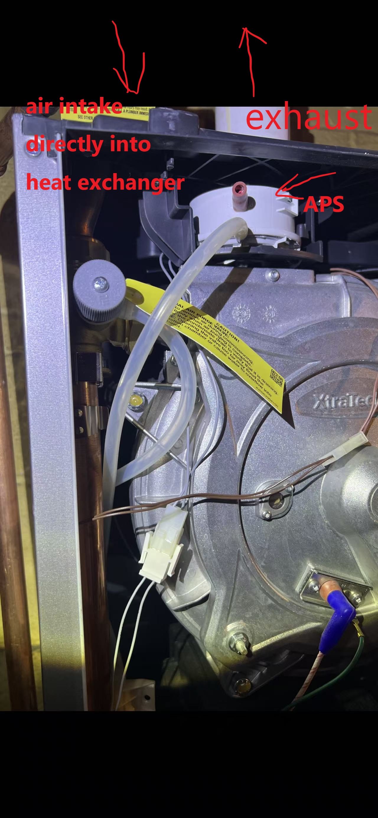

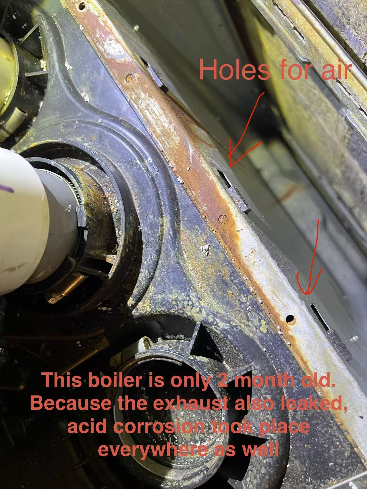

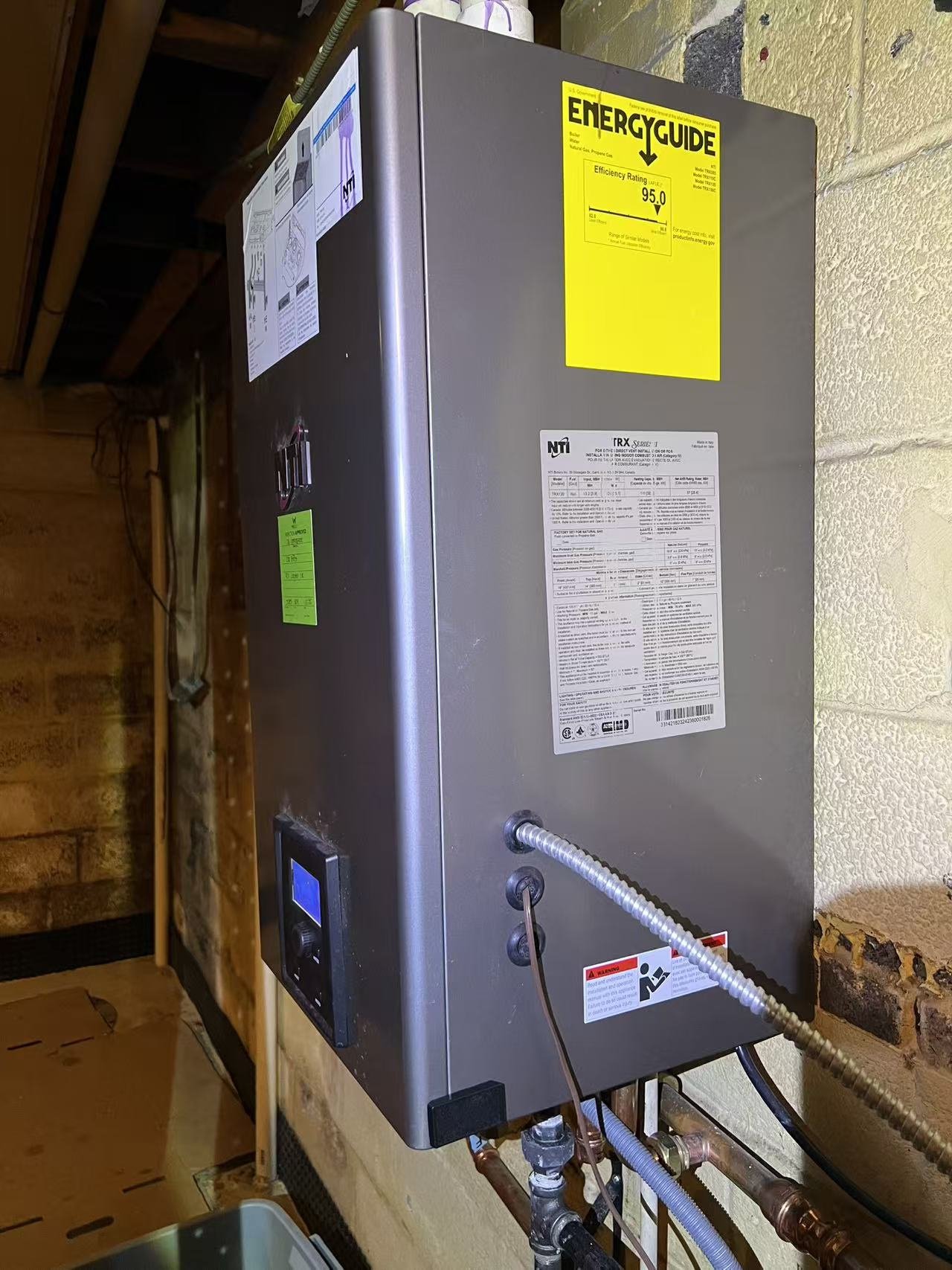

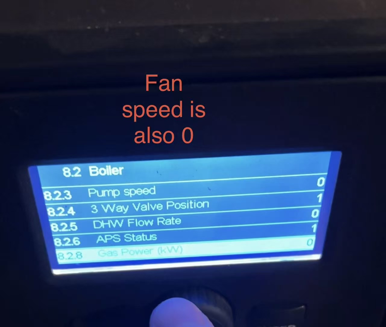

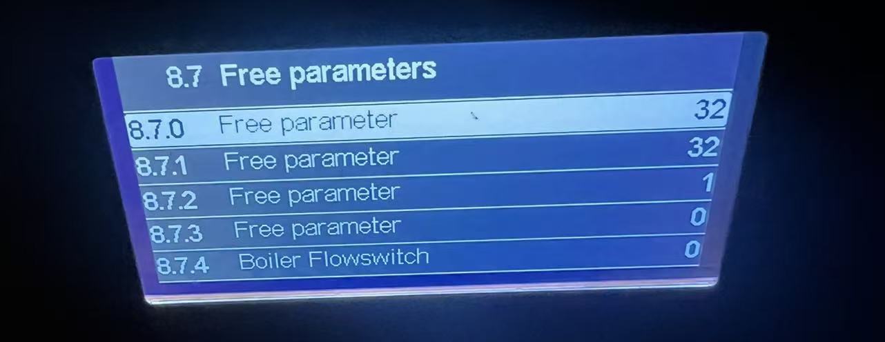

Basically, someone installed this gas boiler in my basement last year..and ever since then, there have been so many things going on. They didn’t take the air intake cap out, the exhaust started to leak, and while I am not a boiler technician, I recently started to do my own research about how the boiler could have been running for about six weeks while the air intake cap had been hermetically sealing the system for so long.
I recently discovered on my own that when the boiler is not running, the fan speed is 0, the gas power is 0, while the APS status is 1, which, based on my research, means the air pressure switch is closed. More surprisingly, there is no error code displayed on the screen.
Is this even possible? Is it possible that they likely manipulated the wires, trying to cheat the air pressure sensor so that it is always closed? Subsequently, is it possible that they also manipulated the main control board to silence the machine from reporting errors?

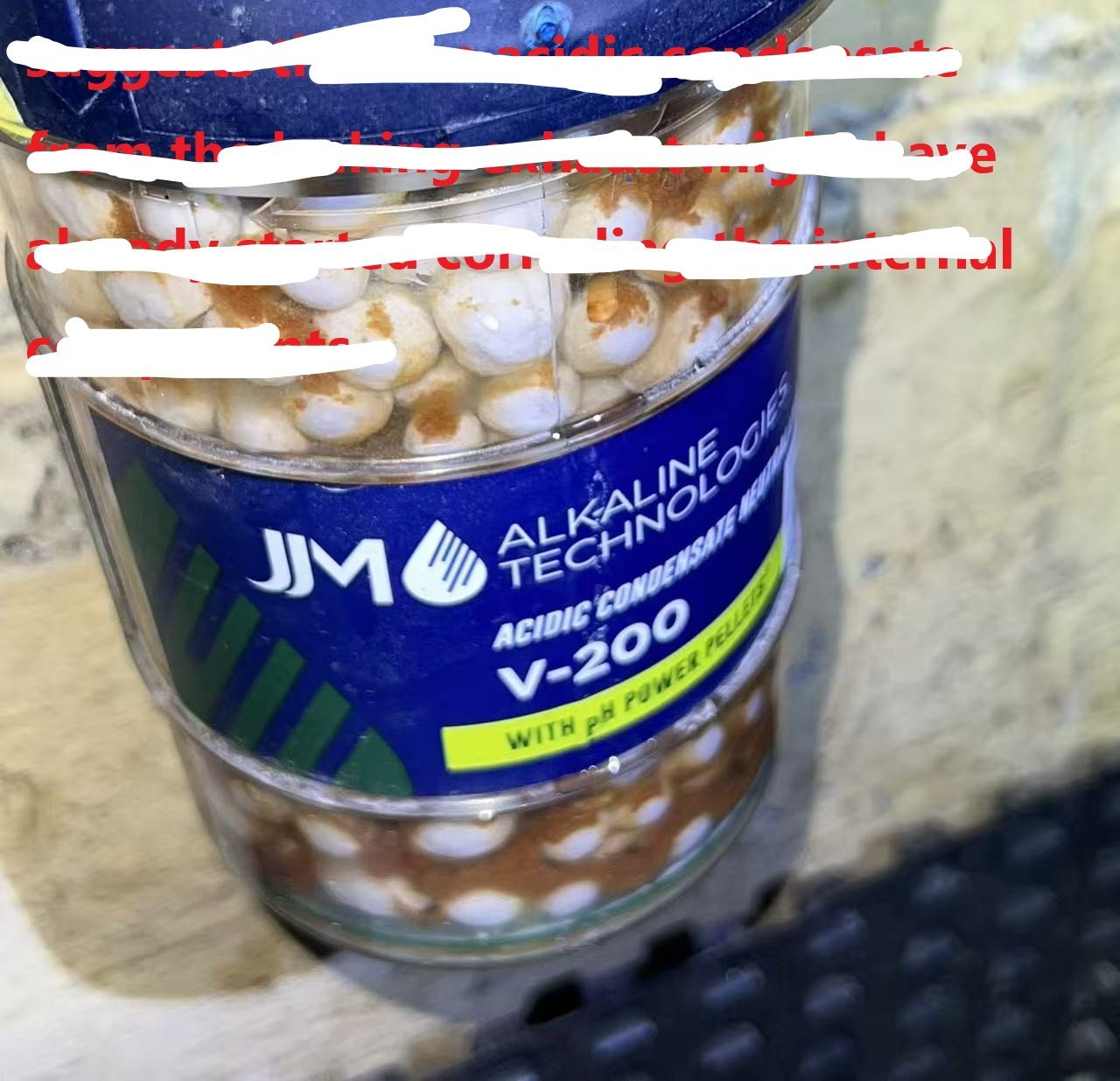

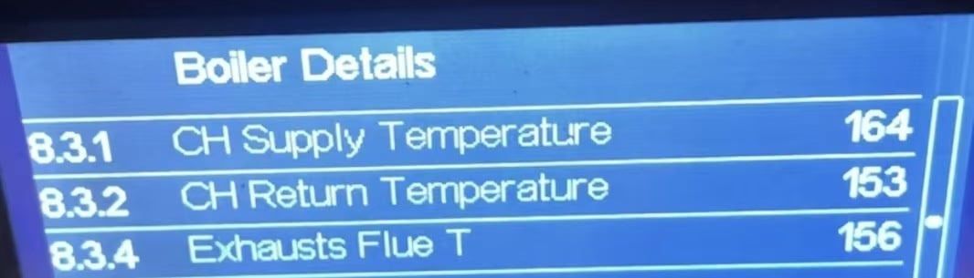

Also, it is really cold outside right now, and I noticed the exhaust flue temperature is 156, which, based on my research, is a very dangerous temperature for the exhaust PVC pipe as well. Is it possible that they also bypassed something so the boiler never shuts itself down?
This company says "nothing is wrong"...... while it is temporarily working though and I have to keep it on just because it's freezing outside… and nobody is sending me a commissioning report…
UPDATE 1/25/2026:
Thank you all so much for replying to this post!!! I want to clarify a few things. The boiler is currently running and providing heat, and the air intake cap was removed about six weeks after installation. There are no error codes currently being displayed.
The confusing part is that when the boiler is NOT running, it still shows APS status 1, meaning it is CLOSED (because the control board thinks there's air pressure). The boiler is not detecting this as an error, and everything is still working.
Air Pressure Switch always closed.jpg APS STATUS 1.png APS ALWAYS CLOSED.jpg

    hot_rod Posts: 28,704
    the flue temperature tracks closely to the water return temperature.
    What temperature do your heat emitters need.? Staying below 140 will allow the boiler to condense and run more efficiently.
    The lower the return, the more it condenses.
    Mod cons are used in high temperature systems.
    Don’t get started on the PVC pipe compatibility, that concern has been going on for many years
    IPEX makes a tested and approved plastic venting product, Centrotherm and a few others.

    Thank you. My real question is: how could the boiler even run with the air intake cap sealing it? I thought it should have locked itself immediately, unless someone bypassed the air pressure sensor.
    Currently when the boiler is not running and there fan isn't running either, the air pressure switch sensor says it is still closed.

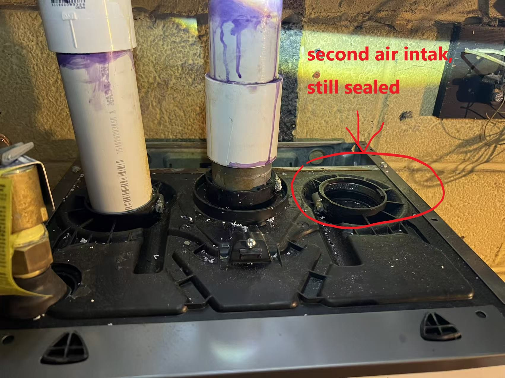

    That is exactly my concern… the technician didn’t even remove the intake cap for six weeks, and there’s no way the boiler would have kept running without shutting down. So, I don’t know if something was bypassed. According to NTI support, APS Status 1 means the APS is CLOSED because there's air pressure—but the intake cap was never removed.
    does the air intake pipe directly to the inducer fan, or just into the boiler cabinet? Some boilers have air into the cabinet, if so possibly the door was off or leaked enough air for the burner.
    I doubt it would even light off with no air at all available?
    I’m not sure what you mean by intake cap? Was this on the air intake termination, or at the boiler? What purpose would it have served?
    109A_5 Posts: 4,759
    More pictures would help.

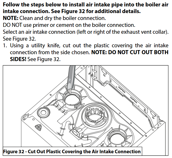

    It is an NTI TRX boiler. The intake cap came with the boiler, and someone needs to physically cut it off with a knife, not just remove a plug.
    The cap has been cut off now, but I started to get curious, how is it that if there was no air pressure, there were no error codes? The air pressure switch should have shut off the boiler immediately. (Actually, that’s what happened when they first installed the boiler, they couldn’t turn it on.)

    Also, the cap directly seals the heat exchanger, it seems. I overheard the technician say that 100% of the air is coming from the intake pipe. I;m not a technician though

    the left one!! yes that's the manual,,, they never cut that thing open…. and the boiler was running for almsot 6 weeks……….. no the right one is not being used
    it's open now though
    109A_5 Posts: 4,759
    So they installed the air intake pipe to the outside and never cut out the plastic covering ?
    Does it work better now ?

    yes exactly, it is working now, the point is, the first day they started the boiler, they said that something's wrong, and they talked about missing a part of 'coil' or 'board', and i highly suspect they bypassed the APS sensor for it to run, because this boiler is not designed to use conditional air to combust

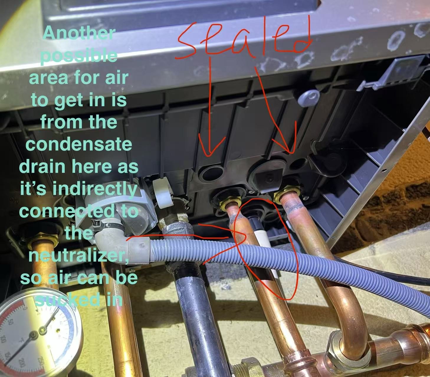

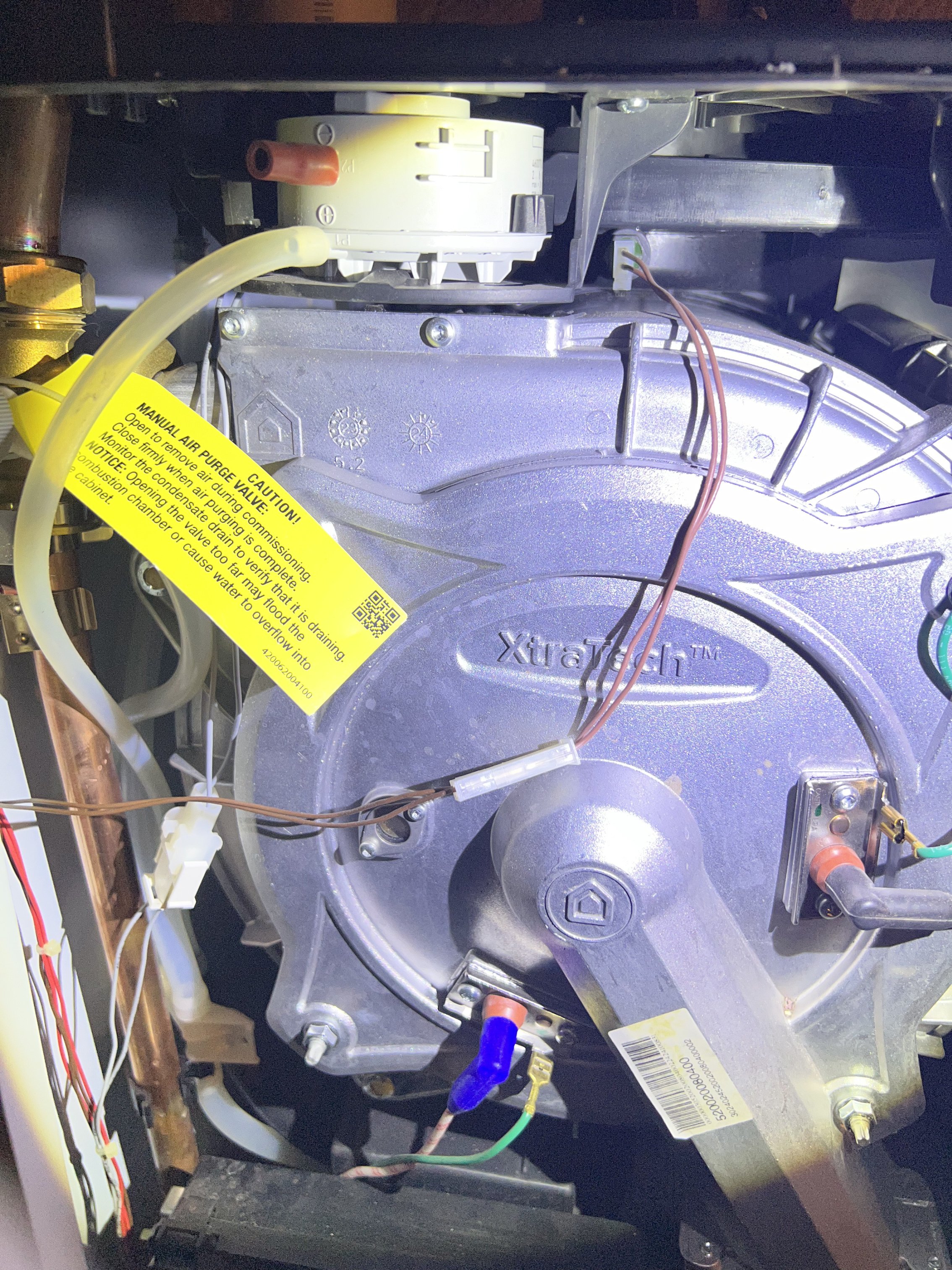

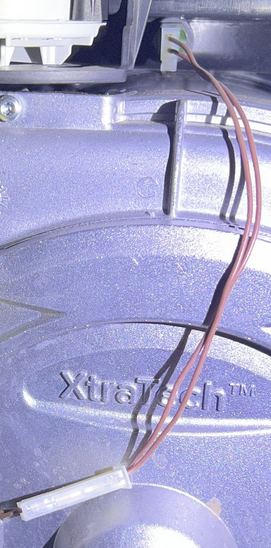

    Attached is another internal photo. These two disconnected wires hanging inside the cabinet are highly suspicious. My assessment (again I'm not a HVAC technician at all) is that the Molex connectors were tampered with to manually jump (bypass) the Air Pressure Switch (APS) and the Heat Exchanger signal (maybe related to like a temperature sensor?).
    By hard-wiring these connections, they effectively forced a 'Closed' signal to the mainboard, tricking the boiler into firing. Normally, with the intake cap sealed, the air pressure sensor would never close naturally due to the lack of airflow. Without this manual bypass, the boiler would have correctly remained in a safety lockout state

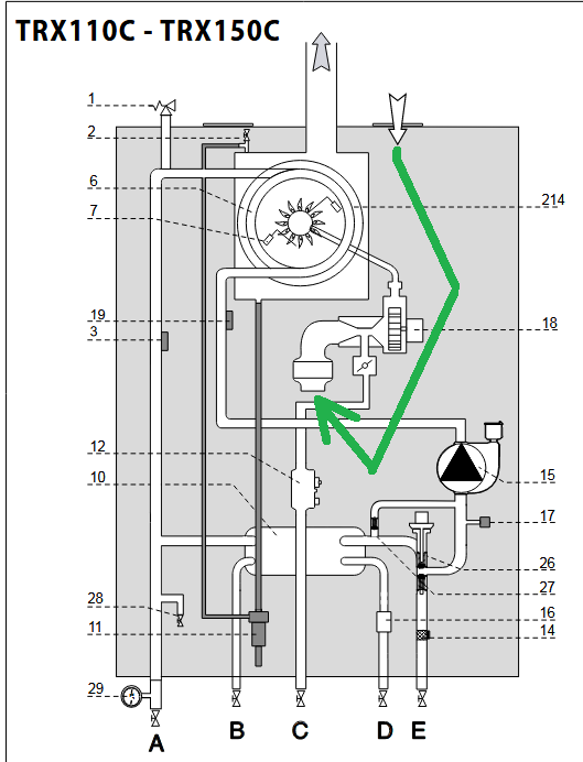

    this is the manual, they never cut the plastic off and attach a PVC pipe to it (the PVC pipe goes to the outside), so there's been no oxygen intake, until this day, I have no idea how the boiler was running, it was definitely producing a lot of carbon monoxide for sure.
    This unit is a sealed combustion system. It is strictly designed to be hermetically isolated from the indoor environment to prevent dust, debris, and contaminants from entering the heat exchanger, I did found out that the technicians intentionally removed a rubber grommet (sealing plug) from the chassis. This was clearly a makeshift attempt to allow unfiltered ambient air into the sealed cabinet to sustain combustion

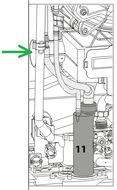

    109A_5 Posts: 4,759
    I don't see anything disconnected. The connector in the middle of the picture goes to the flue gas temperature sensor.
    This looks connected also.
    Looks like the air comes into the cabinet. Then into the intake manifold.
  • bwu0518
    bwu0518 Posts: 28
    THANK YOU SO MUCH! I think this visual explains it all. If there’s no air coming from the external intake, it must have been drawing air from inside the boiler through a leak. Since the boiler is supposed to be hermetically sealed, this also explains why the APS sensor would have needed to be bypassed, as the only locations that could provide air through a leak wouldn’t supply enough pressure…….

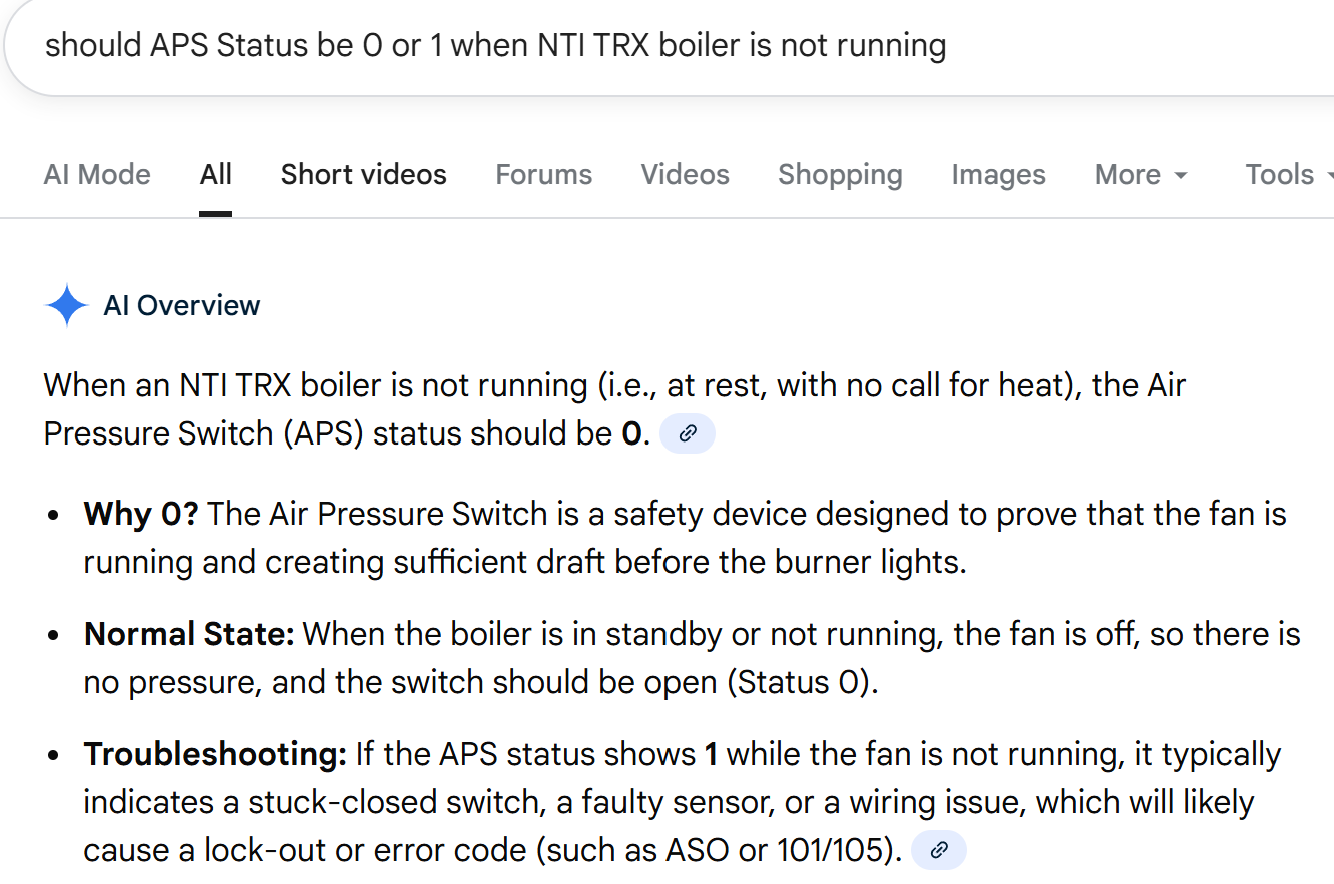

    now the second question is… on the boiler screen, if the boiler is not running & there's no air pressure, the APS still says status 1 (which means its closed)
    109A_5 Posts: 4,759
    I think the Air Pressure Switch is for a purpose other than (or in addition to) what you think it is for.
    Since the condensate trap probably has the proper condensate level in it the Air Pressure Switch is happy.
    EdTheHeaterMan Posts: 12,948
    edited January 25
    Some Air Pressure switches have only a normally closed set of contacts, Other APSs only have a normally open set of contacts, and there are others than have a single pole double throw SPDT set of contacts where there is a common wire and one normally open contact and one normally closed contact. Without knowing how NTI wires up their system, it is difficult to say that a switch is open (off) or closed (on). So that is why I didn't use off or on in my previous explanation. But for clarity and not accuracy I will use on and off to describe the condition of the heater flame.
    If the flame is off the APS must be in the flame off position in order to start the turning on process. If the APS was jumped, or bypassed to the flame on position, the system can not start.
    Once the start sequence turns on the fan, the APS needs to change from the flame off to the flame on position or the gas valve can not open to make a flame happen.
    That is why @109A_5 indicated that the APS is "happy". This means that no one has jumped, bypassed or adjusted the APS in order to make the heat operate. There must be another reason for your system operating with both of the air inlet cut outs still in place. It has nothing to do with the APS.

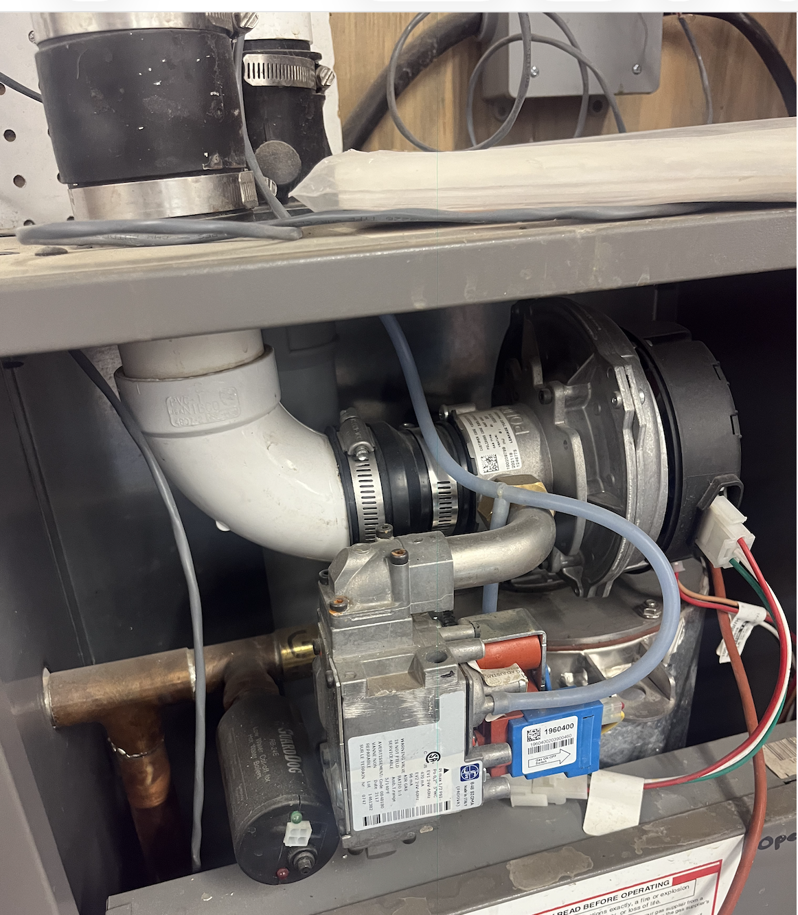

    I don't see intake air direct connected to the fan?? Air piped to the fan looks like this. Exhaust directly behind.
    Most all mod cons allow you to pull inside air if the room volume is sufficient. Following the manuals requirements form "all inside air"
    So the air just comes into the case, as I see it. I doubt the case is hermetically sealed! Every wire and pipe that goes into the case has some air leakage.
    I highly doubt that boiler would fire if the fan was getting absolutely no air? How would it push air into the combustion at all if it were 100% blocked. It's really no different than blocking the outlet of the fan, air movement stops.

    This helps a lot. I really appreciate it. This kind of explains why it was still burning, because it was probably sucking air from the condensate drain. This is how the neutralizer looked after running for about six weeks. That brownish-colored residue definitely suggests that something inside the boiler corroded.
    With that being said, I still think someone jumped the APS because right now when the boiler is off, with no air and no gas, the boiler screen still says the APS is CLOSED. I also think someone bypassed some settings in the control board to let the boiler keep running because I got confirmation from the manufacturer that this suggests something is indeed incorrect.

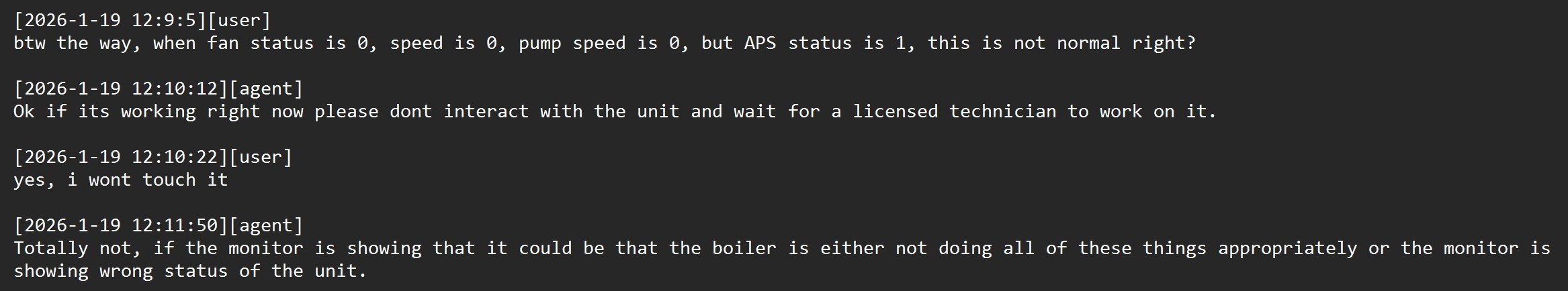

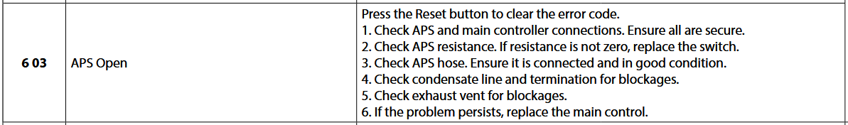

  • bwu0518
    bwu0518 Posts: 28

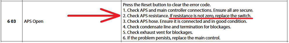

    Honestly, I don’t think the APS is really “happy” 24/7. I confirmed with the manufacturer that this would suggest the APS is always “happy,” regardless of whether the boiler is on or off.
    For your reference, APS status 1 for this boiler means the APS is closed.

    And by the way, there is always going to be colored discharges thru the condensate drain. It is the nature of burning fuel. Stuff that is in the air that is not actual air will do funny stuff when it comes in contact with a fire flame. There are also impurities in the gas you are purchasing from the gas company. Nobody is perfect, including the guy that filters the gas before it gets to your home. And the combustion process actually takes the hydrocarbons the gas is made up of, and converts them into other stuff like carbonic acid. That is acid made up of carbon and other byproducts of combustion and does nothing to heat your home but will eat away at the innards of your heater.  You may need to replace that heater in about 17 to 29 years as a result of that stuff.
    You need to remember your home is not a super clean laboratory and therefore you will get some stuff that is not necessary to heat your home but will get exhausted into the air and the condensation that leaves the boiler.

    yes, the boiler casing is meant to seal the entire
    I attached more pics. There are indeed spots where air could be sucked in, but not spots where air was supposed to be drawn in. So even if there was combustion, it was definitely severely incomplete combustion thus producing highly concentraded carbon monoxide

    Thank you all for replying again!!!!!!! I genuinely appreciate the feedback, especially since my post has been getting removed from other places for no apparent reason. I took pictures of all sides of the boiler and shared them earlier in a reply. I agree with everyone’s points. If there truly was no air, the unit should not have burned gas or initiated combustion at all. Even so, any locations where air could have leaked through would definitely not have provided enough airflow, so the air pressure would not have been sufficient to trigger the APS to be ready for combustion.
    I think we should move on to the next question that needs further investigation. How is it possible that when the fan speed is zero, gas is zero, and the boiler is not running, the APS status still says there is air pressure, the air pressure switch is ready, and ignition can start?
    running without adequate air may have damaged the air prove switch
    Its hard to reverse troubleshoot, but you know the corrections that need to be made
  • pedmec
    pedmec Posts: 1,488
    You can't jump the air pressure switch. With any mod-con boiler when there is a heating demand enabled it goes thru a self diagnostic to ensure that all the safety devices are in their correct position. if any safety switch is in the wrong position it will not allow the boiler to start. it will give you an error code. you can try it yourself by removing a wire from the switch. its to prevent techs from doing just that
  • bwu0518
    bwu0518 Posts: 28
    That 603 APS OPEN is exactly the error code I see in the error log history (not currently displayed on the screen). Now it looks like, regardless of whether the boiler is running or not, the APS status is always 1, which indicates it is permanently closed (and not open). This raises my concern that someone may have jumped the sensor. I do not have proof, as I am not a technician, and I have asked the government to inspect it next week. I do not want to hire a third party in case the company claims I am 'tampering with evidence'. Before we discovered that there was barely any air intake, the fan probably could not have sucked in enough air from the leaks for the APS to fully close. So it seems like someone may have forced it to appear as “1” all the time.
  • bwu0518
    bwu0518 Posts: 28
    I totally get that. That’s the craziest part right now. When the boiler fan is not running and there is no air pressure, the APS should be in an incorrect position for the situation, and the boiler should not even start. However, the boiler is still cycling on and off normally, with no error codes. Either the APS has been jumped, or it was damaged from the prolonged incomplete combustion. Either way, something is damaged, yet the boiler is still working without anyone’s interference.
    109A_5 Posts: 4,759
    edited January 26
    When the boiler was commissioned was a Combustion Analyzer used ? If so do you have the receipt ???
    You and AI are are making the assumption that the status should be all zeros, well what about the 3 way valve position ???
    And I'll say it again, I believe the APS is not for proving the inducer fan. It is for many units but in this case it seems it is not.
    Where does this statement from the manual state the APS proves proper inducer operation ?
    Sadly the boiler's manual does not state the sequence of operation (not that I could find).
    " something is damaged " claiming something is damaged with no real proof is not very logical. You need a pressure / vacuum source, a Manometer and a multimeter and the APS specifications to test the APS operation, without that you are just guessing.
    # 2 below expects the switch to be closed when the unit is not running. Resistance tests are not done with the unit operating.
