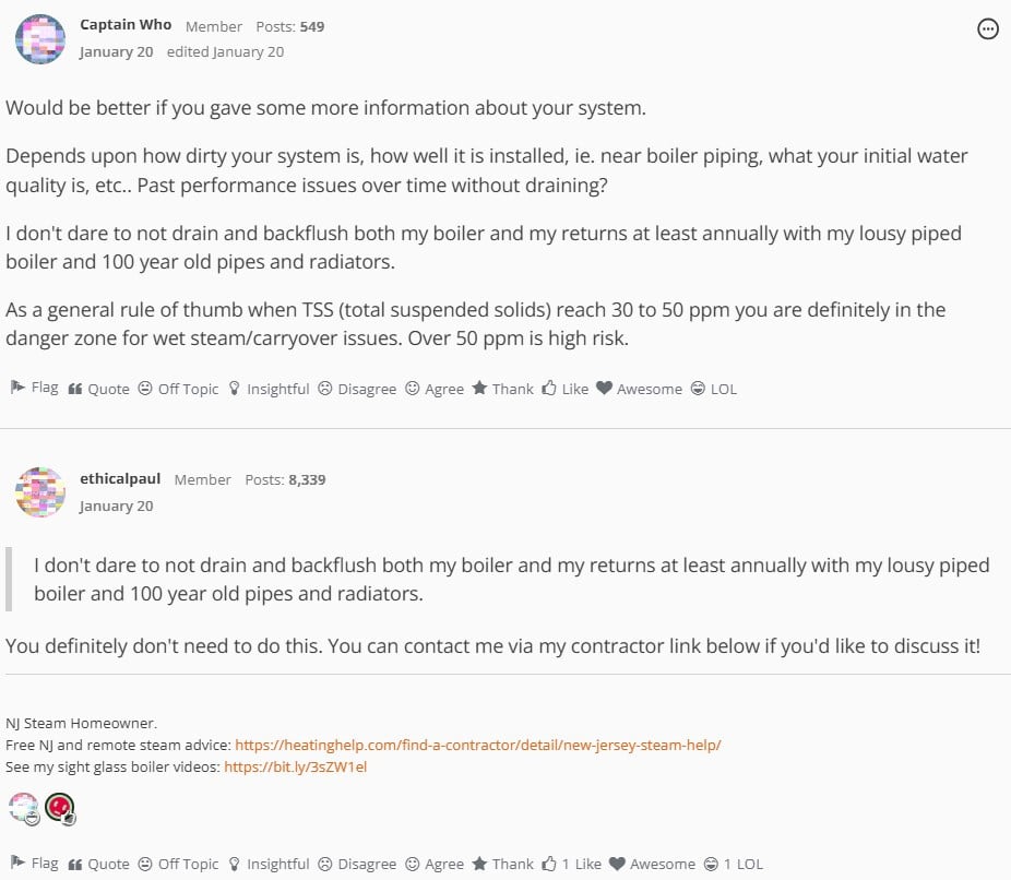

    "But remember I did used to have a ridiculously poorly piped Utica with a single supply pipe and when I got the water decent, it didn't carry over anymore."
    Yeah. My situation exactly. For some reason I don't understand, you deny what I am seeing in my own system the past 20 years or so, that I need to drain and flush (you told me I don't have to do this) and treat to prevent wet steam progressing to severe carry over. Not trying to divert the thread, just have to say this.
    "The small supply pipe slows down the steam exiting the steam chest so there's not really any "sucking" behavior that happens."
    Either you are misunderstanding what I've said, or I said it with not enough clarity.
    If you have water that is surging/carrying over, then you definitely have to drain it and/or skim it. What I probably said was there's no reason to periodically drain every x months like you are doing. You can get your water in good condition and keep it that way with water treatment such as 8-way.
    If I recall correctly, you just recently did some pipe replacement, which would typically introduce oil into your system. That's the kind of thing where you do have to skim and/or drain (just like I had to recently do where I fouled up my own boiler water).
    Also let me clarify that I am not claiming you need to treat water to prevent carryover. In fact, I've never seen a product that can actually stop carryover (with the possible exception of Squick). 8-Way definitely makes surging worse under some conditions (I didn't always believe this), so I now advise get the water clean and behaving correctly first, then treat.

    Why are things not up for discussion? Stalking? That's wacko 🤣 You seem to think that disagreement constitutes disrespect. It does not. I have complimented him on his videos and his efforts many times. It is the conclusions that I do not agree with. Don't project on me please.
    Why do you not see that him gaslighting me that my annual draining and flushing is not necessary when clearly it is, is something that could be interpreted as a form of disrespect. But that is OK. I will push back politely with or without your approval.

    That's true, but I also did an experiment where I put a little cutting oil into my boiler, and here's how they compared:
    • Undersized supply, down to 1" with water level all the way to the top of the gauge glass. Result: No problem
    • Normal sized supplies, with a little cutting oil in the water. Result: a lot of carryover
    So that's why my current thinking is that water quality is the first thing people should focus on when they have surging/carryover. It's a lot cheaper, easier, and faster, and seems more likely to actually improve things than getting out the wrenches.

    1000% agree. Homeowners and contractors, should pay attention to water quality. But we know that they don't. It's a struggle to get homeowners to do any maintenance. Or more precisely, it's a struggle to get homeowners to hire someone to do any maintenance. No way under the sun, any homeowner is hiring contractors, to come back for multiple visits... Therefore, the working assumption is that most residential boilers, will have water that is some degree of bad. Or some degree of less than ideal. Which means that proper piping, or even over piping, is beneficial.

    "So that's why my current thinking is that water quality is the first thing people should focus on when they have surging/carryover. It's a lot cheaper, easier, and faster, and seems more likely to actually improve things than getting out the wrenches."
    With all due respect. I am not arguing. I love your experiments. Please don't be offended.
    That is not quite the way I remember it, because you were saying that you pretty much ruled out the existence of wet steam issues in any residential boiler due to bad near boiler piping/mechanical issues.
    And yet you did tell me that the solution I have found to my problems with my system, which is to pay utmost attention to my water quality by draining and flushing once a year was not necessary.
