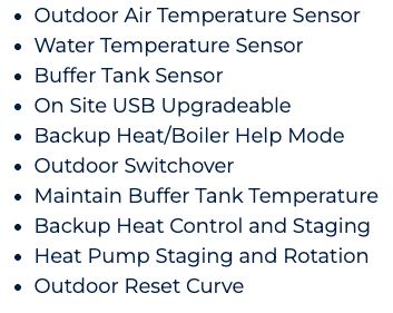

It does have some features that may be useful, shown below.Outdoor reset, buffer control, able to switch a backup source on, etc.
Look at what comes on the HP control, it may have enough features without adding the SSIC
Living the hydronic dream0 -

Outdoor reset is nice to have to maximize the HP efficiency. Does that come with the basic HP, or is the SSIC needed to run ODR? If a sensor in the buffer and outdoor sensor comes with the basic HP, that should cover your needs.
