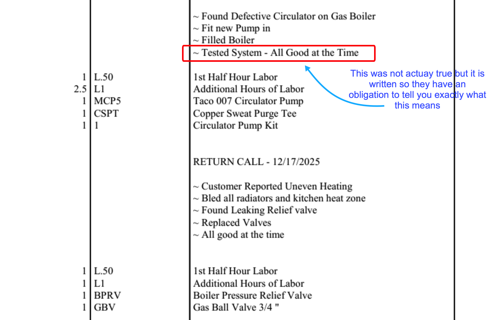

Hi,
I know I am not supposed to put prices on here but trying to figure out if the price seem right so I hope a total number is ok. I recently had a vendor come to my house because my boiler was making a loud noise. It was a bad circulator pump and granted it was hard to get to so it took longer but the price seems really high. The next day, some the radiators were not heating up when they were heating fine before so I called them back and that was more hundreds of dollars. They said I had a leaking valve but I am thinking that should have been caught the day before and/or questioning if he did something such as add too much water to the system to cause the leak. The total came to $$$$. Is that reasonable? Below is what he did. Side note, when he was the first day, he complained that the first 2 pumps were defective so he had to keep putting new ones in and drive back to office to get another one but it is hard to figure out if he charged me for that time. I am scheduling call with the owner about this but wanted to get opinions before that call to see if it seems high or not. Thank you!

    Hard to judge from here what went on. I will say that when a circulator is changed and you then have no heat in areas, this could have been the cause of the no heat and the system would need to be purged of air. This may not have been done after the circulator was changed. Hot water heating systems heat with water, not air, so you may have a legitimate complaint.

    That price of over $1,000 might be fair, but it depends on your location. The New York metropolitan area demands much higher labor costs, and wholesale parts often cost more from a New York supply house with higher overhead. In contrast, a small town in Wyoming typically has much lower labor rates. For that reason, it would be better to replace that dollar amount with “$$$” or something similar.
    When I was in business, I had a policy called “You Never Pay Twice.” That policy covered the second minimum labor charge, which was typically a 0.5-hour fee just to show up. Since the leaking relief valve was probably a few years old and had never been exercised or “operated” as instructed by the manufacturer, it may have already been defective. That means the next person who touched it—whether it was you, the cable guy, or the plumber—was likely to cause it to leak. For that reason, I agree that you should pay for that repair.
    However, because the leaking valve was discovered after the system was improperly vented and some of the radiators were not heating properly, I would have deducted more from that repair under my service-call warranty.
    For example: if I replaced your circulator for $10.00 and you later called about uneven heat, and I normally charge $6.00 to correct uneven heat and replace a relief valve, I would show the combined total as $16.00. I would then offer a $3.00 discount under the warranty portion of my “You Never Pay Twice” policy.
    You would need to agree to the initial $10.00 before I started the working on your circulator, and to the additional $3.00 before I replaced the relief valve the next service call. All pricing would be agreed upon up front. If you declined the $10.00 repair on the first day, then all you would owe is the minimum service fee to show up, diagnose the problem, and provide a written price quote which might have been $0.98

    if they came back why are you paying?
    a company is defined by how they deal with issues later. If we make a mistake or when we make a mistake how do we deal with it?
    In your situation that would’ve been a no charge call

    I might start with a query about if they have any guarantee on the work they do on a service call.
    Call from another phone (caller ID and all) and ask the question anonymously as if you want to use then for a needed repair.
    Then ask about what the statement "All Good At This Time" means on a service call ticket/invoice
    Seems like "All was not good" since the following day the system did not heat properly and it did heat properly several days earlier, my guess is that opening the piping system caused air to enter the radiators. There is a statement: Filled Boiler (which means adding water) as part of what you paid for on the first day. and since you already paid for that (adding water) why do you need to pay for that again on the second day. Just because they changed the name to Bleed Radiators which also is adding water to the boiler.
    I can guarantee that the air in the radiators was a result of the "Taco 007 circulator pump" job. That bleed radiators should have been done the first day and if they wanted to charge additional for that on the first day, then it should have been included. I think that they are not the type of company that admits their mistakes and would rather loose a customer than refund you any money.
    Asking management the tough questions may get you a few dollars refund, and if not find another plumber.

    Looks like an invoice from a third grader. "All good at the time" means what? "Cycled all zones to limit, making sure all returns are coming back hot. Verified system pressure. Ok at 15 psi at 180° limit.", is what it should say.

    I would ask is:
    What is a circulator pump kit??
    I would tell the owner the tech did not bleed the radiators that's why you had the second call……..unless you saw him bleed the rads the first time…..but regardless there was now need for a repeat call
    Tested system all good is just a CYA cover story
    Why did he change a gas ball valve and a relief valve which had nothing to do with the original call? And did he actually replace them? Pictures

    I’d keep an eye on the boiler pressure also. A weeping relief is often caused by pressure over 27 psi.
    Pressure increase can happen when a fill valve that hasn’t been used in a while is activated to do a purge, after a repair.
    Hopefully the expansion tank was checked also.

    A thorough repair would have changed the circulator as needed purged all zones and done a complete check of all devices. This was not done. Service companies need to do this for customer satisfaction not to mention the dreaded call backs that occur when a service call such as this one was not thoroughly done. It avoids all of the finger pointing.

    While the second call could have been avoided if he'd done his job properly on the first call, it's hard to say what that time would have been. That 1/2 hour for the second call should definitely be thrown out, and there are some questionable items on there as well like the valves that were supposedly replaced. Were they actually replaced? Were they actually defective? If yes, why weren't they done the day before? Did you approve those replacements, seeing as they have zero relevance to the call? WTH is a "circulator pump kit" and why was it necessary? 3.5 hours to diagnose and replace a circ, replacement of a relief valve, adding a sweat purge valve, purging/bleeding, verification of tank pressure and proper operation really isn't obscene at all. They seem to have marked up the material pretty significantly, but the labor looks about right.
