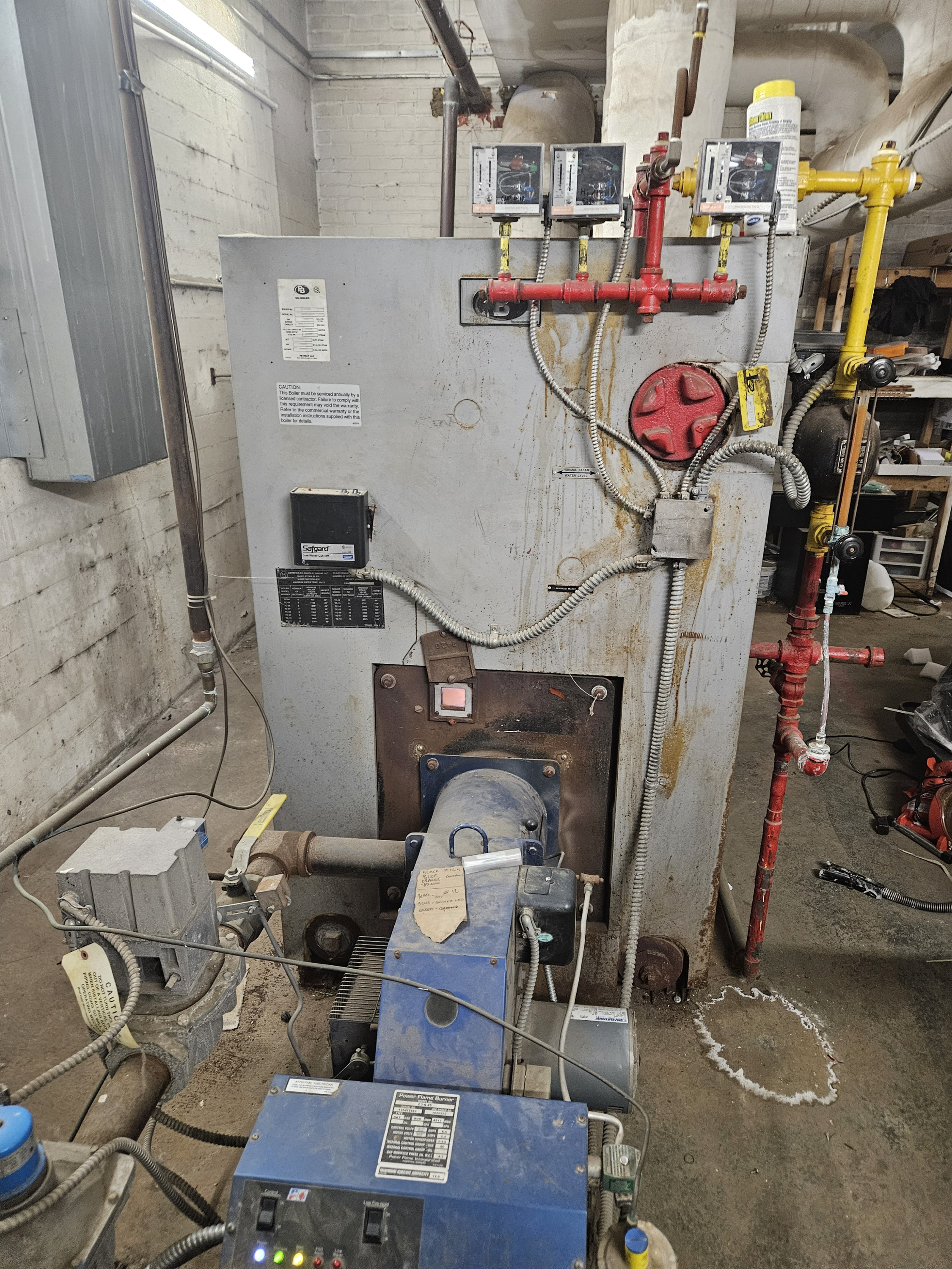

Hey everyone its been awhile since I posted here. I have a commercial steam boiler for a large apartment building that I service regularly. I've been using steam clean treatment on all my residential boilers and I've been very pleased with the results.
This boiler however would take 10-15 bottles of steam clean to effectively treat it according to what I've looked up.
What are my options for treatment a boiler this size?
Located in durham NC.

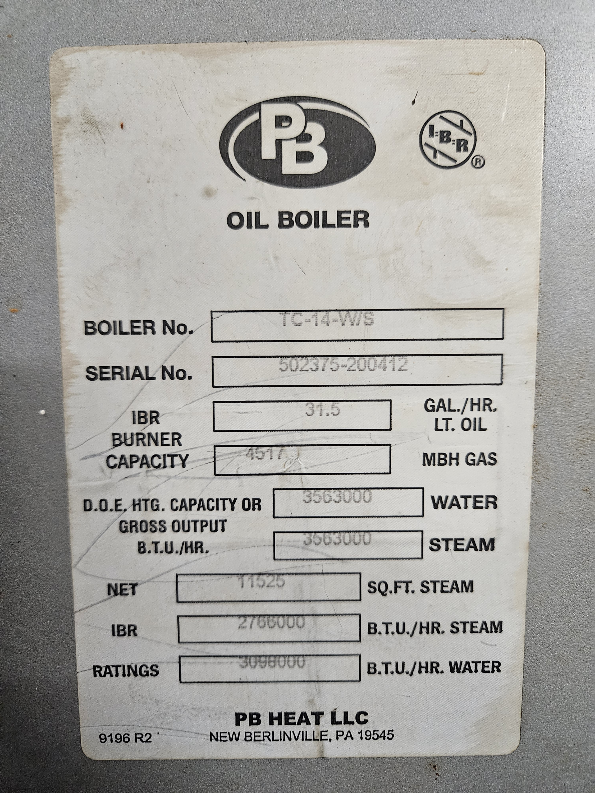

    wow 11,500 sq ft of steam
