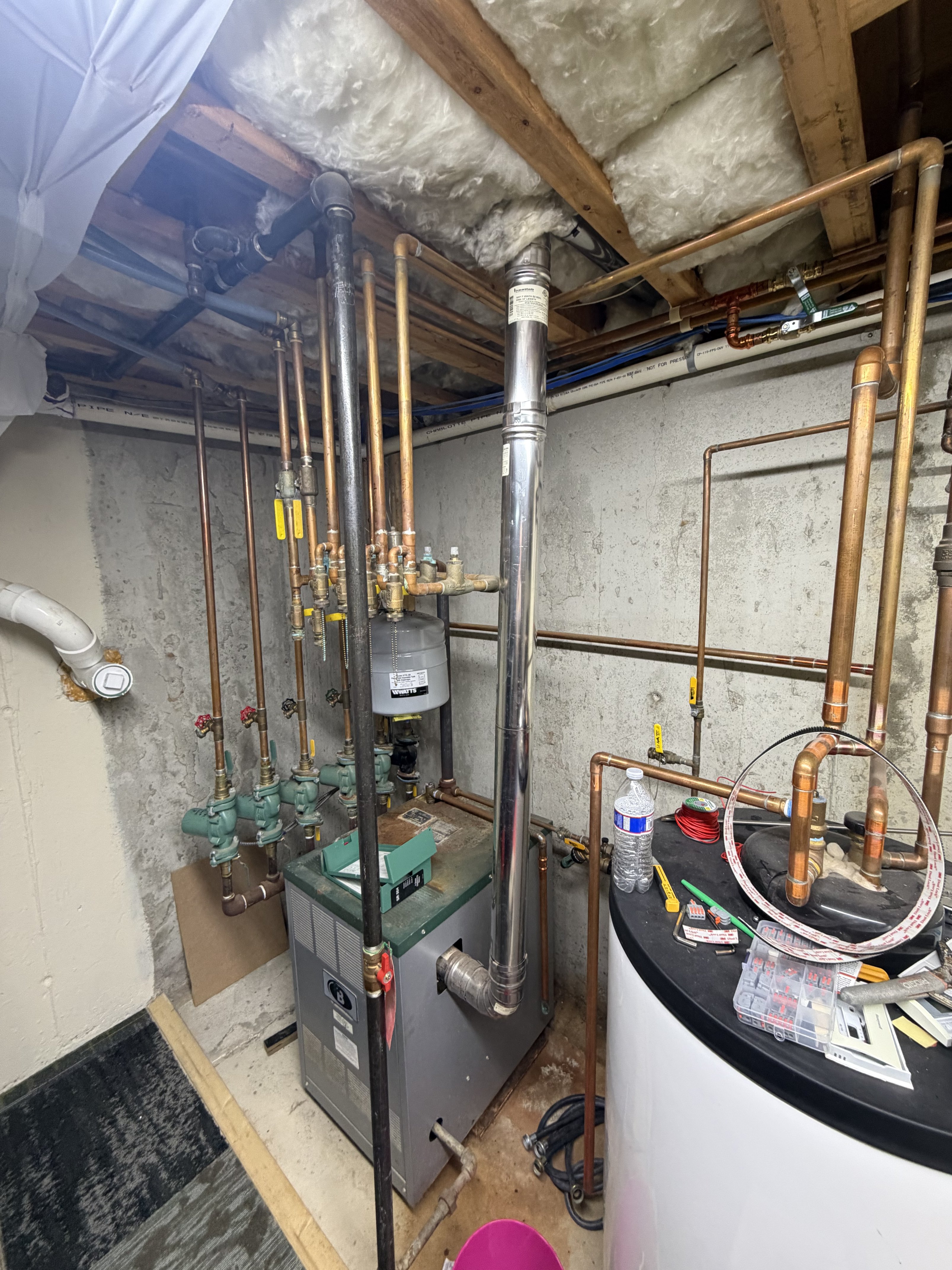

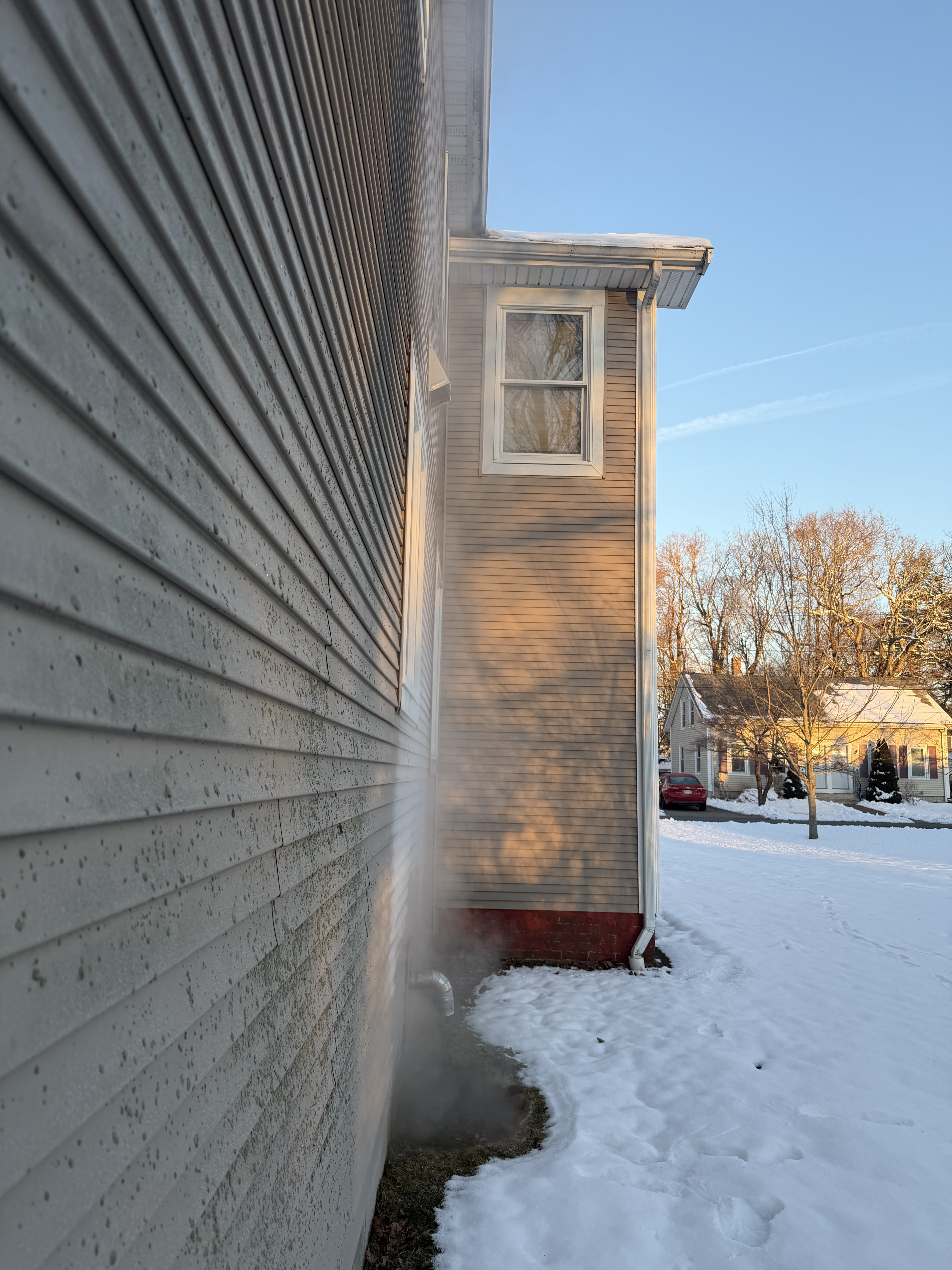

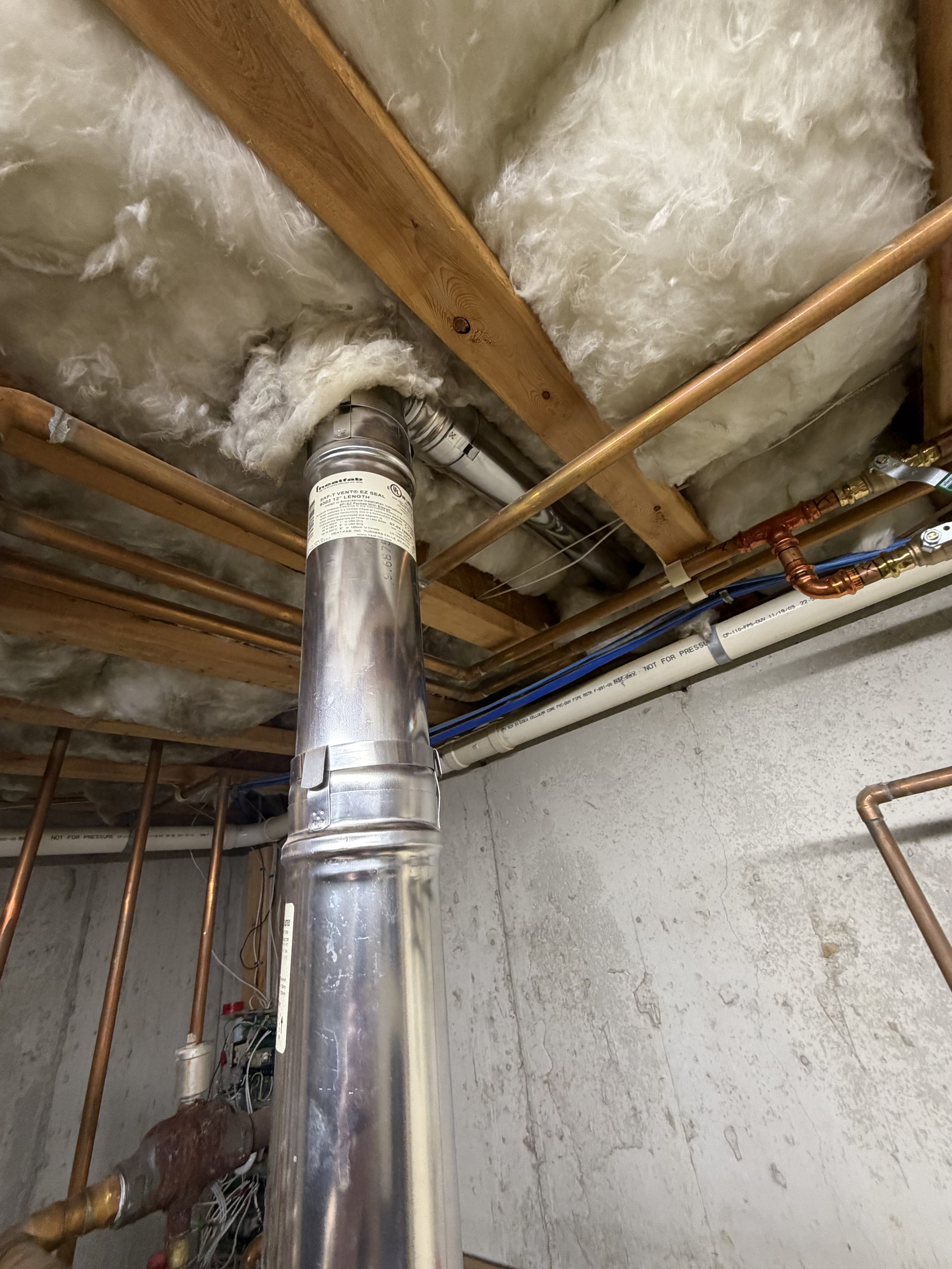

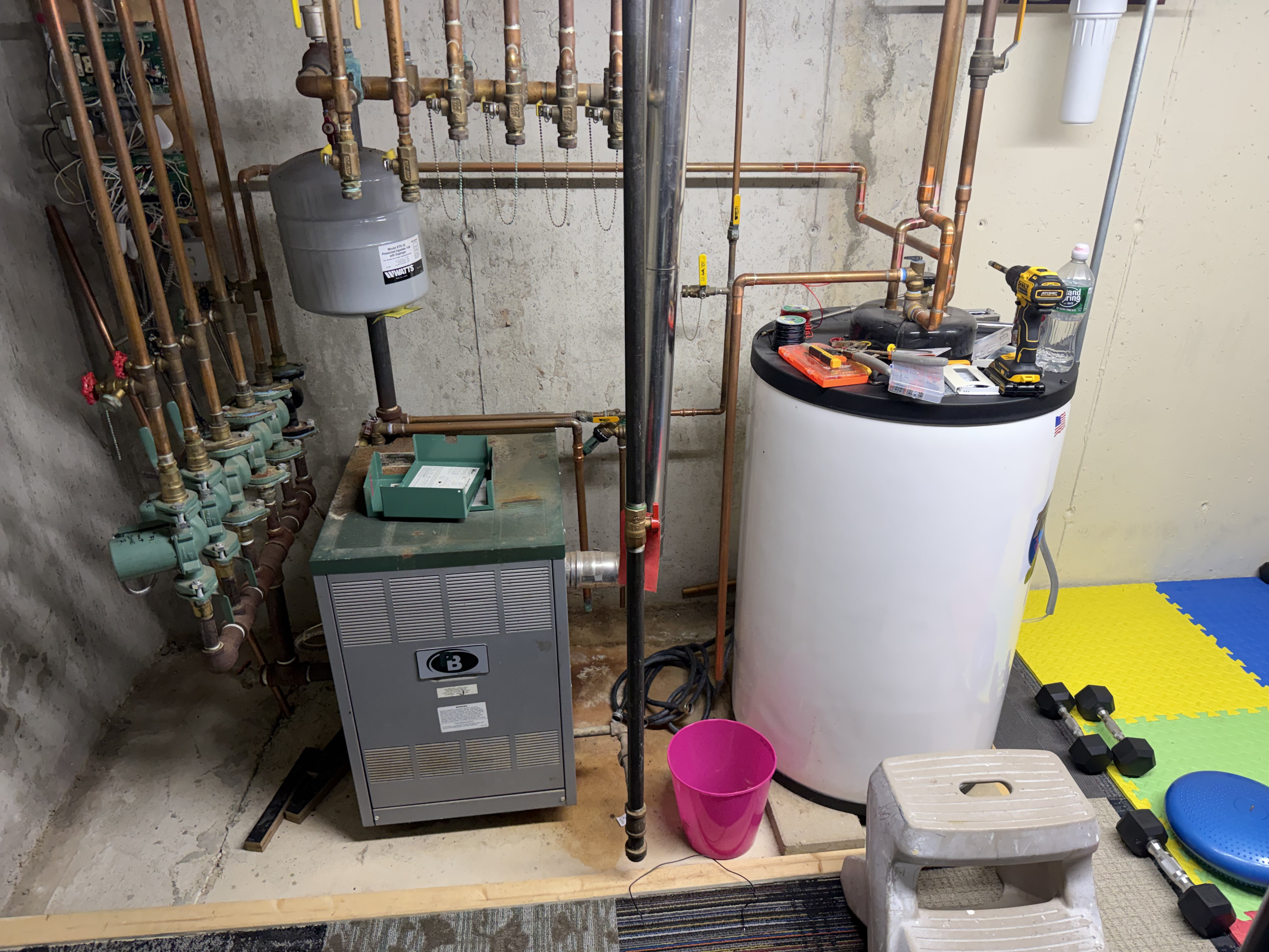

Hi, my boiler vent was installed correctly and to code. The issue is the heat from the exhaust is running up the outside wall and back into my soffit vents, attic, creating moisture (see pics), frost etc. Can anyone give me my options for moving or extending the exhaust? UPDATE- I added the make and model of the boiler in the pics above.

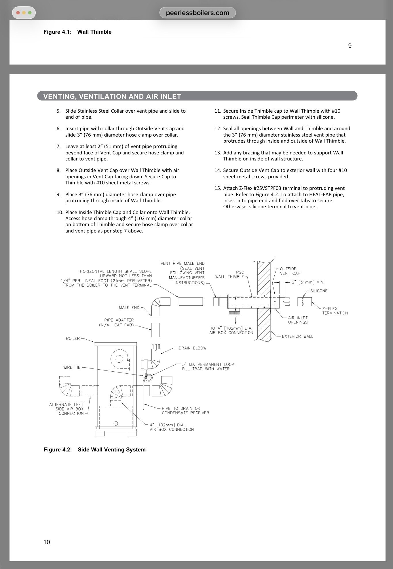

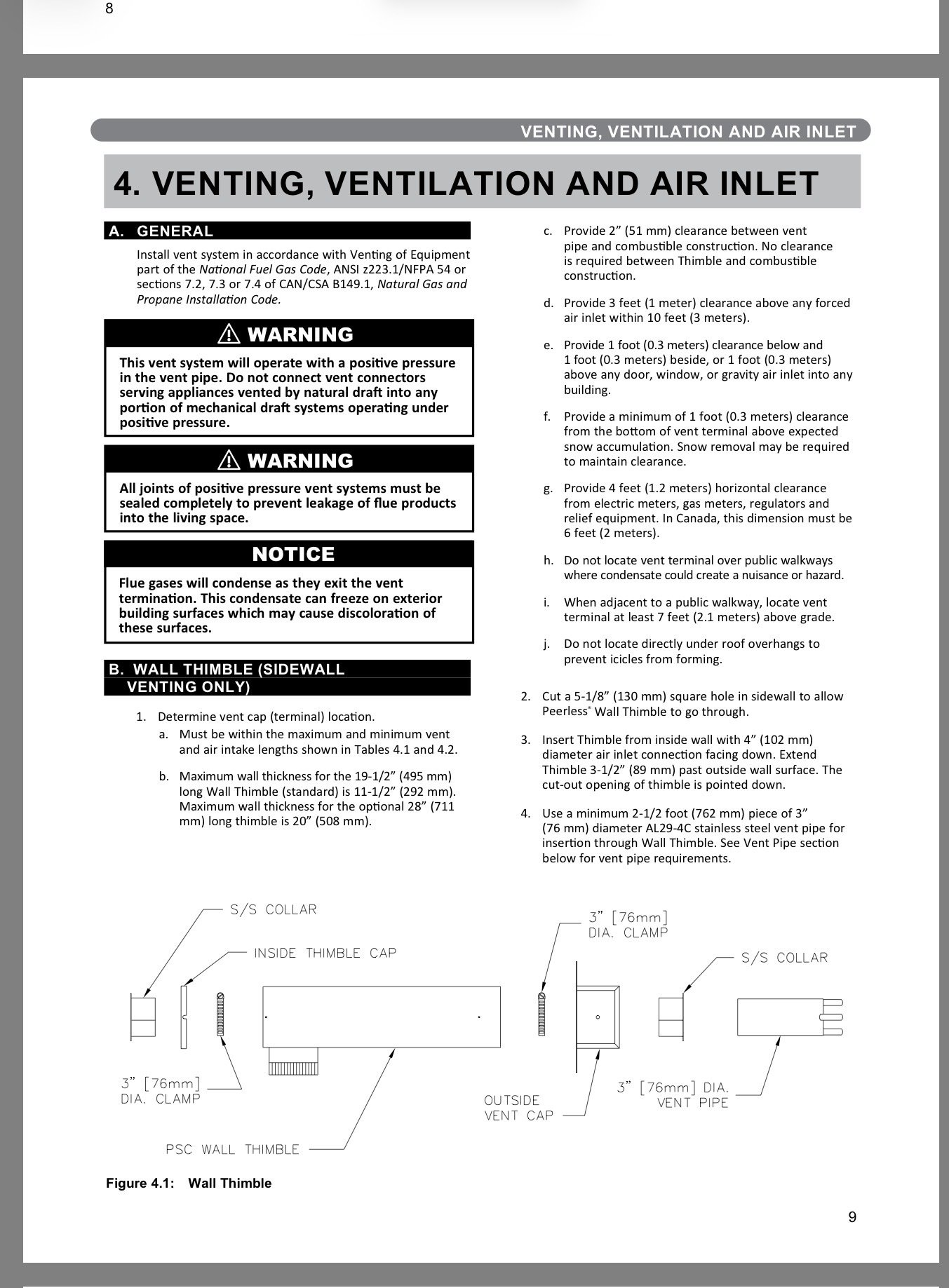

    I'd like to see the install manual of the boiler to show that that is an approved way to terminate the exhaust. Is there a reason it cannot be re-piped to exhaust out the gable end?

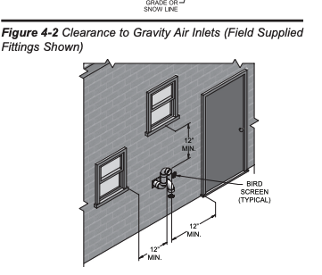

    It looks like it meets the required dimensions from windows, openings and the ground?
    If you removed the 90 ell it would blow out a bit more, but wind may still push the exhaust vapors against the building. These concentric kits have exhaust straight out the end.
    Besides fogged windows the siding will take a hit and fade over time.
    The very best way is through the roof.
    While you may not likes the looks it could run up the outside and ell out just under the soffit. The snorkle method

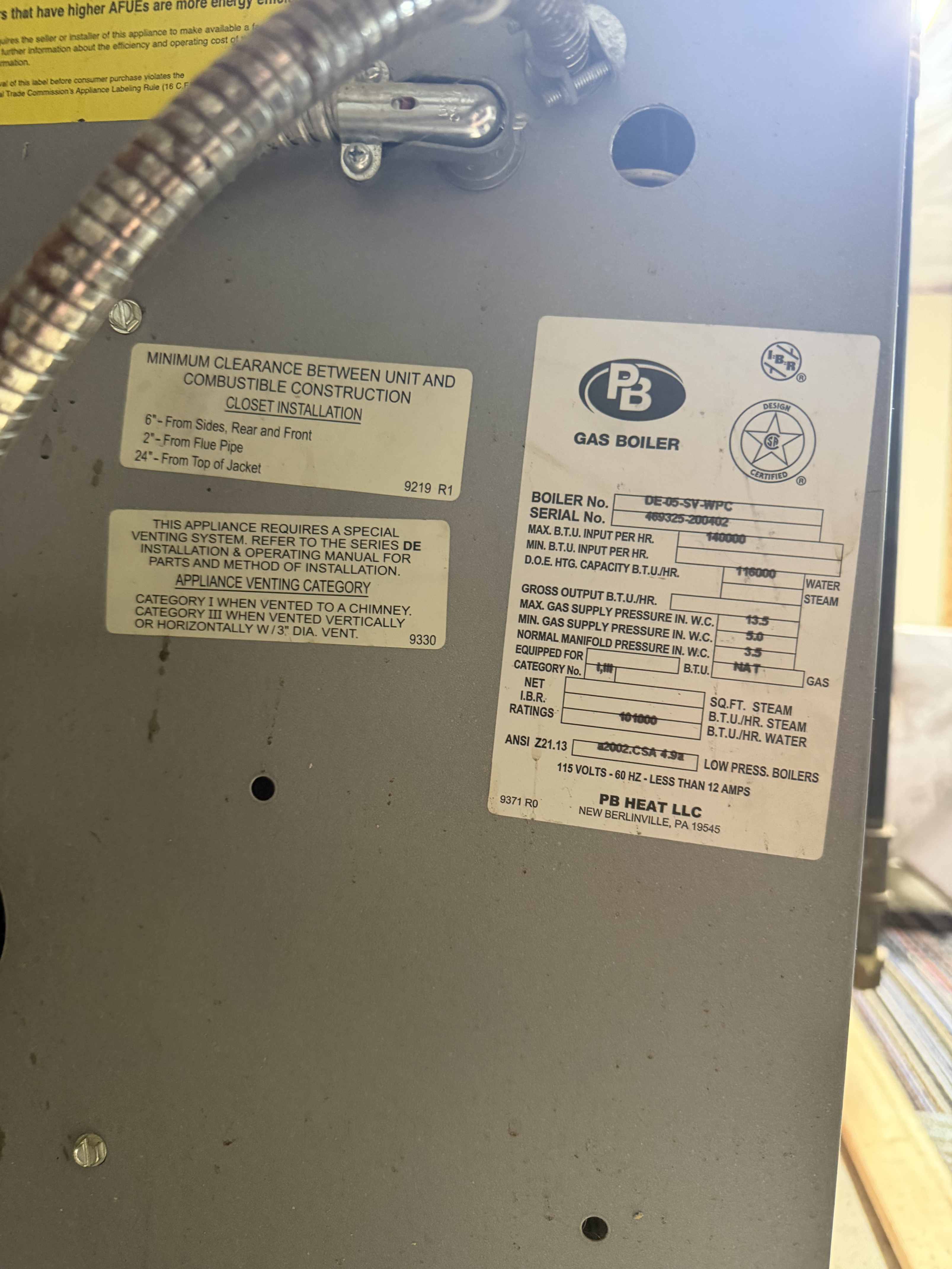

    What make and model boiler?
    If it’s 90%+, then the metal wall cap is not the proper termination.
    How about some pics of the boiler and the vent piping?

    Your flue gasses shouldn’t be cool enough to condense at the vent termination.
    What water temperature is the aquastat set to run the boiler?
    Was gas manifold pressure set to manufacturer’s specs with a manometer?
    The excessive zoning on that system may be causing short cycling which will lead to lower flue gas temperatures and condensation.

    That not a condensing boiler. Std 83% set up.
    the 90 downward is not helping matters at all.
    I would add a 6- 12" section w/ 45* on the end facing downward.
    hot_rod Posts: 28,708
    I think the manual shows the discharge with the thimble kit, without any fittings on the outside. But wind direction towards the house may still blow the exhaust against the siding
