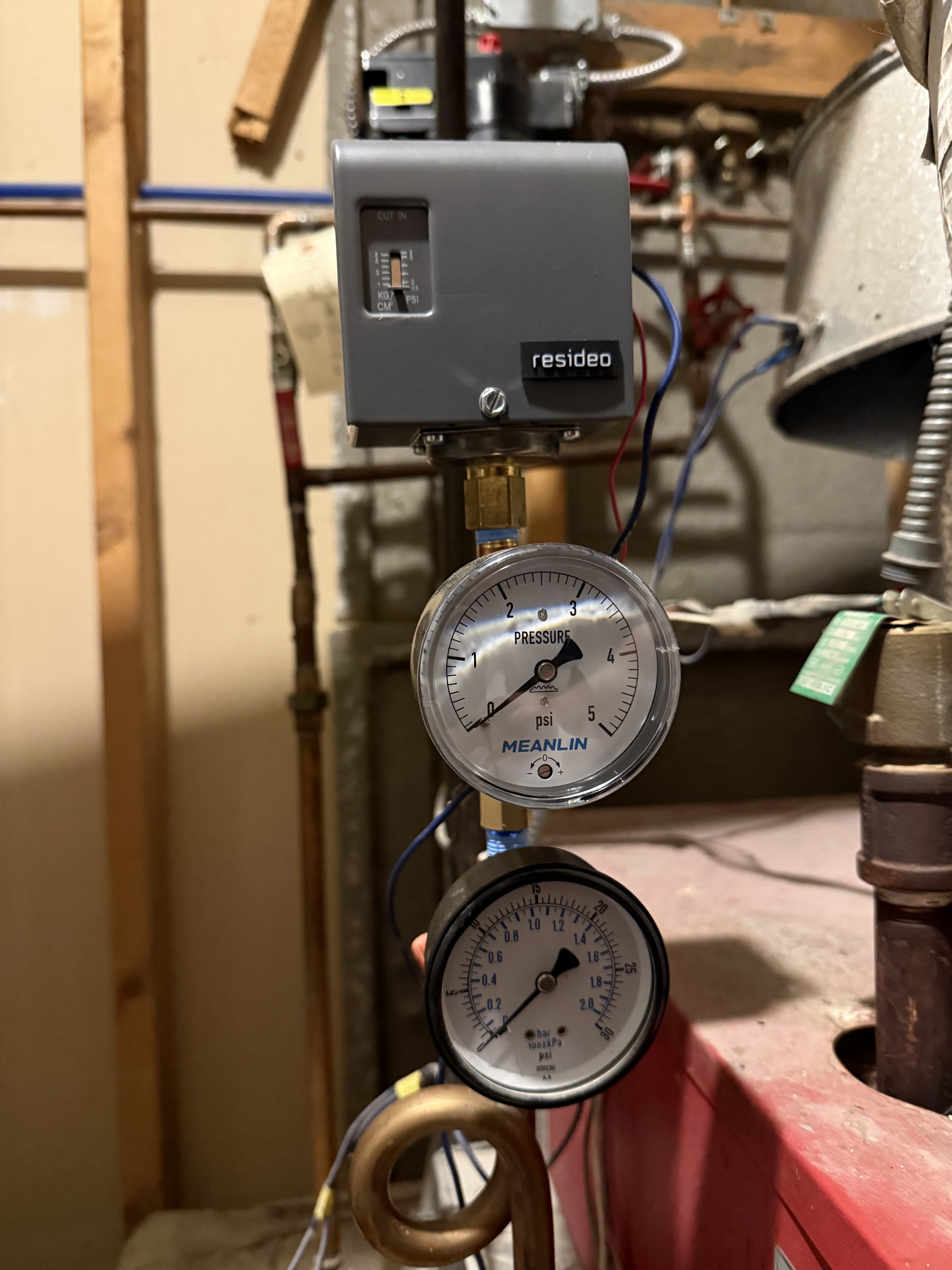

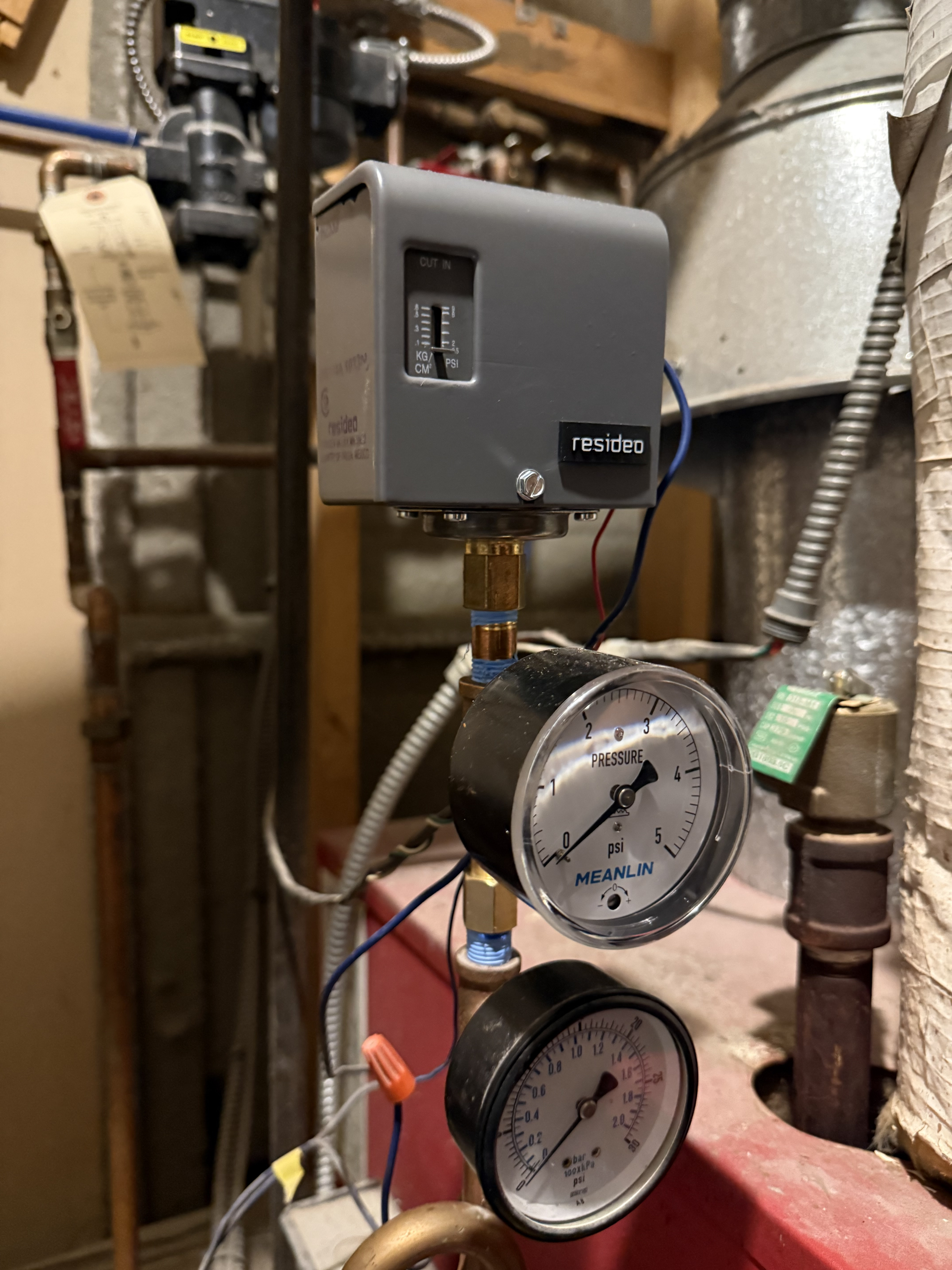

Wondering if this gauge setup is viable:
cleaned pigtail then added a tee along with swapping to more sensitive pressuretrol. 0-5 gauge reads less than the 0-30 gauge:
Still working on vent for second steam leg, but do have a Gorton #2 on the condensate return pipe. Slowly getting there I feel.
Thoughts?
