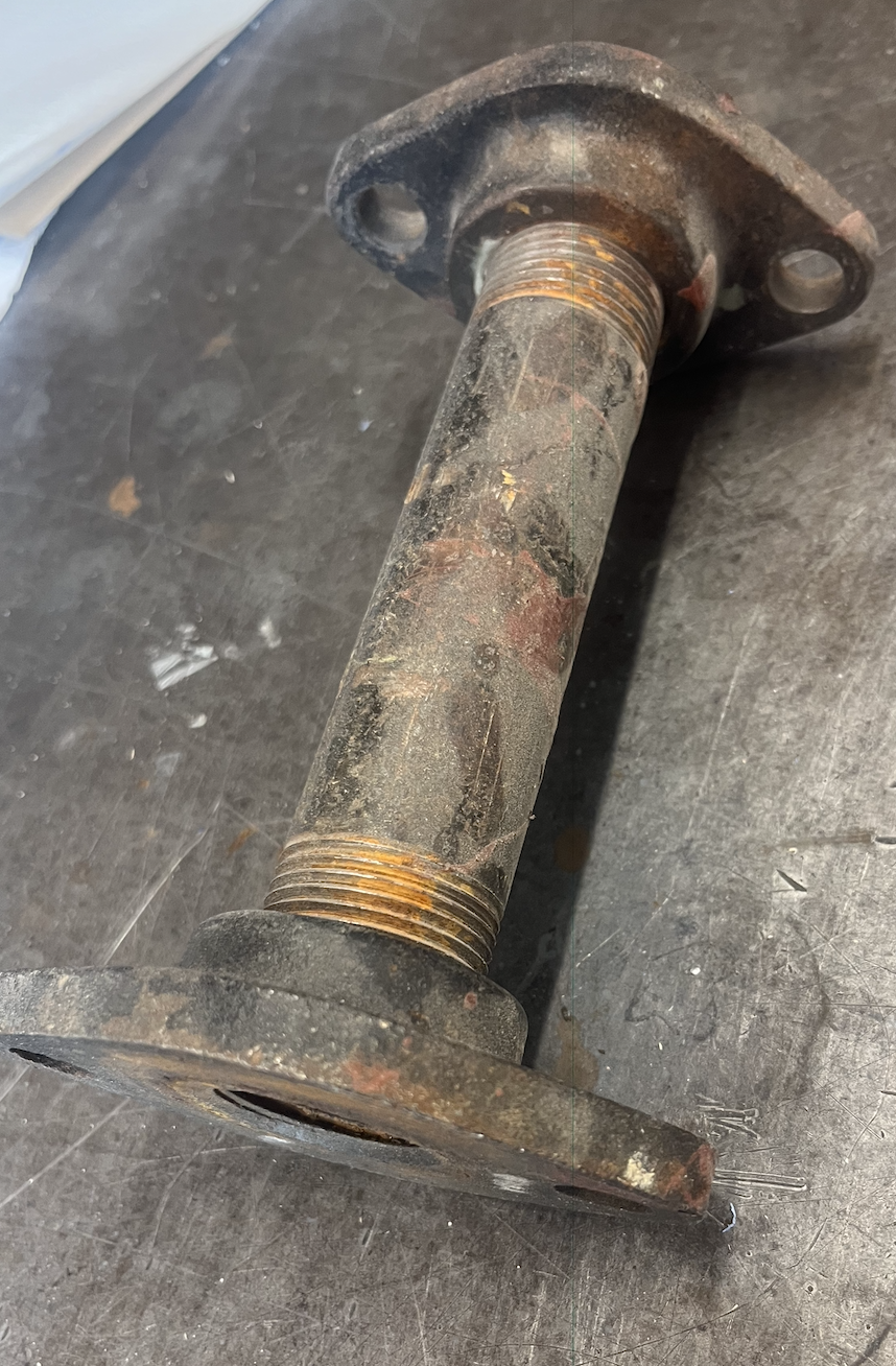

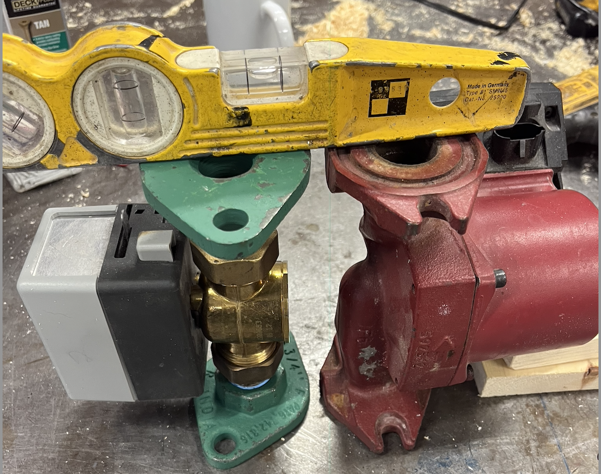

Siggy had this thought so I built up a prototype.
Thoughts or suggestions?

    Was it very tricky to get the same port to port length as the pump or did you get it first try?
  • Pretty cool idea. I did something similar for flushing older systems. I made up a straight pipe with two flanges (connected to iso flanges) to flush the system, initial purge it, then swap out the blanks for circulators. To me I think it's a way to keep junk getting lodged into impellers.
    hot_rod Posts: 28,705
    pump spacers, handy for piping systems for the correct spacing

    Yeah, it took a few flange brand tries:) This is where BSP threaded pipe shines, Loctite or hemp the threads and stop wherever you want.
    A copper sweat version is pretty easy to get "exact", but the sweat flanges are more$$

    Neat idea and all, but don't we need to repipe anyway to add a system circ?
