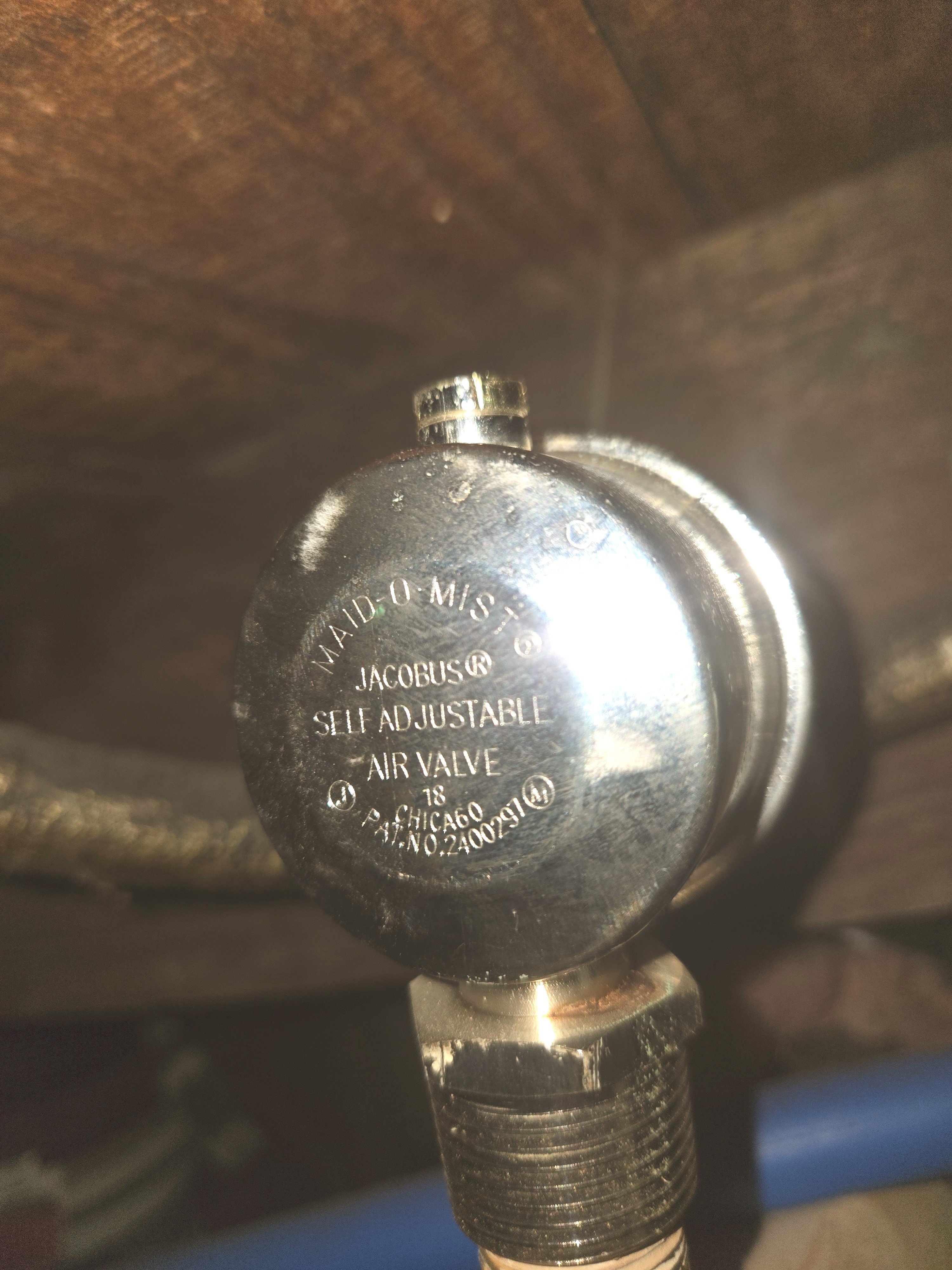

I have a small 2 story house w Dunkirk boiler situated in center of basement. 1 pipe system. At the end of 1 2.5 inch main, approx 20 feet, it T off to 1 3/4 pipe. About 4 feet from one half of the T are 2 vents stacked/ganged on one vent opening, a Gorton #1 and a MaidOMist 18. Time from furnace to vent opening is 1 minute w vents removed. With vents installed time is 1 min, 47 sec. The Gorton sits on top of the T and heats up first. The MaidOMist is on a 2 inch nipple (off to the side of the T) and take a while longer to heat up.
Does the MaidOMist vent take longer because it is a slower vent or is it because it is not right on the top of the T fitting?
Should I add another vent to the gang/stack/manifold (not sure what term to use) to try to get the time down to 1 minute,as it is w no vents screwed in?
Rad on this end of house are slow to heat.
    ethicalpaul Posts: 9,076
    I have to admit I don’t know what a Maid o Mist 18 is but regardless, 1:47 is pretty fast, there’s not much to gain there
  • I added Maid O Mist pic. I dont have others of the setup can but get em

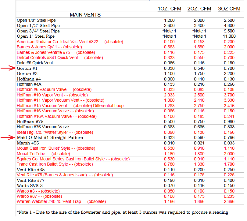

    Steamhead Posts: 19,007
    It's a #1, meant to compete with the Gorton #1.
    Or the Gorton #1 was meant to compete with the Maid O Mist #1. I've never seen proof of which company set up their designs and numbering first.
    I know Gorton had their #2 in the early 20th century. It was designed as the only vent in a Vapor system. The inside is the same as the smaller vents, only bigger.
    Semi-retired
  • Thanks everyone. Think I will add another Maid O Mist, try to get that time down closer to 1 minutes. From the chart above, looks like it vents a little more and it's cheaper. Can anyone suggest why I should go with the Gorton instead?

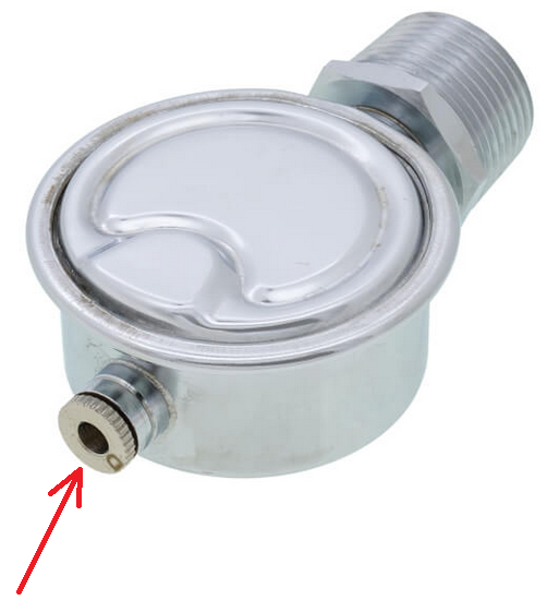

    Since the orifice is removable, I kind of wonder if the with old Maid O Mist and maybe the new one (although it probably would void the warranty), if the orifice could be drilled out a bit more. To get a bit more air flow through it.
    ISTR the D orifice is the same size as the valve seat, so no, that wouldn't help.

    Anyway it does not matter apparently the D orifice is the same as the valve diameter so modifying it is useless.
