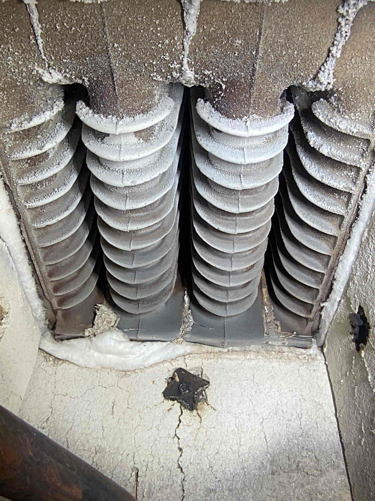

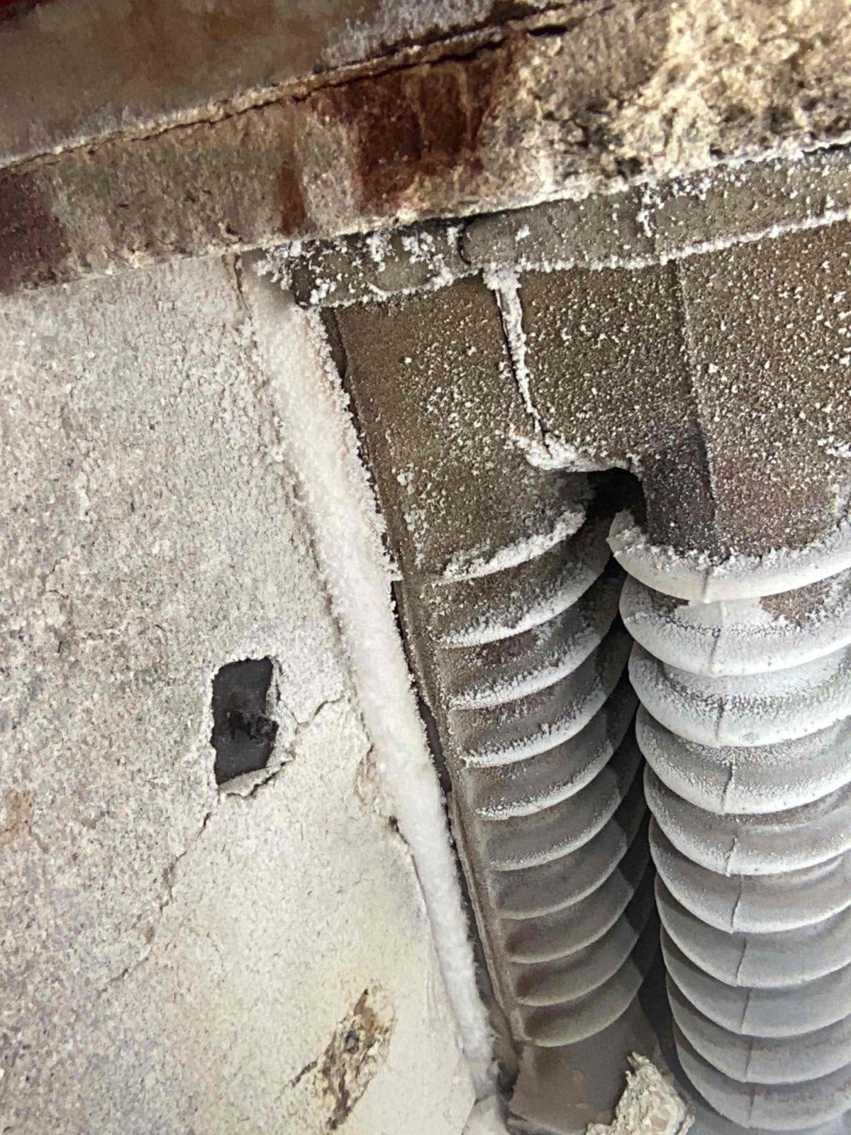

Ex wife had someone take a look at it since there is an overfilling problem. It still ran fine with the supply water shut off (I advised that is dangerous). The pictures are from the technician that said the whole boiler needs to be replaced. No mention of what is wrong other than these two pictures. A crack in the firewall. The other two technicians that worked on this boiler years ago never mentioned this as an issue.
Is this crack an issue?

    I assume that this is oil. Any competent oil burner technician will know how to repair or replace that refractory.

    That looks like the ceramic fiber/fire proof material that combustion chambers are made of.  They are lining the burner box of a gas boiler that the cast iron sections are set on.   Those cracks are nominal and have no bearing on the operational safety or integrity of the boiler.  The technician that is telling you that it is dangerous, is just trying to get you to purchase a replacement boiler that you don't need.
    If there is missing ceramic fiber material (which there is no missing material by the way) then you just need to replace the insulation.  You don't need a boiler.  I remember my next door neighbor's father telling me one time that those tires on that car were bad, we needed to jack up the gas cap and install a new car under it.  When I was 12 years old I knew he was not serious.  And your boiler salesman is also telling you to do the same. Buy something you don't need because a replaceable consumable part is “almost” failing.

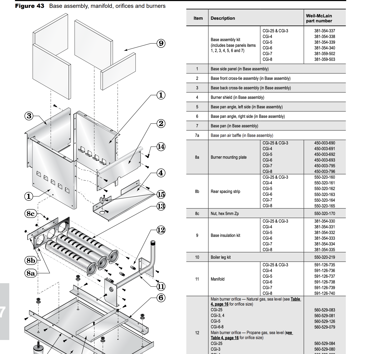

    This is a page from a boiler that uses the same type of ceramic fiber insulation in the firebox. Part #9 in the diagram is called Base insulation kit
    And that part number is less than $300.00 at a supply house. You need to look up the part number of the insulation kit needed for your boiler. If it is no longer available, then you can just make it out of Lynn Manufacturing Ceramic Fiber Board

    I thought that black thing was a hole, but it is just a washer that holds the refractory in place.
    The sad thing is the "technician" is probably so dumb he really does think she needs a new boiler.

    Certainly looks like a gas boiler. And certainly does not need to be replaced.
