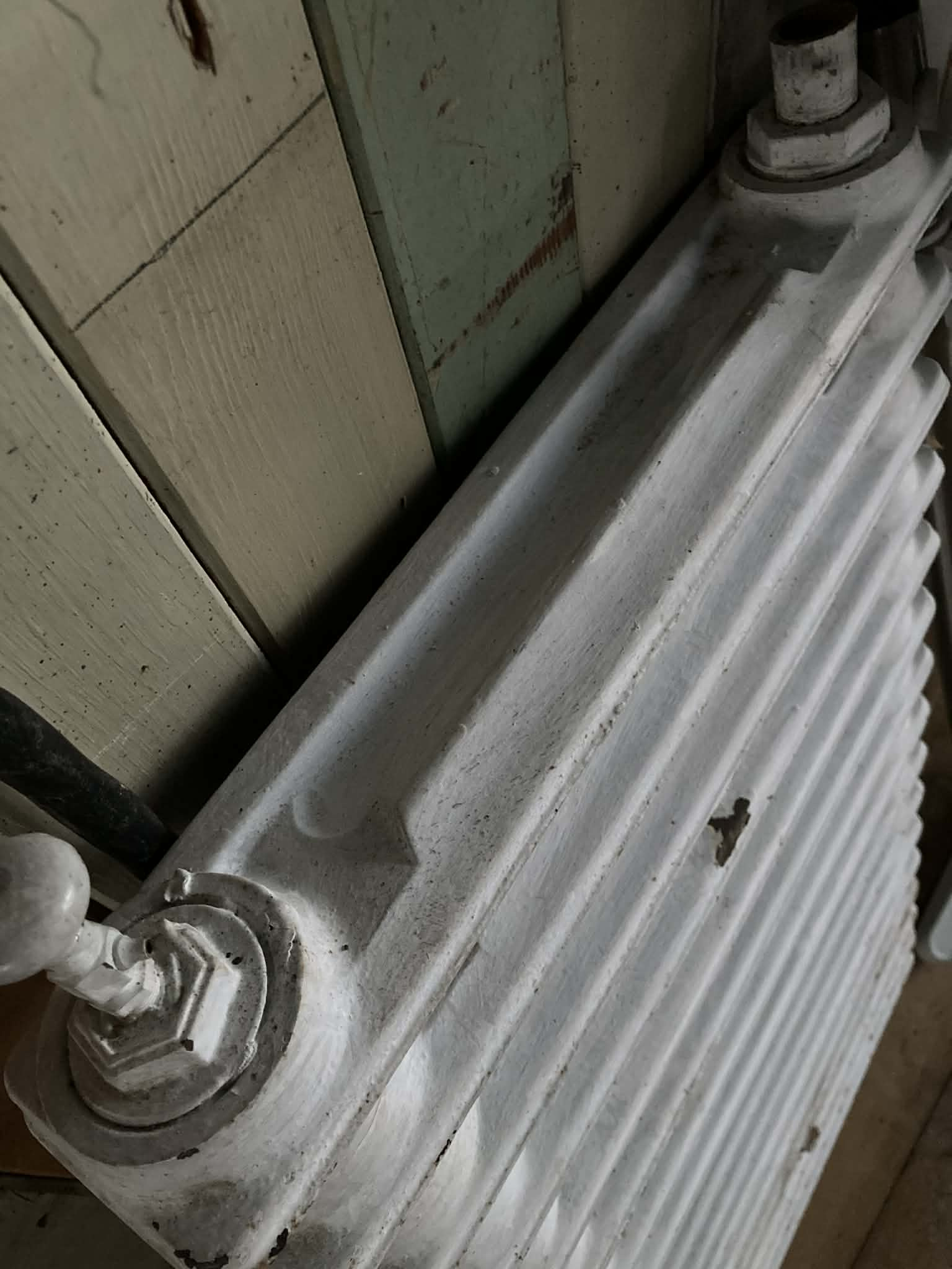

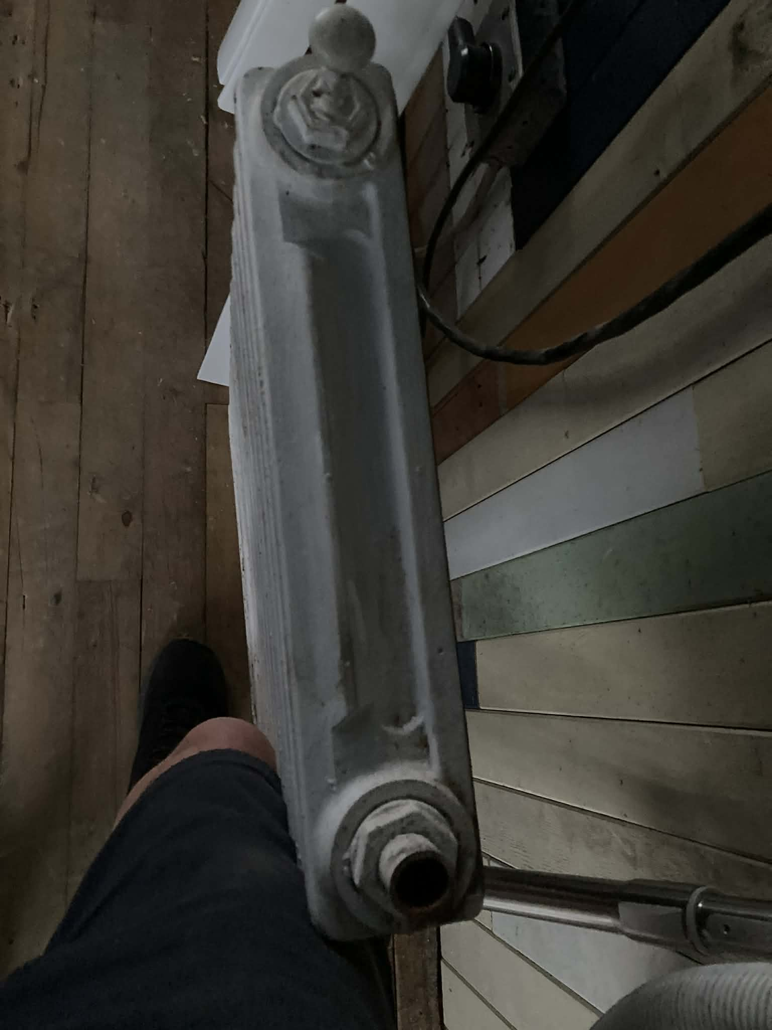

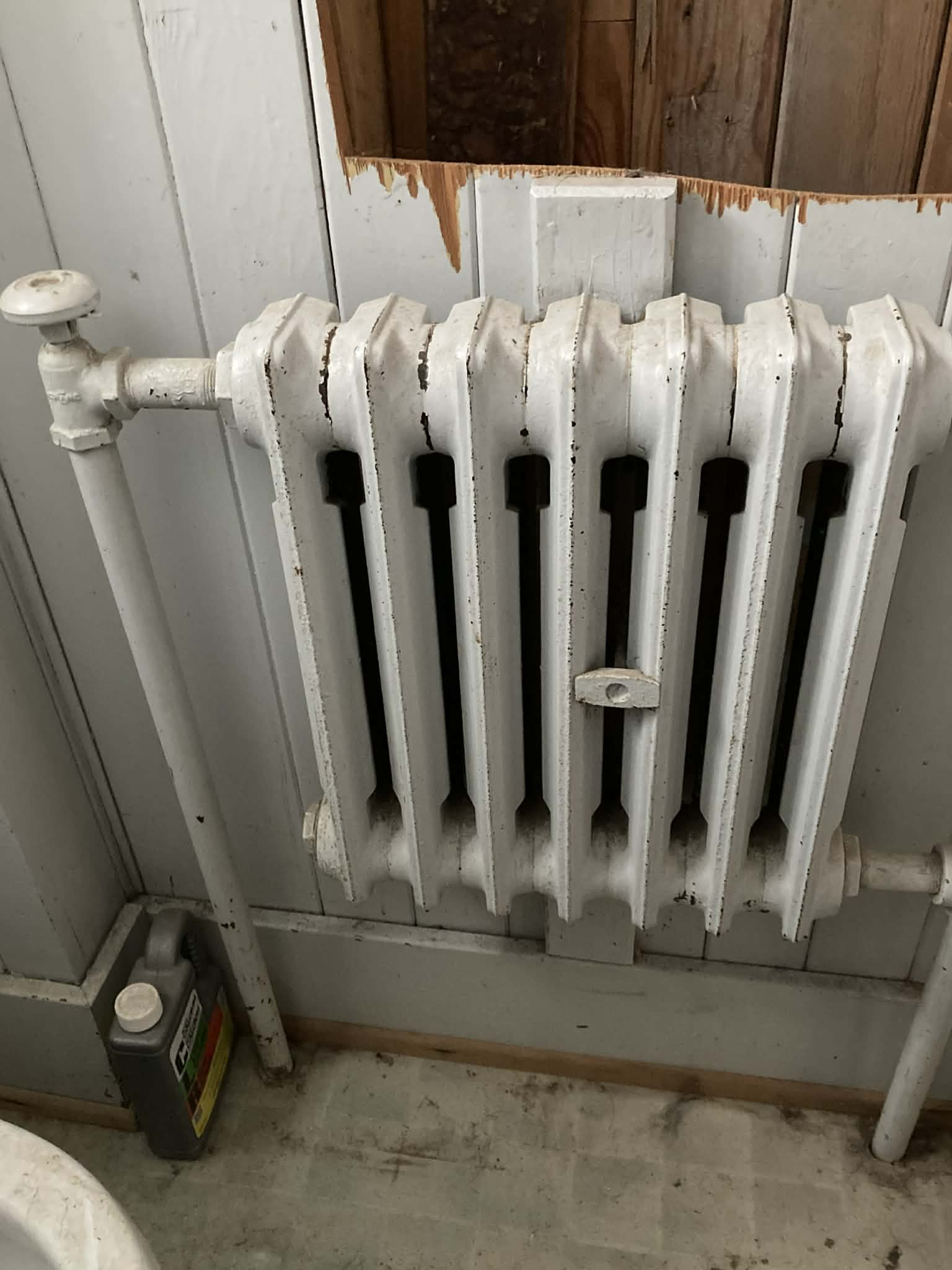

Need help to find EDR per section for this rad
Hi, can somebody tell me what is the EDR per section
dd938291-8841-4f20-b749-ab611299948b.jpg 8b7395a9-a31e-4b94-860d-18ff06dcff30.jpg 85561da3-abb8-4b11-81fd-171ce09a9357.jpg
for that kind of radiator. It is wall mounted. It is 16 5/8" high and 3 1/4" wide. Looks like 2 tubes, but it is not open between the tubes. I don't know if it connects inside to become 1 bigger tube. I have several of these radiators that I plan to reuse. I have searched the internet, but couldn't find anything like this. Thanks in advance!

    Are you going to connect them to a steam boiler?   They appear to be connected to a Gravity Hot Water system that may have been upgraded to a forced hot water system with a boiler replacement some time ago.  The reason I ask is that you only need EDR for sizing a steamer.  If you are using them on a hot water boiler in approximately the same location as they used to be, then you need a load calculation for sizing the replacement boiler.

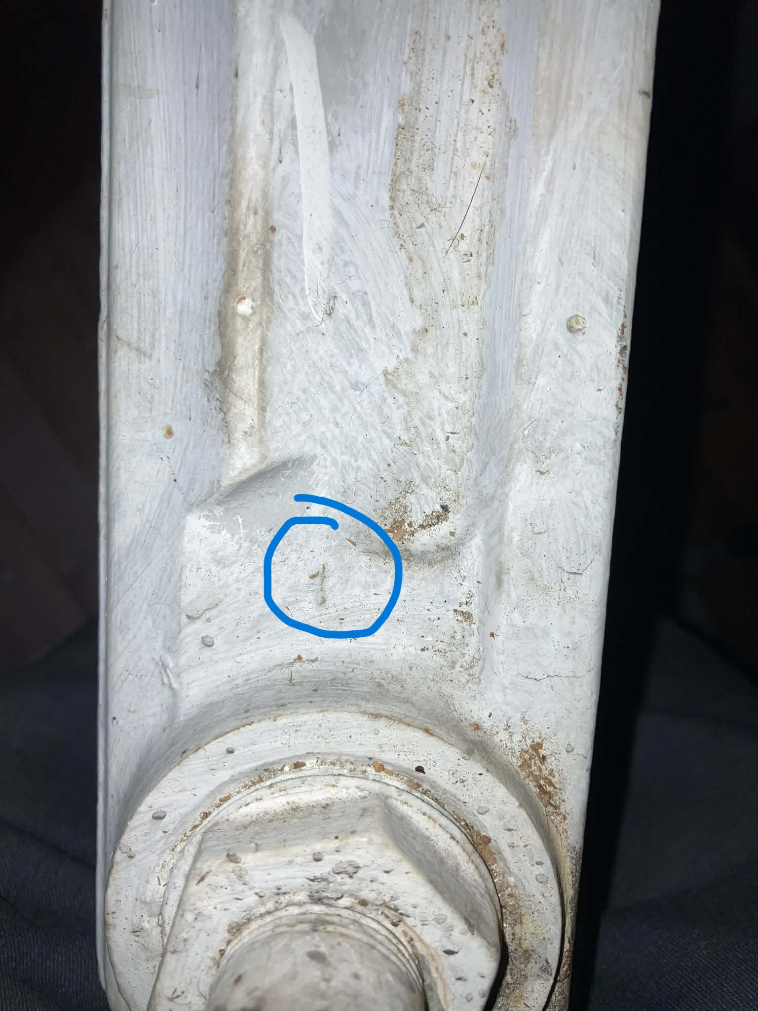

    I see some lettering on the radiator around where the bleeder is- what does it say?

    @Steamhead Must be a chunk of paint, I don't see any lettering around the bleeder, but there's a "1" at the other end of the section. Other sections are numbered "2", others are numbered "3"
    I am assuming it is hot water with that bleeder on it. Post the length, height and width and we can come close. Its just a chunk of iron. Finding the EDR with one that has similar measurements will be close enough. It won't be off enough to make a difference.

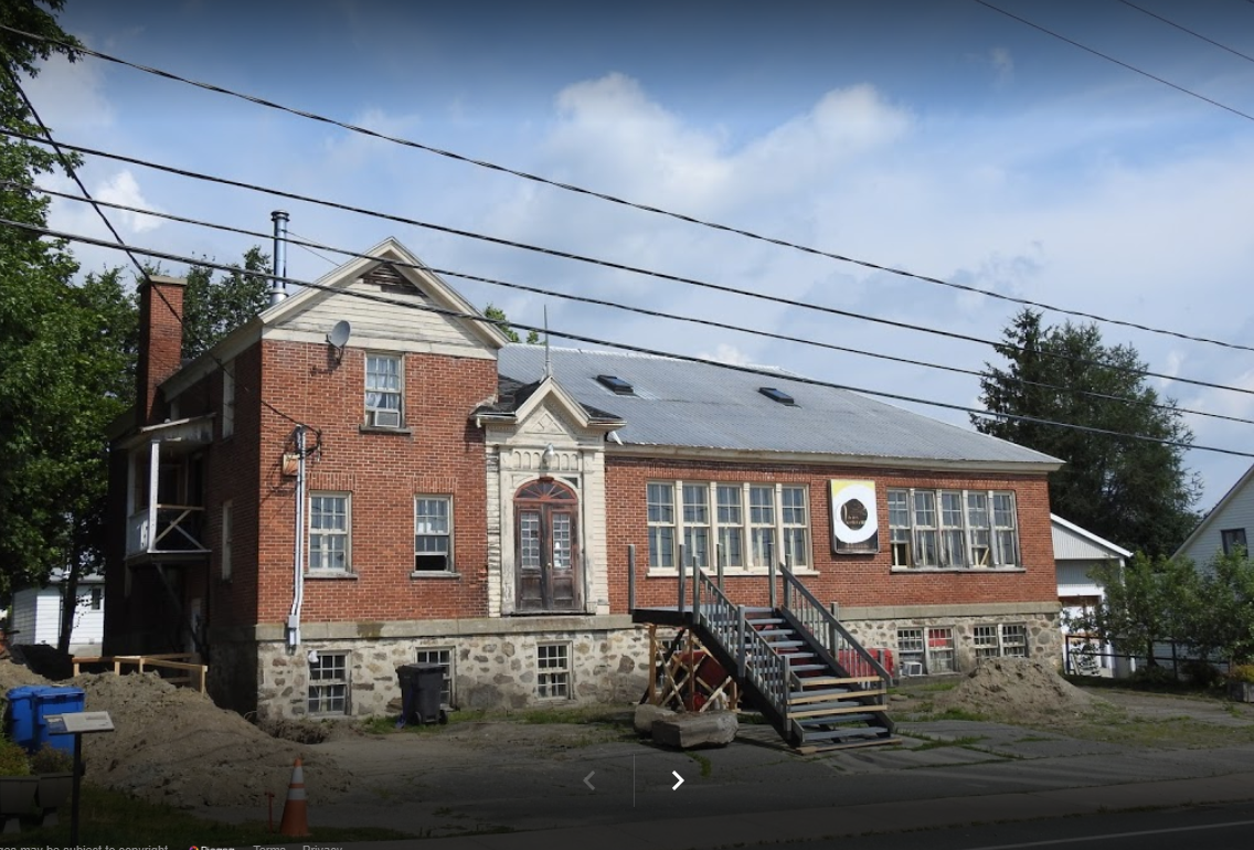

    @EdTheHeaterMan No, I'm not going to connect them to a stem boiler. A forced hot water system will be used. I am living in an old school, and I am renovating everything. The big cast iron boiler that was there, was removed years ago. There were a couple or circulators in the system and the water was moving trough 3" steel pipes. The system worked fine when I bought the place 20 years ago. Then, the boiler broke and I stopped everything. All radiators were disconnected. I have several other rads. Some are 4 tubes, 32" high and some are 4 tubes 26" high. For these, I've found the EDR. The 32" are going to be reused in my woodworking shop and some 26" are to be reused in the basement mudroom along with some wall type rads like the one in the pics. Another part of the building will be radiant floor. I have 4 - 54 sections radiators in the basement that are made from the same sections you see in the post. I need the EDR for these so I can decide to where to use them.

    @EBEBRATT-Ed the sections are 16 5/8" high and 3 1/4" wide. I need the EDR per section since the rads will probably be shorten.

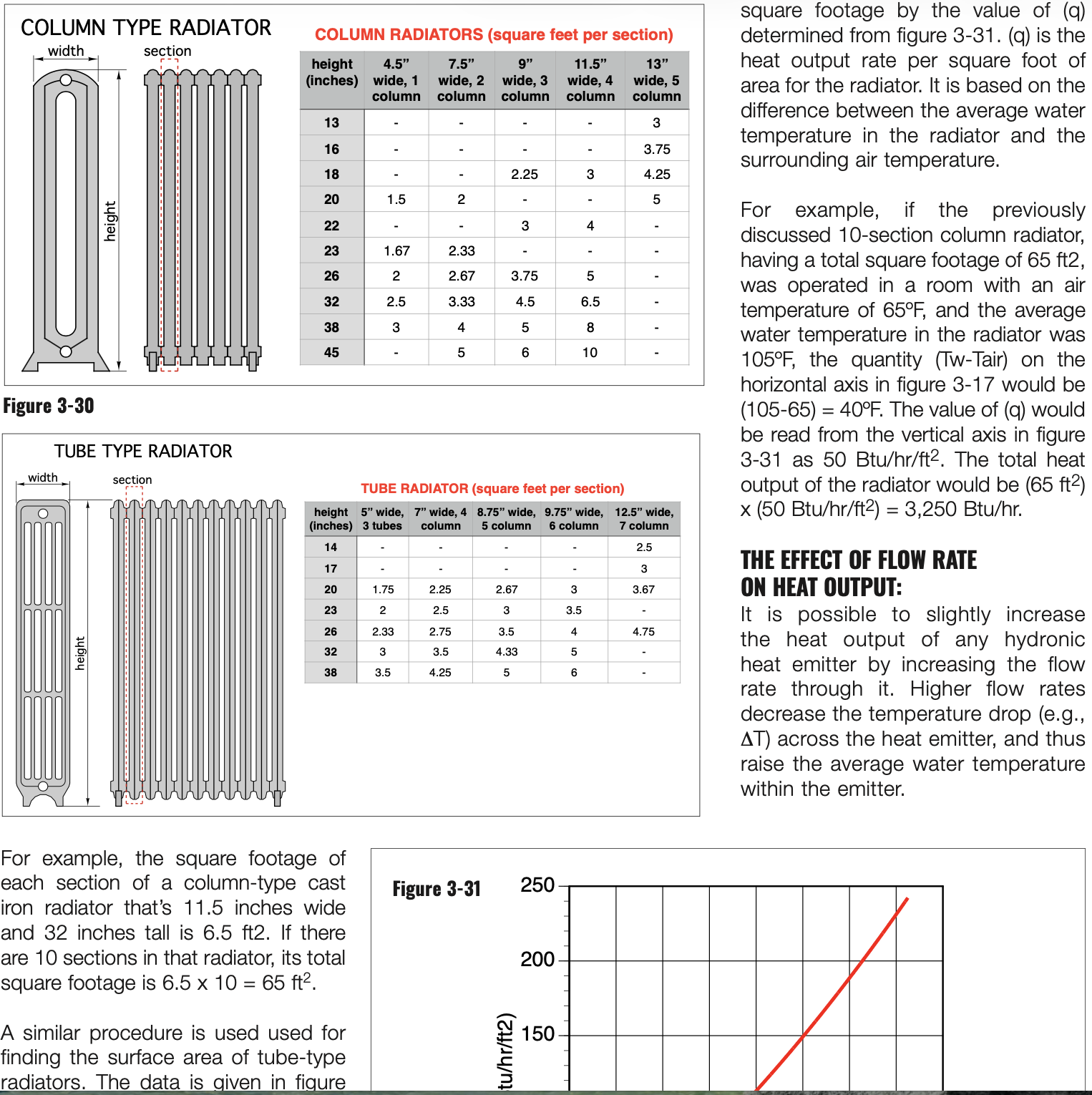

    I don't own the book, but Dan Holohan published a book called Every Darn Radiator (EDR) . I'm not sure if that one is in there, however maybe someone with that book can look for it. There are some standard or common radiator charts that have some EDR that you can interpellate a close approximation from those charts.
    For example Weil McLain has a sizing guide that shows column small tube and large tube radiators.  The one column radiator indicated a dimension of 4 ½” by 18” tall having 1.333 EDR compared to your 3-¼ by 16-⅝” single column section.  That radiator is clearly larger than yours.
    They also show a thin tube two column radiator that is closer to yours at 3-½” x 19” at 1 EDR which is about the same width but taller than your example. and may have more surface area, since there is two tubes while you have one column. Then there is a wall radiator that is 15” tall but it does not indicate the width dimension, that has a 1 EDR rating.  That is close to your example.  So I might suggest that your radiator section is between 0.75 and 1.0 EDR.
    If you were going to chop up your sections in hopes of getting a working radiator of 10 sections, then I would take a “WAG” at about 8.5 EDR.   If you were going to have more than 50 sections in one room, then I would like to be a little more accurate.  But if you are using 10 sections or less for any particular room, then the 0.85 per section is what I would use.   Remember this calculation is not Rocket Surgery.  You want to get close and adding a section or two to a room may not be such a bad thing.   Get close and let the other adjustments like TRVs or ODR do the fine tuning.

    @EdTheHeaterMan thank you very much! That is great help. I think the sectional wall type 15" tall will do just great. I will take your suggestion 0.85 EDR/section and I plan to use TRVs. So like you say, if there's a section or 2 extra, that would not hurt anything. I have another question for you: I calculated my woodworking shop heat loss at 39952 Btuh (yes, it's huge!). I already have 4 - 32" tall 4 tubes radiators for 109 sections in total in there. I calculated 3.5 EDR @180 average temperature that equals to 170Btuh/sq. ft. that gives me 595 Btuh per section X 109 sections= 64855 Btuh. Or I can go down to 150 average temperature that gives 385 Btuh/section for a total of 41 965 Btuh, that is closer to what I need. Should I lower the water temperature in order to keep all the radiators in that room? With a TRV on each radiator will there be some problems if I the temperature is higher or can I go lower temperature= more radiators (I have plenty of those!) Am I hard to follow?

    @EdTheHeaterMan yes! This is very helpful, thank you! I don't think there will be other part of the house/school that need 180 degree water, I've got enough extra radiators to fill all the rooms and run the boiler at low temp. I live in Québec, about 45 minutes south of Québec city and about 90 minutes from the US border in northern Maine. My DTD is 84 for an indoor/outdoor design temp 70/-14. We don't have a "gas culture" here, the electricity is cheaper than oil, propane or natural gas, so I'm looking to go with electric boilers like an Hydra that heat water on demand. It is clean and I think, 100% efficient. I say boilers in plural, because I am well over 100 000 Btuh to heat the "beast". I think it's possible to use multi boilers. Do electric boilers have the same issues with low return water temperature, like corrosion or other "diseases"? BTW, I have installed a 320 amp service. Here's a photo of the school. As you can see, there are a lot of large windows! There are the same on the back.

    Great looking building!
