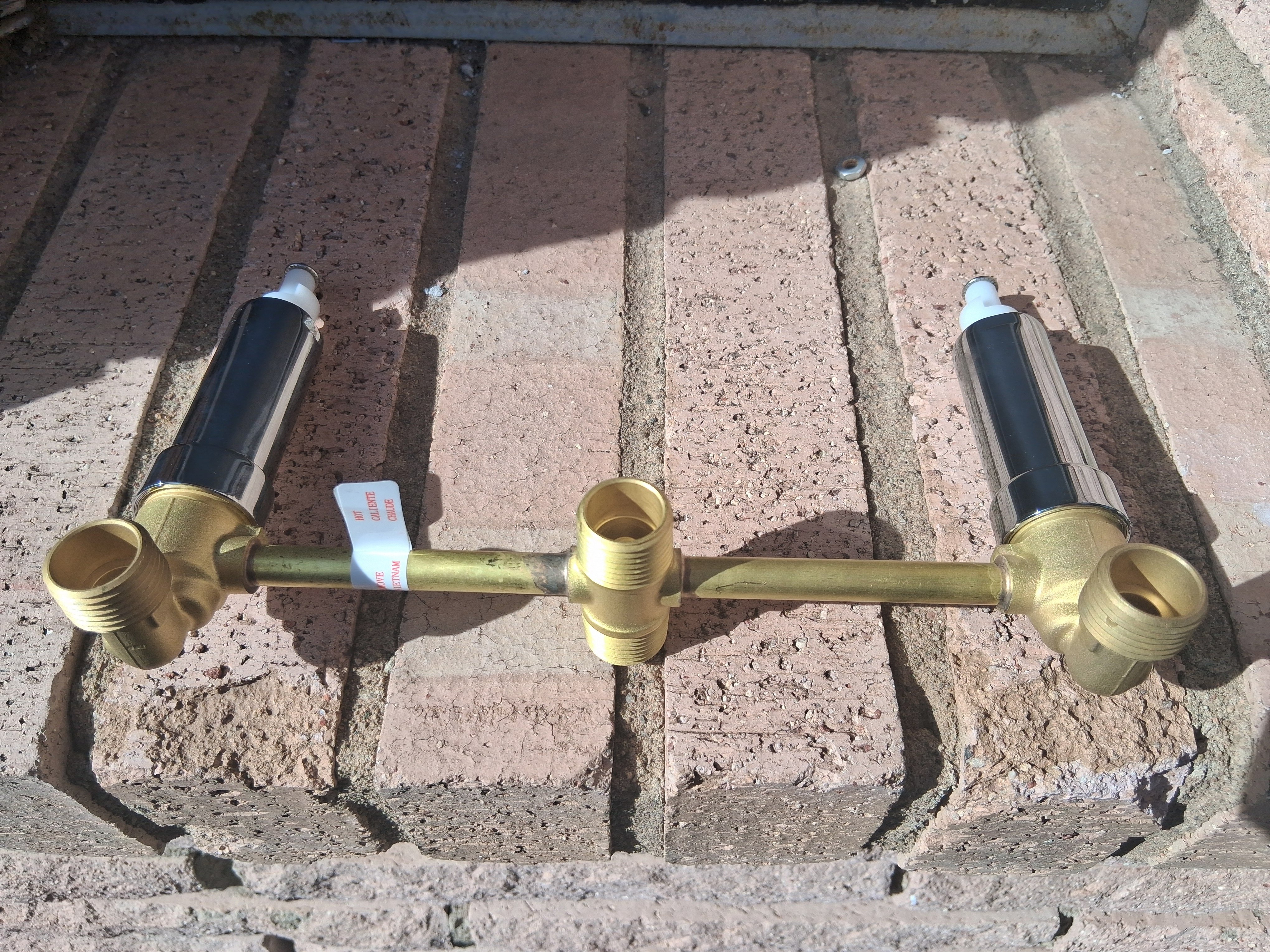

Good day. This thing is tagged with hot on the left side. How important is that? I ask because the hot supply on the shower I'm working on is on the other side.
Thanks
Alex
P.s. I'm ditching the center mixer for this dual valve.

    Jamie Hall Member Posts: 27,572
    Two independent valves? From the hydraulic standpoint, may not make much difference.
    HOWEVER
    I don't think,, in looking at a lot of sinks, tubs, showers, and whatnot all over Europe and North America and parts of the Far East over lamost 9 decades, that I have ever seen a dual handle faucet setup with the hot on the right and the cold on the left.
    Somebody will get burned. Badly. If you switch them.

    guzzinerd Member Posts: 461
    edited January 12
    Look at the pic again and my reply just before your comment please...the hot WAS on the right out of the box (indicated by the little sticker). My question was if i could just hook it up with the hot to the left, which i did. All of the faucets in the house have heat left, cold on right.
    Maybe i should have taken the pic from the front instead of behind the rough in valve.

    mattmia2 Member Posts: 17,420
    valve is designed for a feed up from below the floor. note that in most jurisdictions you need a tempering valve that limits the temp of the hot water supplied to that fixture since it doesn't have a pressure balanced cartridge.

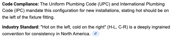

    Intplm. Member Posts: 3,079
    Fed from the top the bottom or any another imaginable direction, hot should be fed from the left as the user would expect. Piping the shower valve correctly is the responsibility of a conscientious installer. Cross the pipes to the proper sides.

  • guzzinerd
    As I mentioned several times now, all my hot water is fed from the left. The feed in the shower is from the ceiling, which is why I needed to flip this valve.

  • rick in Alaska
    rick in Alaska Member Posts: 1,526
    I think this is a communication issue. I believe you are saying the water lines coming from the ceiling are plumbed with the hot feed coming down on the left side as you face it, but your shower valve body says the hot is on the left if the valve ports are pointing down, and you want to just turn the valve over so the ports are pointing up to make it easier to plumb.
    The problem of doing this is that the valve has ports in the center of the body for the shower and the tub fill, and have to stay in the position you show it, or the valve will want to be dumping water out of the shower head when you are trying to take a shower. The only way you can make work what I believe you are trying to do, is run the pipe down past the valve, and return it up in to the valve.
    depends on the specific valve. some are designed so you can install the parts in different ways and make either port indexed the right way and the diverter diverting one way or the other, others it is fixed in how it is cast and machined.

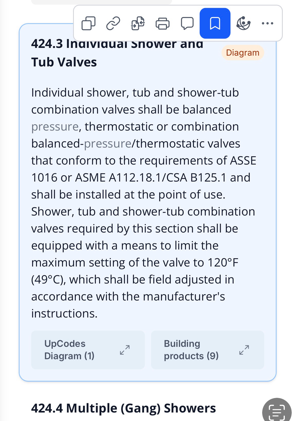

    I don't believe any plumbing code allows two handle valves. Tub shower valves need to be ASSE 1016 compliant.

    edited January 16
    "no direct indication in the provided search results that ASSE 1016-2005 is adopted or enforced as a mandatory code requirement within New Mexico’s construction or plumbing regulations."

    hot_rod Member Posts: 27,806
    New Mexico has a state plumbing code that is based off the 2021 UPC Uniform Plumbing Code
    If you are a licensed plumber in NM you should have access to a copy
    anyone should be able to access it now because laws can no longer be copyrighted.
    michigan's code also specifically says this requirement can not be met with an inline tempering valve for some reason.
    This makes me wonder if any "grandfathered" code allowances still exist.
    any jurisdiction can add addendums to a code specific to their area
