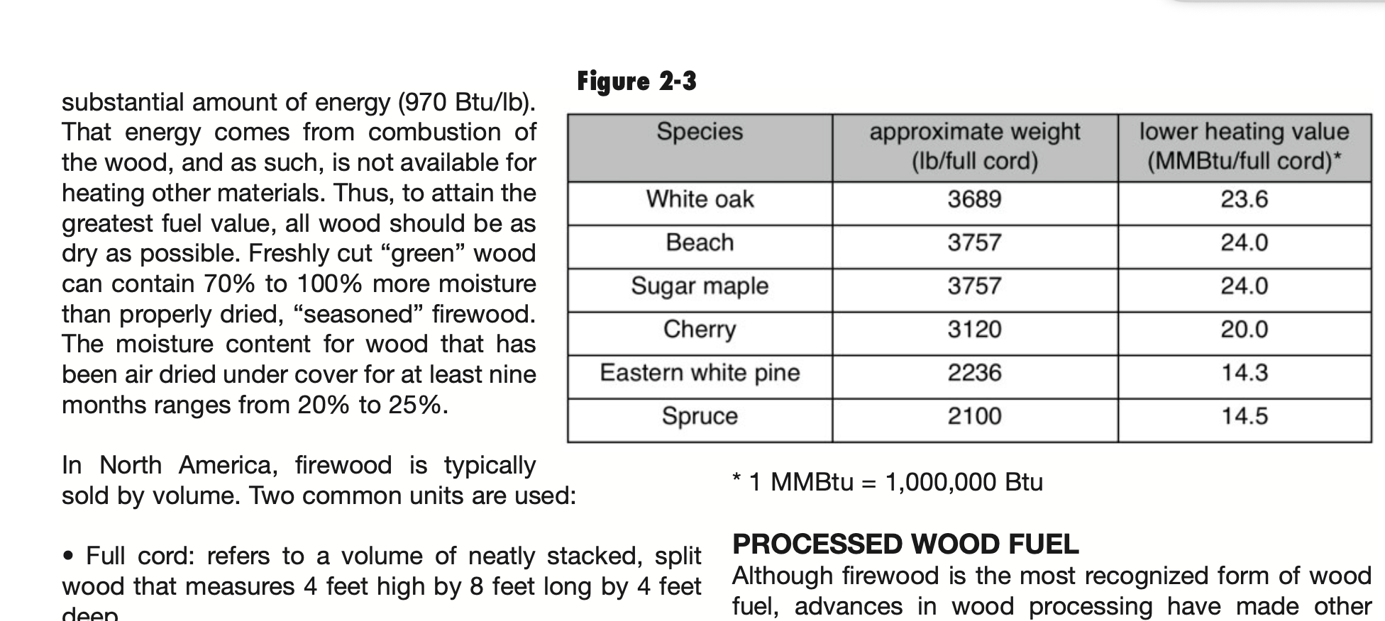

    You don't say how much wood you're burning, but on their website they have a calculator that shows a cord of red oak is equivalent to 139 gallons of oil. So burning at that top output would equate to a cord every 14 days, or every two weeks. If you're burning less than that your output is going to be less.

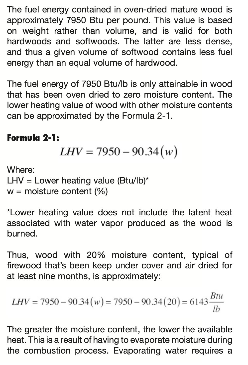

    Missing from those OWF wood usage predictions are the quality of the wood, moisture content, and that it is burned at high, gasification temperatures.
    So dry, aged hardwood would be the fuel for optimum performance.
    Often wet, green, or too large of diameter wood is shoved in them. Unless wood is split down to 4 or 5" diameter the core will not air dry to a low moisture content
    Studies years ago showed about 40 - 45% efficiencies in common OWF.
    Some wood burners will swear that green or wet wood gives you more btus, than dried wood.
    That is not quiet the case.
    Diehard wood burners own and use a moisture meter to check the condition of their wood.
    Some numbers, for crunching, here.

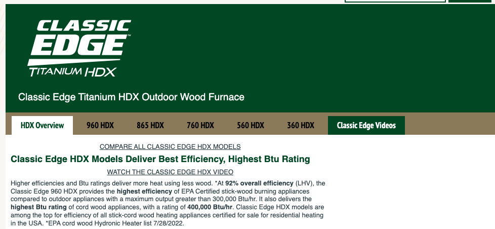

    Screenshot 2026-01-11 at 3.41.32 PM.png Screenshot 2026-01-11 at 3.38.55 PM.png

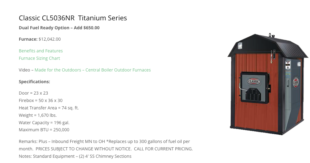

    Output number vary based on the version of the 5036.The HDX shows 400,000, the NR at 250,000
    I wonder what size oil gun the offer for the dual fuel?

    The 5036 is a non-gasification conventional turd with about 30% combustion efficiency using dry wood. They actually do a little better with wet/green wood due to the lack of heat exchanger. There is no such thing as an HDX (gasification) model of 5036. CB rates the BTU output at 250k/hr, but that's the first hour not continuous output. I have come to find in the real world with average 20-25% MC hardwood, continuous output of a 5036 is approximately 125-150k/hr which should cover this load, but something as simple as waterlogged underground lines can easily suck up 100k in a long run and this is an extremely common issue from folks who didn't want to spend the money on good underground lines such as Thermopex that comes from Central Boiler. The only way to know for sure is to start running some diagnostics (temp readings, head loss calcs, etc) to find out where the BTUs are going.
