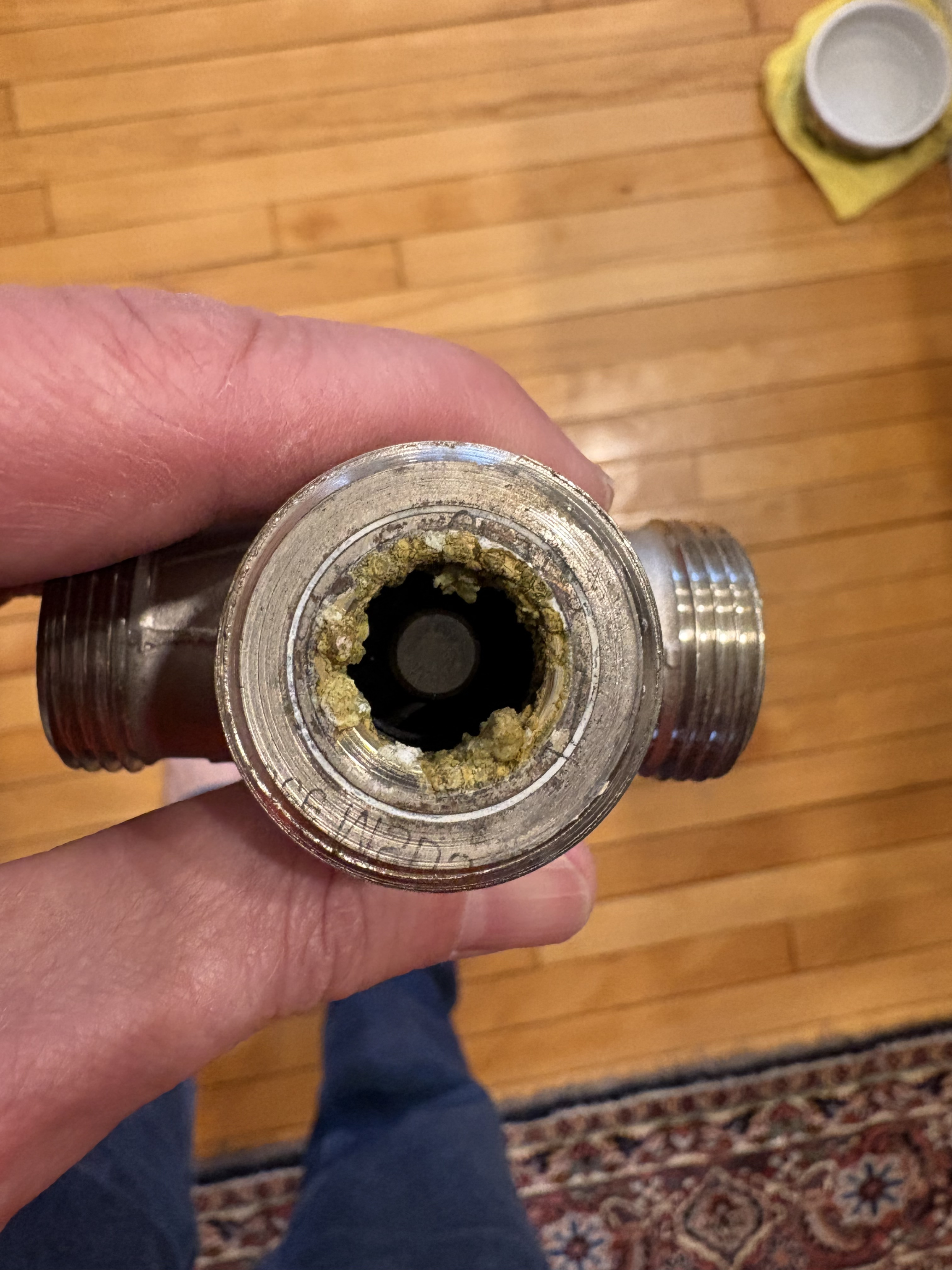

  • @pecmsg I would agree with you about the body but it is the same in 8 units with three different valve brands. This is what the mixing valve looked like when they took it out.

  • @hot_rod I just posted pictures of the mixing valve that was removed. The pressure is the same on both sides of the system. It was clogged with calcium but the new mixing valve next to the tanks didn't change the temp drop. Again not a supply issue we have 2 80 Gallon indirect tanks with the boiler set at 160, all temps confirmed.

  • I just replaced the mixing valve it had a lot of crust build up inside it. The issue is much better but it is still there.

    If the cartridge on each of those shower valves are like the mixing valve pictured, your work is not done yet.

    hot_rod Posts: 28,708
    If a mixing valve at the HW tank was corroded like that it can stick the spool and temperature will be very erratic, hot, warm, cool etc. Cleaning and rebuilding the 3 way mix valve may solve the problem.
