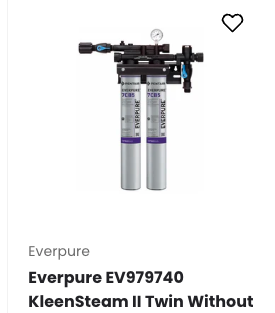

    I recommend a steamer fill water filtration filter assembly, hard water takes elements out quickly if you use it regularly. Some steam generators units have a drain down and flush after use also.
    Screenshot 2026-01-10 at 12.14.07 PM.png Screenshot 2026-01-10 at 12.12.42 PM.png
