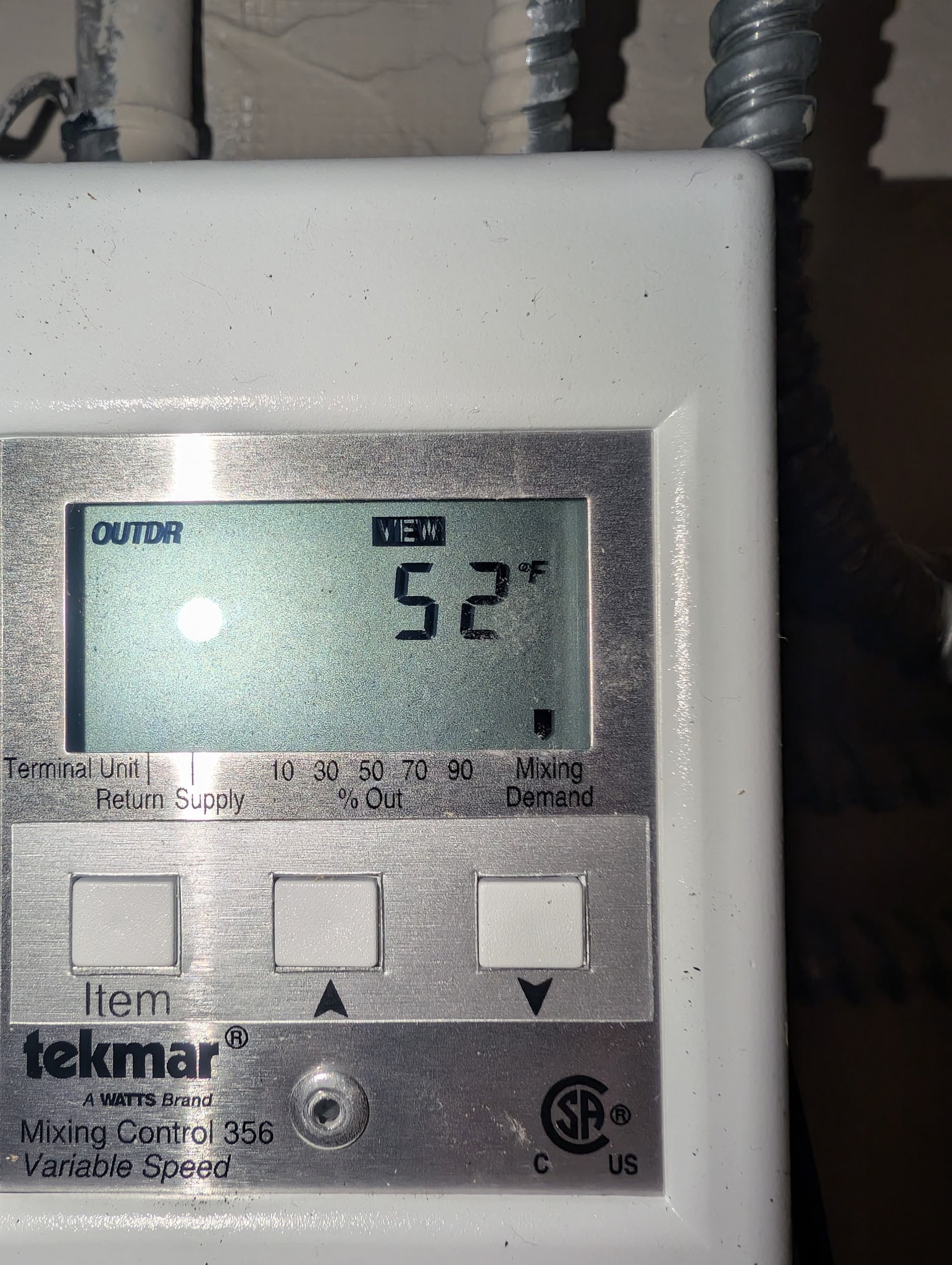

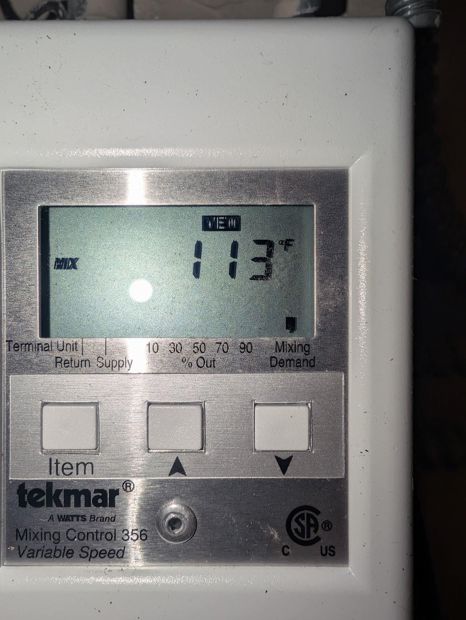

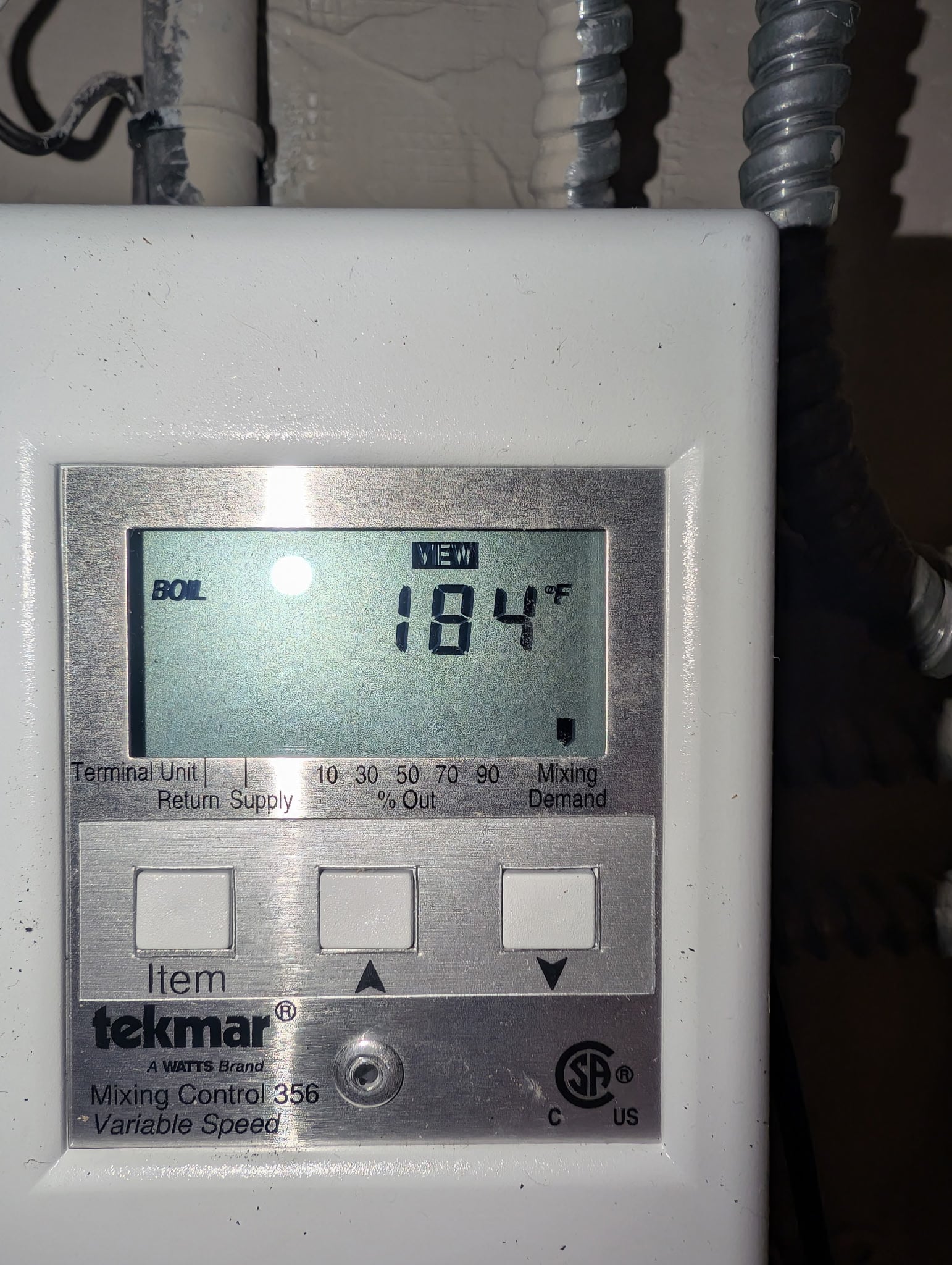

Tekmar 356 is showing the mix demand icon in lower right screen. It however doesn't show any pump percentage in the bar graph. Is this normal?
    hot_rod Posts: 28,705
    Scroll through all the parameters, with the item button I believe, what is the supply temperature. Is the system heating? Supply to the system warm?
    Screenshot 2026-01-09 at 12.11.34 PM.png Screenshot 2026-01-09 at 12.12.23 PM.png
  • GM_73
    GM_73 Posts: 11
    Customer is stating floors aren't as hot as they used to be. We replaced the Tekmar about 3 weeks ago because the screen was blank and the inject ion pump wasn't working. Customer sent screen shot of display, will be going there Monday.
    Mix temp- 113
    Boiler supply 183
    Outdoor ambient 52 (Chicago in January)!
    Thank you

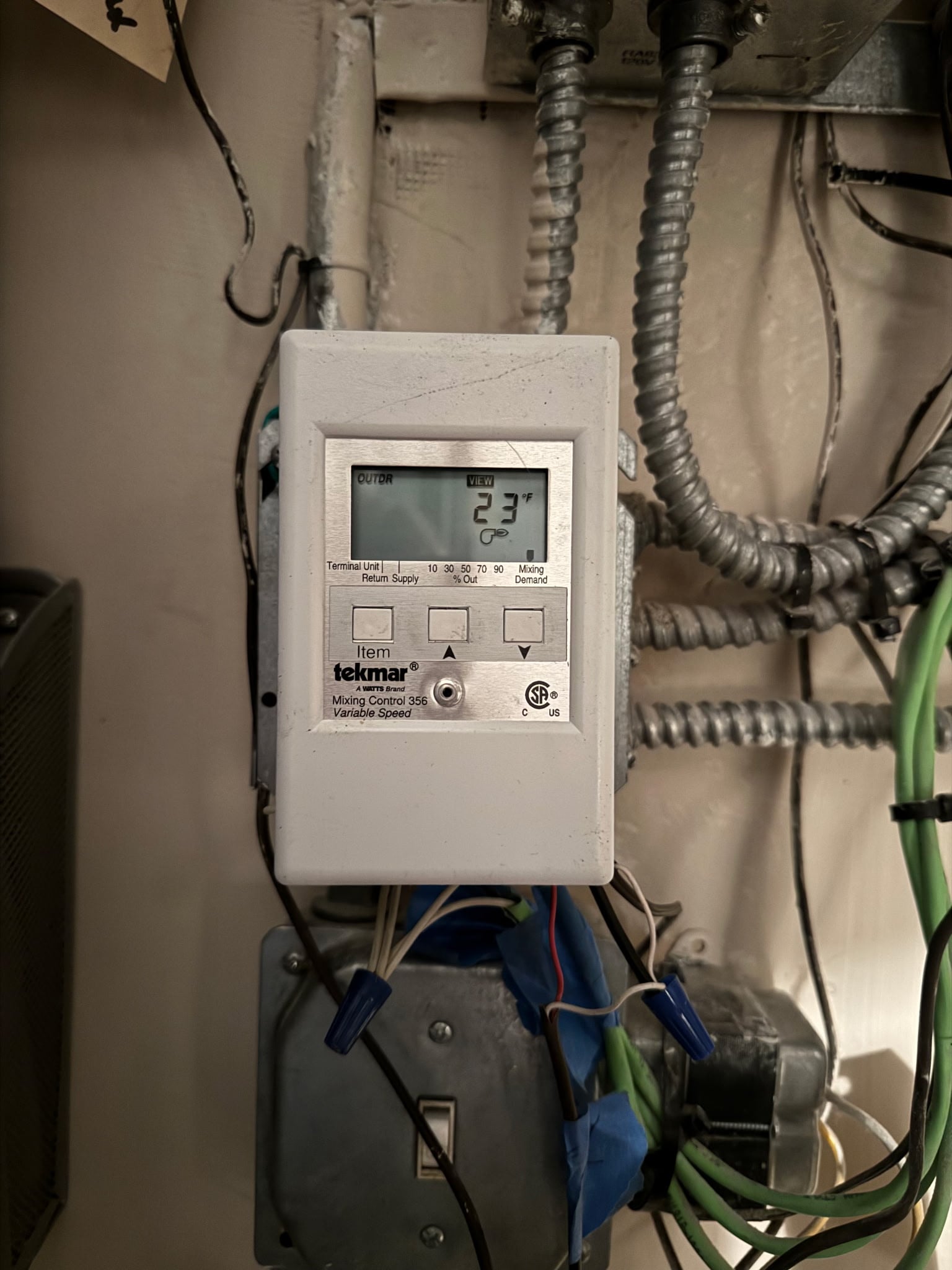

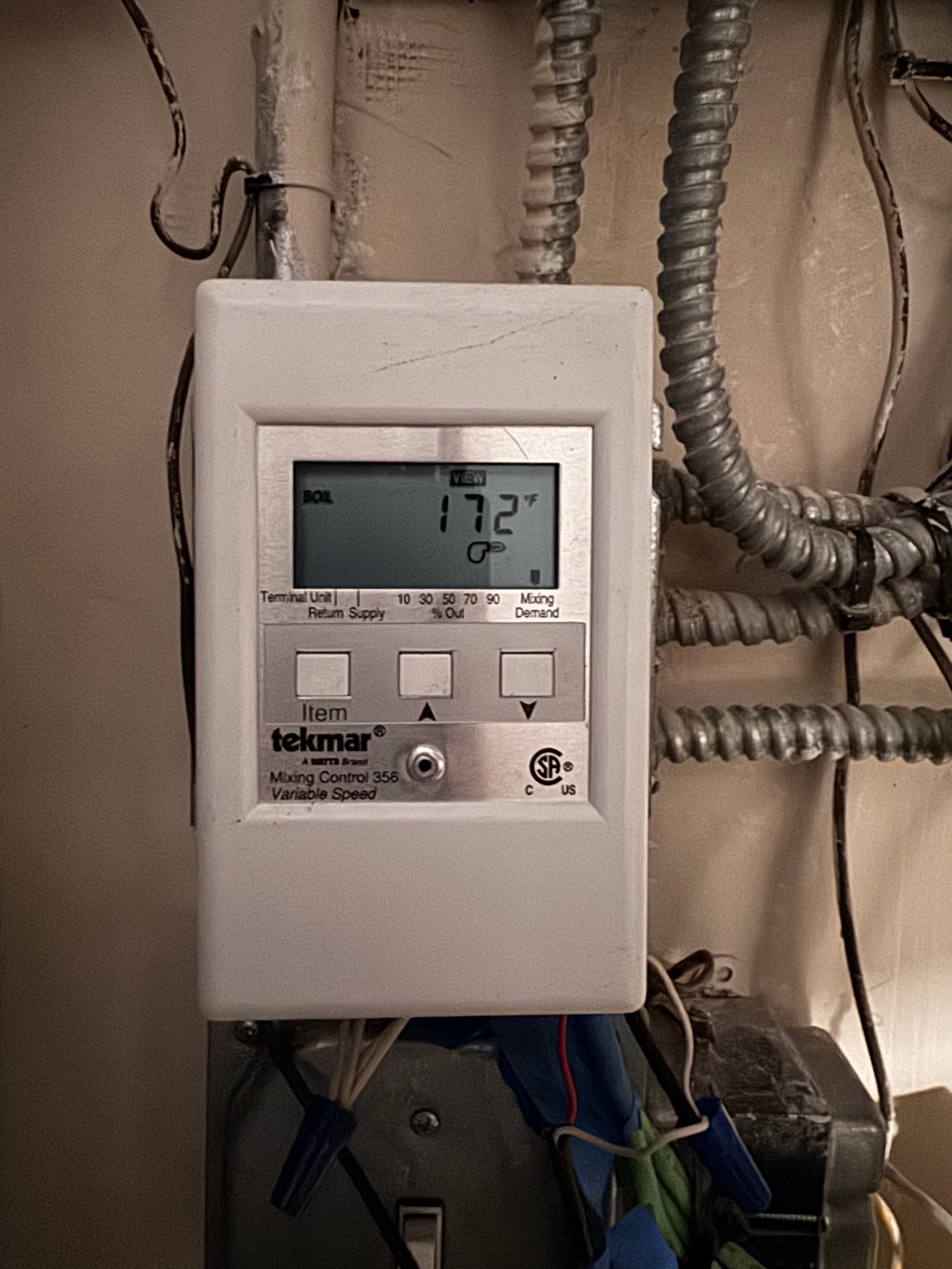

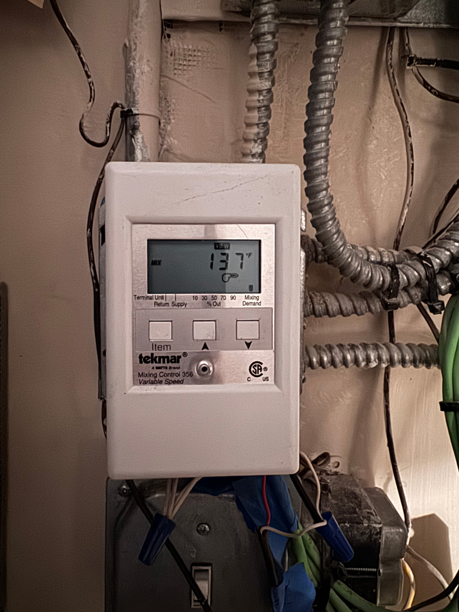

    Attached are later photos of the troublesome Tekmar on a colder day. Will be onsite tomorrow armed with variable pot, sensors and new 356 IF all goes south. Customers have been exceedingly patient. I am nearly 2 hours from site.
    Question? (1)- The "mix" icon in lower right is generated when terminals 7 & 9 make, or on a call for heat? I do understand that doesn't necessarily mean pump will run, other criteria must be met. Thanks a lot!

    That control usually tells you if and what is wrong via error codes on the screen.
    If you are not seeing error codes, test the sensors for resistance, and scroll thru settings.
