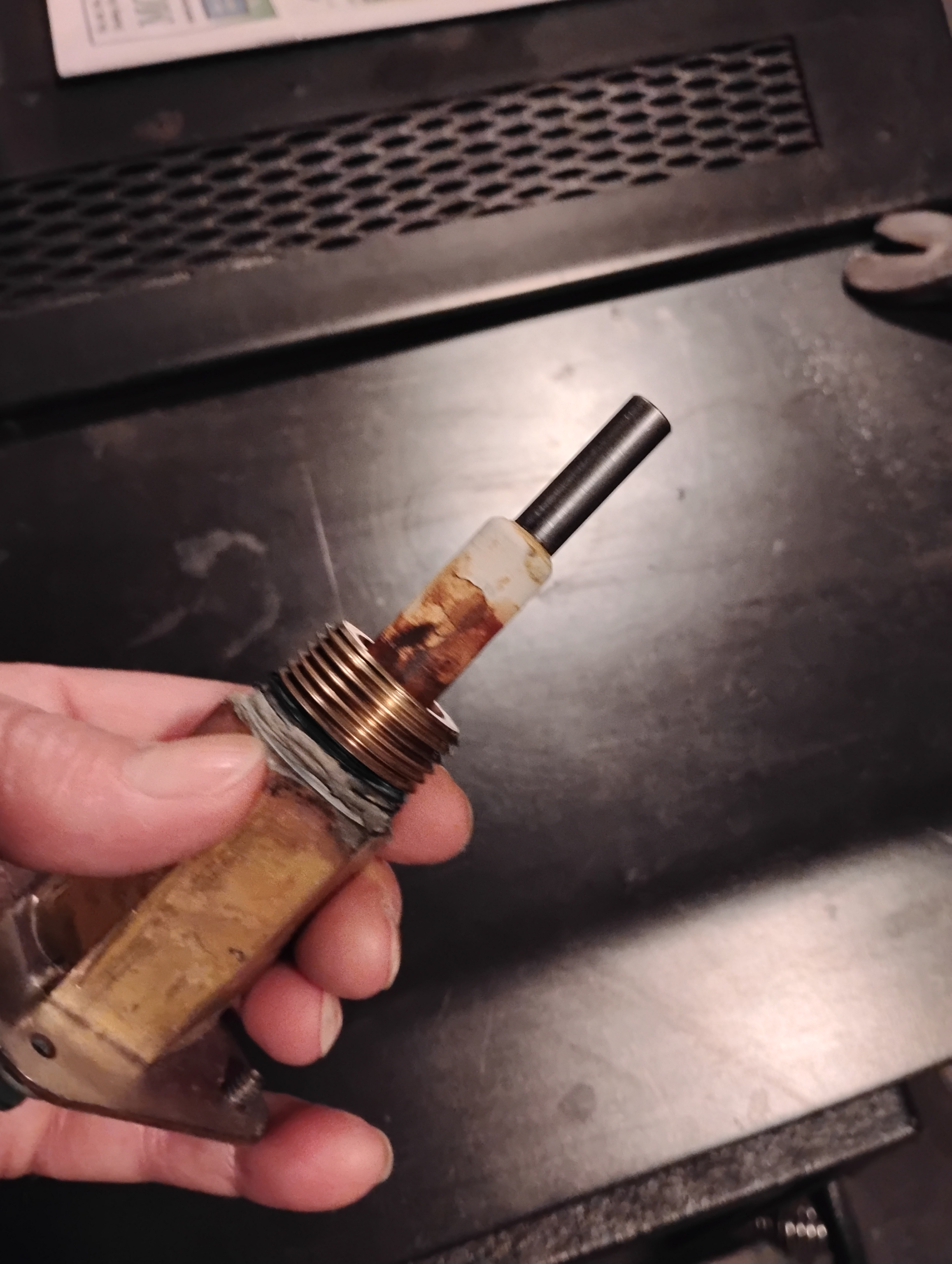

I pulled my probe and it was encased so I soaked it all day in vinegar/water solution and scrubbed a little with a toothbrush to get it clean. Re installed and it doesn't call for water as much but still calls everyday.
I bought a new probe but have not installed it yet because I'm not sure if it is the problem or part of the problem. If there is something else going on here I could still return and get my $89 back.

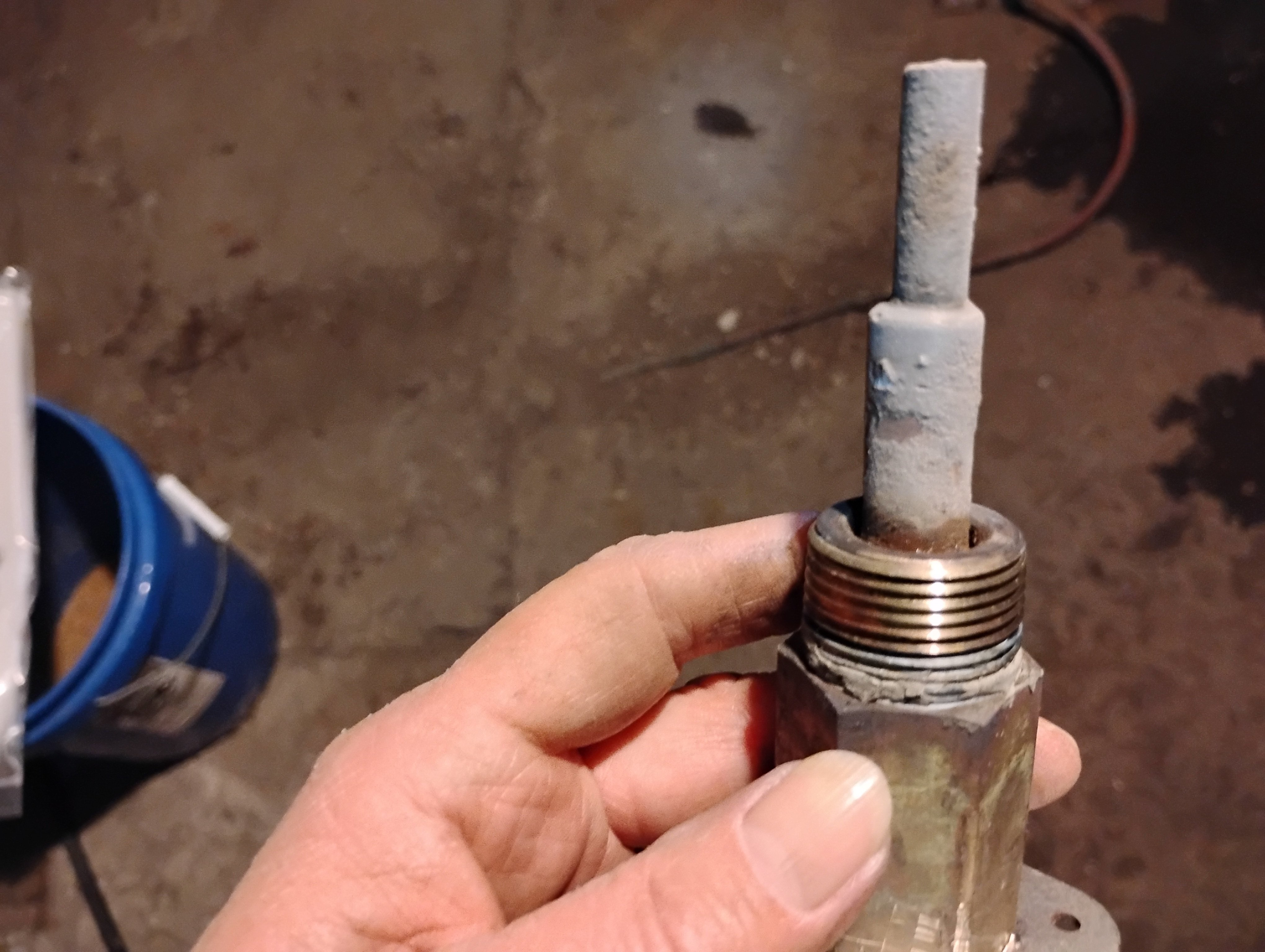

After cleaning— I was afraid to scrub the white insulator part.

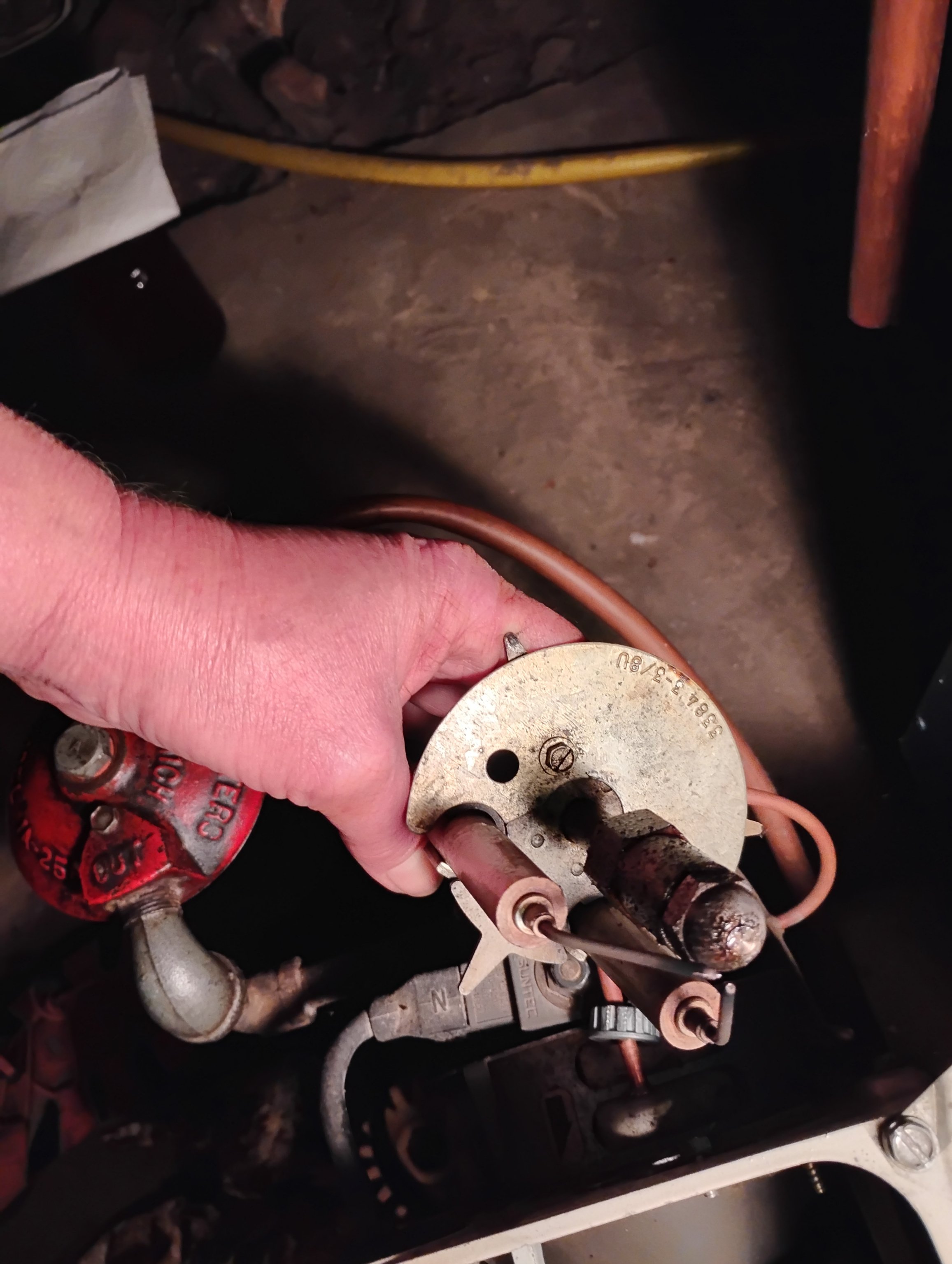

I bought a new "wooly" and nozzle and checked electrodes.

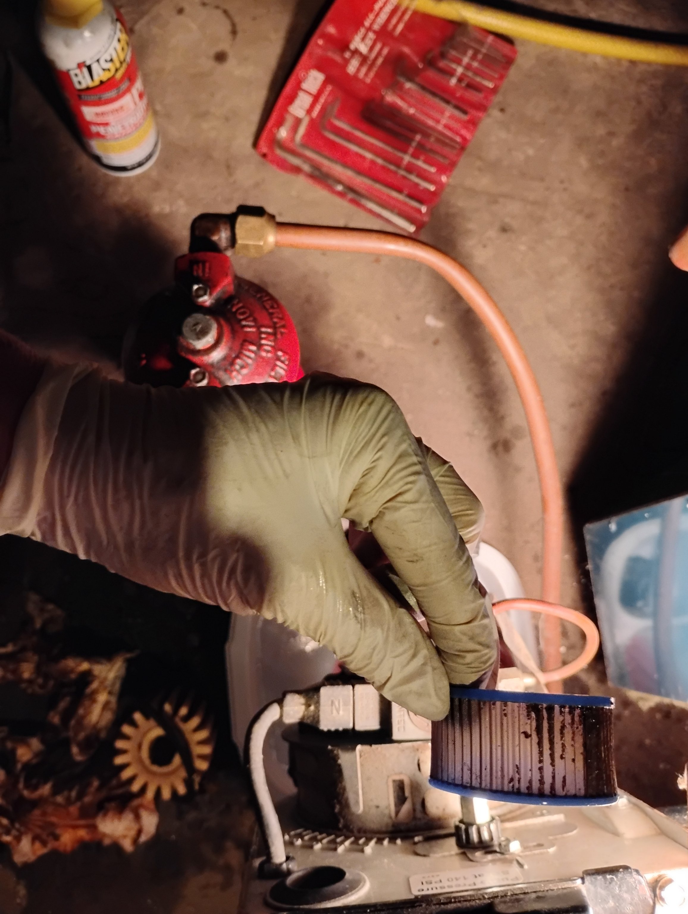

Installer put the white filter in the last time (Feb 2025) and I didn't like it. You can see chunks of it in the cup. I replaced with "wooly". Had to scrub the inside of cup with a toothbrush to get all this crap out. Oil tubes to nozzle were partially plugged. Had to spray a couple of times with PB Blaster to clear.
And lastly, I pulled the screen filter by pressure pump. Cleaned and put back in. This has never been checked by installer.

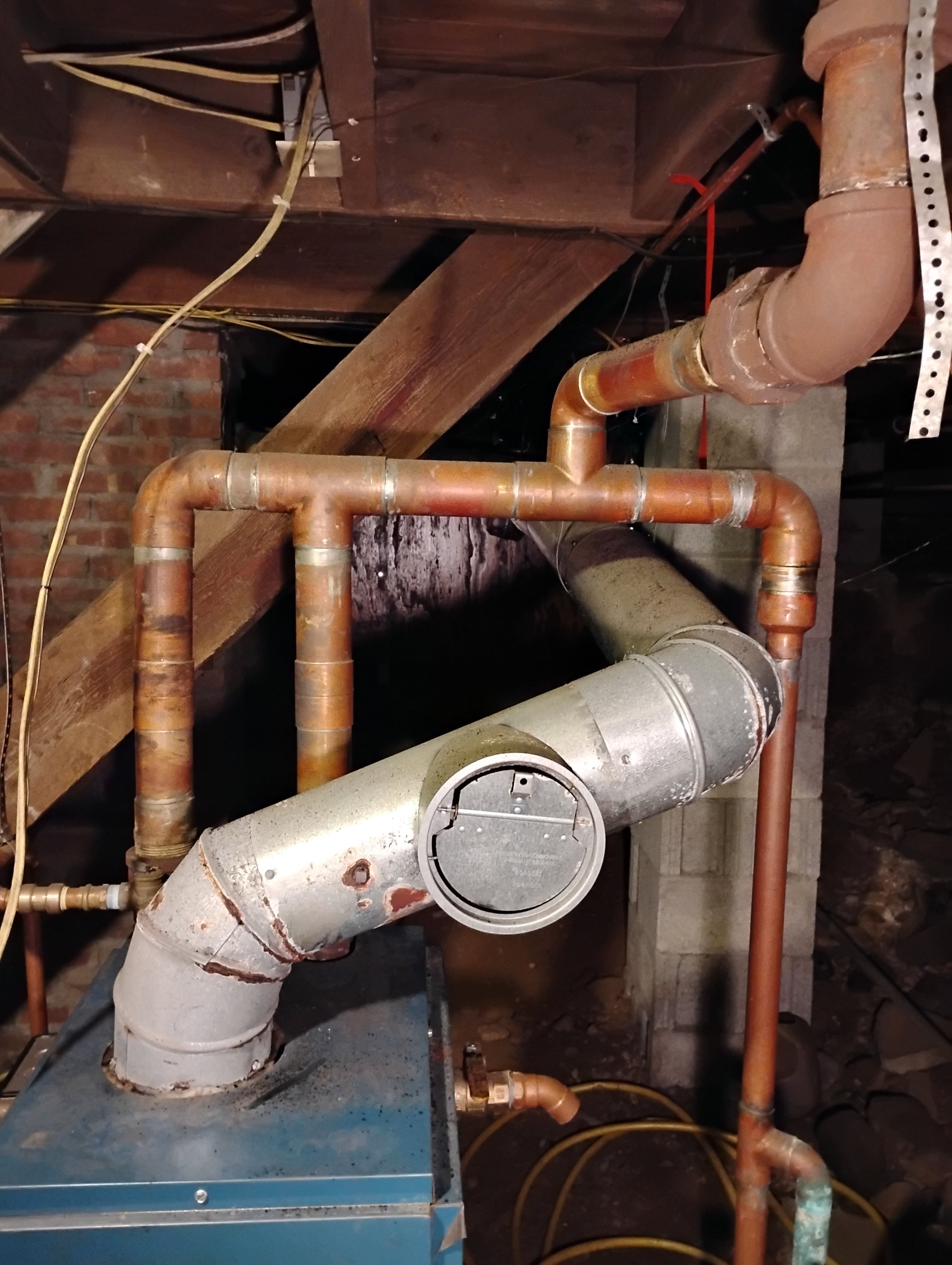

I feel like I'm not getting good dry steam and that it is pushing water, maybe because I wasn't getting a good flame? Should I pull the top cover and brush the nipples and clean the chamber since it has never been done? That would allow me to check for wetness in the chamber since I heard a dripping noise. I have the boiler cleaning brush needed for this. Do you think the probe is part of the problem? Keep in mind, all components date from 2010 when I got my first Dunkirk. Only heat exchanger was replaced.
The whole shebang.

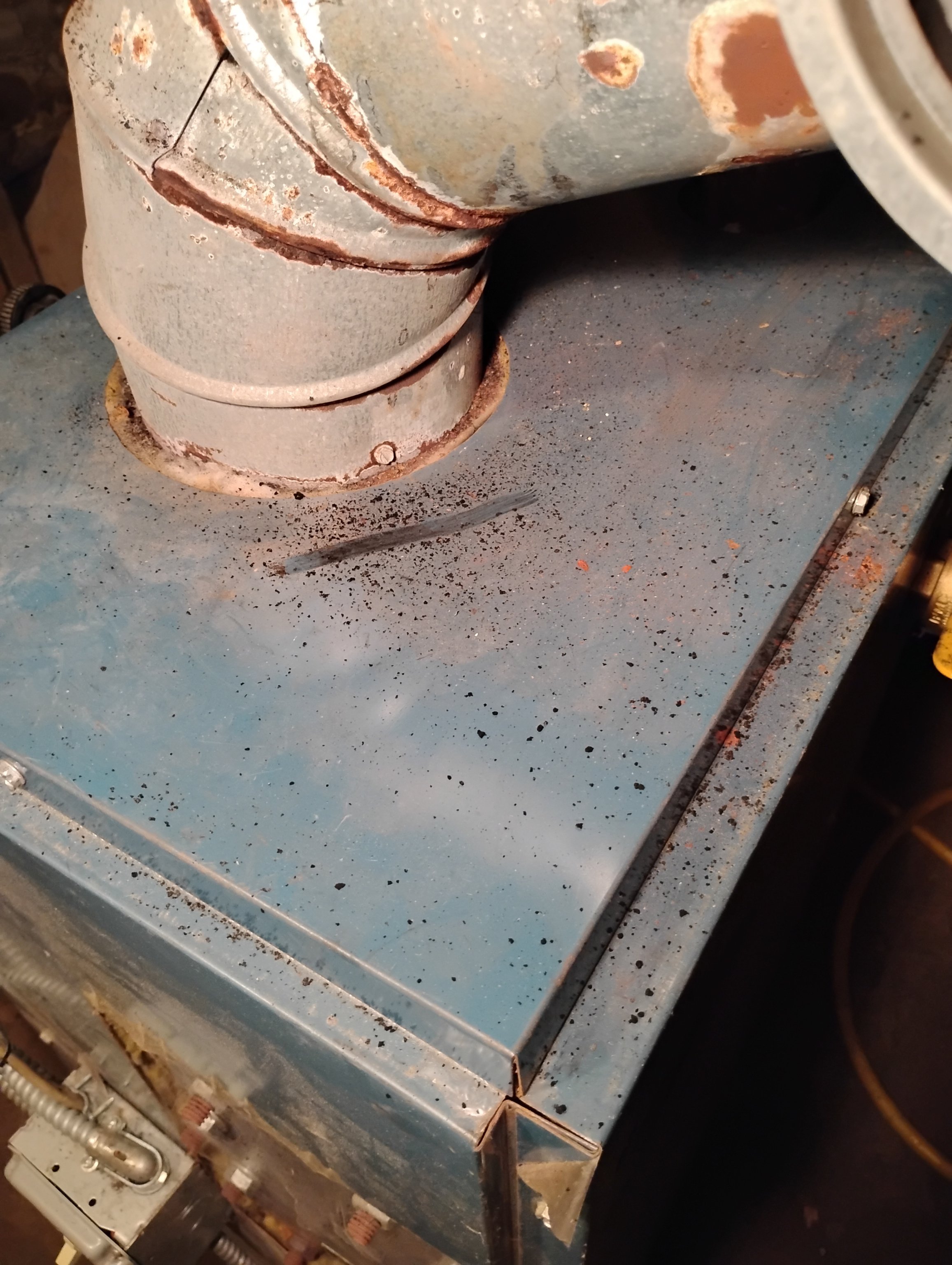

Not as much soot as before. But still . . . I run my finger through it. My black pipe was replaced with all copper when the first Dunkirk was installed. I argued against it and lost.

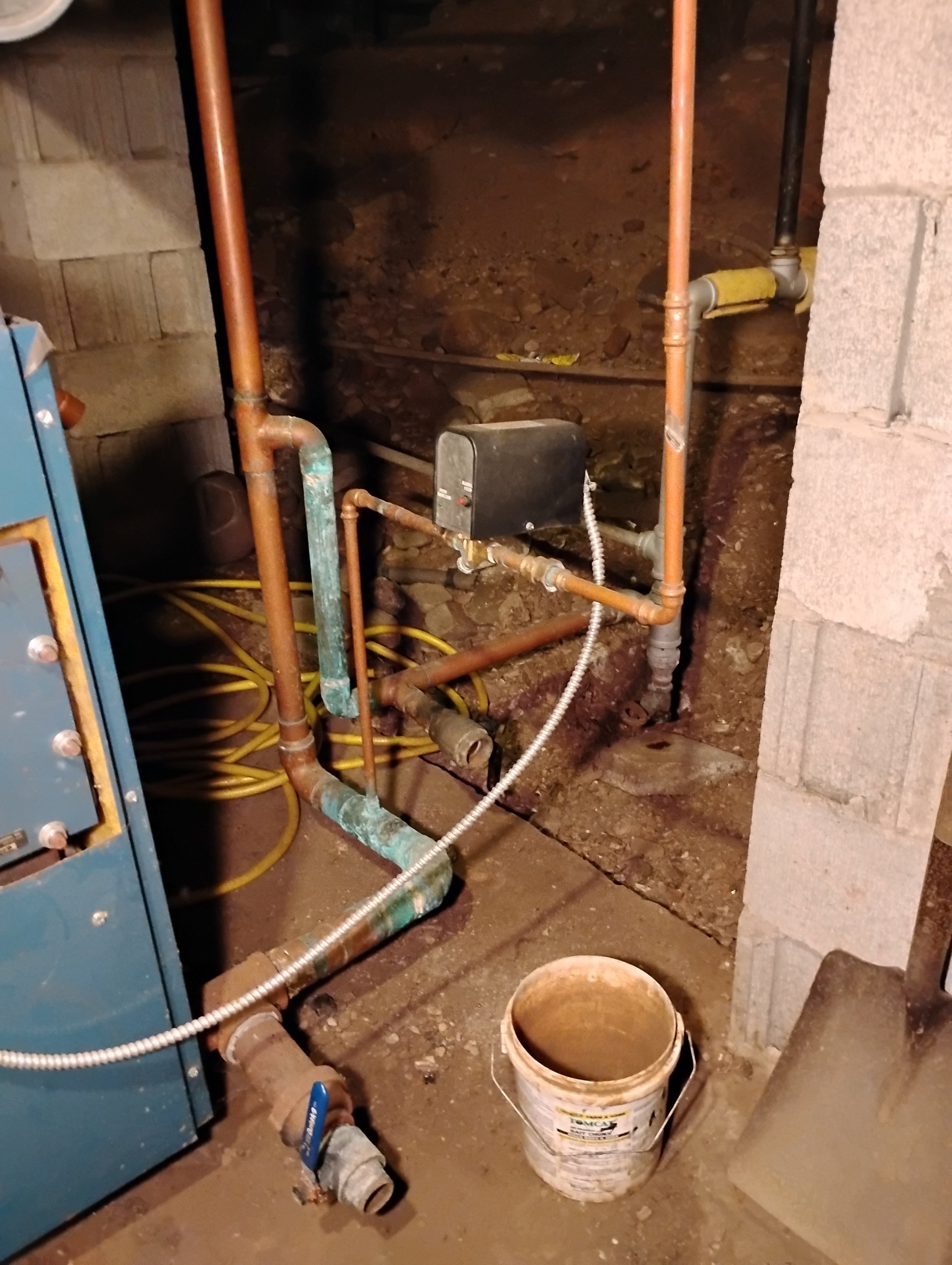

The copper pipe at the top of Hartford Loop has leaked since day one (2010). Slow drip . . but still. I argued with that installer that it needed to be fixed/resoldered. After all, it is a closed system. Their "steam expert" said it wasn't going to hurt anything.
I blow down every Sunday morning from the two ball valves above. But since it calls for water every time it cycles, the water at blow down is crystal clear—so I have not been doing it.
Lucky for me, I also supplement with a coal stove in the kitchen for when the temps drop to make it easier on my oil consumption. I've been trying to wean myself off coal since I'm now 63. So far, I have been buying more coal than usual to take the load off the boiler and it's problems. Some specs . . .
I'm using .75-80A for nozzle. That is what was in it. According to the book, it is within it's limits and uses less oil than what is on sticker. I also figured combustion was setup for that size.

    Well, to start, if it's making soot — any soot — the combustion is out of adjustment. Now you don't need a steam familiar person to adjust the combustion — an oil burner is an oil burner. Does your fuel oil supplier have a service department? Might try them (if that isn't where you were already…).
    So that's where I'd start.
    But that much crud in the filter also makes me wonder about the quality of your fuel oil. Shouldn't do that.

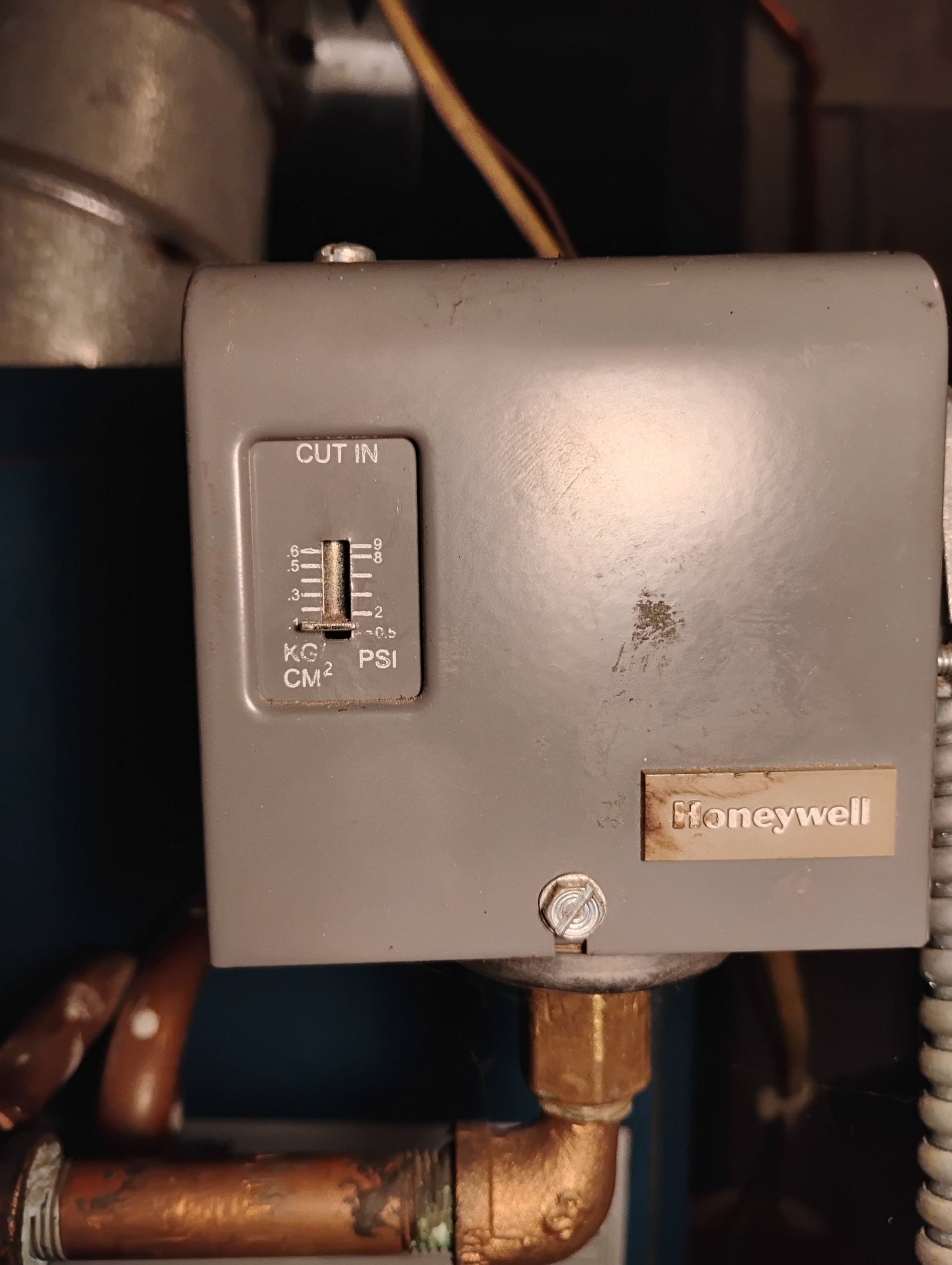

    What is the pressure setting of the pressuretrol? A picture, please, if you are not sure.

    Your two problems are soot which a modern boiler/burner should not make. Dunkirk make a pretty good boiler but they didn't install it right.
    2d problem is excessive water MU. If you are adding water you have a leak. Hopefully not the boiler as it is only 6 years old.
    You can lose a lot of water without seeing much. Packings around valves and air vents.
    Excess MU water will make a boiler fail early.

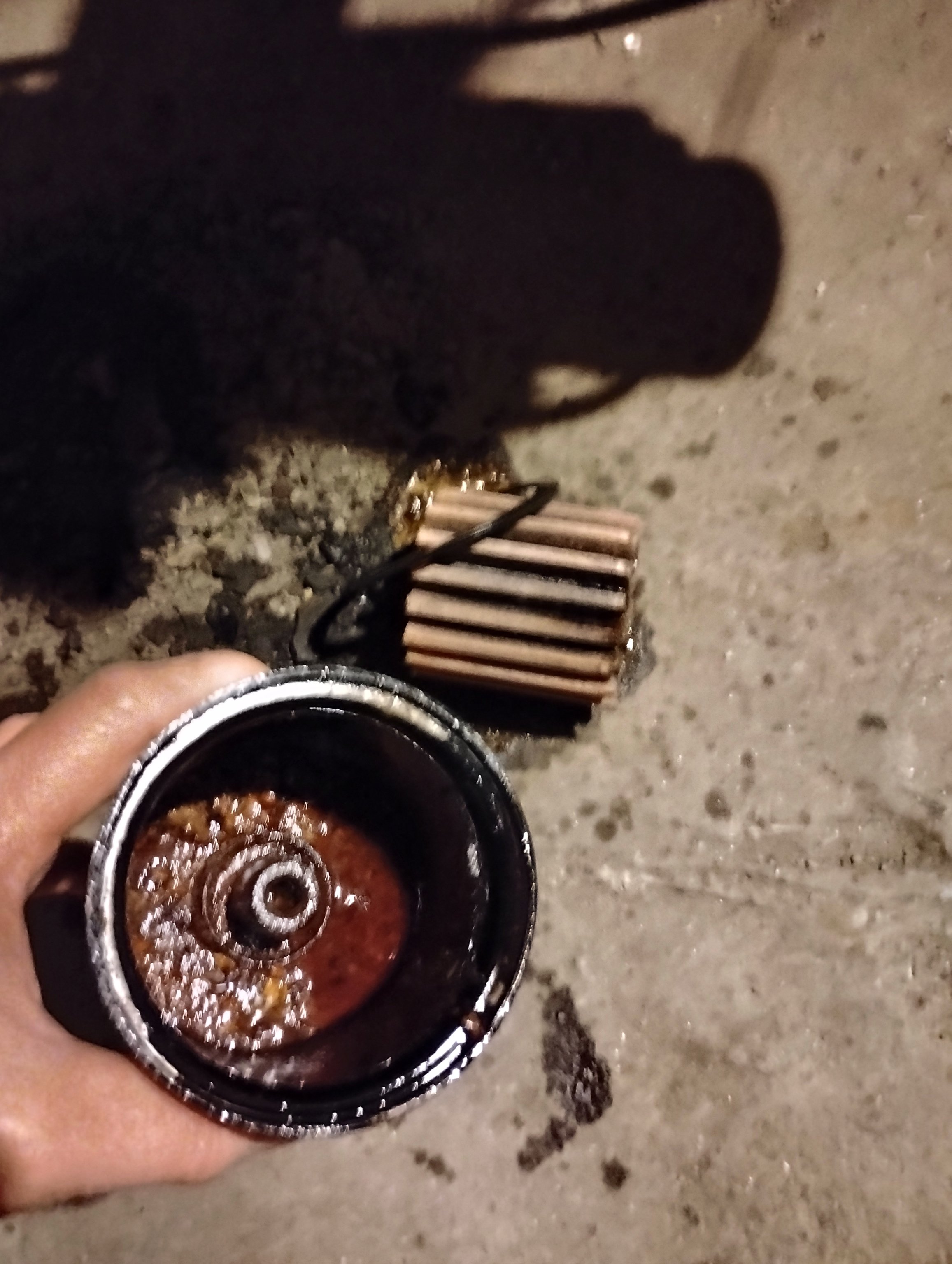

    And that oil filter canister shows evidence of water getting into the oil tank. Need to find that problem too, and fix it.

    if it is a probe type lwco it doesn't require periodic blowdown.
    if the boiler install is that knuckleheaded i would be surprised if all the vents and valves were verified to be leak free.

    Soot = bad combustion.
    Your nozzle looks very dirty - just replace it as it's a cheap part that should be changed with boiler maintenance.
    Changing nozzle for a different type, you need to adjust air ratio. Your oil burner has two air adjustments: band and plate near the burner on the left side. Your burner manufacturer has specs for each nozzle set-up.
    On my steam boiler, inept maintenance person changed the nozzle for the one used for hot water without adjusting air ratio - this produced VERY sooty boiler.
  • I realize I have two problems—soot and water. I'm really more concerned with the water problem. I KNOW that excessive MU water is the slow death of a boiler.

  • Every time I get an oil delivery, I have to run out and check my filler cap. I have found it tittering on the top and not screwed on and I have found it laying in the snow. REALLY!! I turn it on so it is tight, then back it off a 1/4 turn. That way I can gauge if somebody messes with it. Trust but Verify!!

    maladjustment. any oil burner needs to be checked and adjusted with a combustion analyzer and a few other tools when it is installed or serviced

    First, if you have a probe type low water cutoff there is no need to blow the boiler down except maybe once per season. Maybe not even that. So stop. There will be some initial accumulation of sludge from the initial water fill, but so long as additional water is not added, no or very little additional sludge will turn up.
    Losing a gallon of water a week is a bit much, perhaps, but not catastrophic. Worse, it can be hard to pin down losses of that magnitude. One single drip every ten seconds or so will be that much water! And drips have this way of evaporating on steam pipes…

  • Soot = bad oil/air mixture. Period.
    Bad oil can cause soot because by delivering oil + dirt, you offset the oil/air mixture (by clogging the nozzle).

    the copper can pull the sections of the boiler apart and make it leak because the copper expands more than iron and there are no threaded joints to twist a little.

    You seem pretty handy, I'd repair the Hartford loop leak myself, plenty of videos on YouTube on how to sweat copper pipes.
    " I need to know if the boiler is leaking or the probe malfunctioning. "
    These are two very independent issues, which requires different tests.
    Over filling the boiler would test if the boiler's heat exchanger has rotted out above the water line.
    Draining it below the probe level should cause the LWCO to trigger the water feeder to fill it up to at least to the probe's level.

  • At the 3 week mark, I pulled the cup to check and there was some sludge in bottom of cup. Cleaned and replaced filter. So I ran out of oil on Thurs. I found out last night they would deliver today (Sat.). Went down early this morning and took the plug off the top of tank. Extended a camera down in there that has LED's on it and took a couple of pictures. Wasn't sure what I was looking at but looked like it could be sludge near the fitting. I have two fittings on bottom of tank. I opened up the drain valve and dumped in a quart of hot water at the top. I got a quart of black water in my bucket. So I kept repeating this and got a lot of black water with sediment. Sometimes I got a steady stream, then surge and spit. So I know there is sludge floating around in there. Decided I would use my small ShopVac to reach in and vacuum most of it. Before I got that far, I heard the deliver truck pull up. I could have stopped him but it can take up to seven days to get him back and we are in for a big storm. He gave me 220 Gal. He arrived at 10:30 a.m. I have not fired yet. I'm worried I may have loosened too much stuff with the hot water. Is there any advantage to letting the new oil settle or blend with the sludge? Should I dump in "Diesel 411" in the tank?

    I would NOT have put water in the tank. If you wanted to dissolve the sludge, you should add something that will mix with the oil.
    If you have a filter at the tank, remove the filter housing and open the valve to drain out a gallon or so of oil until the oil is red and clear. It wouldn't hurt to add an additive that absorbs water, but I'd mix the additive with a couple of gallons of diesel before adding it to the full tank.

    As @MaxMercy says! Open the drain (have a big transparent container handy) and drain oil until it is completely red and clear in colouor when standing for a few minutes. Even a small trace of water or sludge will make it very difficult if not impossible to get your boiler going again.

    Go back to what I said. Drain fuel from the tank into a clear container and let it settle. Keep doing that until there is no water or sludge layer visible (the water layer will be at the bottom with fuel on top; the dividing line may not be all that obvious).
    If you are getting inconsistent flow — suggesting sludge blockage — keep going until it is good and even and smooth.

    The copper isnt the end of the world, its not great, but the threads will move and leak before the cast rots. The leak at the Hartford needs to be fixed. You dont need a steam man to do it. Any plumber can as long as you know the specs. Keep the tee at the right height and the street 90 going in. The rest is coupling work. Just find a licensed plumber over the age of 40 and they should be able to sweat a few joints.

  • I drained out about 15 gal. of fuel oil before it stopped being chunky and was clearer. It also began foaming a lot in the bucket. I knew foaming was a good sign. So I cleaned and changed my wooly filter. Pulled the little round screen in the fuel pump and that had chunks in it. Cleaned and wiped and put back in. Pulled the nozzle and tube—cleaned put back in. I was afraid to drain the copper line from tank to wooly cup. I don't like cranking on those fittings. I fired the boiler and sat with it. After a few minutes, I noticed fuel oil dripping out from under the burner and risers were not getting warm. Then boiler started smoking and I powered off. I visually checked all connections that I had messed with and there was no fresh fuel oil around them. I contacted HEAP and they will pay for repair/replacement and they give you a list of vendors to contact. I have to get 2 proposals for the fix and HEAP picks the vendor to use. The list is 43 vendors that cover my county. I have called about half on the list and can't get anyone to come. They either don't do oil, or I'm out of their service area (even though they are on my county list), or they don't return my call, or their mailbox is full and can't leave a message. So I'm still trying to call people and I've lost another week without heat. So, is there anything obvious I could check? Could the chunky oil that was running through it have damaged the fuel pump? Should I make a new gasket for the oil pump as mine did look fragile. I could not see real good down there but did run my finger along the seam and did not get any fresh oil on my finger. I have a roll of gasket for work on tractors. ???

    The New York State plumbing code allows copper to be used for steam-YUUUUCKKKKK.
    If it were me I would buy enough black iron pipe and fittings to have on hand when you replace the boiler and save the receipts to return the unused black iron pipe.
    The ceramic insulator is damaged and cracked by the looks of it in your picture. I would replace it and only blow down the boiler once a year as Brother Jamie has said.
    What really concerns me is the flue pipe condition and the barometric damper on your steamer, there is no adjustable weight scale on it and the handle is gone and the seams on the joints are very rusted and you should have no soot coming from your flue gasses.
