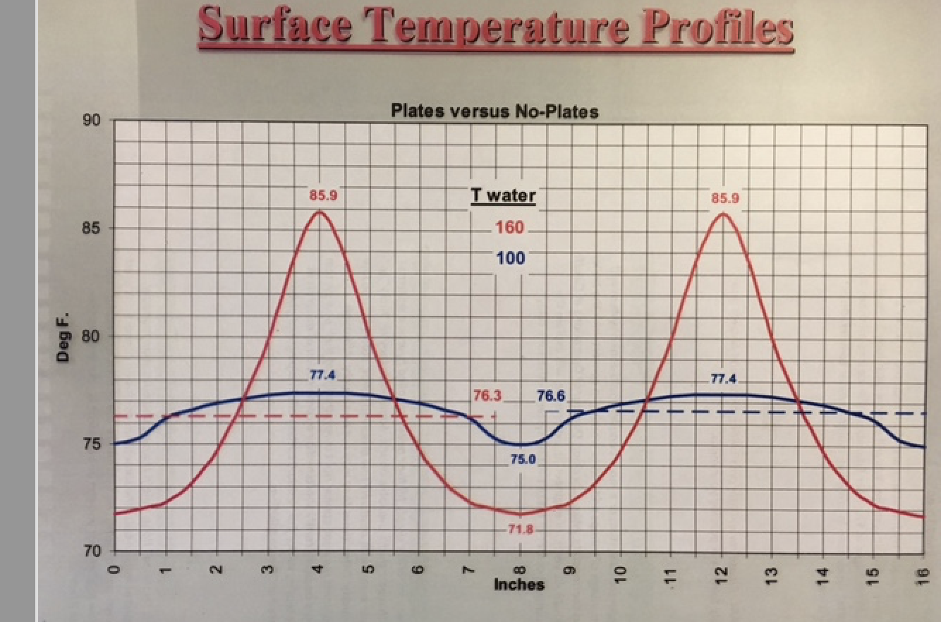

    I personally suggest 82° as the average floor temperature for a comfortable residential floor, ASHRAE 6.5 suggests staying below 80°. So base floor output on that 80- 82° number, and obviously that is a design day condition. If the boiler operates on ODR as it should floor temperatures will be constantly modulating.
    While 78 may not provide the warm toe feeling it is still much better than a 68 or 70° ambient room temperature floor, especially with concrete floors.
    Yes, floor coverings matter, both for the panel heat output and also for the comfort factor. 78° concrete vs 78° carpet or wood as an example.

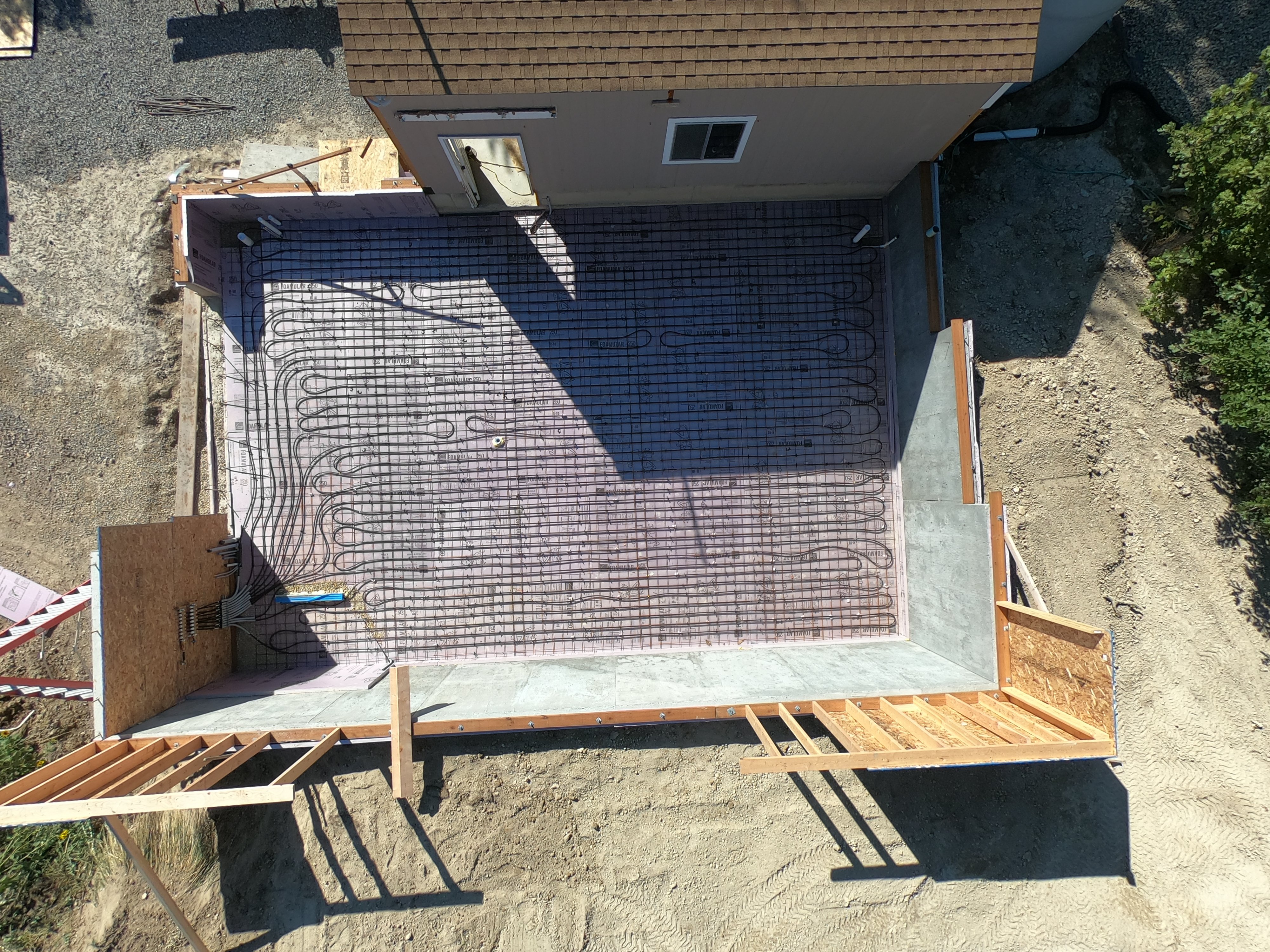

    Drone shots are nice for slab on grade jobs. This is my shop with 6" OC 1/2" loops.

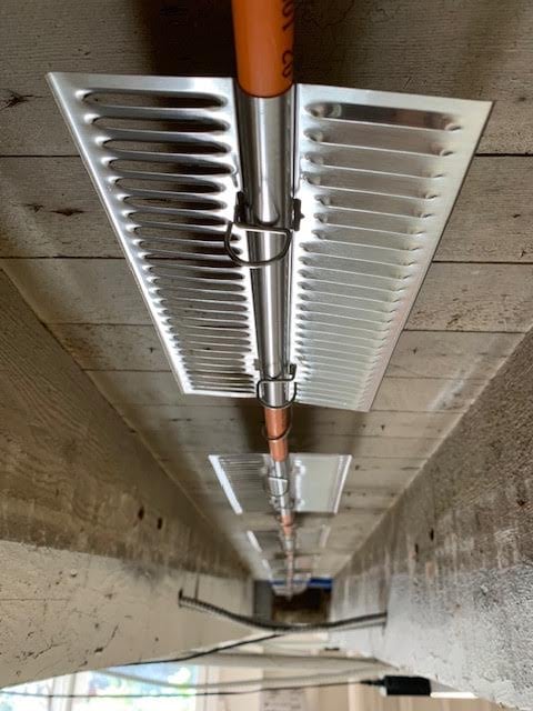

    I used to use plates and then switched to Ultra-fin. You only need one run per bay instead of two (so, less tubing and labor) and water temperatures can exceed 120℉ if need be; something you can't do with plates under oak hardwood.

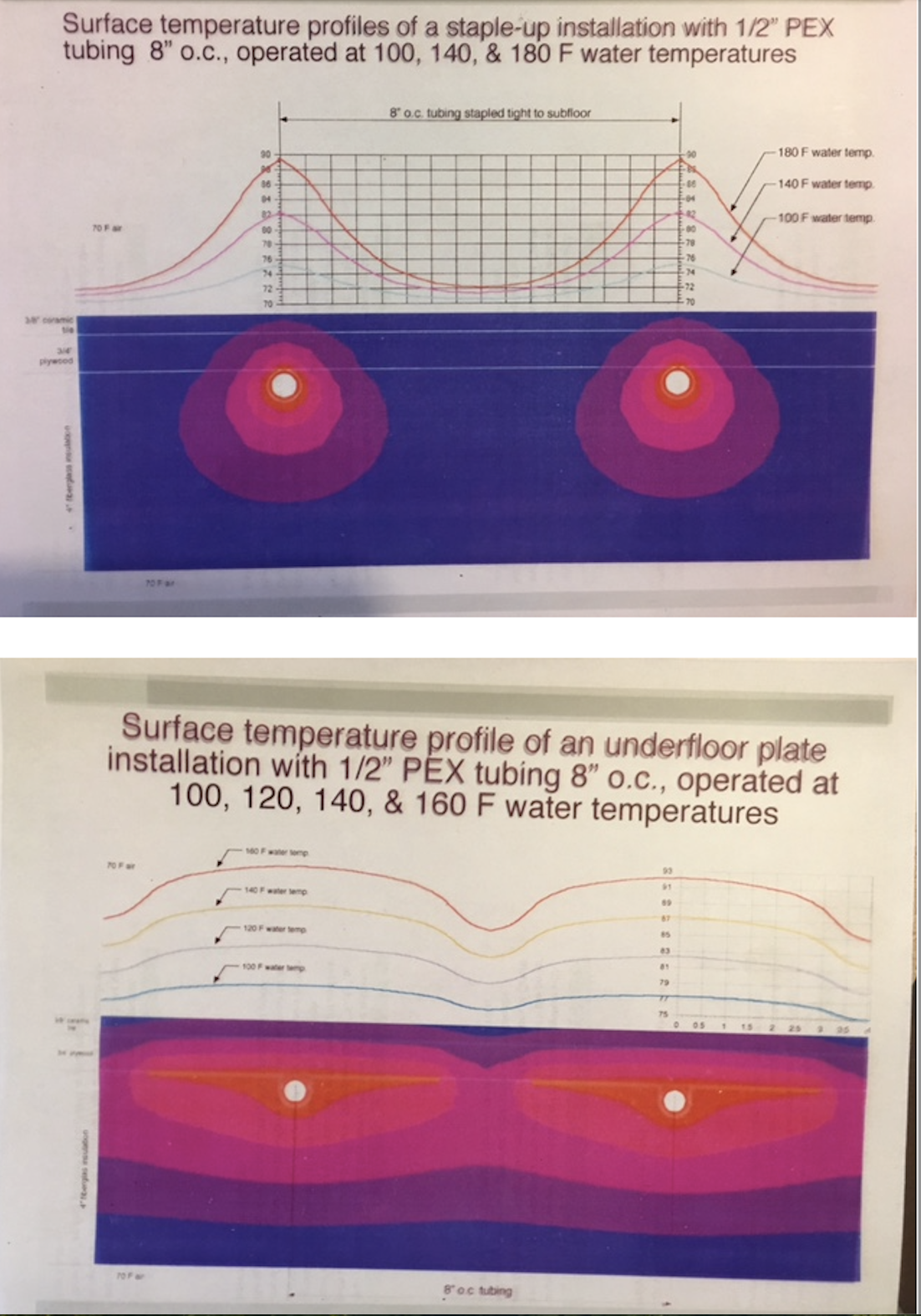

    Conduction vs convection heat transfer. Tube to plate is conduction transfer. Attaching the aluminum tightly to the floor is another conduction transfer.
    Compare bare tube performance to UF performance, the UF drives more convection currents.
    There is a place for both methods, conduction probably trumps convection for transferring energy from tube to floor.
    Put your hands near a warm coffee cup.
    Now wrap them tightly to the same warm cup
    Results?

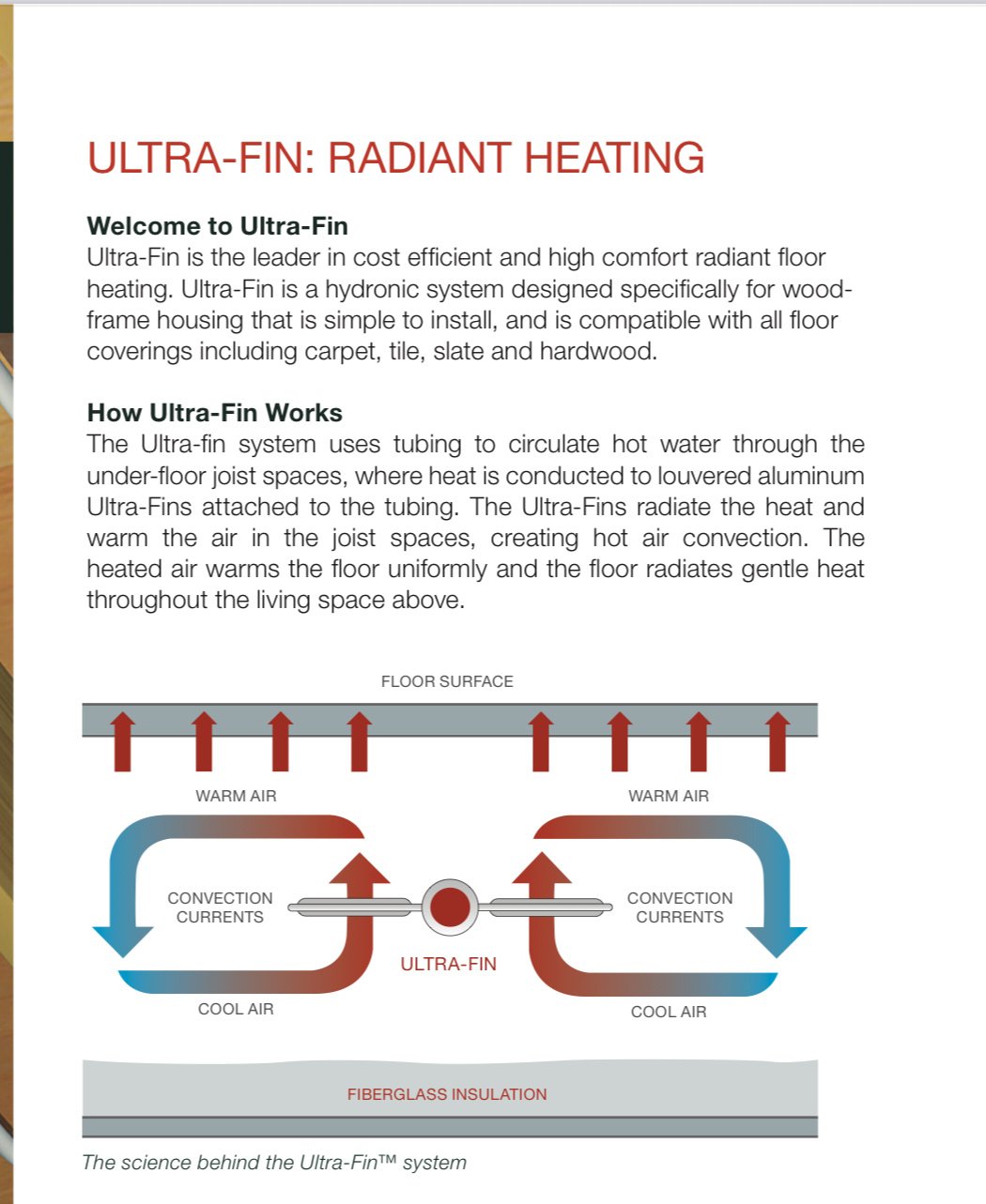

    @hot_rod Here's something to think about. You can't have conduction without mass. Also, you can't have convection without mass. Air is mass. 14 pounds per sq inch at sea level. You can't measure heat energy because you can't measure energy, only the effect of energy on mass. My thought is that mass is constructed of atoms and atoms act like a battery. When energy (radiation) fuses into an atom, it moves electrons into a higher orbital state and when the energy moves out of an atom the electrons move back to a stable environmental orbital state. Why do we use Ex tanks on our heating sys? Is it because the boiler miraculously creates more water molecules or is it because the boiler puts heat energy into the water molecule causing it to get larger? I mean there is a volume increase.
    Convection is really conduction. Tube to plate is conduction, Plate to air is conduction, and air to subfloor is conduction. Mass to mass is conduction.
    Ultra Fin has louvers which help to move air and the plate is suspended not tight against the subfloor which helps air circulation. But, as I stated, it's really conduction not convection. My question is it the most efficient method of conduction? My thought is that the greatest mass to mass provides the greatest transfer of heat energy.

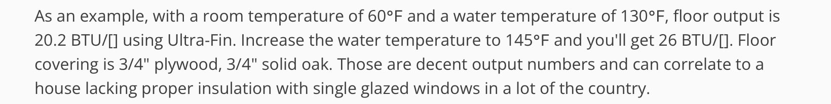

    @HomerJSmith With either plates or fins, manufacturers' guidelines, installation methods and engineering have to be trusted and followed.
    As an example, with a room temperature of 60℉ and a water temperature of 130℉, floor output is 20.2 BTU/[] using Ultra-Fin. Increase the water temperature to 145℉ and you'll get 26 BTU/[]. Floor covering is 3/4" plywood, 3/4" solid oak. Those are decent output numbers and can correlate to a house lacking proper insulation with single glazed windows in a lot of the country.
    If the house exceeds these numbers, you have to use a different product or supplemental heat.

    this is how UF explains the heat transfer mechanism of their product. Air being an insulator doesn’t transfer as well as conduction. Hold the pan of water 2” above the cook top, time it to boil, then place the pan in the glass cook top as a demo of conduction transfer.
    Regardless of how you transfer it is the floor surface, considered the radiant panel that the calculations as based on 2 btu/ sq ft.
    The UF will require higher SWT to match the output of the transfer plate.
    The UF example using 60 degree ambient 130 SWT is a bit odd. 60 ambient may be a bit low for comfort?

    my thought is wrapping your hand tightly you have no air boundary layer, that is the definition of conduction, direct contact between the plate and subfloor, your hand and the cup.

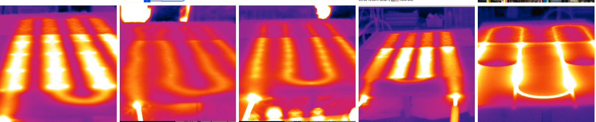

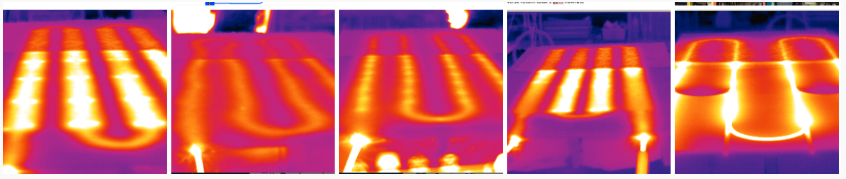

    I have a IR pic of what it looks like when you pull heat transfer plates away from the subfloor, I’ll find it tomorrow.
    The UF example Allan added
    the comparison demo I would like to see is supply the Thermofin aluminum transfer plates with 145f, what is the btu output.? Actually similar example is in Modern Hydronics as a radiant wall example
    If the 145 SWT to the transfer plate resulted in a floor temperature of 120F
    120-60=60 60 x 2 (btu/ sq ft in a floor model) you get 120 btu/ sq ft.
    that clearly shows the power of conduction heat transfer.
    Obviously 120 degree floor would not be reasonable, the example is to make a comparison, with the same SWT, same flow, same room ambient transfer plates vs UF

    "As an example, with a room temperature of 60℉ and a water temperature of 130℉, floor output is 20.2 BTU/[] using Ultra-Fin. Increase the water temperature to 145℉ and you'll get 26 BTU/[]. Floor covering is 3/4" plywood, 3/4" solid oak."
    So let's plug those numbers into the model I proposed. 20.2 BTU/hr/sf means the floor surface is at 70.1F. Assuming the floor is R1.5, that means the underside is 30.3F warmer, or 100.4F. The air below the floor is the same 10.1F warmer, so the air is 110.5F, which seems reasonable for 130F water.
    At 26 BTU/hr/sf the floor surface needs to be 73F, the underside is 39F warmer or 112F, the air below is 13F warmer or 125F, which again seems reasonable for 145F water.
    I don't know if it's coincidence, but in both examples the air in the joist bay below is 20F below the water temperature.
    So let's say that holds true for 170F water. And let's look at a 70F room temperature, I don't know why they would bother with 60F. What I get is air below is at 150F, underside at 134F, floor surface at 86F, heat flow of 32 BTU/hr/sf. That's about as hot as you're going to want to run the floor anyway.
    The key to all of this is that the joist bay has to be well sealed and insulated. If not, it's not going to be able to achieve temperature and the whole thing falls apart.

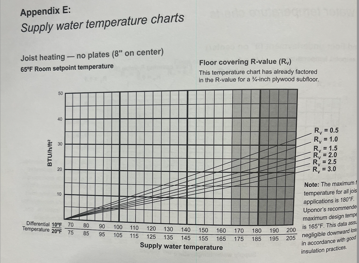

    hot_rod Posts: 28,864

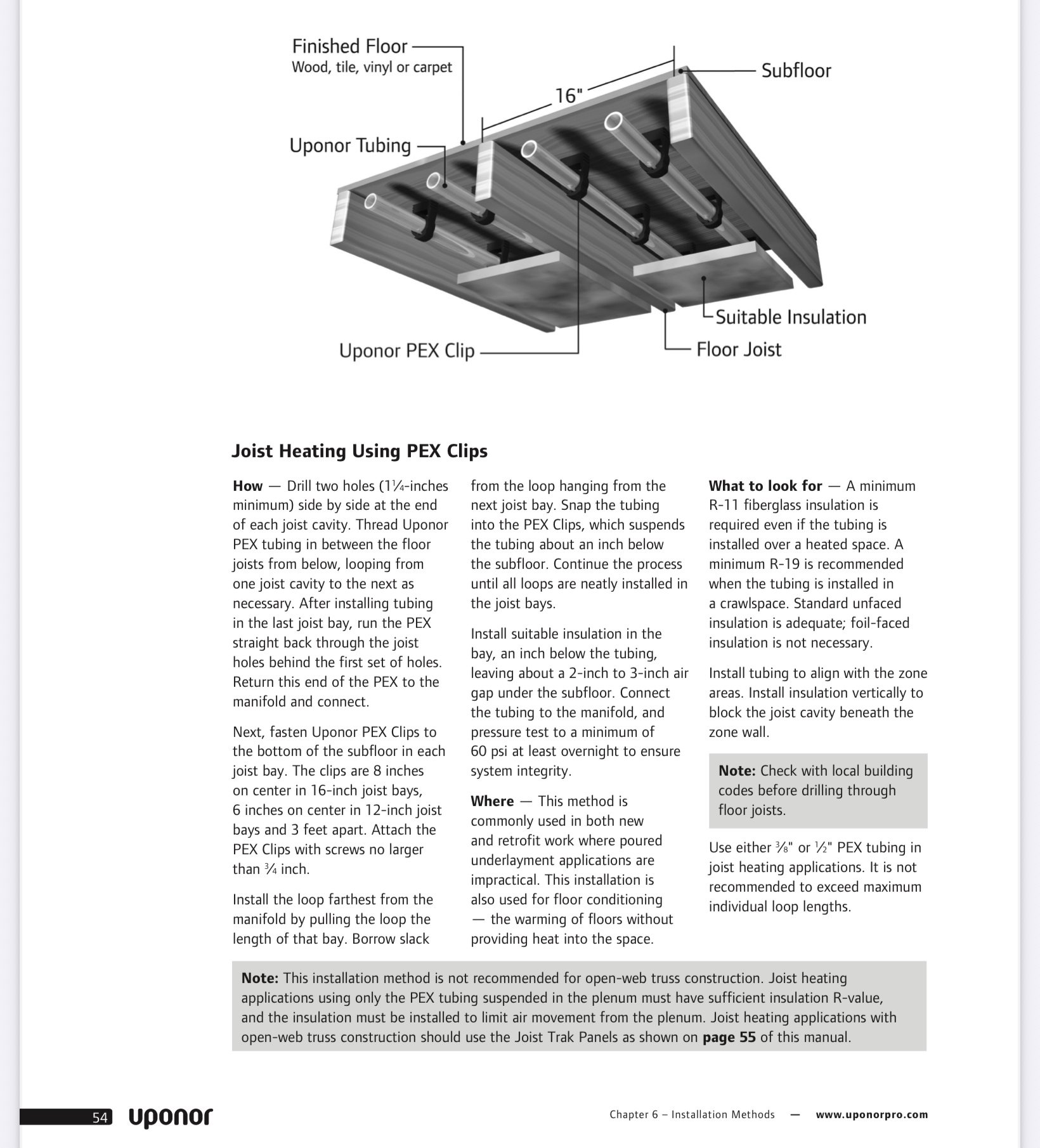

    the earlier uponor design manuals had output charts for the joist bay or suspended tube method. I don’t see them in the current edition? At least in the online version I found.
    But they do seem to indicate joists bay method is more for floor warming than radiant heating type loads
    Plateless in Radiantville july 2022 PM magazine and a later article article Shakeout Time suggests 15 btu/ ft for bare tube staple up. There is some conduction in those rubber and pex tube staple up. I would think tube suspended below, joist bay heating, output would be lower?
    UF may boost that a bit by encouraging more convection currents
    Limitations may be how warm the plywood or OSB can handle, 140f sticks in my mind.
    Uf in Allans climate may be a good fit, mid 20 and higher BTU loads, maybe not. Uponor seems to have changed position on the realistic outputs?

    "This installation is also used for floor conditioning, the warming of floors without providing heat into the space."
    I think we can all agree how ridiculous that statement is.

    Here is the Uponor output chart from the current 8 th addition. With 145° SWT outputs are below 20 btu/ sq. ft.
    So IR testing I did at my shop at bottom, for more of a visual look at radiant floor mtube installation method.
    So Uponors numbers, Siggys FEA, Dales FEA, testing at KSU by Dr. Kirby Chapman all seem to line up with regards to realistic outputs
    From left
    Thermofin transfer plates with copper tube,
    Suspended tube (joist bay Uponor method)
    Direct staple up, bare tube
    Thermofin with 1/2" pex
    Warmboard
    In pic 3 notice where I pulled the pex out of the Thermofin to connect to the manifold, lowering the conduction transfer from tube to Thermofin
    The Warmboard #4 shows a similar effect where I routered across the aluminum layer mid panel stopping the conduction across the aluminum.
    The back 1/2 of these examples has a piece of berber carpet, no pad below.
    The key may be the average temperature across the panel also. Warmboard even at 12" OC spreads the temperature well.

    What stands out in these IR pics is not the entire 4X8= 32 square feet of the panel is the same temperature.
    So assume the yellow in these pics is 82°. A % of the panel is below that. Maybe assume the magenta color is 70°. So if you calculated the average surface temperature the entire panel output would be below hte math showing 32 sq ft at 82°.
    Lets assume 50% of the left panel has a surface temperature of 82°, 50% at 70°. The average being 76°.
    76-70= 6 X 2 = 12 btu/ sq ft output
    looking at the suspended tube 2nd pic, first off none of the panel is at 82, with it receiving the same SWT, then the % at the orange color call it 78° is a much smaller number.
    Hard to argue against the conduction power of the aluminum plates. And if efficiency is a gola the SWT difference to get both producing the same output starts to hurt. Probably taking suspended tube out of boiler condensing temperatures.

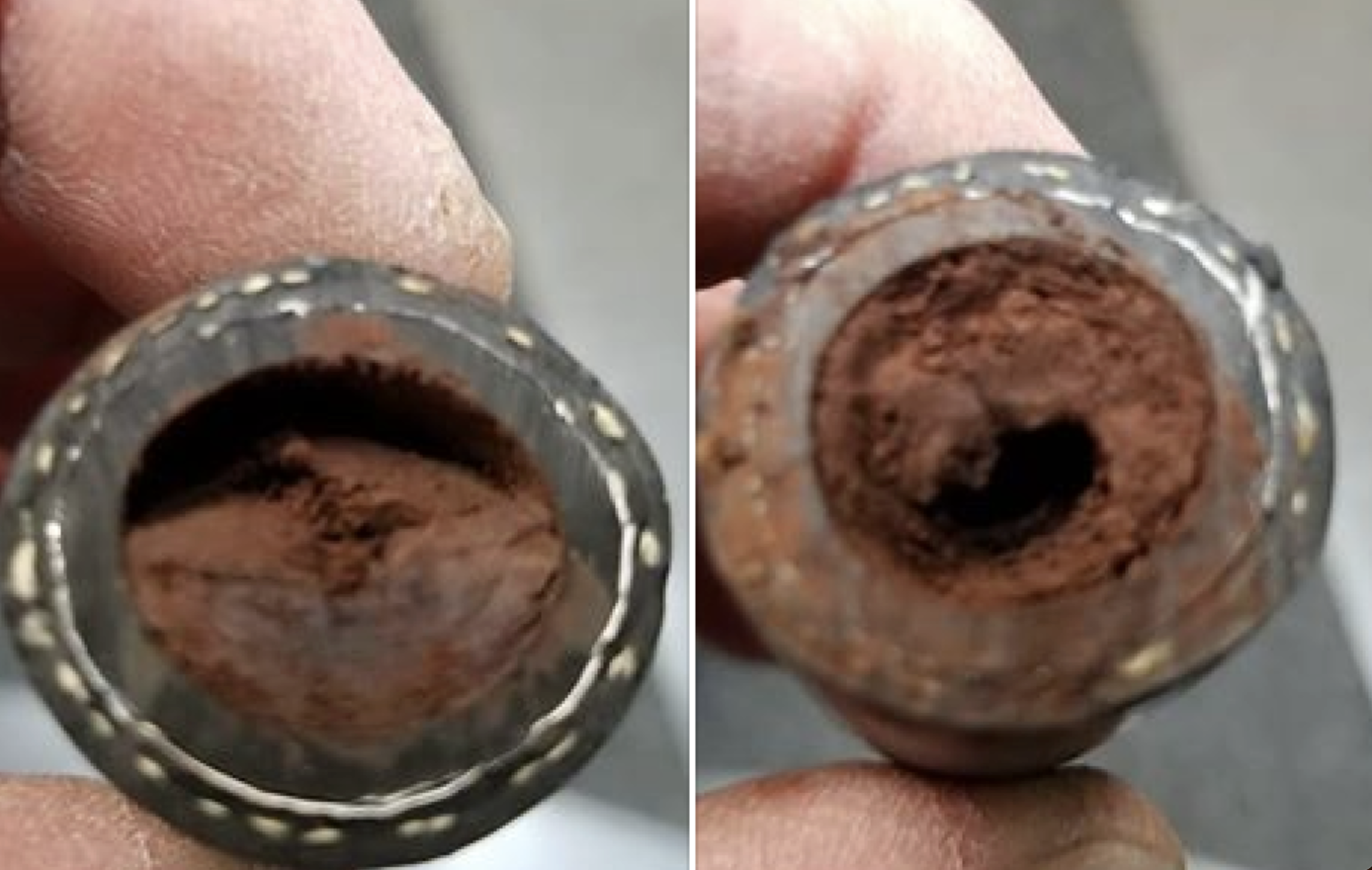

    I think heatmeister out in Colorado has been wrestling with sludged rubber tube systems his entire career.
    This tube did not come from the manufacturer looking like this. You are looking at your expansion tank, pump volutes, steel pipe and fittings in a reduced form :(

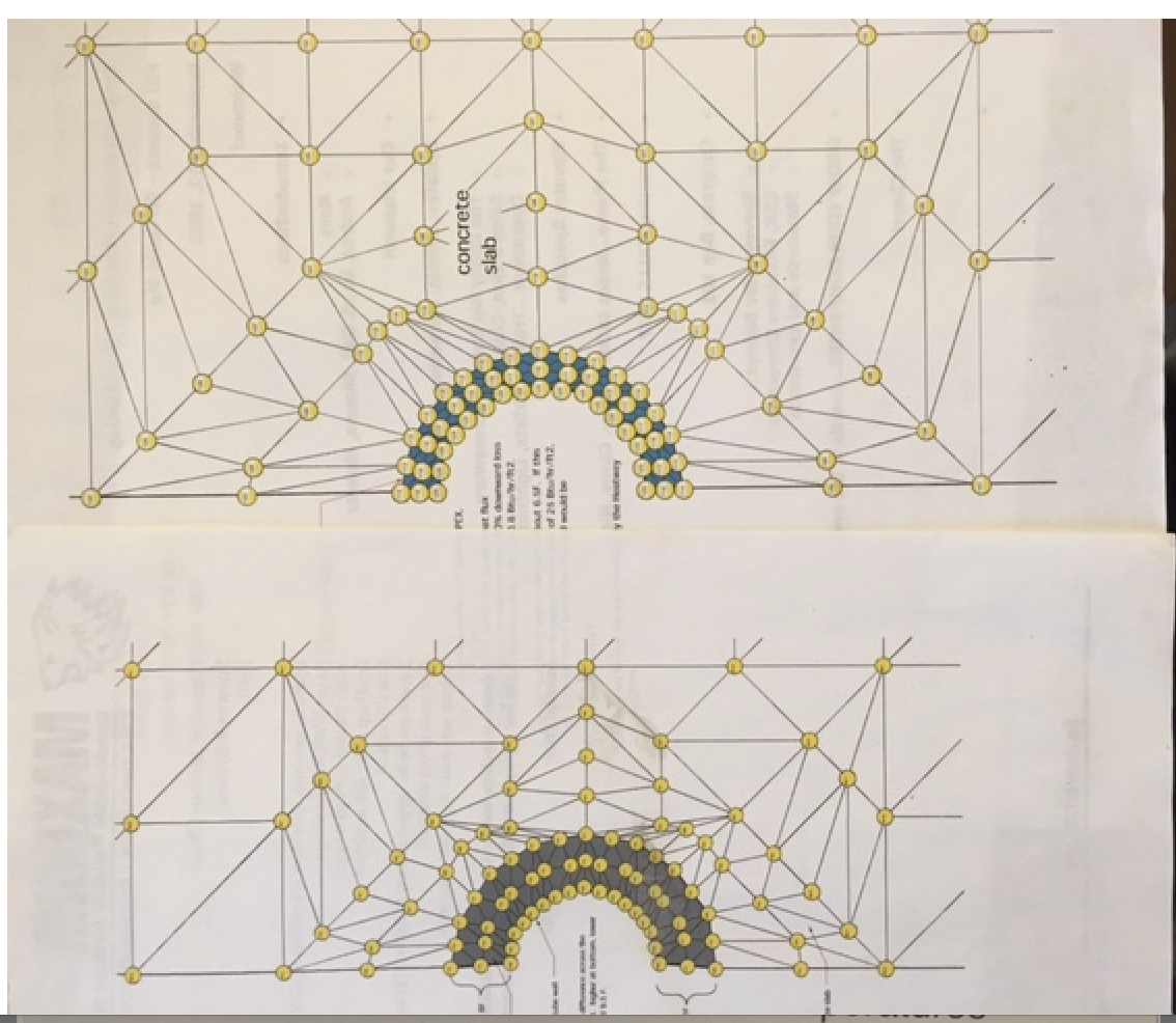

    Here is how a FEA finite element analysis turns temperature nodes into graphs which used as the basis for my IR panel testing.
    The first pic was modeling pex in slab vs much thicker walled rubber in slab. The rubber being an insulator and much thicker than the SDR 9 pex tube limits the outward temperature profile.
    But if the rubber ends up in the condition of the post above it really doesn't matter much, does it?
    Screenshot 2026-01-09 at 11.55.07 AM.png Screenshot 2026-01-09 at 11.54.53 AM.png Screenshot 2026-01-09 at 11.54.15 AM.png
    The lower slide shows not only the better temperature spread of plates vs bare tube, the inches noted on the bottom axis, but also the wide SWT temperature difference required to get the 85.9° floor temperature.
    Plates with 100° swt vs bare tube at 160° swt.
