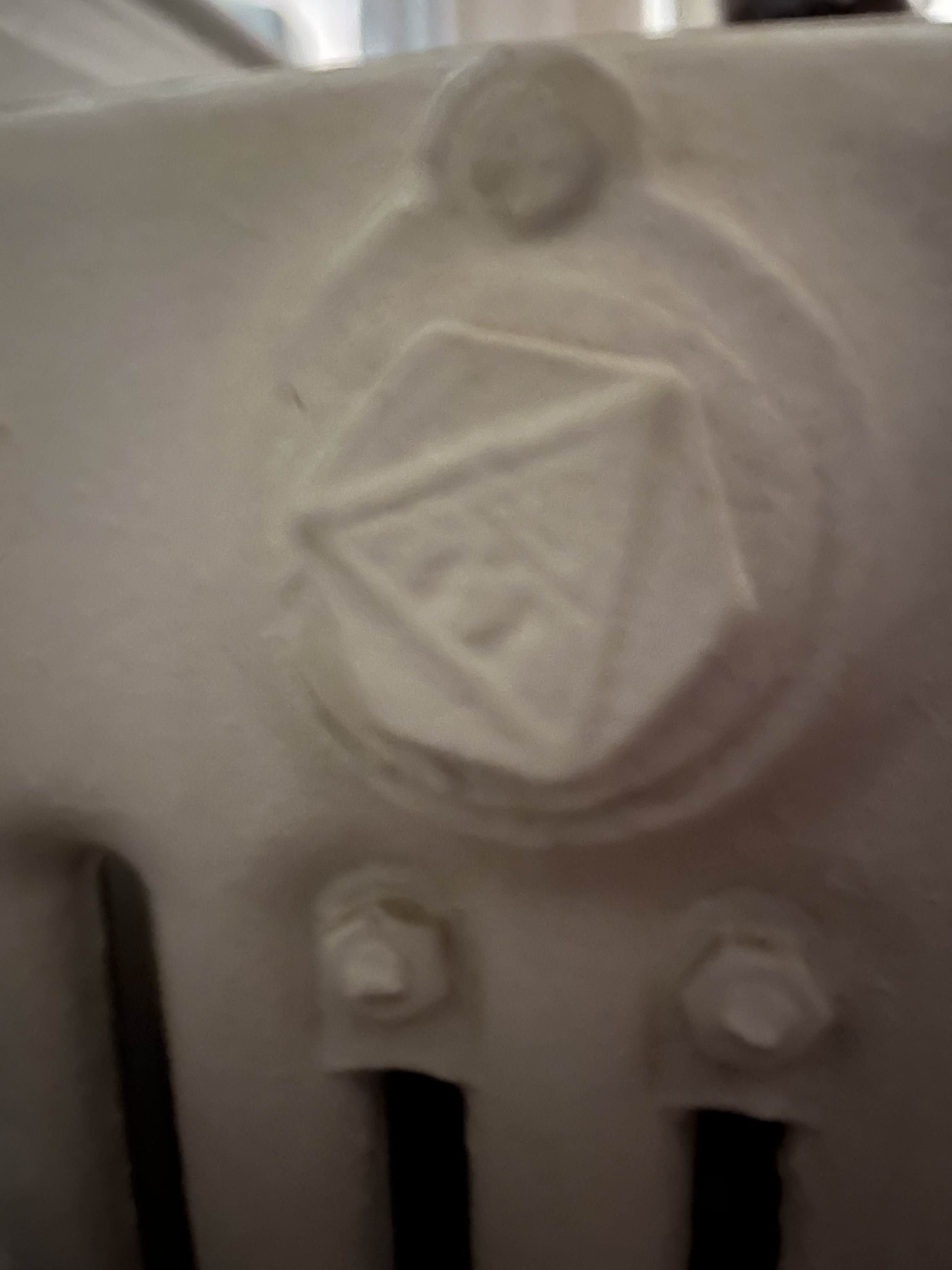

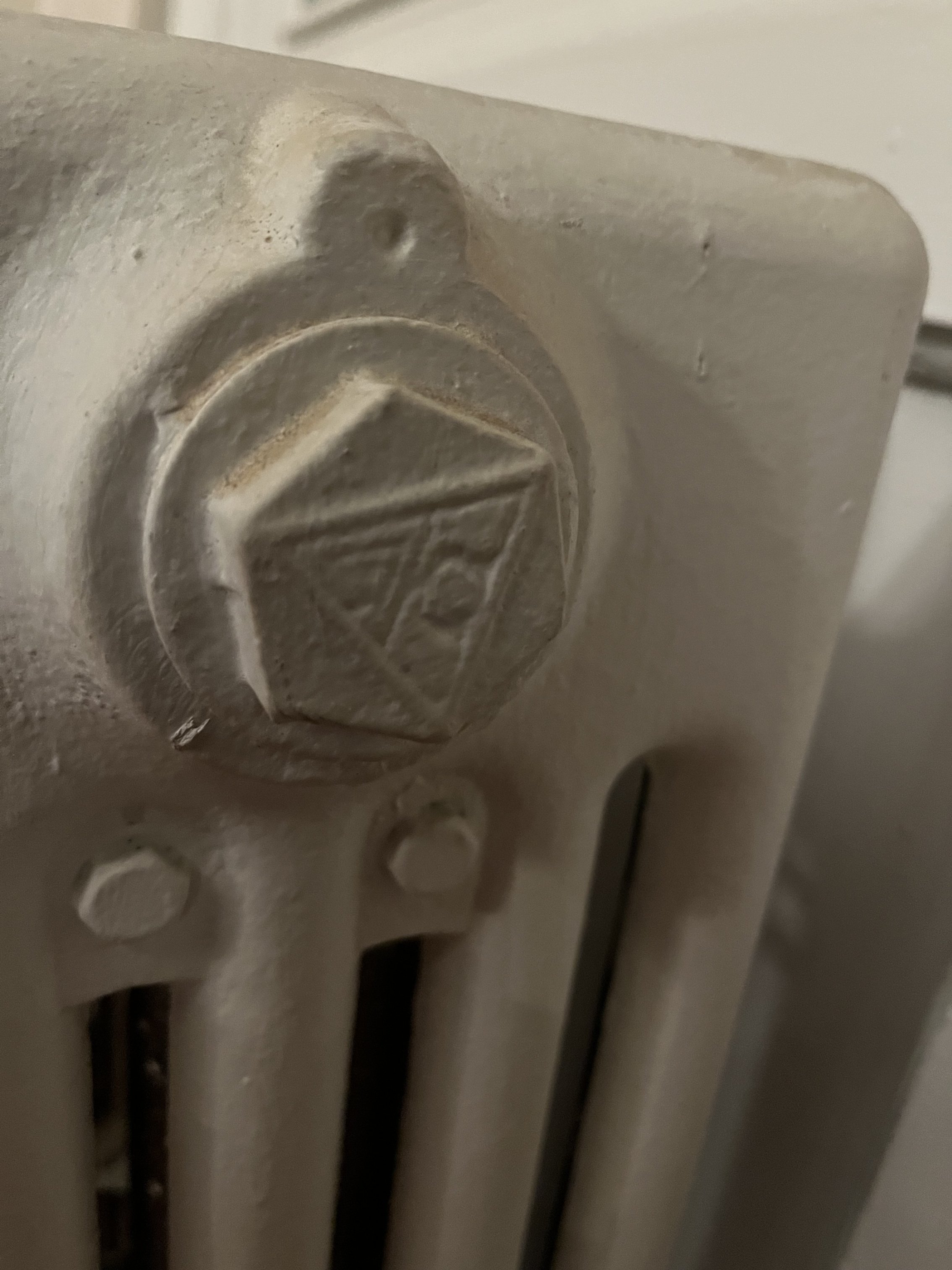

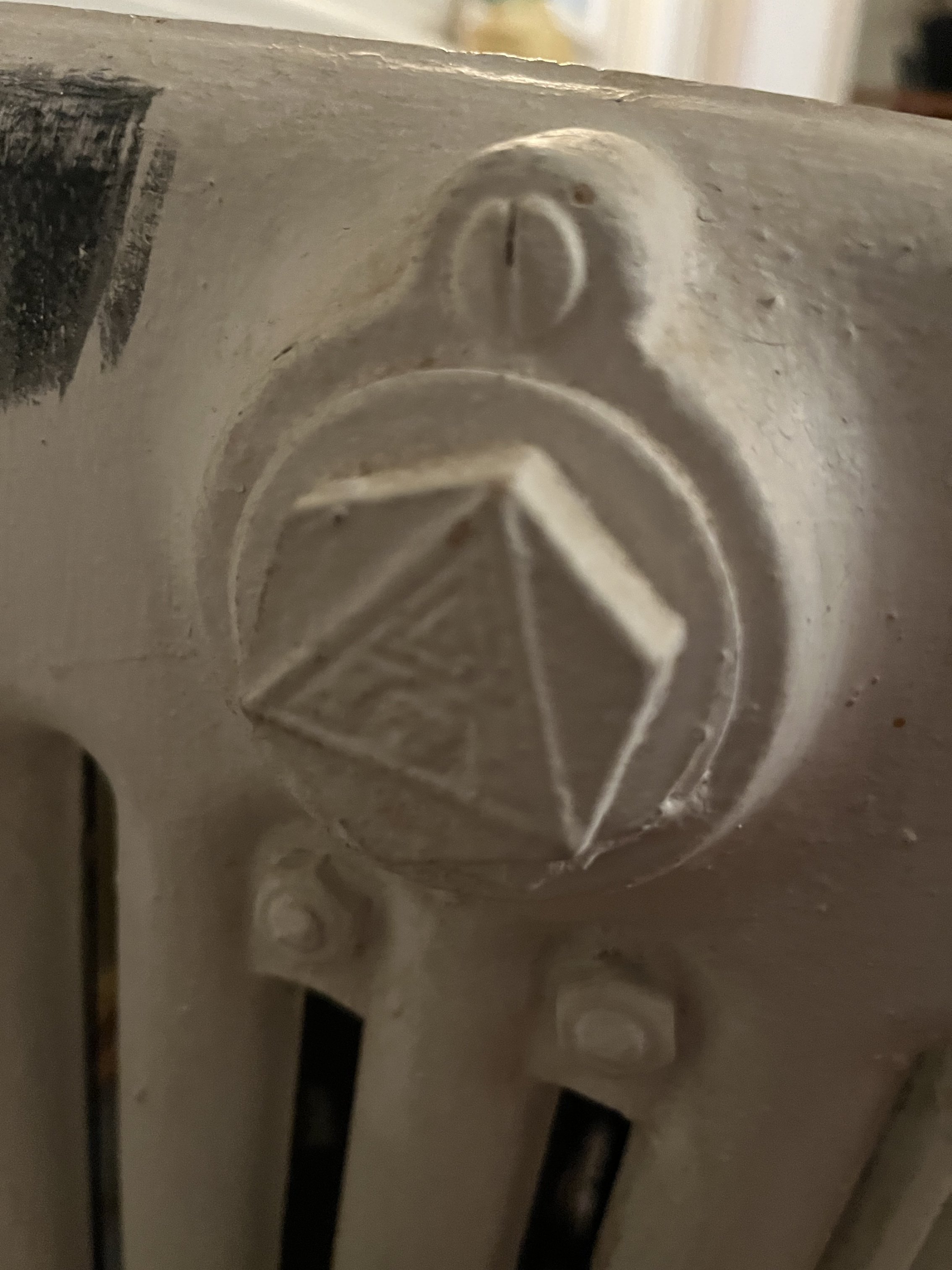

Hello fellow steam brothers, need help identifying this brand Rad as I have a few. Fow reference, 5 tube rad measures 8" in width and 25" in height, 15 sections at ~ 38" in length. Note tap port/point just above the end plug. Looks like 1920s to 1930s styling similar to Arcos. Top end plug has a triangular shaped logo, might be an A plus other figures IDK. Pics are attached.
many thanks for all the help.

    Hard to make out what's on the plug, the pics are a bit out of focus.
    The radiator itself, according to your measurements, should be a standard type of large-tube radiator similar to the American Corto, National Aero and others. Ratings were standardized by then so any large-tube chart should apply.

    Steamhead, hello, hope all is well with you and HNY. You have previously helped me with a few other issues in the past, and I Thank You very much. Rad dimensions are similar to Arco Corto. 8 x 26 for 5 tube falls in line with Arco Corto but mine are 25" high. Guess worse case is that I tool down the listed EDR by 5%, should be close enough for my Btu calcs. I will see if I can remove some paint off the plug for a better pic. Looked clear enough but have never seem that type of logo before as well as a tap point just above the plug. Most likely you have.

    Appears after long search from downloads in the HH Wall - Museum, Rad brand was identified as H.B. Smiths 144"s. sizing and design match as well as the position of the tap just above the top radiator plug.

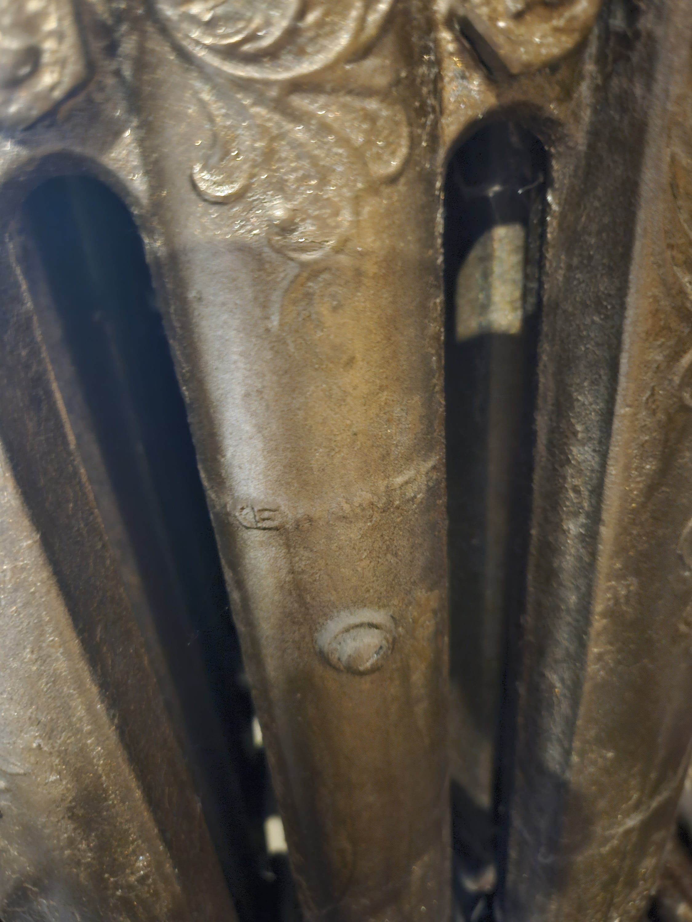

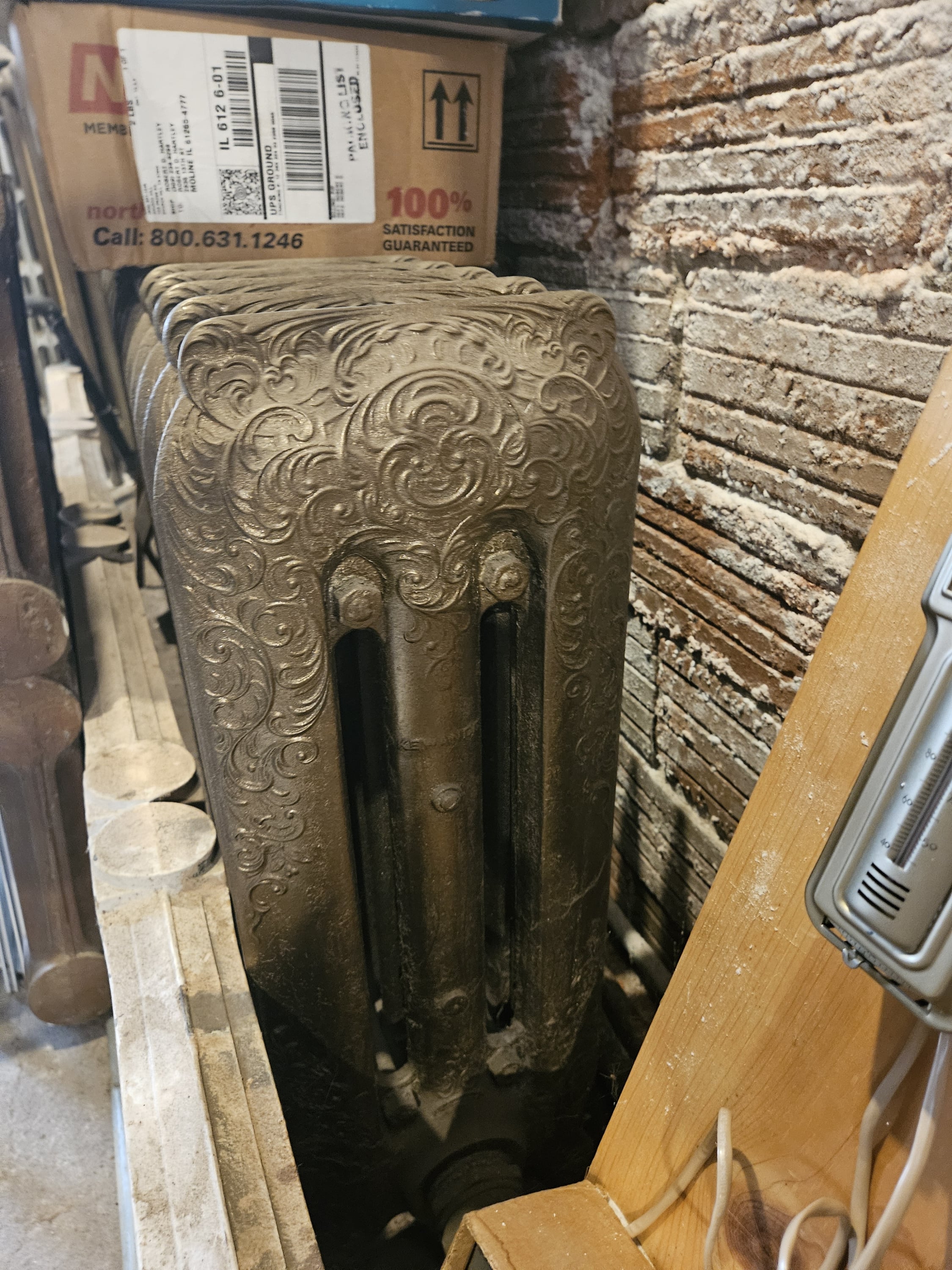

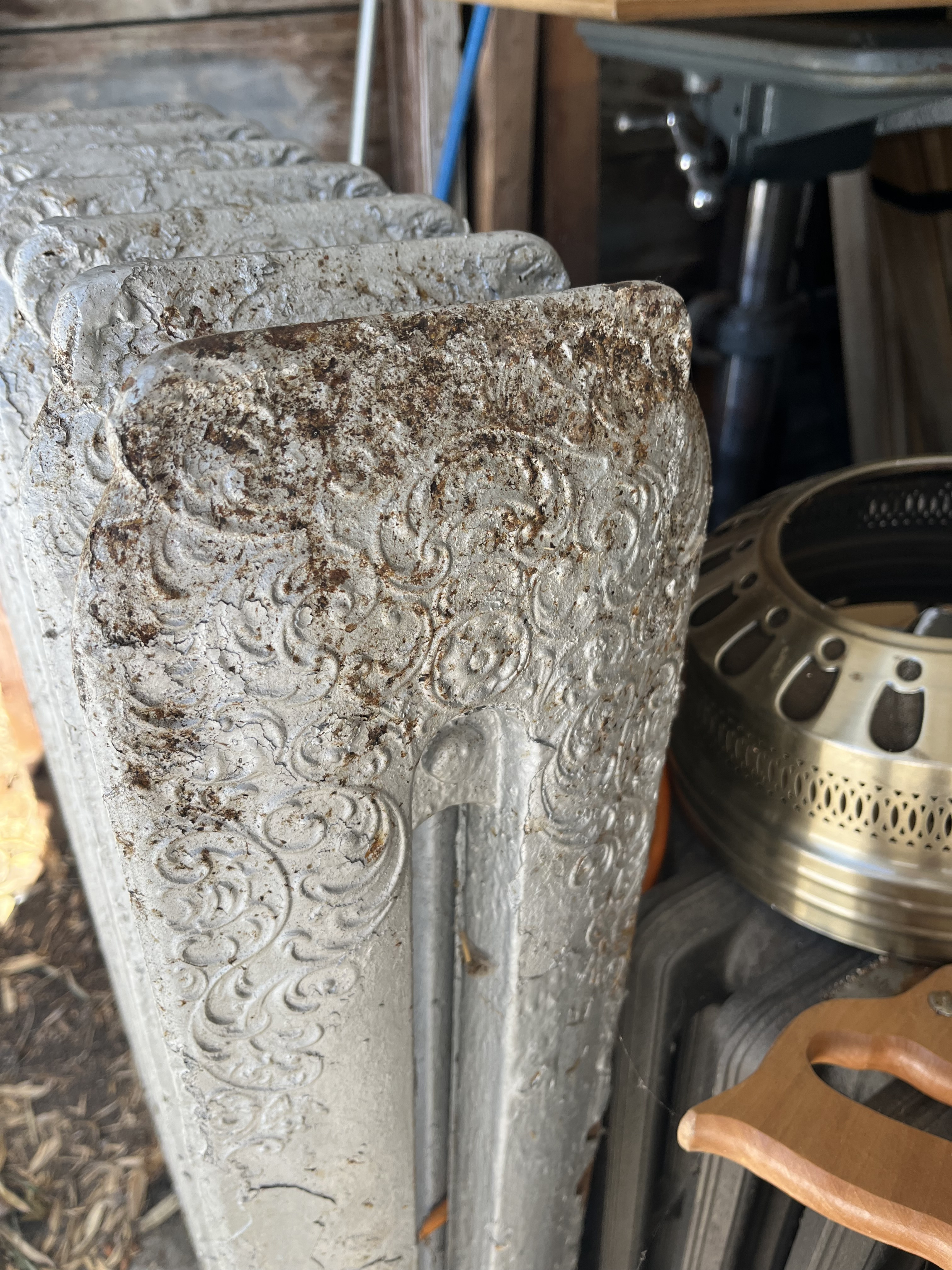

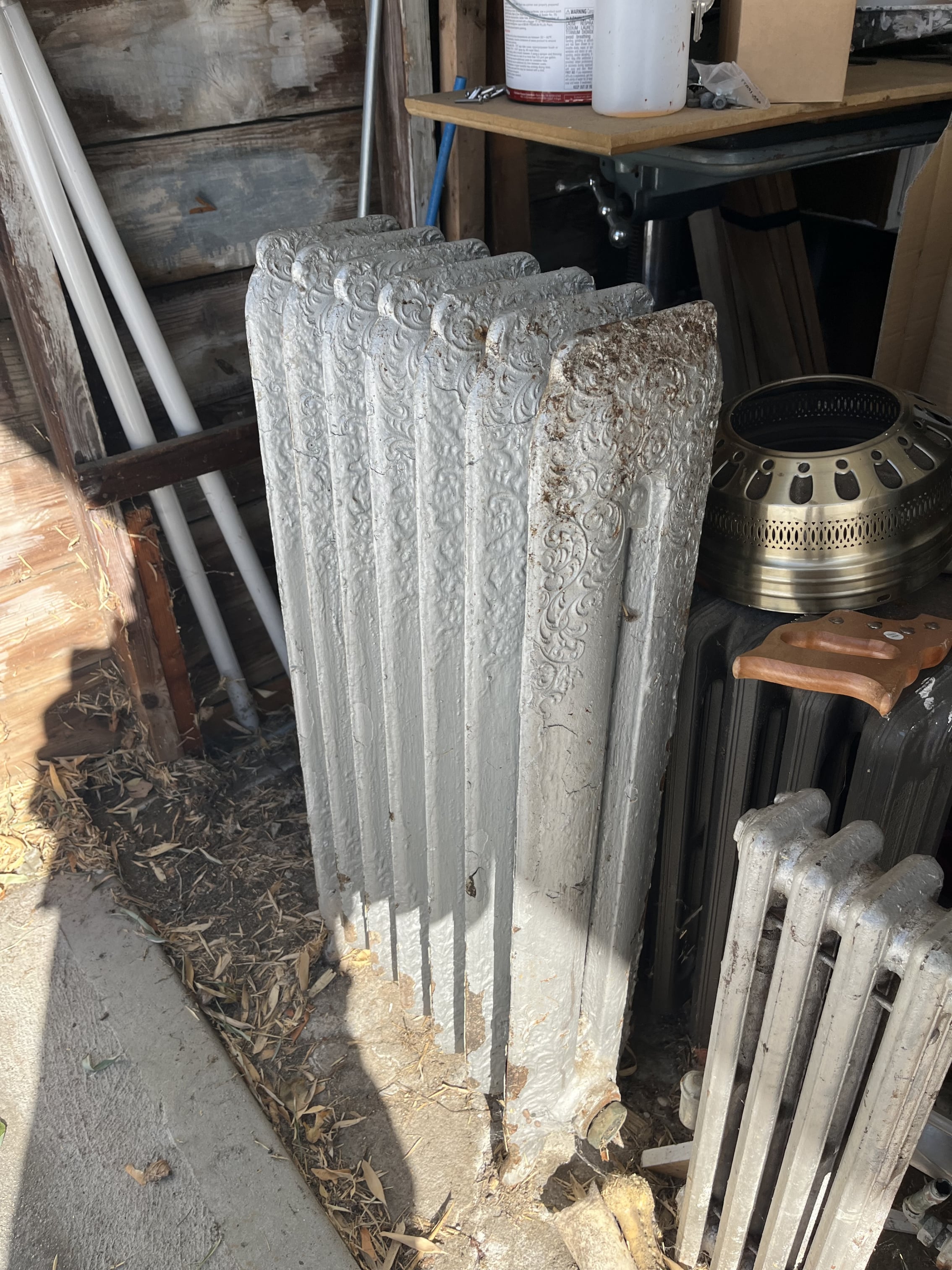

    Meanwhile, have obtained an old Victorian era Rad from a bldg in the Bronx NY. Not positive, but believe she is an old Arco - Rococo style. She stands 43" tall, approx 7-1/4 wide with 7 sections, 2 columns only. Can someone plz verify manf of this Rad. Looking to have her cleaned like new and installed somewhere in my home.
    Many thanks
    mattmia2 Posts: 18,238
    it will say roccoco near the bottom tapping if it is one. but it looks like it is.

    I'm 95% sure that the radiator you show is made by Kewanee and it is their copycat version American Radiator's rococo model. The pattern is nearly identical, but not exactly. I think I have a Kewanee catalog that I could dig out if anyone doubts me.

    Here is my kewanee "rococo"
    is that a steam only radiator where the top sections aren't connected?
  • Dave in QCA
    Dave in QCA Posts: 1,811
    My example is steam only.
