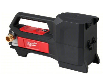

    I'd like to see Milwaukee combine their cordless pump and compressor into one tool. A lever or knob to select one function or the other.

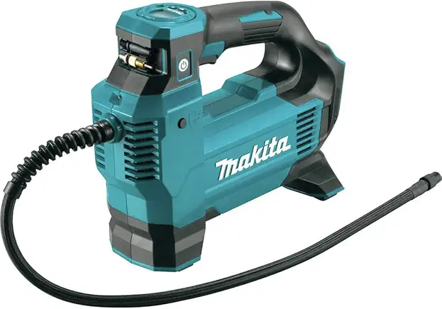

    I recently picked up the M12 compressor. The size is great, you a small box in the truck
    edited January 7
    When there's no isolation/drain valve assembly on x-tanks, it can be a huge pain. Removing the schrader valve helps, but with a good bladder, there can be an unexpected weight when released with a potential for lots of water. Maybe someone will come out with one that has a small release valve tapped into the tank itself.
    I've got both the cordless Makita and Milwaukee compressors and like the Makita trigger action vs. the push button Milwaukee. Easier to let go of the trigger to stop air flow than pushing a button. Also got the dual presta/schrader fitting for bike tires/x-tanks.
