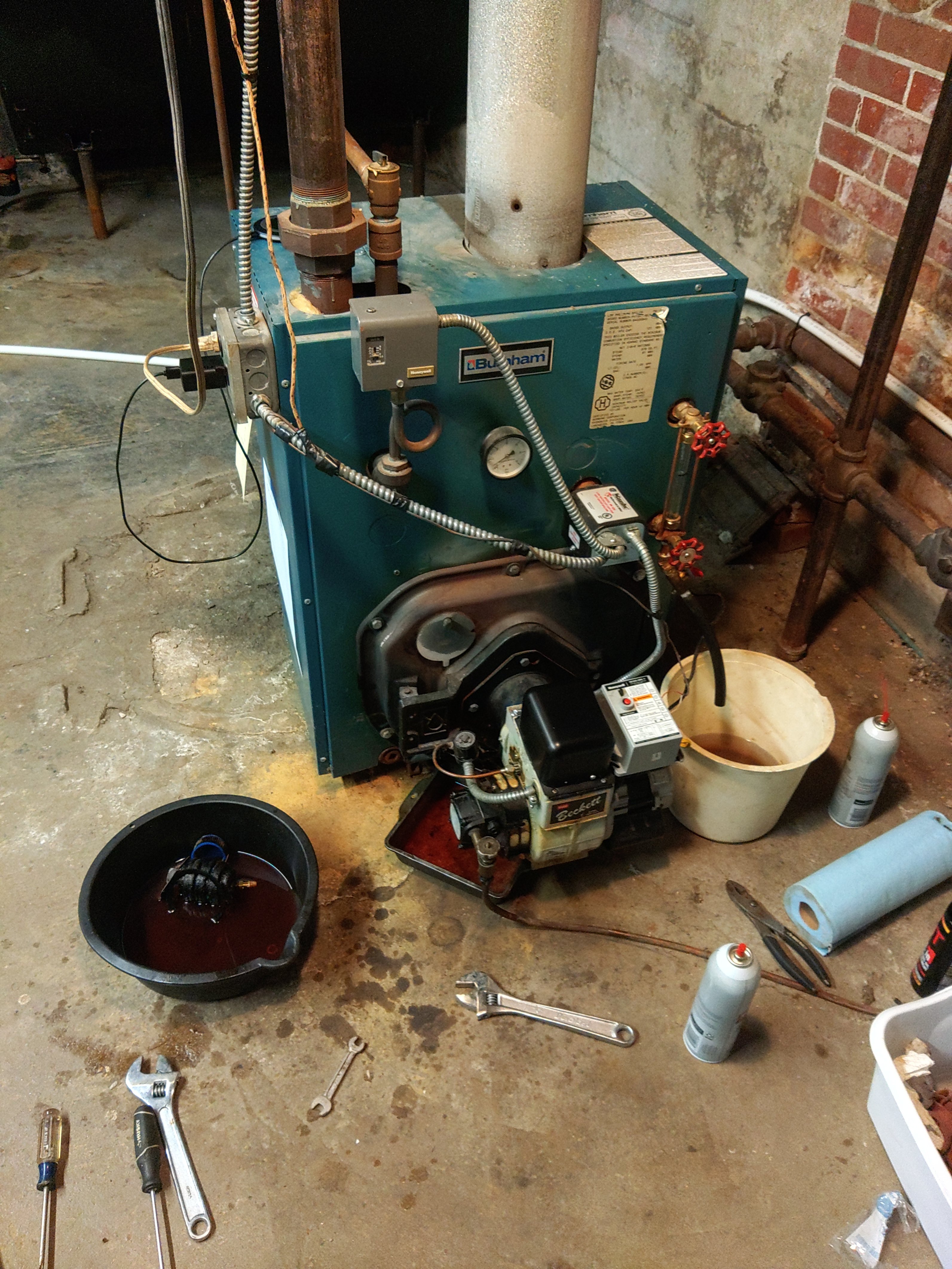

Currently have a Burnham PV73ST which was installed in October 1998 steaming up my Webster type R 2 pipe system in this 1934 colonial, have had very good service out of her for both heat and hot water with the only troubles really being a faulty LWCO some time ago as well as a mystery water leak which I solved last year which was just the drain valve by the burner which I simply capped off with a garden hose cap. Just did the annual maintenance on the burner a week ago, just waiting on my plumber friend to free up to give me a hand with brushing the heat exchanger, replacing the fire chamber liner, replacing the pigtail as well as doing a combustion analysis and efficiency test. After heating season I am going to be abandoning the hot water coil in favor of a 58 gallon electric heat pump water heater as I would like to be able to have hot water storage and also not burn oil in the summer time. I'm curious how much longer I can get out of this old gal. Plan on staying here long-term and in April it's been 30 years since Mom and Dad purchased this place. I've been doing some reading about replacement boilers however and I've been looking at New Yorker, US Boiler, Velocity / Crown, and Peerless as I know the inevitable will happen one day. And I know this is not a DIY job I will obviously have a professional do it when the time comes, just researching some options.

  • Thanks Ed, it's definitely in good shape. Aside from the leaking drain valve and LWCO, haven't had any issues with it at all. And I think with the old style transformer and primary control, the burner will last a very long time still. I did put a new motor on it about 4 years ago. I think with it providing my hot water and staying hot round the clock that may have prolonged its longevity. I think the plan will be to run it until it leaks or starts sending steam up the chimney.

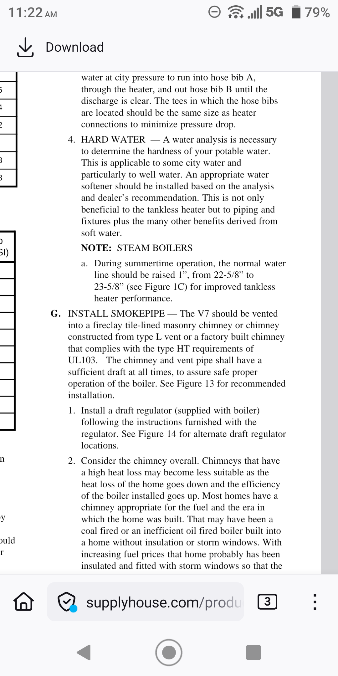

    I'm not sure about the V7 series, but I seem to recall the V8 series called for water 3/4 up the glass as normal? Looks like 22 5/8" up from the floor for a V8 series is the normal water level. I don't have one to measure though.
  • I'll have to see if I can find a manual, however I just keep the water in the middle of the glass
  • It is indeed 22-5/8" per the manual.
