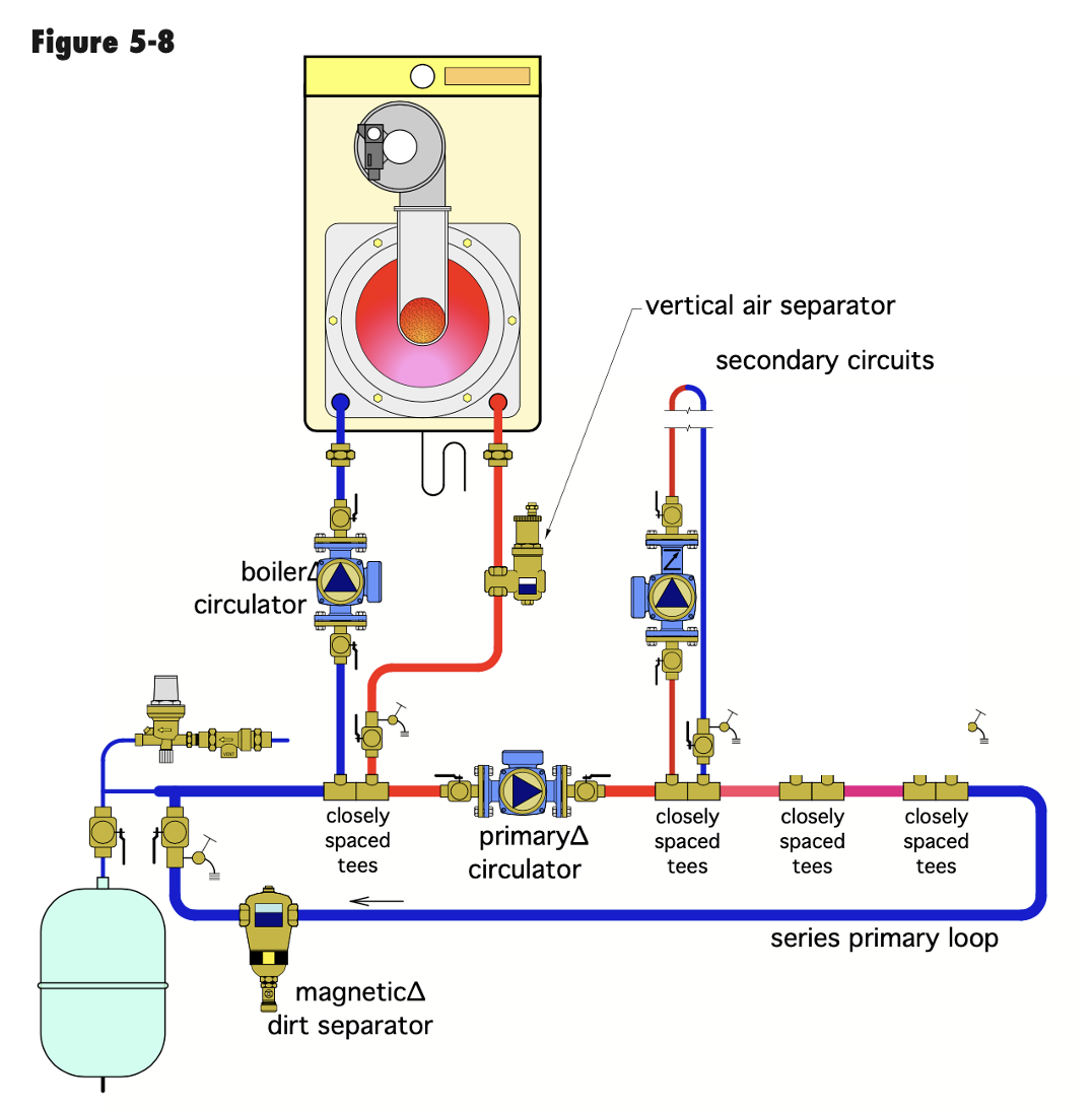

    Is it possible you have a system like this that was built with future expansion in mind.
    This would be a 3 pump, single zone example.

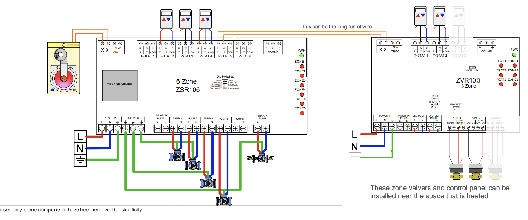

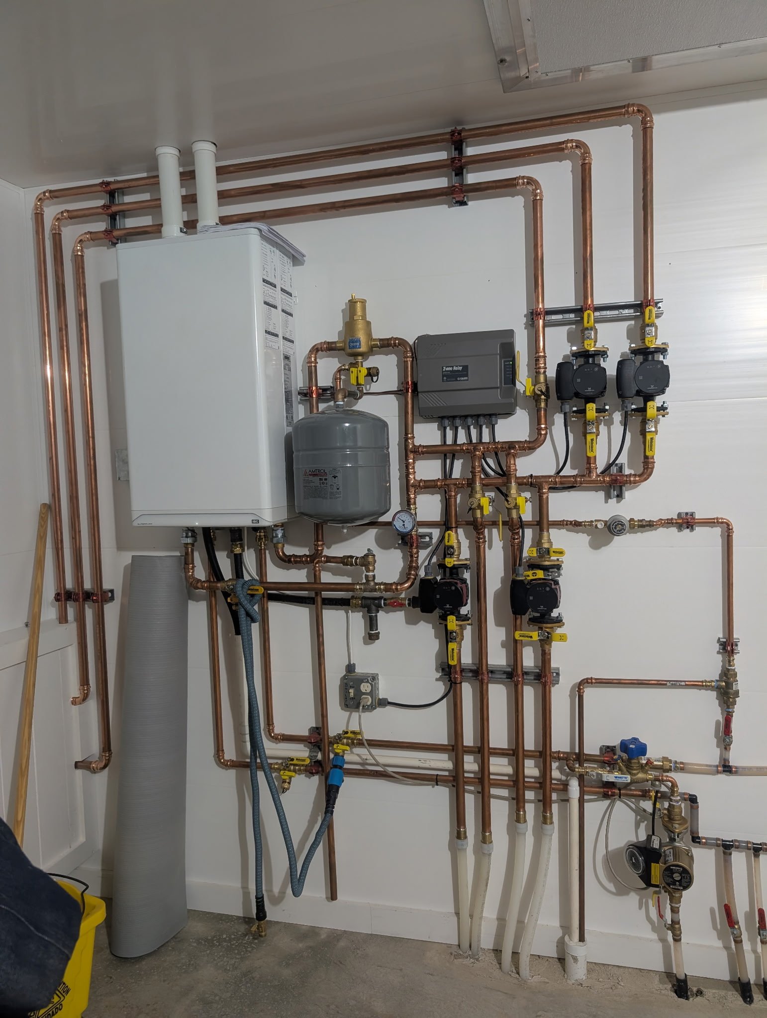

  • I'm sorry, let me explain myself better, the existing system has 4 zones with 4 pumps all hooked into the relay box as normal, very very nice system i'll have to post some pics then, but the 4th zone goes 50 feet over under the slab into the basement with a supply and return and stops there, he had in mind for one zone in the basement (staple up) then the homeowner got me to do the staple up but also wants radiators in his 120 sq ft entrance
    The other 3 zones over in the boiler room are all radiant in the concrete
  • so in otherwards the 4th pump hasn't been used yet just sitting there waiting for the staple up and radiators to get hooked into it and fired up, i just have to get the pump in the boiler room to communicate with the zone valves over in the basement

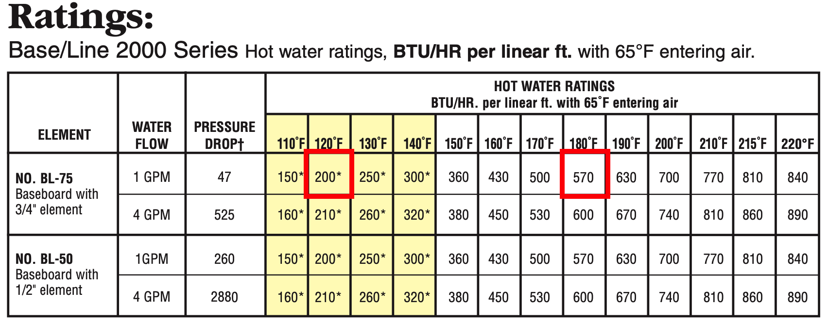

    So there is a combi Mod-Con boiler that does both heat and DHW. It is currently operating with a low temperature for radiant floor space heating on 3 for 4 zones. The hottest water for space heating won't get much over 125°F. If the outdoor sensor is connected that temperature will ramp down to as low as 95° on milder days. You want to add a radiant floor zone the the unused circulator that is already piped in and connected to the boiler.
    If that was the end of the story, then you have no problem.  There may be a little overheating as a result of the two different radiant floors… Staple up and concrete slab, but that is nothing compared to your additional zone requirements.
    In order to add a standing radiator, a panel radiator or a baseboard radiator or convector radiator to that system you will need a really big one if you don't get the water temperature up to 160° or more.  That means that you will need to have some sort of mixing valve or injection pump system to make 160° water that leaves the boiler down to the 125° or lower. You need the lower temperature for the system as it is operating now because that works.   Look at the water temperature output for simple baseboard radiators when you have only 120° water compared to the recommended 180° water temperature.   You will need at least 30 feet of radiator to do what 10 feet of radiator will do at 180° if you use the low temperature water.  Slant Fin Base/Line 2000
    You need to rethink this idea, or get a really big radiator for the really small space.
    I had a customer request the same thing from me.  “Just connect this cast iron radiator in the shop to the radiant heat system you are installing so I can get some heat in there in the winter."   After telling him it won’t work multiple times, and trying to convince him, the additional $$$ for that project would be wasted money, I ended up doing it because that is what he wanted… and the customer is always right.   He called me after the first year and told me I was right.  Sometimes you need to tell them ten times and when they insist and you do it for them, and  get paid for it, you just have to wait for the phone call telling you that you were right.
    Everyone is an expert when it comes to their house. They know best until proven wrong (and paying $$$ for it).
    Good luck with this project.
    I can do the wiring diagram for you if they insist.
    EdTheHeaterMan Posts: 12,948
    This diagram assumes that the #5 zone in the circulator control panel is the unused circulator zone. (This is the 4 zone setup in the Caleffi instruction manual)
    The two zone valve zones and the thermostats and controls can be placed close to the space being heated. The only wire that is needed to operate the boiler for those two zone valve zones is the orange wires from X X on the ZVC-3 to the Zone thermostat on zone #5 (or whatever zone has the unused pump connected to it) terminals W and R. The C terminal is not used. The circulator pumps and other boiler functions will work as usual with this simple thermostat wire connection.

    That is some nice work in the mechanical room.
    Very professional to see an actual balance valve on a recirc system, BFD with an actual vent tube. Good taste in hydronic components 😄

    Add a ZVC to run the zone valves and run the end switch wires from it to R&W in the existing switching relay. A call for heat from either new zone would tell the respective circ to come on via end switch, which would then tell the boiler to come on.

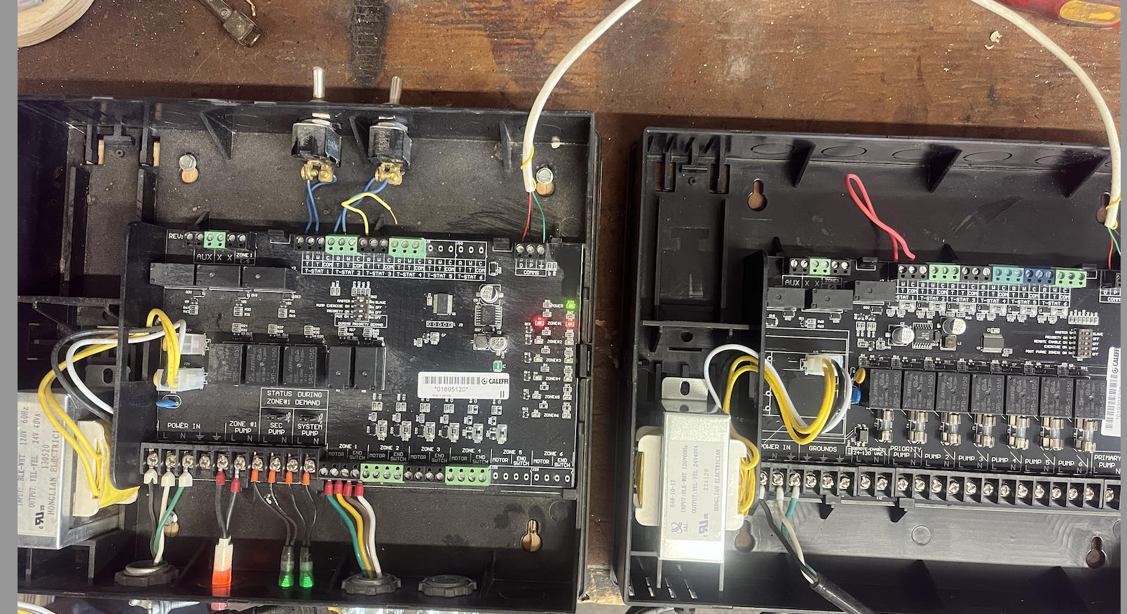

    If you pair two relay boxes together I would suggest using the COM connections. A 3 conductor thermostat wire between them. With Caleffi you can "daisy chain" an unlimited amount of relay boxes this way, of any variation ZVR (zone valve) or ZSR (zone pump)
    The advantage to this is you dont tie up a relay, assuming you have a spare. A spare is always nice to have should one relay ever fail, especially with the soldered on relays.
    But also by making the first box "master" any slave added to the first box will reconize priority on box 1.
    An indirect or any load on relay 1, with priority triggered on, all loads on the slaves, valves or pumps, will turn off until priority is satisfied. Or the priority could be toggled off via the dip switch.
    Priority relay is always relay number 1 in Caleffi boxes.
    This also shows the 40Va transformer in the pump relay box, and it is protected by a self resetting fuse, the yellow disc next to the molex plug.
    These features and functions are a result of contractor input when we first designed these relay boxes.
    The snap in 40 Va in the zone pump relays was added by installer requests also. Two transformers can be installed for a total of 80Va across all connections on the ZVR zone valve relays. This can be helpfulmif you want to put multiple thermal actuators on one zone connection.
    The 6 zone box comes with two relays. Theses are standard foot mount type transformers with molex plugs.
  • Hey thank you much for all that info, I'm going to have to use your wiring for this Ed because i don't want to move the pump to the basement and cant put the zone valves in the boiler room so that diagram is perfect, and about the radiators, they are panel radiators 2 of them with a total of 14,243 btu's with 180 degree water, and its 120 sq ft so i came up with 5000 btu's needed? so i hooked them up real quick yesterday so they can run while we install the joist track plates and it did pretty good, but we where only there for an hour so couldn't see how good its working, (that's with 130 degree water btw)

    I think you may be OK since you are oversizing the radiators. I just believe you need to have it in writing that it may not work and you will do the plumbing and wiring as the customer requested, and using the lower temperature water may or may not be enough to heat the space. With high temperature radiators and low temperature water flowing thru them is not recommended by the manufacturer. So it might not work.
    But if it was your idea to do this, then forget what I just said and hope for the best …LOL.
    I probably don't know what I'm talking about.
  • yes it was the homeowner's idea, but for some reason that did not cross my mind, which is not cool, but those things got the temp up to 69 degrees and would not get warmer😨 so the homeowner said he can just keep the door open to the part with radiant, and i told him about the mixing valves, all in all the customer was still very happy with everything! lesson learned, we'll never forget that, even though its really just common sense
