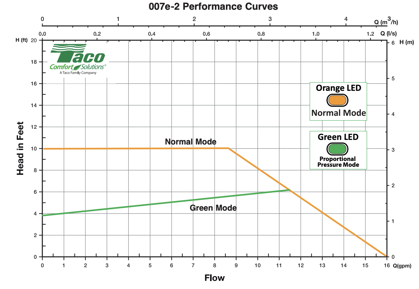

    At 3 gpm and 6' of head, the 007e will work for you. But since your pressure drop doesn't change, I'd go with the Delta-T pump, no? You can set it for whatever Δ you want (5-50℉).

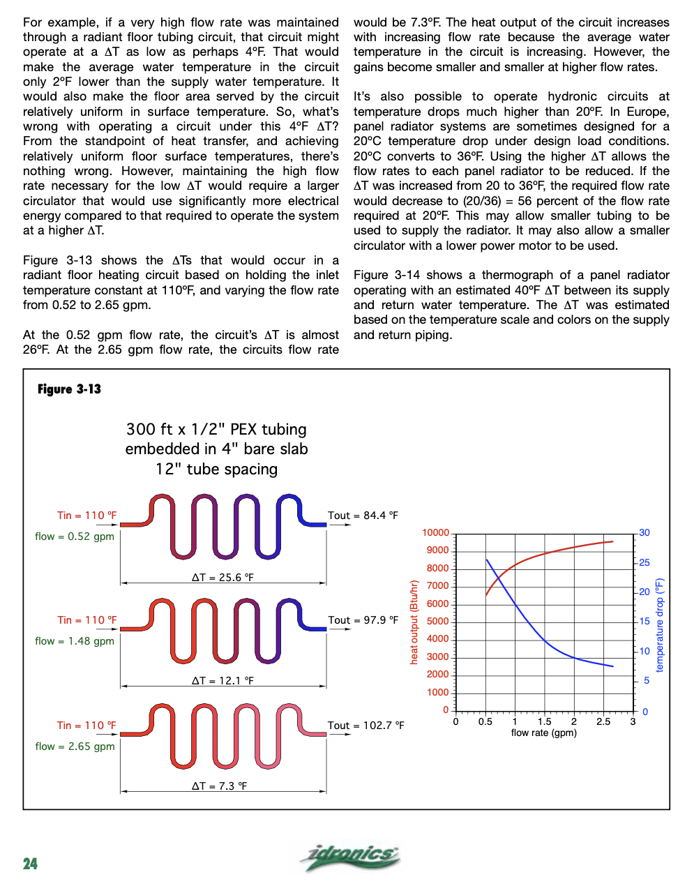

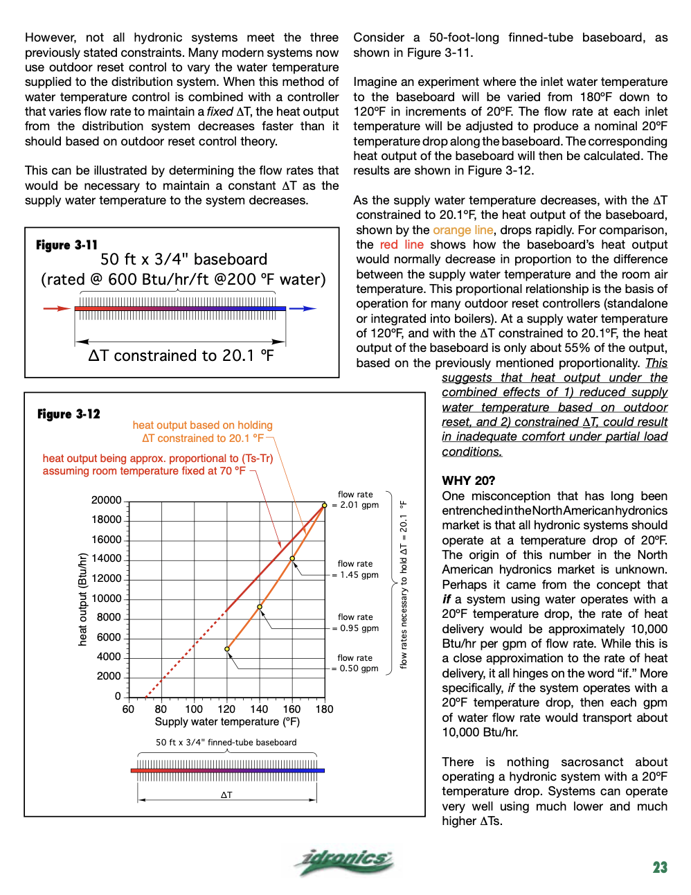

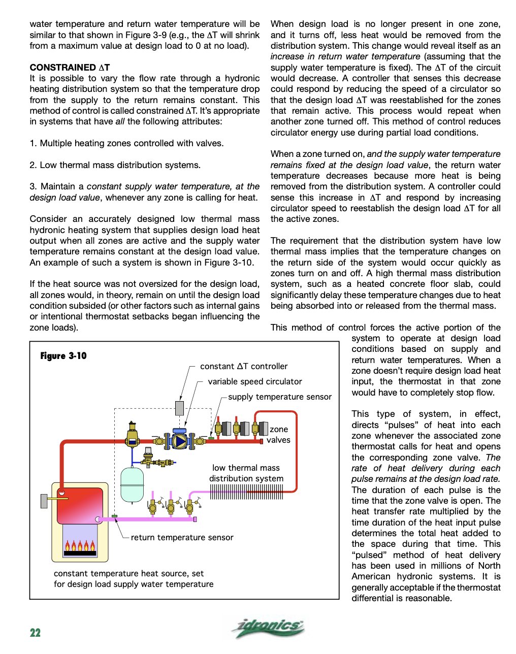

    As such the ODR attempts to satisfy the load with the lowest possible SWT, both for boiler or fuel efficiency and comfort of near constant circulation. With a mod con boiler this is easily accomplished by modulation the boilers burner(output) based on temperature inputs to the ORD control function.
    In several issues of Idronics we talk about hoe ODR and constrained ∆ operation. I think you have it correct they are trying to do conflicting functions.
    Allow the ∆ to vary as the load dictates. Delta P varies flow rates based on zone requirements. Some suggest ∆P is just for "European" type systems? But you may have noticed every circulator brand now has a wide range of ∆P circulators available.
    Suggestions below for the type of a system where constrained T operation may work.
    Personally I prefer all the benefits of ODR regardless of number of zones, type of heat emitter, or type of boiler.
    Idronics 25 is a good read about heat transfer in general.
    https://www.caleffi.com/en-us/magazine/25-lowering-water-temperature-existing-hydronic-systems
