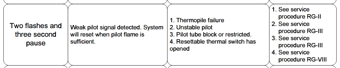

confused in Rhode Island . . . low sensor signal but pilot stays lit on Bradford White Defender
its a two flash then pause fault code on an MI5036FBN and the manual details sensor testing procedures which are fairly standard. my confusion is why does the pilot light stay on if the sensor is low? is there some gray area where it will leave the pilot on but not light the main burner on these? this is new territory for yours truly.
thanks. brian

    109A_5 Posts: 4,759
    edited January 4
    The gas valve assembly is powered by a powerpile or thermopile (the pilot). If it shut off the pilot the gas valve would go dead and you would have no diagnostic codes, I would think that would be worse with this high tech junk.

    takes a lot more power to open the main valve than it does to power the microcontroller and display. typically the current just holds the safety valve on so that takes a lot less power than opening the main valve too.
  • i realized this after posting the thread. i'm just so used to the inadequate thermocouple response/no pilot symptom that I didn't stop to think about the idea that lesser current could still keep the microcontroller going. dawn broke over marble head. homeowner decided on new heater anyway because it was a 2014 install. thanks all and @Tim McElwain
